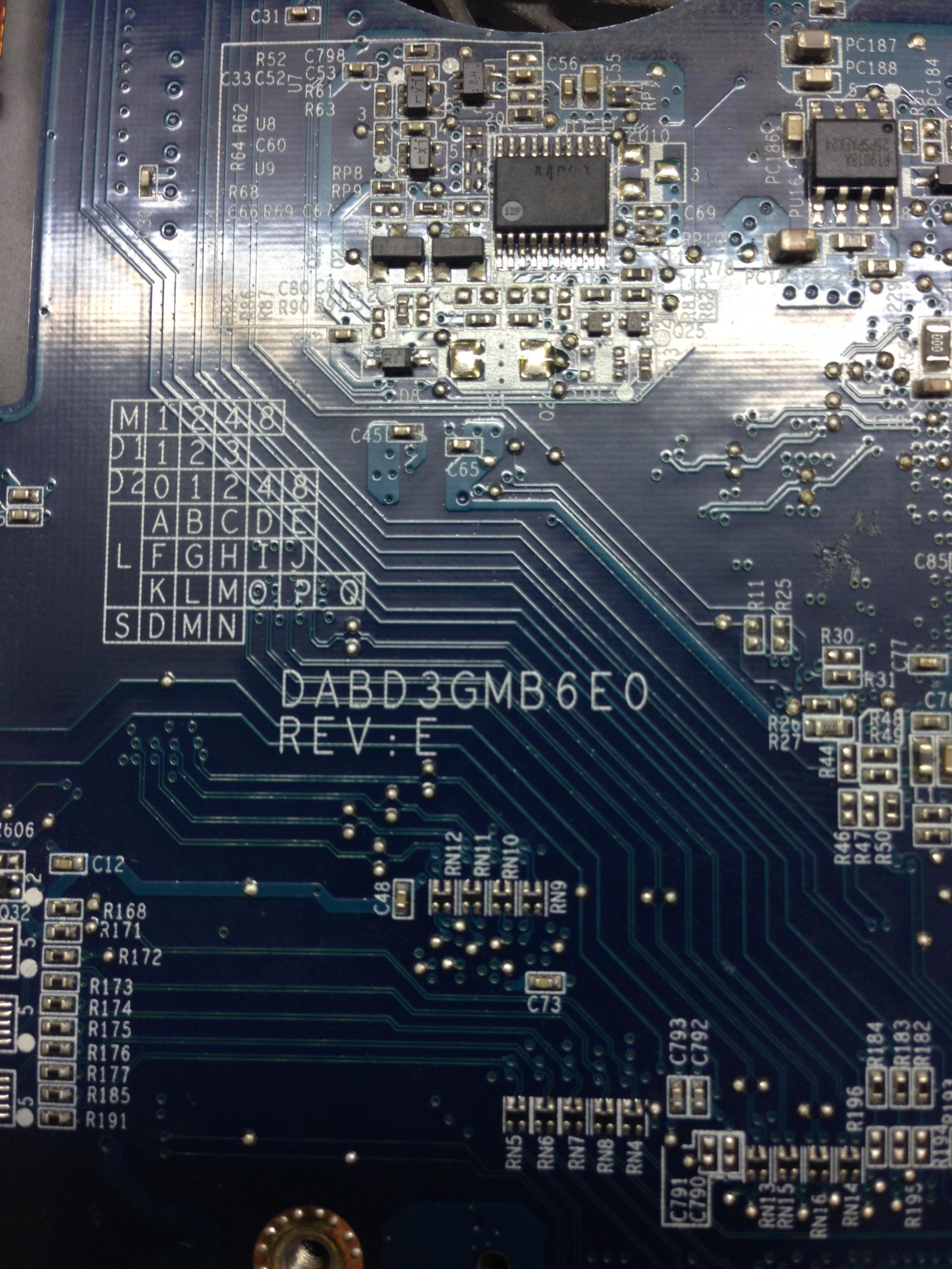

    Hi, i got this toshiba a300d with no display, fan spin for 2-3 sec. I thought it was the NEC/TOKIN issue, but i see there is SMD 330 smd. i can check them but i dont thik this is the problem. Does anybody have schematic for this board? it is
    DABD3GMB6EO REV E

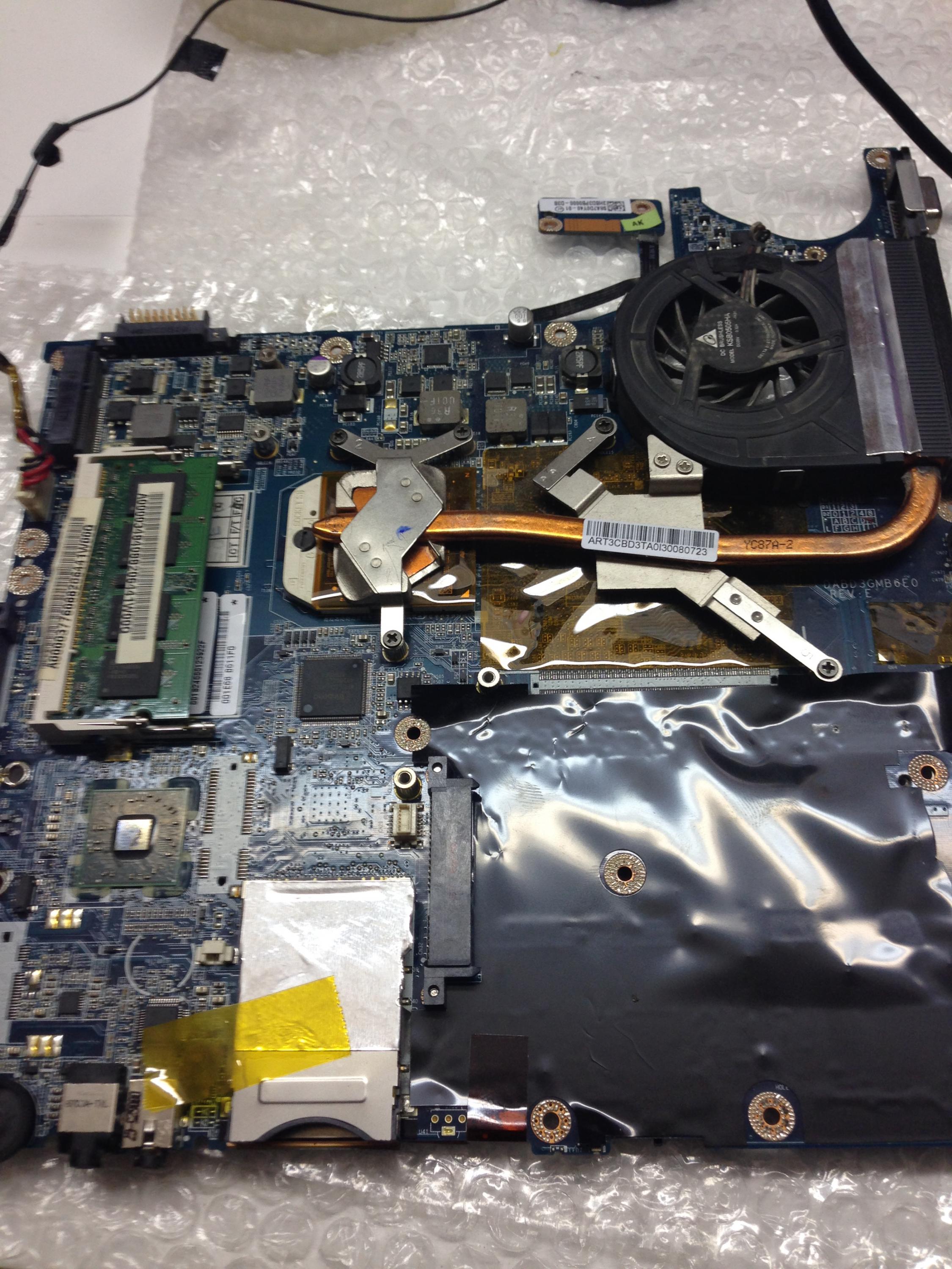

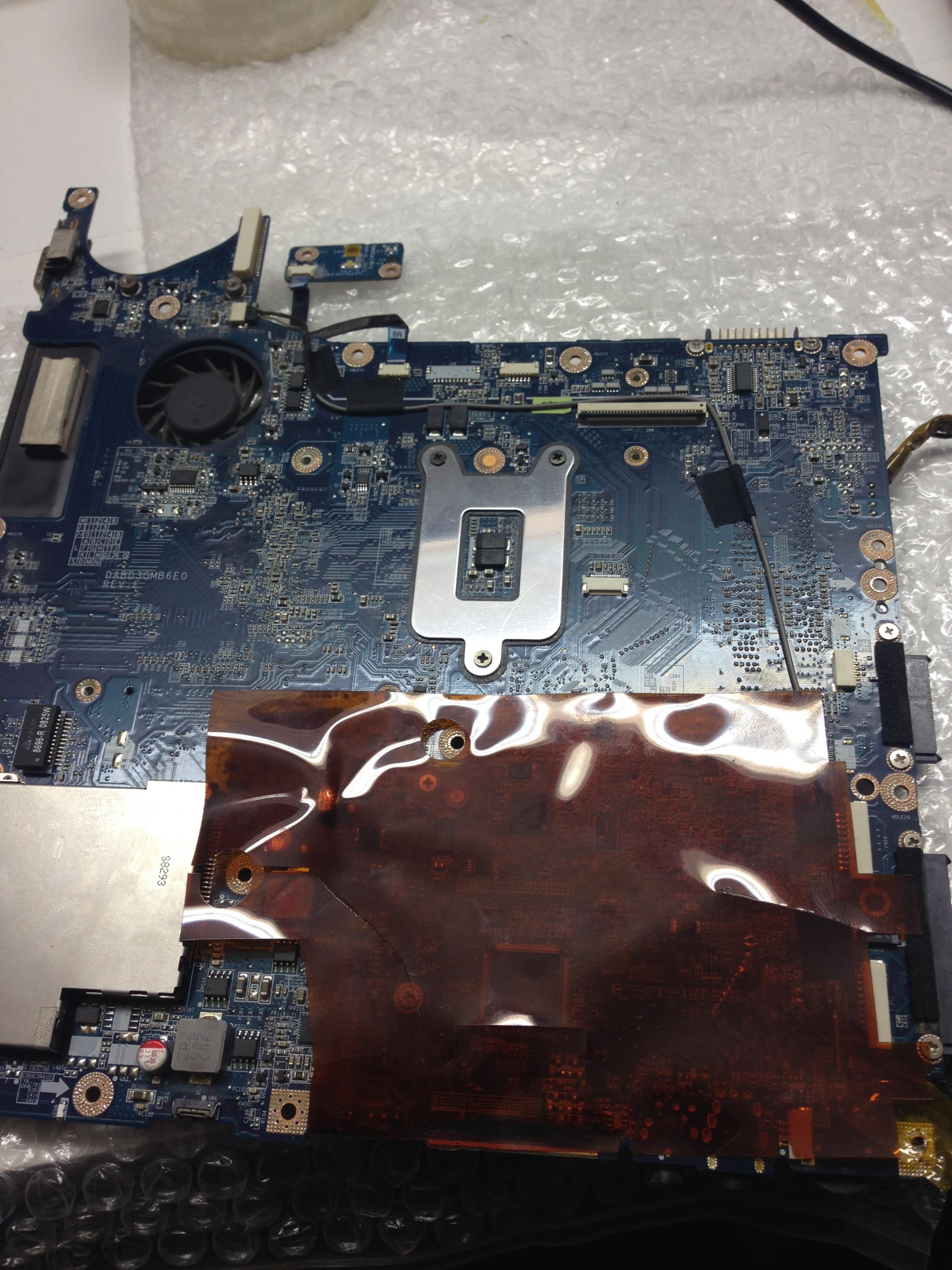

      Re: Toshiba A300D power problem
      just finish with the reflow, it worked. But i hate this kind of reapir, i can never be sure it will last a day, month or year. I think in this situations it is the best to put a new VGA card.

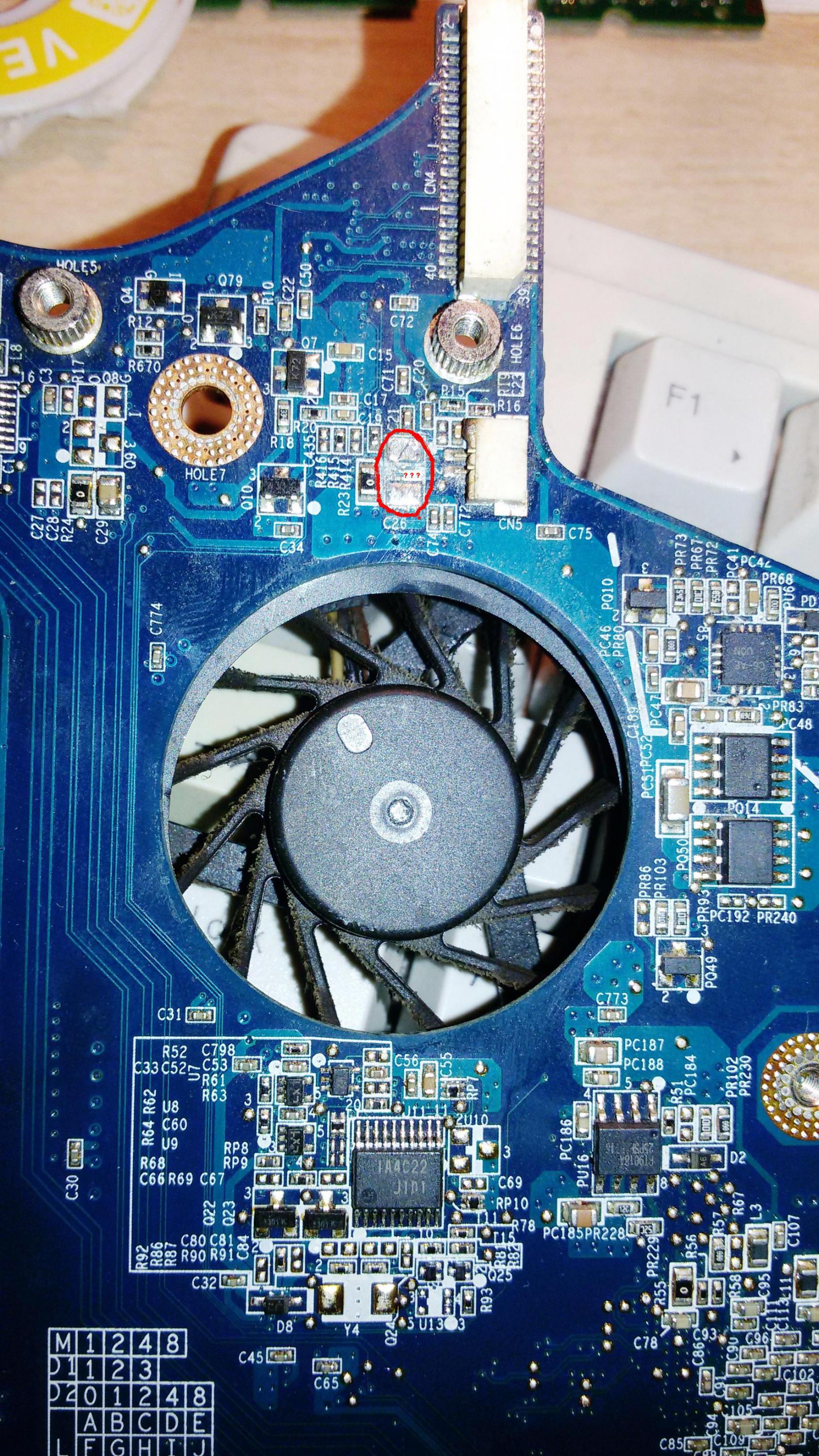

                  I have A300D 14E motherboard ( DABD3GMB6E0)...In that part was maybe a fuse or somethin else thats was completely fried, and the motherboard was without power or any indicator to show a life, I remove the fried component it and now is power on, tested with external monitor is working...but now I dont know is it a fuse or some another electronic component.. Need a little help
                  P:S: I saw pictures here from the same motherboard and I noted that is missing a cable that connect the down right side from the hole 43 to Hole 6( CN17 to CN5)
                  Hope 4 help..Thanks

                    no no no it`s not fuse it`s capacitor...big one i see,most likely on backlight power line...don`t put fuse...

                      Ah yeah! Crnogorac be nice and explain me which capacitor I need to put there.. The fried component was with a white colour...!

                        I guess you will need the schematic to find out what the capacitor should be
                        Edit: Think I found the schematic, see attached.
                        Check Page 20, top right for C26. Schematic says 10u/25V_1206

                          yes it is 10u/25V...i did not have schematics before...thanks to agent24
