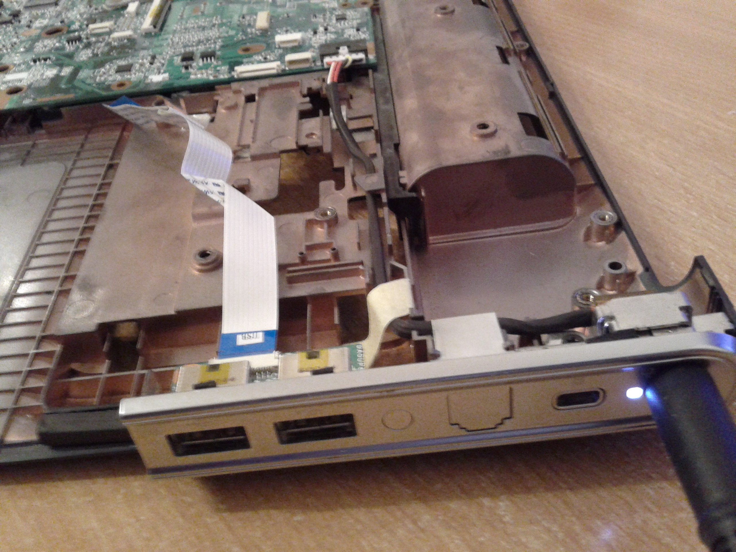

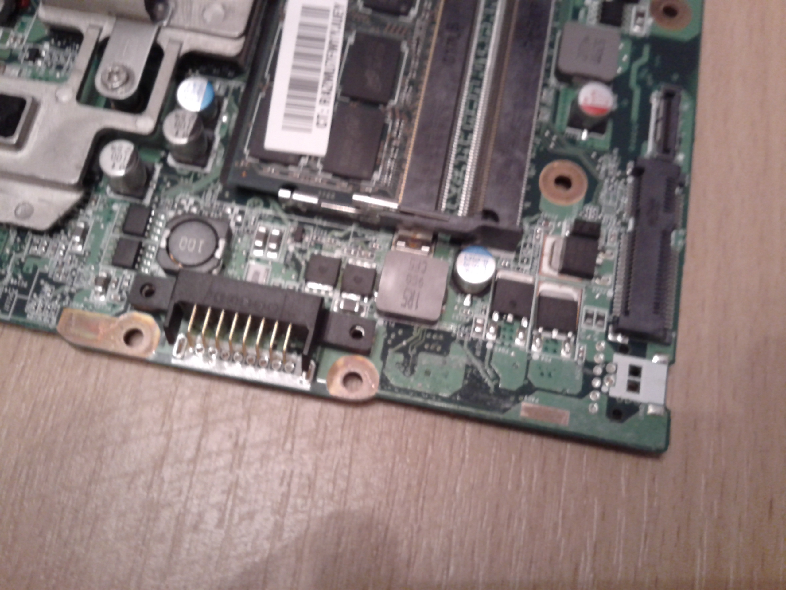

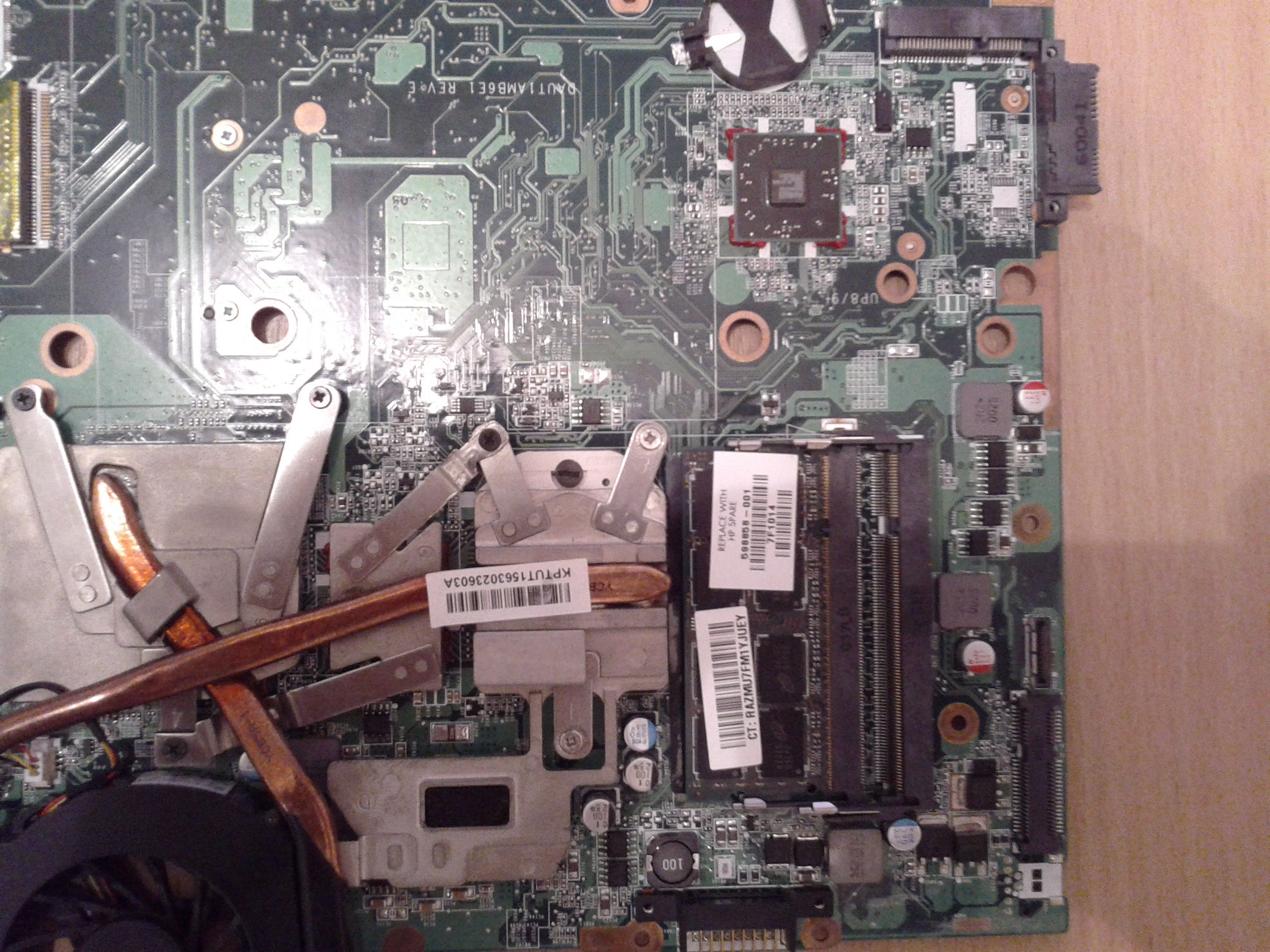

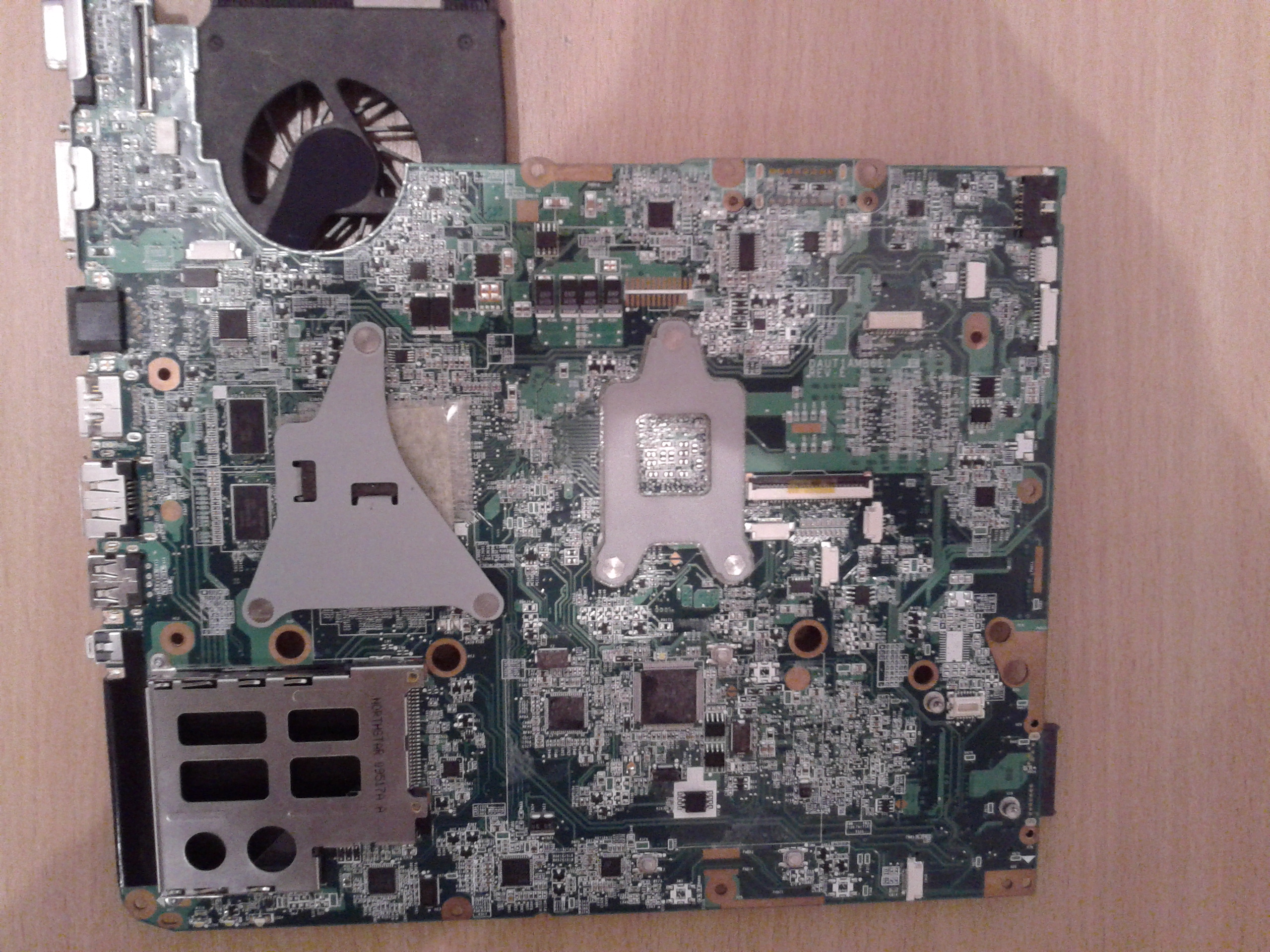

    hello to all
    I have problem with my HP notebook,
    wont turn on,no fan turning on,nothing.only light is on DC in
    Boad is DAUT1AMB6E1 rev:E UT12_ATI
    uploding pictures to see.
    Battery output on motherboard is 0,47 V,DC jack is 19.52V,I check voltage on board ,everywhere is about 0,5V,power button is 0,47V when I push button voltage is falling down ,so I think that is ok.

        Re: HP DV6 2130ec
        Power button voltage is extremely low. and probably bios chip have also low or no voltage in pin 8.
        You should find out kind of short-circuit in this supply line.

                              schematics are ok. but older rev. btw did you measure rtc battery ? also start flashing bios and change EC. Check signals ACOK, LIDSW#. you can use the schematics above, they are ok.
