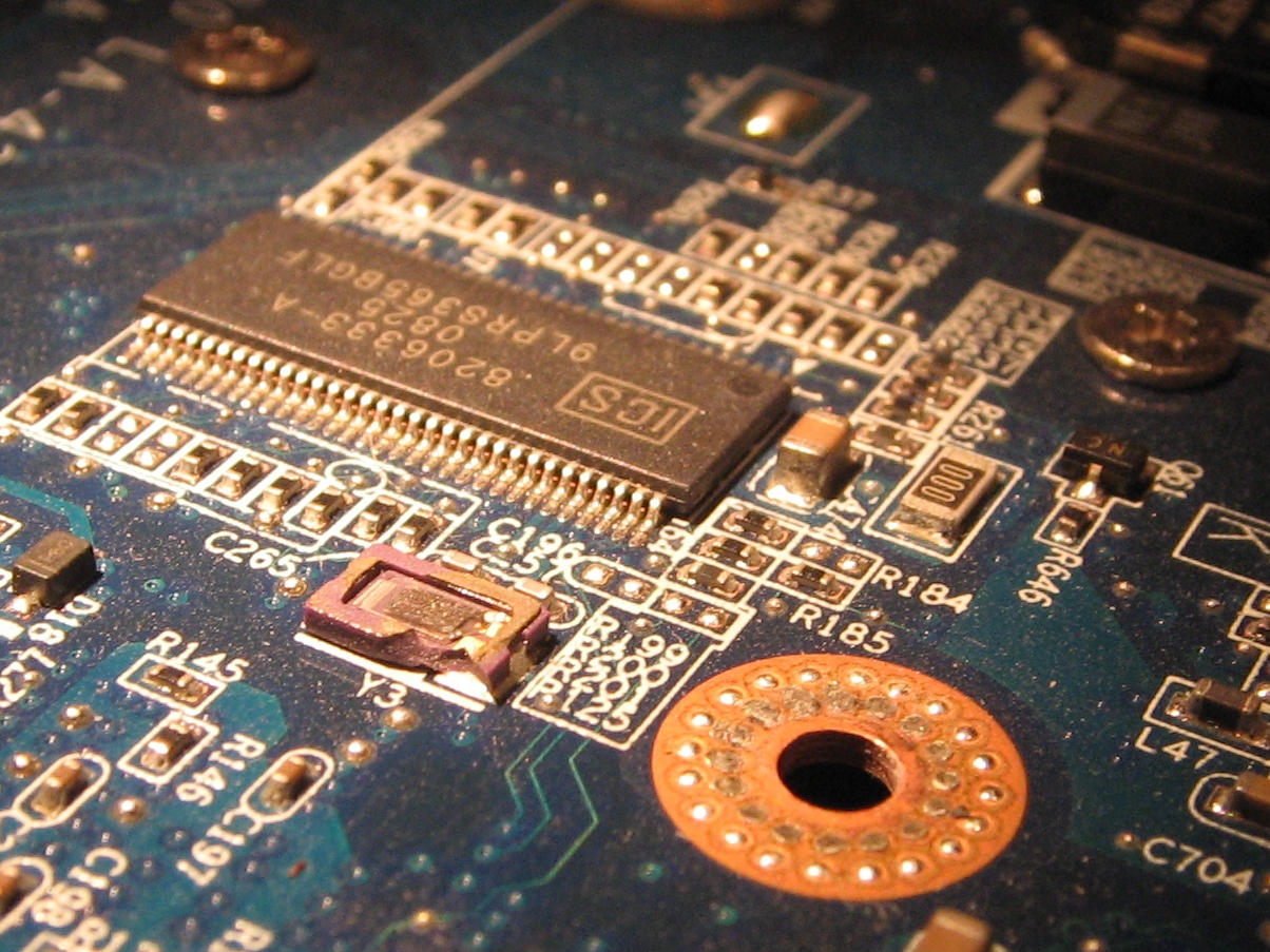

    This is my first attempt to fix a laptop... from a friend. Don't have a lot of hope for it but thought I'd give it a go.
    It's a Dell Vostro 1310 and it won't start at all. Tried stripping down to the basics, disconnect everything except 1 stick of RAM (tested OK in another machine) and it won't start.
    Fan spins up, then stops, then Caps Lock and Scroll Lock come on solid and NumLock starts flashing. Google suggests this means motherboard problem (surprise, surprise)
    Friend said it used to fail POST and beep sometimes, but would start others. Now it won't do anyhing. No beeps so far for me. Tried reset BIOS by removing battery, no change.
    Found schematics online (attached)
    Video: http://www.youtube.com/watch?v=m_PM1DJUQ_M
    Any ideas on where to look first?

        Looks like I found one problem for a start - the crystal for the clockgen is smashed. Guess I'll have to replace that and see what happens after...
        Any advice on replacement or known issues?

              Reflow the Intel northbridge/IGP chipset. That oughta fix it. What happens with those particular Dells is that the motherboard warps and some of the solder balls under the chipset no longer make contact. This is not the common lead-free solder cracks problem, it's a physical defect of the board itself, it is made of low quality material.
              For this reason i would not recommend attempting a reball on this mainboard, you will likely ruin it. Just reflow and hope for the best.

                    Reflow:
                    In its simplest form means to hover heat, over the gpu, which re-joins solder balls underneath the chip if they are cracked. If the balls are joined together, then a reball is needed.
                    Reball:
                    To replace solder balls on a bga chip.

                        just a reflow its ok. this is my 1310 i did http://www.youtube.com/watch?v=ihxjo...0ORz_hRD4VCYeQ
