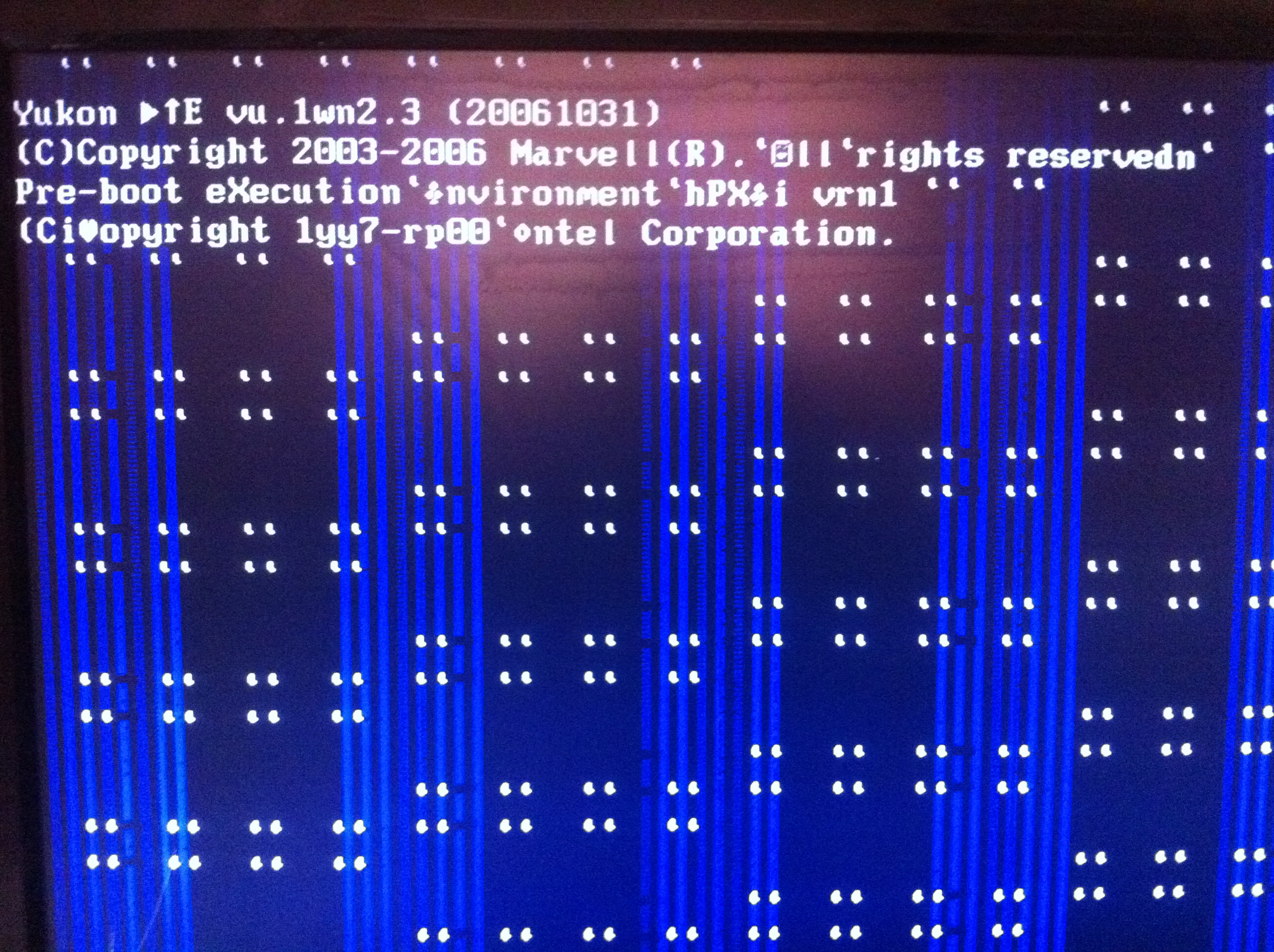

    Toshiba A200,distorted display
    Hi everyone, i have this Toshiba A200 with dedicated graphics card ATI RADEON HD 2600 and 512mb. The display is distorted and i want to know whether it is from the GPU itself or from the memory chips.Thanks in advance.
  • lord
    • May 2011
    • 319
    • Croatia
    Re: Toshiba A200,distorted display
    my exp says vram
    • siddiq
      • Dec 2011
      • 121
      • Ghana
      Thanks for reply.Please verify for me if a reflow will suffice or i have to change them.Thanx.
      • kc8adu
        • Nov 2003
        • 8832
        • U.S.A!
        vram may be shared with system ram?swap it first.
        • siddiq
          • Dec 2011
          • 121
          • Ghana
          video card has dedicated vram
          • selldoor
            Slow Learner
            • Dec 2010
            • 7870
            If you gently flex the board does the pattern change
            • lord
              • May 2011
              • 319
              • Croatia
              reflow would do for some time, if you want to do the job done you have to reball them, or buy new ones.
              • fddizon
                • Sep 2011
                • 555
                • Philippines
                Sid,
                give it a try... flux it nice and reflow evenly
                tried one like that and its about a year now and still ok...
                just did cleaning after six months
                good luck!
                • lord
                  • May 2011
                  • 319
                  • Croatia
                  So? What happened?
                  • rievax_60
                    • May 2012
                    • 897
                    • australia
                    Because the VRAM can be stuck to the heatsink by the thermal paste, the VRAM can be pulled from the PCB.
                    • siddiq
                      • Dec 2011
                      • 121
                      • Ghana
                      Will get back to you soon...
