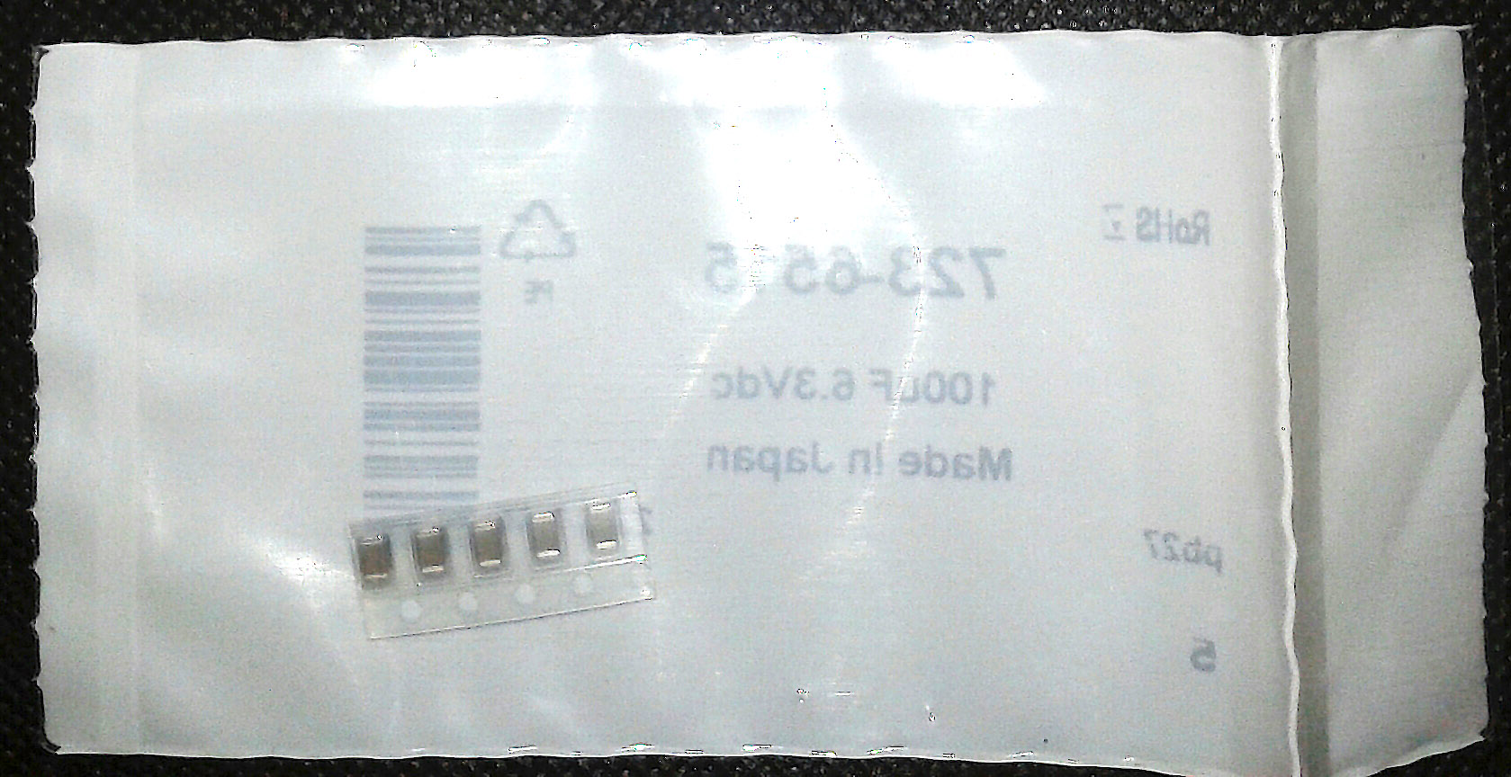

    Hi Fddizon,
    The 10 caps with RS Stock No.GRM31CR60J107ME39L arrived to me 2 days ago and I don't really know the correct capacitance for each of these caps. Could you please tell me if there is a way to determine the correct capacitance of the 10 'Murata 100μF ±20% 6.3V dc X5R Dielectric Ceramic Multilayer Capacitor' that I had now? Does it necessary to check the polarities of the caps before I really proceed to install them on the correct terminals of the pads (+ or -) ?

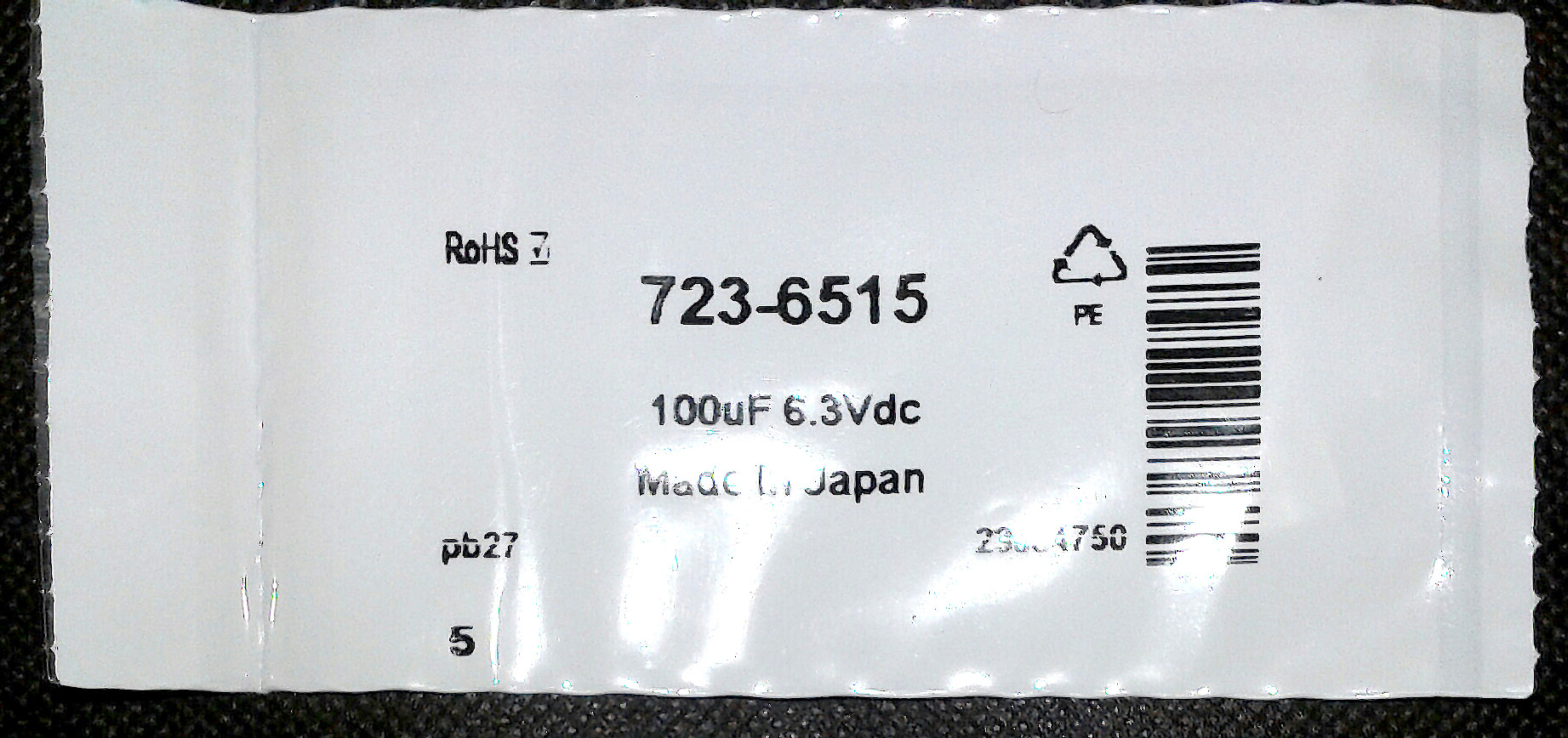

      Re: MSI CR400 no display
      Its clearly stated on the label. Capacitance value is 100uf. No polarity, so any orientation will do. Just make sure one end touches one pad and the other end to the other pad.
        They are 100uF 6.3v ceramic capacitors : http://au.mouser.com/ProductDetail/M...k1crgPpDV82A==
        The polarity doesn't matter with these capacitors.
        I would like to point out that if you're trying to use these to replace electrolytic or tantalum capacitors that had polarity, you're making a mistake.
        Ceramic capacitors are very sensible to voltage, the capacitance won't be 100uF at 5-6v... in fact they're probably going to be 70-80uF at 3.3-4v
        Only use these if you had ceramic capacitors in the first place on the board.

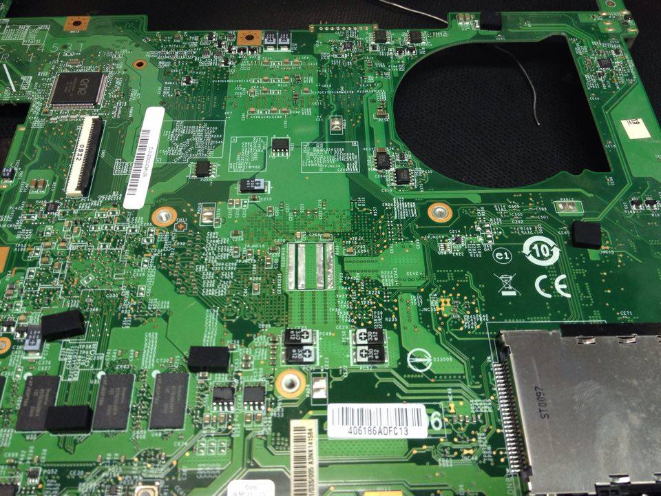

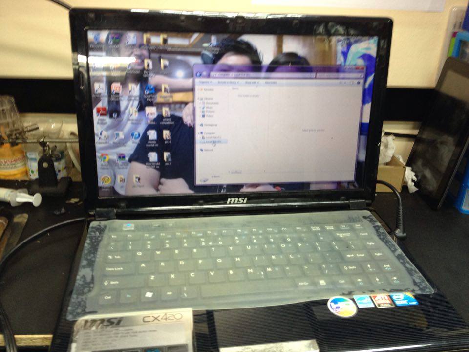

            #105
            Originally posted by fddizon
            i never tried replacing nec tokin chip with these ceramic capacitors but there are success testimonials on replacing nec tokin with ceramic caps on bad caps mega thread...
            take a look at this... added some on the pads along with the original nec tokin chip
            https://www.badcaps.net/forum/attach...0&d=1296545075
            and this one too...
            https://www.badcaps.net/forum/attach...6&d=1304731178
            much better
            https://www.badcaps.net/forum/showth...t=8991&page=12
            Hi Fddizon,
            These are the result of my MSI CR-400 laptop motherboard recapping. I have been using ten of "GRM31CR60J107ME39L CAPACITOR CERAMIC 100UF 6.3V" from RS-Component Malaysia . I will be testing the board by reflowing it using hot air pencil and possible to really get the ESR value for the newly soldered capacitors. Would like to know if any suggestions for reflowing it for further fine tuning or adjustment on the board before putting all the parts back together? Do you just recommend tool like Atlas LCR meter for getting the correct reading on the circuit?

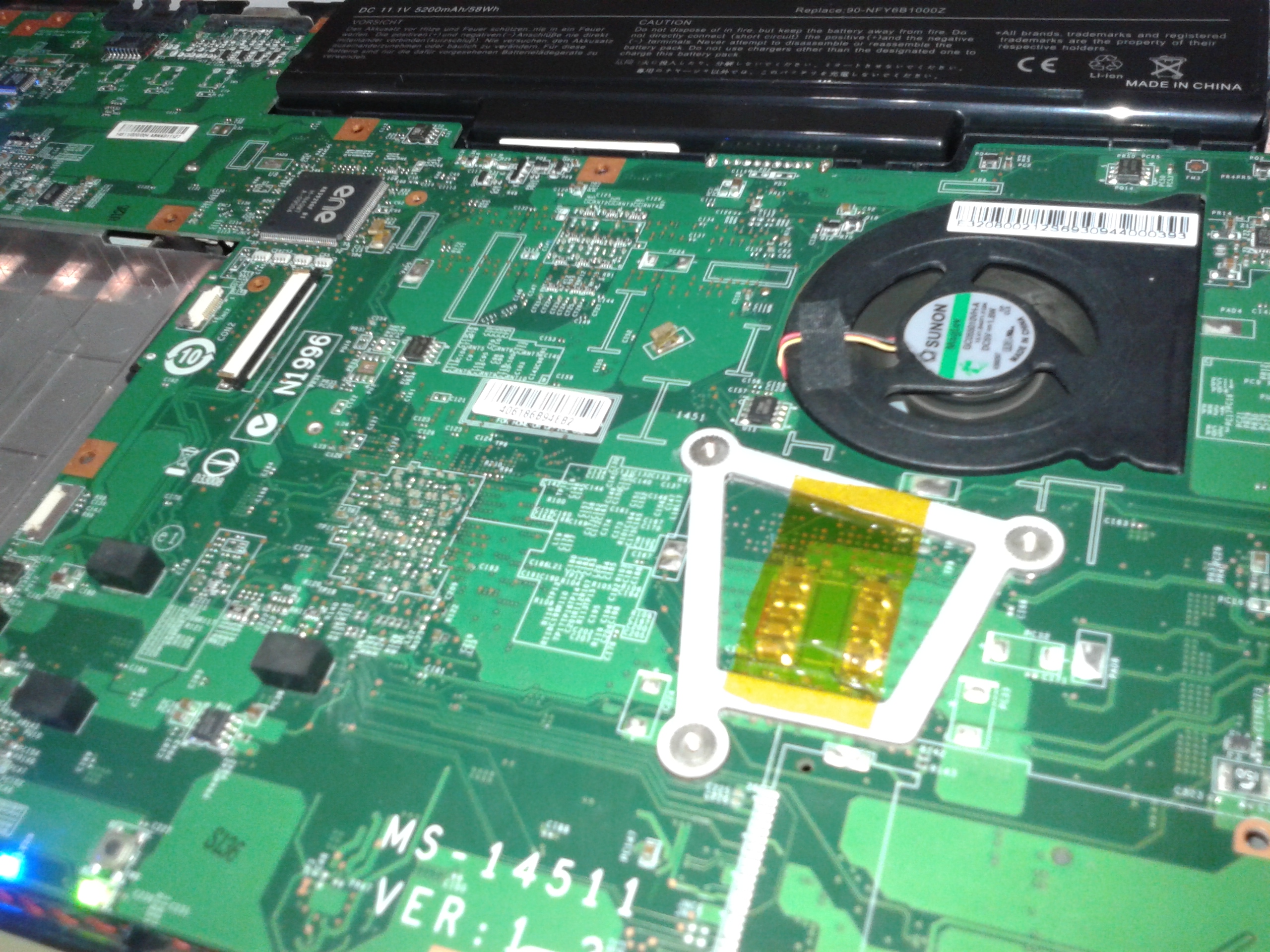

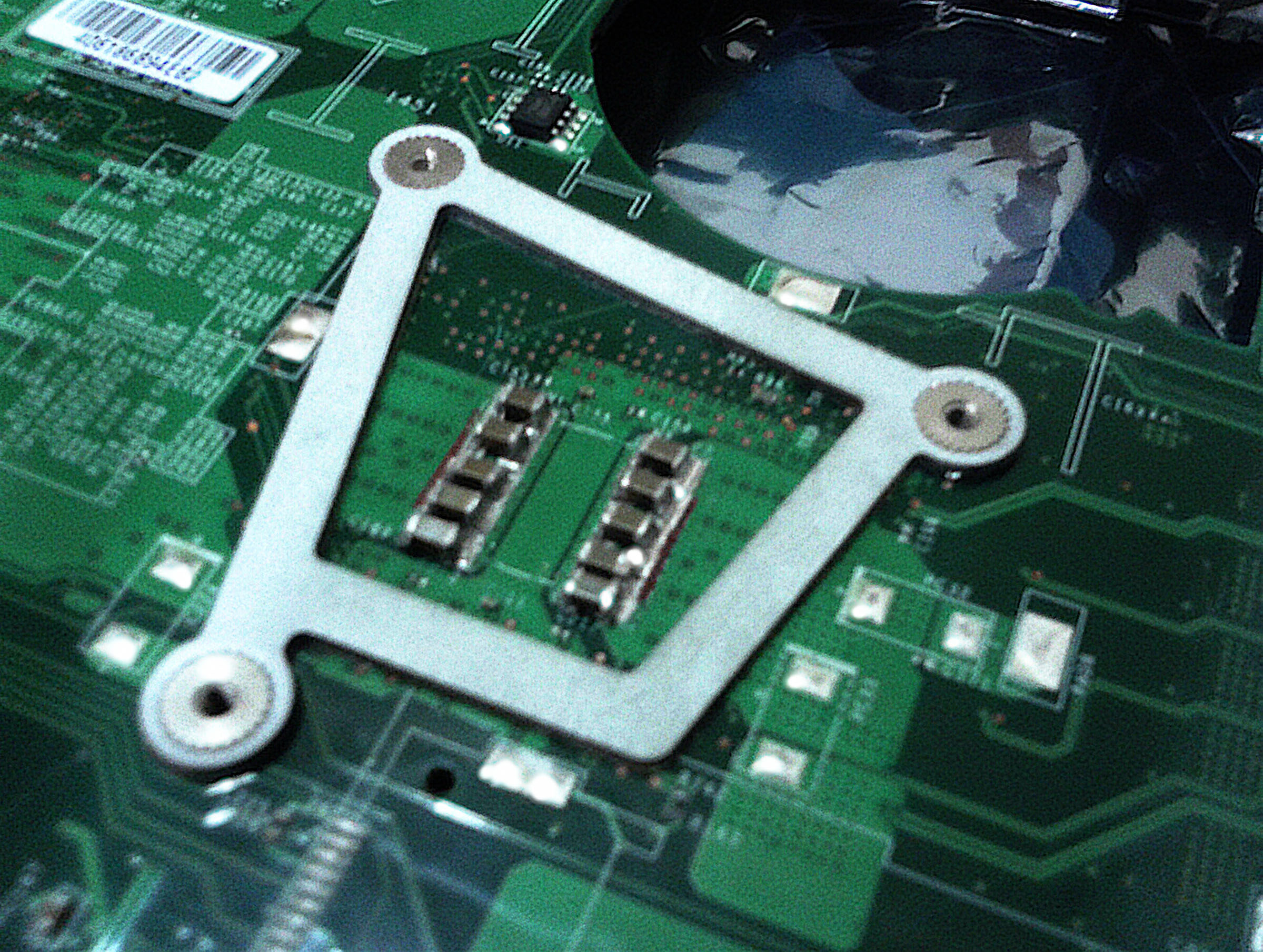

                  #108
                  hi all
                  i have cr400 with no display, i have replace smd capacitor with 4 tantulum
                  capacitor(330uf), the display used to come by pressing sidescreen. after
                  few attempt the laptop smoked and goes earlier state (no display, power &
                  sleep led lighting).i have opened the board and checked capacitor were not burnt some
                  other component were black, i don't know the name.
                  please help what to replace now.
                      Originally posted by kapilverma
                      hi all
                      thanks
                      You need to post photos, show your work, the burnt components, and the area you were pressing on etc.
                      And what exactly were you pressing on the side? You may have shorted something out or there was maybe a bad solder joint in the area.

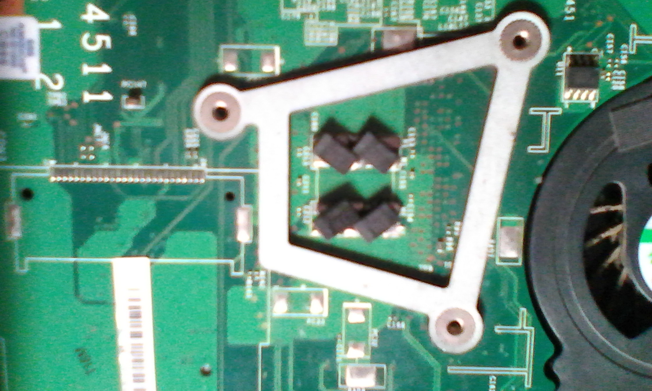

                        you can see in the picture marked with circle fan rod is blacked out with
                        smoked generated from the register under it.
                        i don't know exactly from where smoke cames out, because the fan rod is
                        little black on the round, so i think register/transister under it may be burnt.
                        another picture shows the 4 tantulum capacitor replaces proadolizer capacitor.
                        thanks

                          #112
                          Your work with the capacitors looks pretty good, although it's hard to tell for sure with the photo not in focus, so I can't be sure if they are not backwards or there is some solder bridge or anything. Can you get clearer photos?
                          Going by the way the heatsink mounts in the previous photos posted in this thread, the curved part where the smoke is sits right over the MOSFETs that are part of the CPU VRM. There are six 8-pin parts there, you should check them all carefully, I bet one or more is blown.
                          -David VanHorn

                            #113
                            i didn't replace the capacitor myself, i have soldered by a motherboard repair technician.
                            regarding the cpu VRM part, leftmost mosfet seems blown, is display not coming from this smoked mosfet ?
                            which type of mosfet should be replace now
                            thanks

                              #114
                              thanks
                              If the CPU VRM has a blown MOSFET, nothing is going to work because the CPU will not get any power.
                              The MOSFETs will have the numbers printed on them, write them here or take a photo showing them clearly.
                              But you may have more than just blown MOSFETs, if they blew that hard to cause smoke. VRM controller maybe blown too, if you're really unlucky it may have blown the CPU as well.
                              -David VanHorn

                                  #116
                                  I just fixed mine MSI cx420.
                                  problem: auto shutdown when loading windows.
                                  solution: replacing Nectokin with 4 330uf 2.5 tantalum caps.
                                  and it works........
