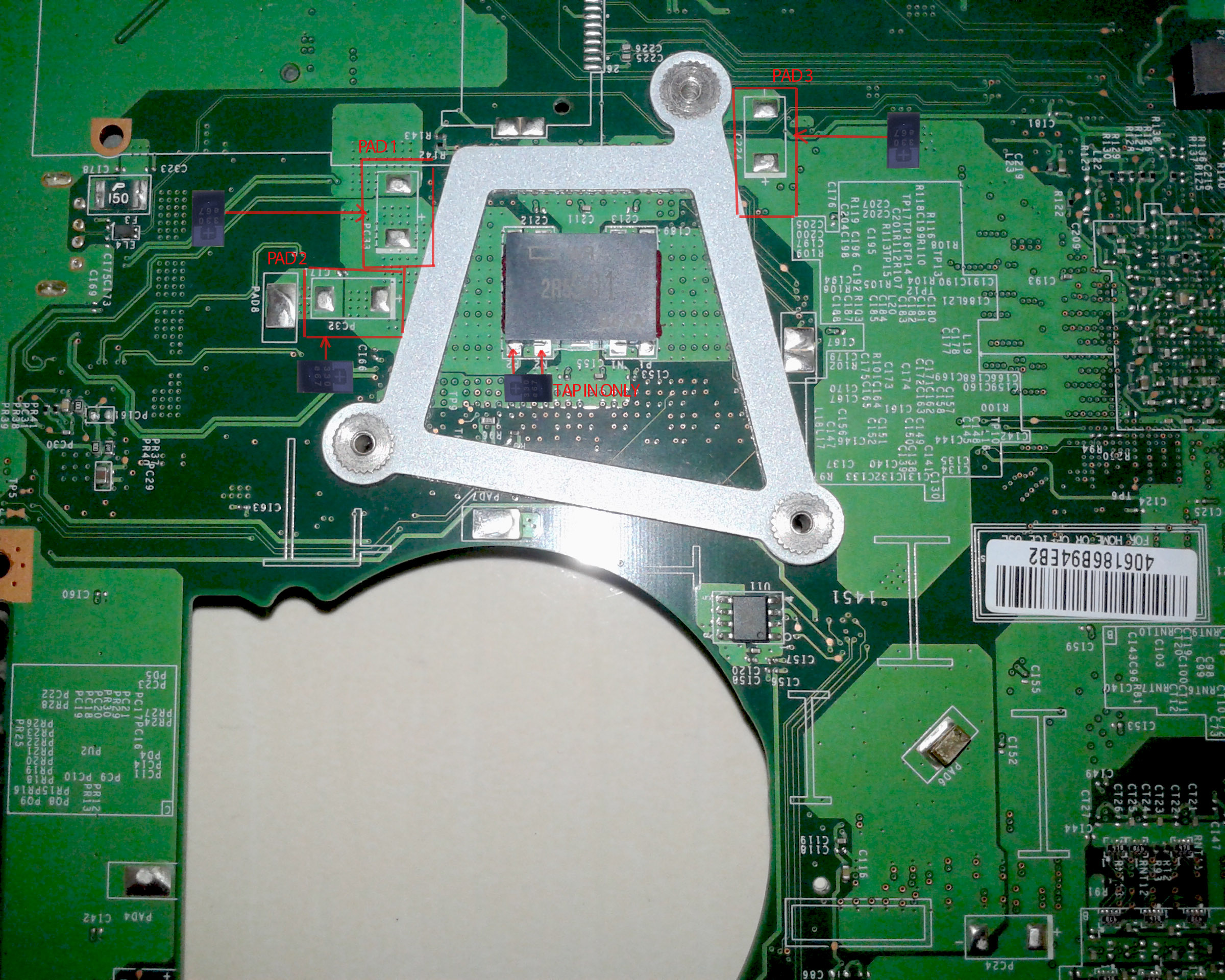

              Hi my MSI CR400 with power but no display
                #87
                Re: MSI CR400 no display
                Originally posted by fddizon View Post
                hi,
                when powered on, no display, fan spinning, power led is lit, sleep led is lit.
                5v 3.3v alw are ok. Coils near cpu has .01 and .02 volts.
                What does this mean?
                nec tokin is the problem try to replace it w/ 2 pcs smd capacitor (330) is the value
                  #88
                  Originally Posted by kenttech16
                  I think your problem is the same with toshiba satellite L300 series,if you are familiar with this one and if not you can search it here. The NEC/TOKIN is the culprit, it is the same with the one on top of the cpu (encircle in red) see attachment. Try to replace it with smd capacitor 4 X 330 uf 2.5v.
                  I've already tried and repaired 5 more of this model and and voila it works for
                  me. Before I also thought it was the Nvidia gpu was the problem, tried reflow and yet no luck then i suddenly realize the capacitor is the same with NEC/TOKIN from Satellite L300.
                  Hope this works for you.Good luck and let me know what happened.
                  Can i use Capacitor Tantalum TPE series 2.5V 330uF 7mOhm ESR from Panasonic? I have the same problem here and i have disassembled my MSI-CR400 waiting for the correct capacitor to be added on the vacant pad as 'kenttech16' mention in his post

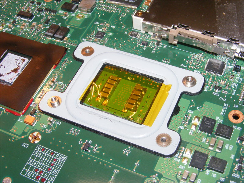

                            #93
                            I think color doesn't matter as long as the values are correct. I use 330uf 2.5 volts with 7 mOhm esr.
                            In msi boards I use 2-3 of them. Toshiba and acer 4-8 pcs.
                            d=2.0 volts and e=2.5 volts
                              #94

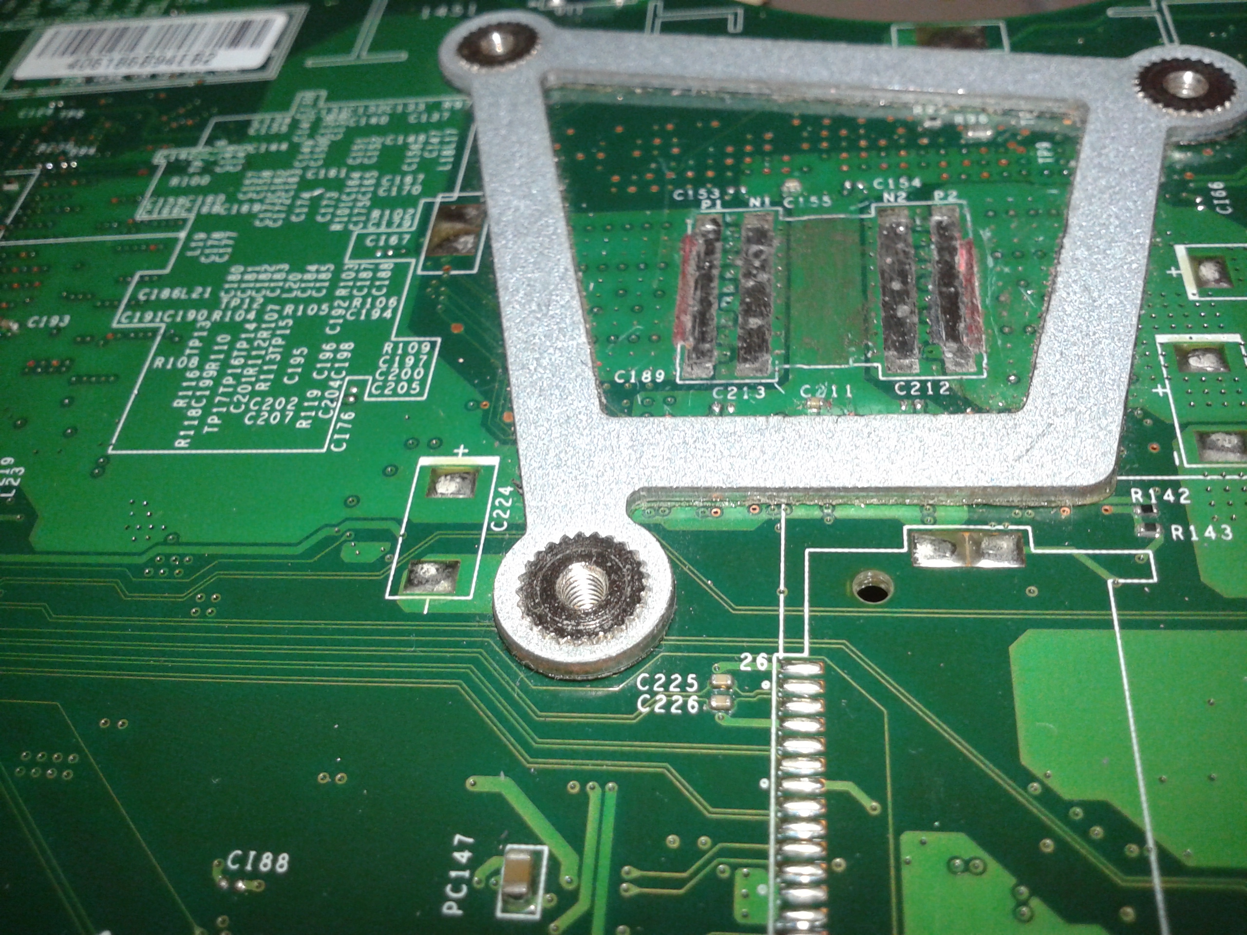

                                  #96
                                  Originally posted by ry x hunter View Post
                                  it depend to your experience.. but for me i try several times in toshiba and msi.. it doesnt work.. but when i try to use the black smd capacitor it work for me..
                                  I have actually safely remove the NEC Tokin but the + terminal strips is bothering me. It is usually stay attached to the PCB and have to be removed seperately. There is not much left to be removed actually. As you had mentioned in your last post that using the white capacitor will actually reduce successful rate so i decided to order 4 of the black SMD capacitor (NIC component) from RS components in my country and i wish that i'm correct.
                                  One thing is how do you actually remove the remaining materials on the + terminal strips safely?

                                    #97
                                    i use hot air and soldering iron together but before using the tools, i apply more solder leads to pads and touch the pads with the tip of the soldering iron plus heating it up the tip using hot air at the same time. also put flux to the pads
                                    nectokin remains will come off easily.
                                      #98

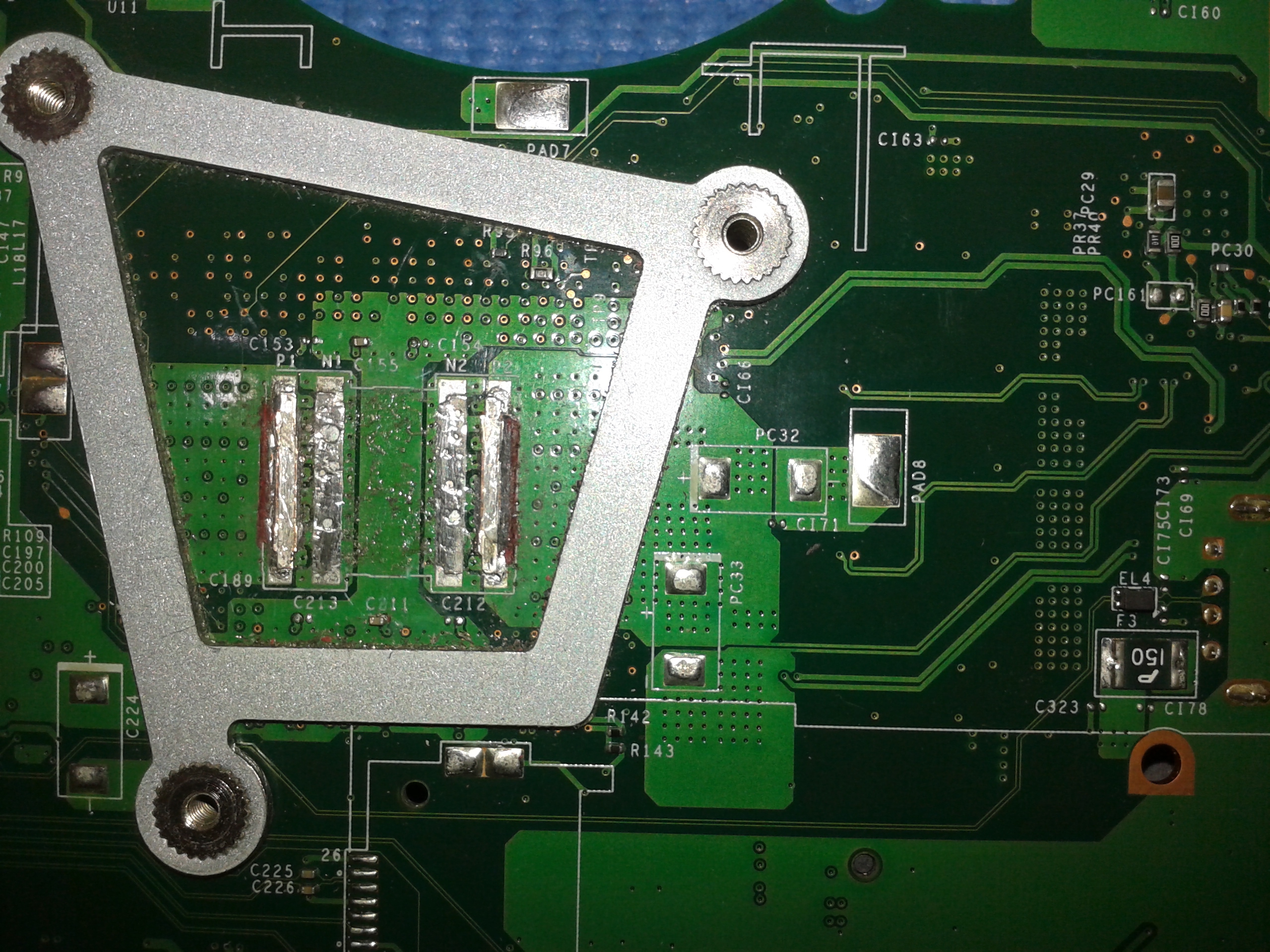

                                        #99
                                        i think they will do the same as the tantalum.
                                        as we can see most of the capacitors used were ceramic caps other than nec tokin proadlizer caps on most motherboards.
                                        much easy to install because ceramic caps are non polar and small, fits better on the pads too.
                                          Hi Fddizon,
                                          I have ordered the 10 caps with RS Stock No.GRM31CR60J107ME39L and will arrived to me maybe next week. I'm new to all this replacement tokin stuff, actually so i will really appreciate that you can give some tips and help me for replacing and installing the 10 caps as soon as they are delivered to me. For installing the murata caps what kind of tools i need to have in order to safely perform the job etc.type of soldering flux, hot air and soldering iron, type of solder leads/wire ?And will putting flux to the pads(on PCB) is useful when use with hotair/gun for soldering the caps back onto the motherboard just like desoldering and removing the nectokin's remains which you told me on your previous post ?
                                          From the second thumbnail, i have managed to remove the remaining materials on the + terminal strips. At least I hope the + terminal is clean now i guess..so i will be waiting for my murata caps to arrive from RS-Component (UK). I hope everything will be fine...
