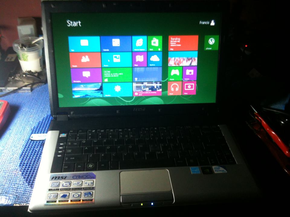

        works great... same as toshiba nec/tokin issue
        thanks to all of you guys...
        specially to ken
        attached is the picture... win 8 installed

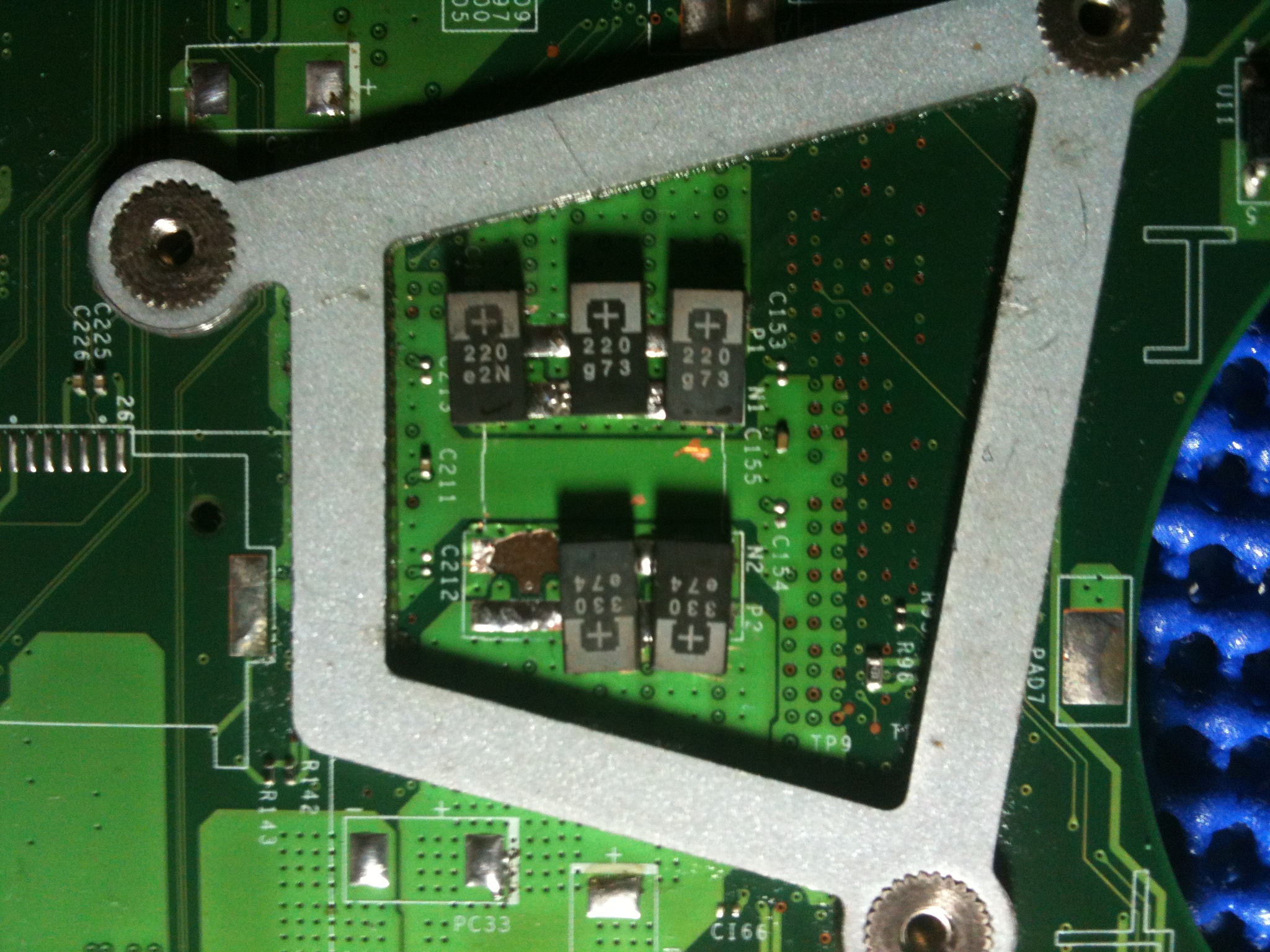

          ok na.. gawa na siya. inalis ko proadlizer capacitor, and replaced it with four 330uf tantalum...

                            thanks kenttech16 for the tip and fddizon for these thread. i have the same model and same problem. I will try it to.
                            @fddizon
                            do you have a picture of that fix you did?

                              here is the picture...
                              my apology that i mentioned "I replaced the proadlizer with 4 pcs 330uf tantalum" but rather i replaced it with 3 pcs 220uf and 2 pcs 330uf. it works the same. total capacitance is the same with 4 pcs.
                              note: be carefull in pricking the chip. pads easily break off.
                              (scrape mo yung tapat ng positive lead para may pag hinangan ka, kung ganyan ang orientation na gagawin mo)
                              regards
