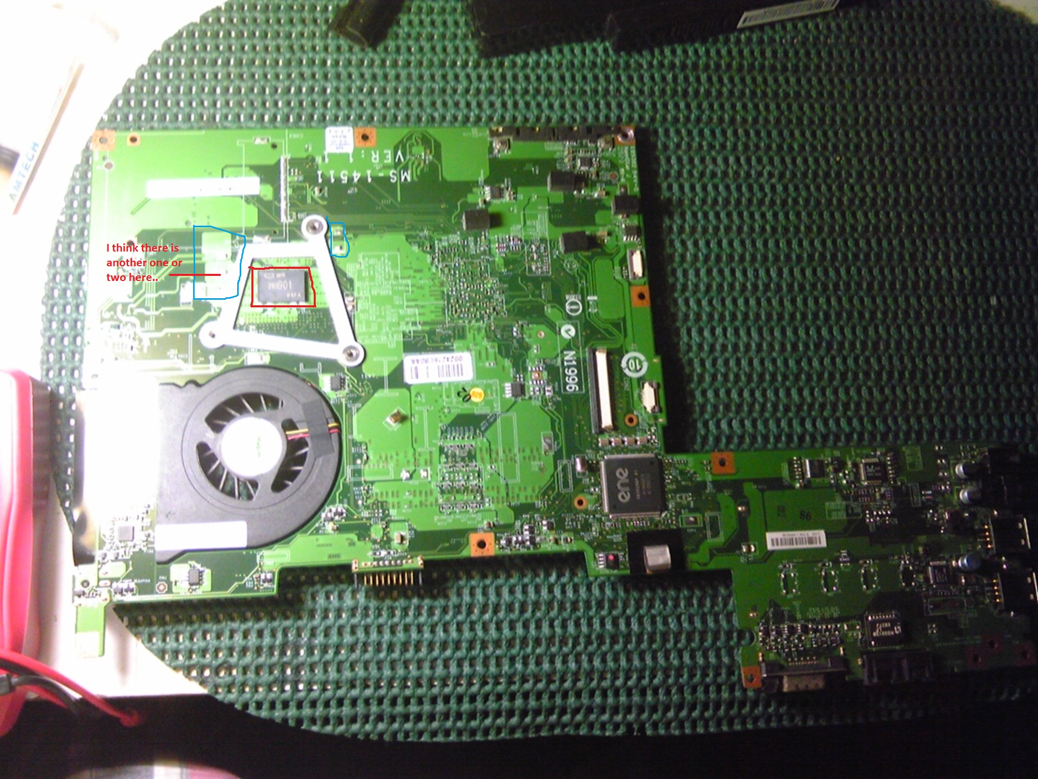

          What voltage of tantalum did you use sir? 2.5v? Did you removed the NEC/Tokin type capacitor and then put the smd capacitors on the terminal both ways with proper orientation? If all are correct then it is possible that reflowing the gpu might caused the damaged? I just hope i'm wrong with this one.
          For me, it works with all the MSI CR400 with Nvidia I had repaired before, and today another one of MSI EX460 with ATI with power led lit up, sleep led also lit up and hdd led is lit up and no display. But I did first the basic procedures, clean the memory module, replaced with good one to isolate. then, removed the cmos battery to reset the board settings, also removed keyboard,odd and hdd to be sure if something is wrong or triggering the no display problem and with only the board, processor and memory still to no avail. Also did replaced the processor and yet no luck.
          That's the time i added two 330uf tantalum first besides the vacant capacitor terminal at the processor and voila it works for me again.

              kent,
              thanks for the reply. i used 4 tantalum capacitors without removing the proadlizer capacitor. just tapped on the proadlizer pads.
              i just did a mild reflow on the gpu which i think not destructive.
              i used tantalum capacitors taken from defective motherboards.
              will try again tonight.
              thanks
              Francis

                100% it's a nec token damage problem. try with capacitors 330mf x 4.

                          Agree 100%!!! Because it always works for me every time I had that kind of problem with that model and the likes.

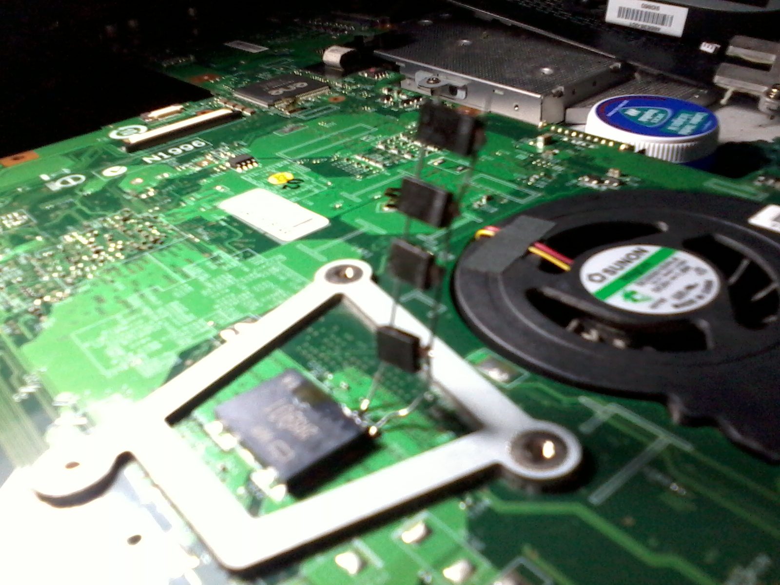

                            what i did earlier is this to no avail.
                            i soldered 4 330uf caps to solid wires and tapped it to proadlizer pads, the same result.
                            will try to solder the caps on suggested pads.

                              your a pro bro. it worked when i put 3 caps with marking NEa JE8 capacitors. too bad that the processor overheats and turn off after a few minutes.(overheat protection) i guess the capacitors value does not fit with the solution.
                              i am ordering 4 330uf 2.5v tantalum capacitors later. will update you soon.
