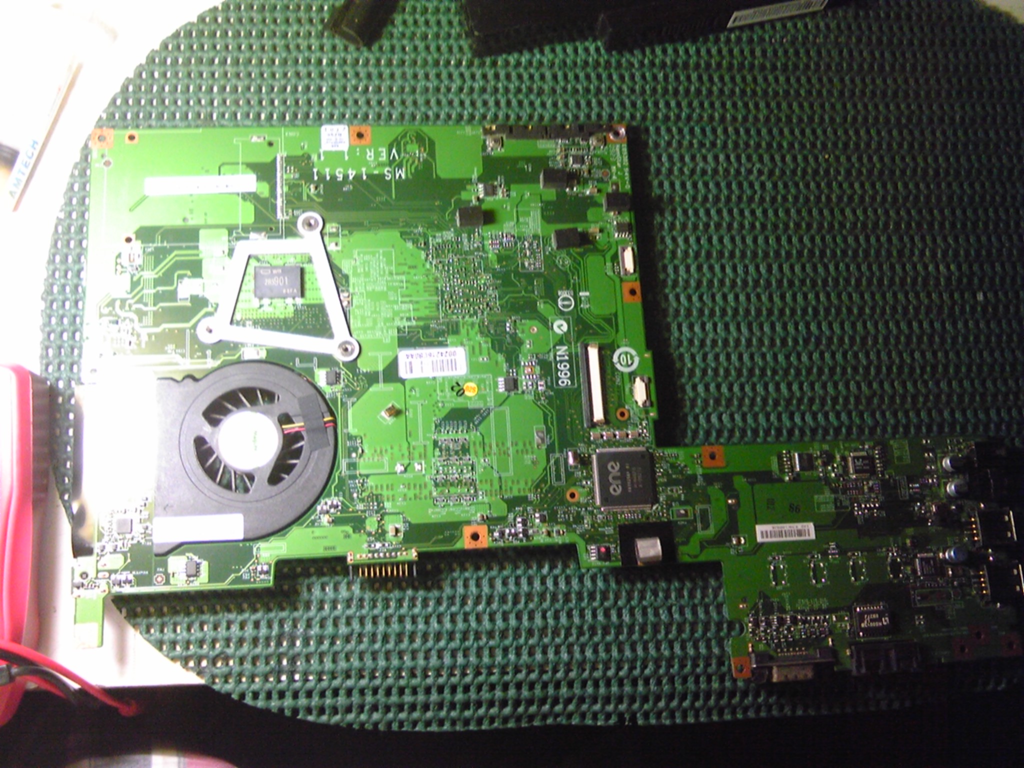

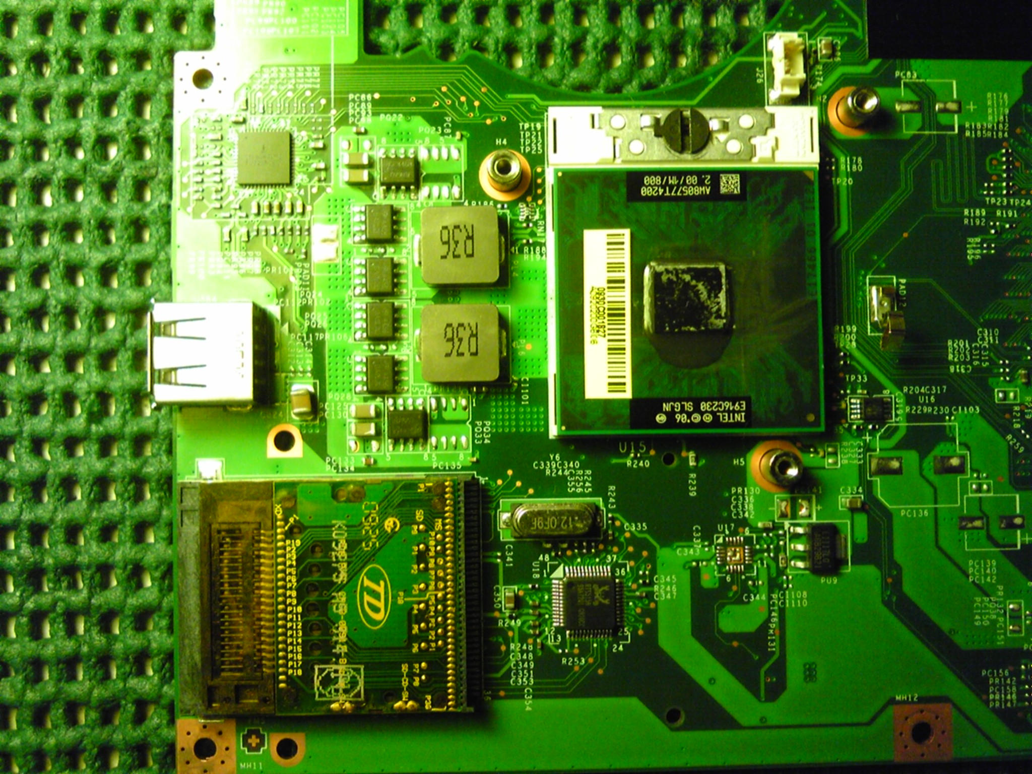

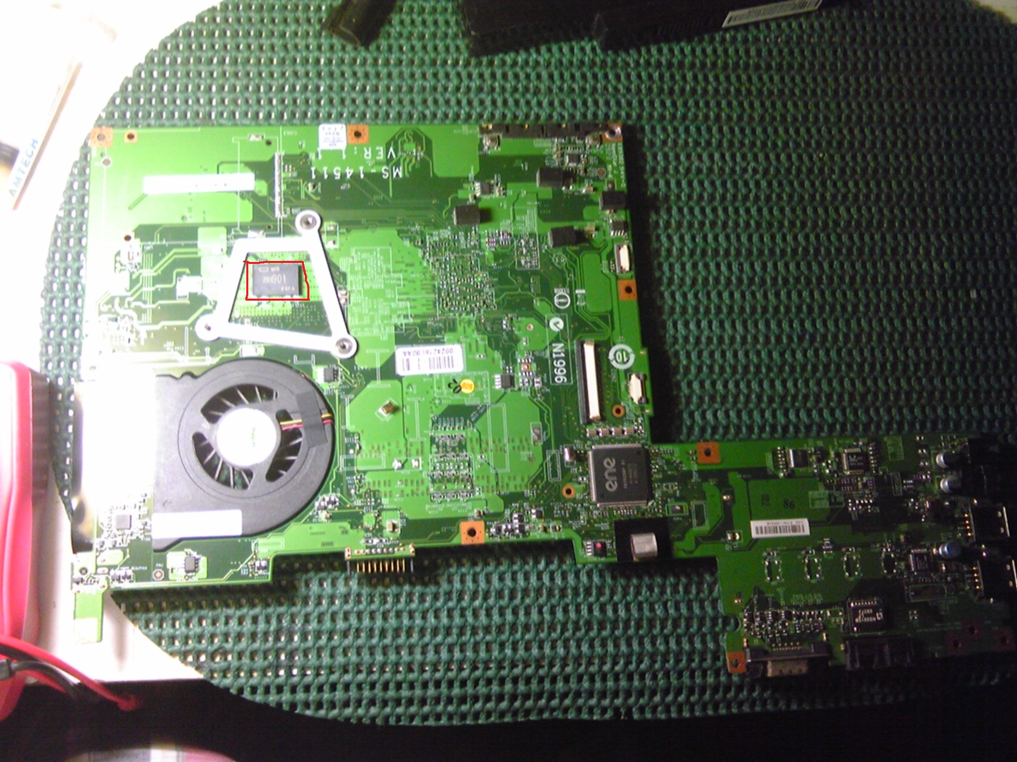

              Re: MSI CR400 no display
              hi,
              here are the pics.
              correction on my post #5. pins 5678 has 19.11volts, no gate voltage pin 4, no voltage at pin 123.
                do you check the voltage without the cpu ???????
                the isl6262 is the driver of these mosfets so their gates are connected to it .
                as you said you had already change it with a good one ,check if isl6262 is supplied with the 19v ;5v; and 3.3v; that is necessary for his functioning

                  no, i made test with the cpu on.
                  further test made with the help of a friend in uk. tested coil for gpu tested shorted to ground. isolated coil to determine if the short is coming after or before the coil. based on tests, circuit going through the gpu is shorted to ground. we assumed that the culprit is the gpu making the vcore voltage not to function properly.
                  earlier:
                  i had some test from the pins of isl6262 -
                  vin is ok, 3.3v is ok, powergood is ok.
                  what pin is 5v on isl6262?
                  tnx
