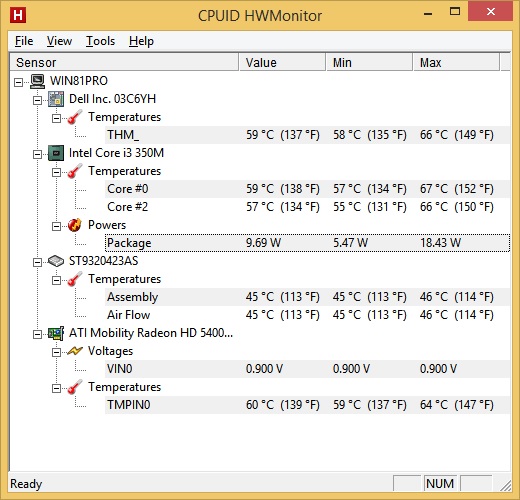

    Have you tried monitoring the CPU temperature to see if it is overheating? Sounds like a heat issue to me. Does the fan sound like it is on max all the time?

        download speedfan.

                taking me 2 month to found a solution for this overheating for unknow reason,cpu temperature go above 80-100c in minute. somehow i suspect is the heat sink can not transfer heat. if you have overheating problem, guess your screen also got color bar too, sign of GPU overheating. this fews items all you needs, cpu thermal paste for CPU,and cut a piece of cpu thermal pad about the GPU size and place it above the GPU chip-set with thermal paste, and because the extra high, you needs to adjust the heat sink. The next thing is cover-up the fan hole below the notebook using electric masking tape, this force the fan get the air from the opening on-top the CPU heat sink at the bottom of notebook, so you have to keep some space between notebook and the table with something, idea coming from after done some research on ASUS notebook. OK! not finish yet! because the temperature is too high, you need a fast start-up operating system like windows 8. And windows8 really good on control the CPU usage, and also set the max cpu usage to 70% on the power option. So, i guess you maybe asking, damn! how to format the notebook? even shutdown at boot because overheating? what you needs is take out the harddisk, put into other notebook, then run windows8 installation when finish step one before reboot to settings up device really, take it out and put it back to the dell, start the dell and continue the installation. I guess, you also can finish the win8 installation on other notebook then replaced back to dell. Reason for this is let the windows8 to control the CPU unit. ALSO in BIOS, SpeedStep have to enable! So you maybe asking. What is my Dell CPU temperature? you can look at the picture. 10c higher then mine toshiba L300....

                            look forward for a solution, but it's still can overheating badly, really really hot on the cpu. and the ATI driver problem
