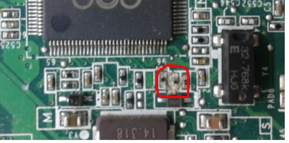

    btw i found corroded resistor i think near the ocillator Ive already replaced it and cleaned with thinner
    still same result do i need to reflow southbridge chip?

          I already replaced
          ram hdd and dvdrom sir
          still same result,
          on the picture above Ive only replaced the corroded part the color black.
          • selldoor
            Slow Learner
            • Dec 2010
            • 7870
            Re: Hp dv5-1235dx cant install os
            Dont understand?
            What has happened inside the red circle
              i dont know either i thought this was the problem so i just cleaned and replaced this but still my problem is not solved
                  Are you saying the middle component in the red circle is the resistor that
                  was corroded and you have replaced?
                  Can you do a clear close up picture of it.

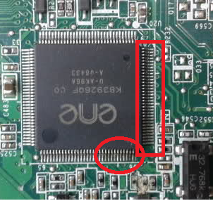

                        • fddizon
                          • Sep 2011
                          • 555
                          • Philippines
                          kabayan,
                          flux and solder ene chip pins in circle.
                          let us know how did it go.
                          (saan ang shop mo?)
                          regards

                              yes kabayan di ko pa na try tanggalin ene chip nilagyan ko lang ng flux then pinagalaw ko konti ganun padin eh baka pullout ko nalang yung board
