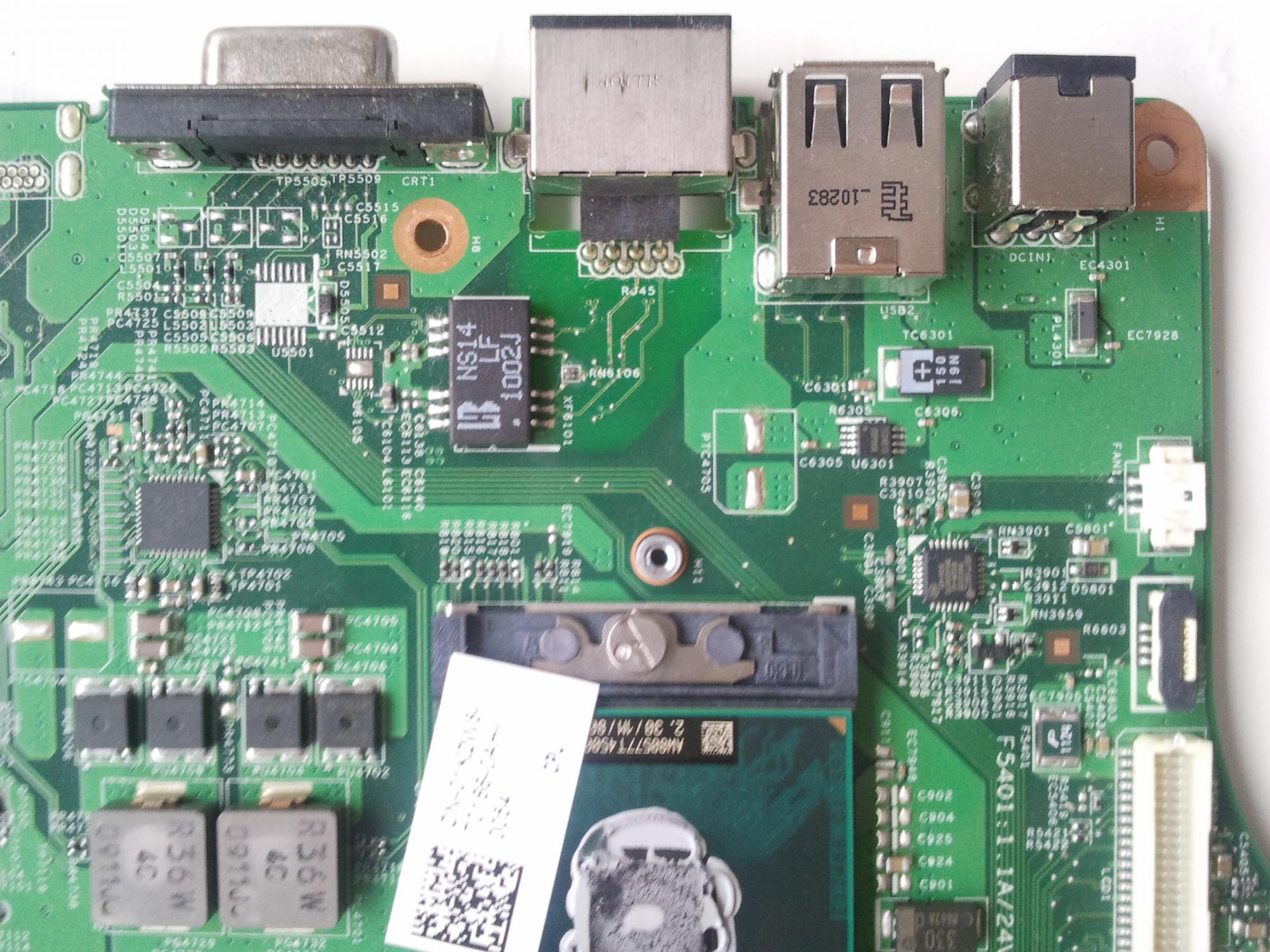

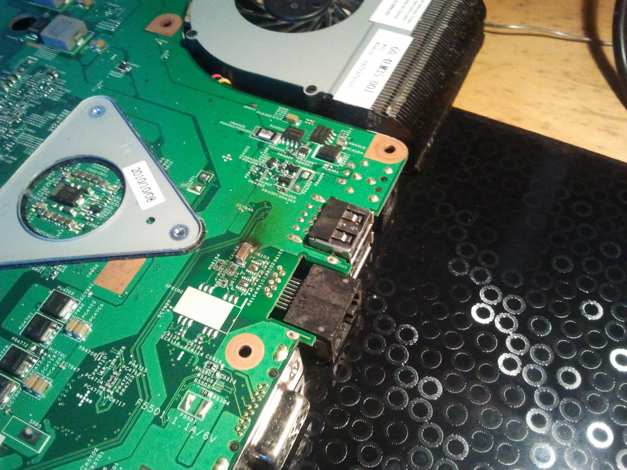

      Re: Dell Inspiron N5030 external power idea

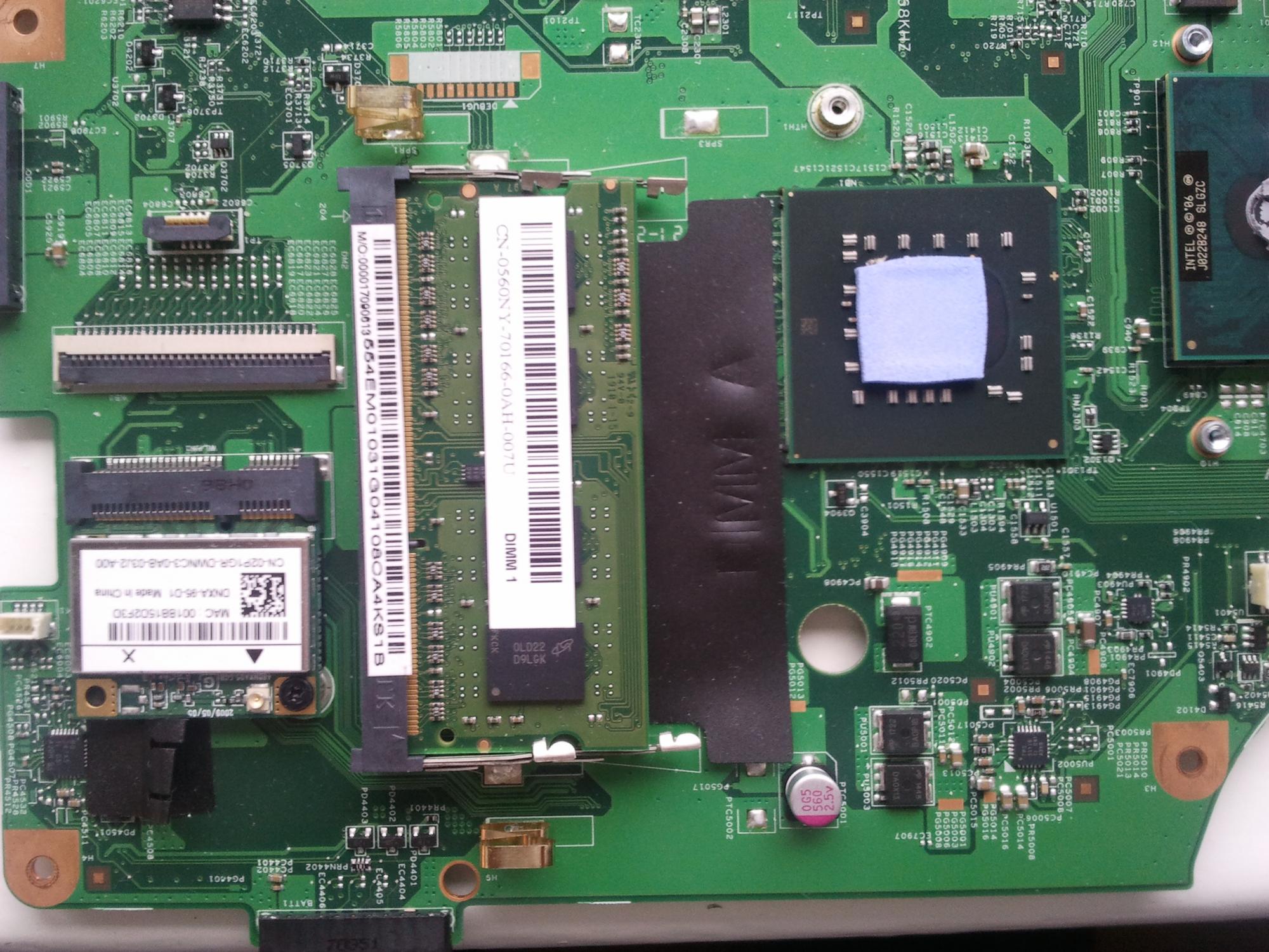

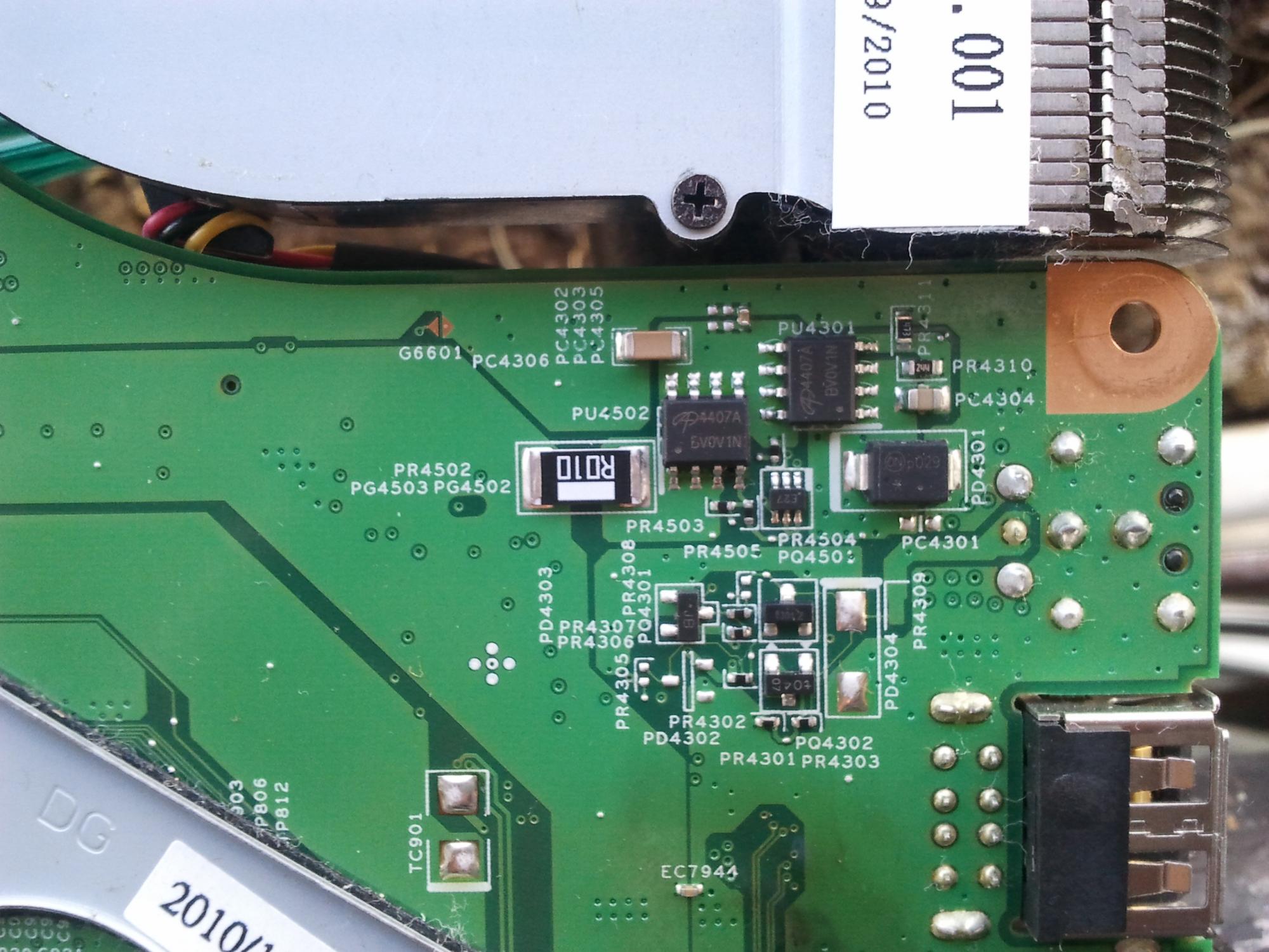

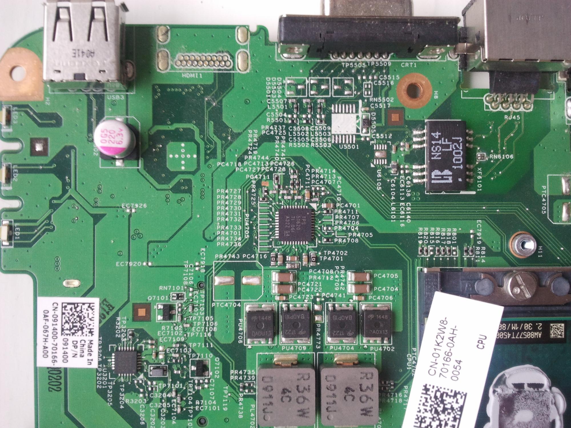

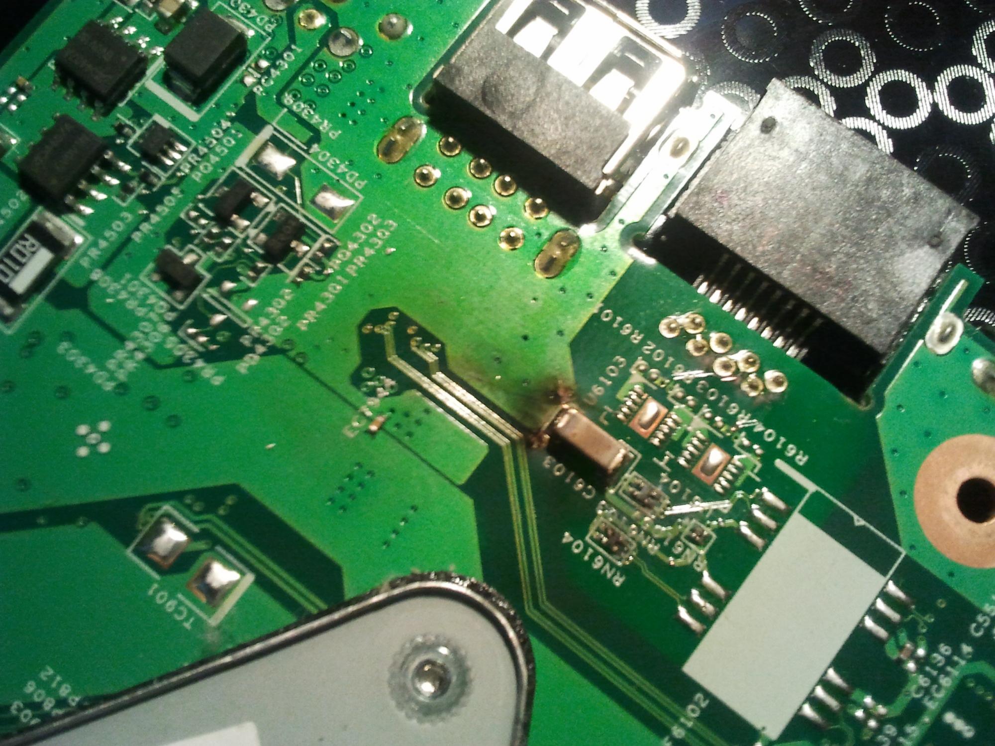

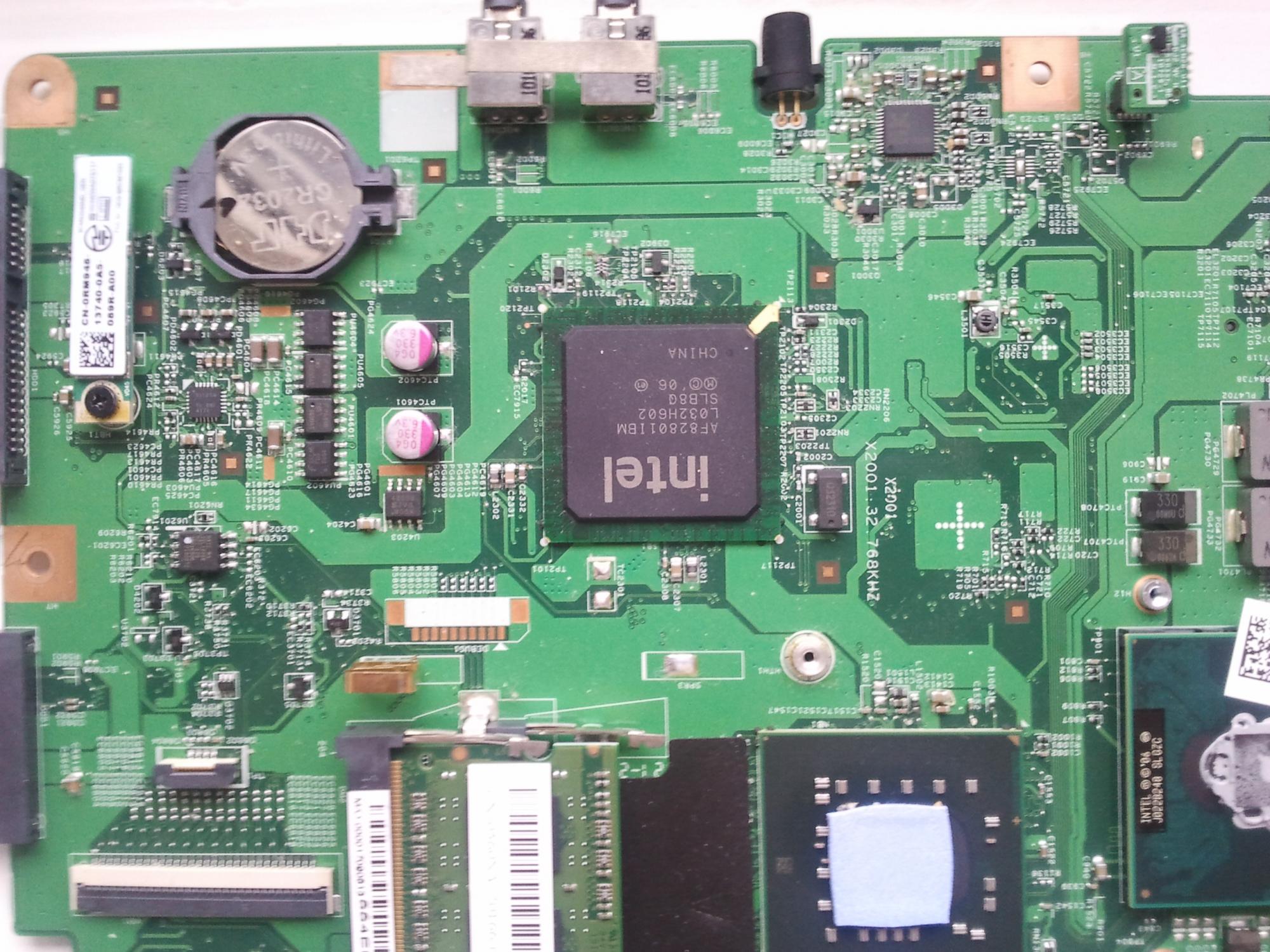

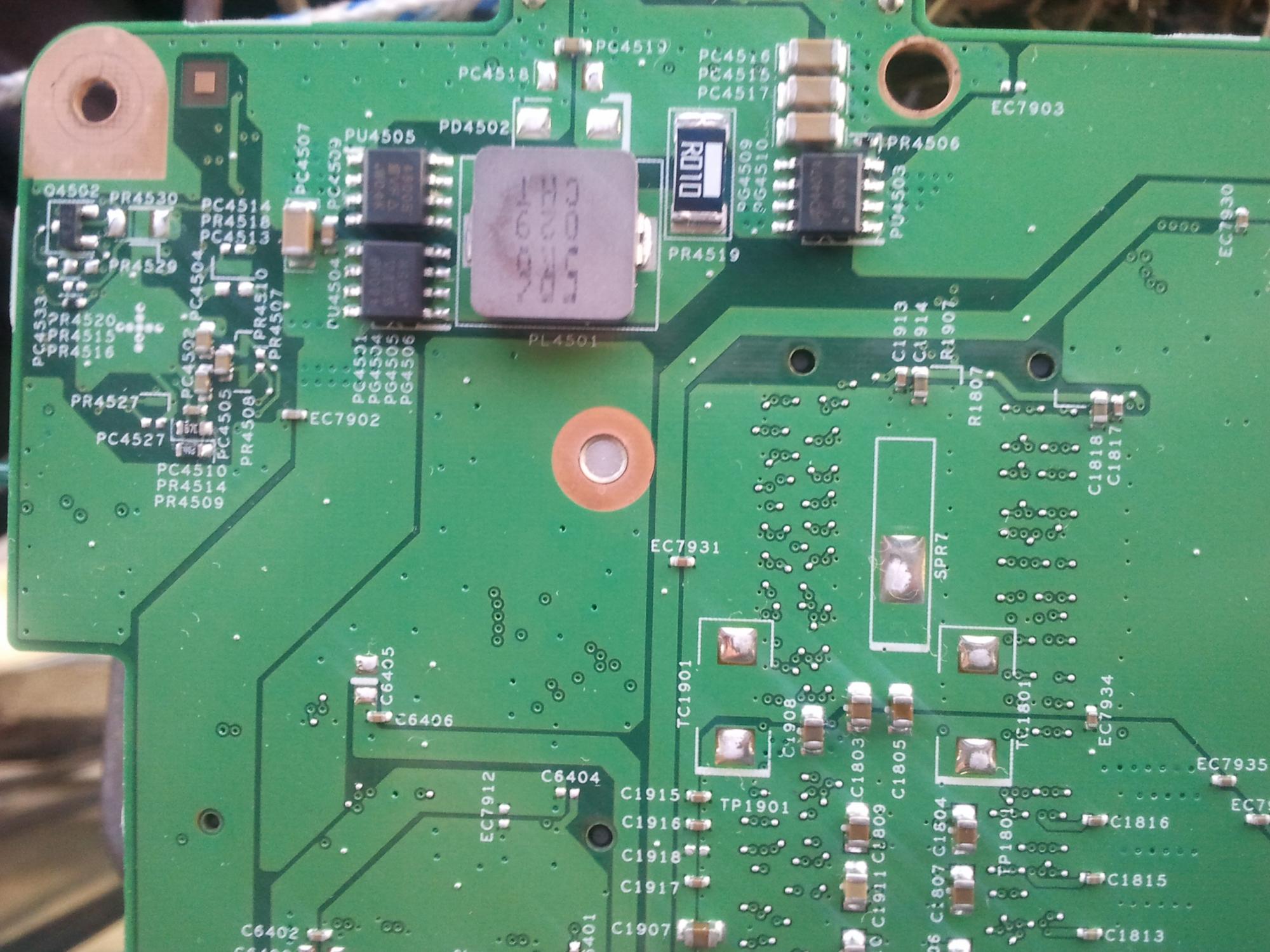

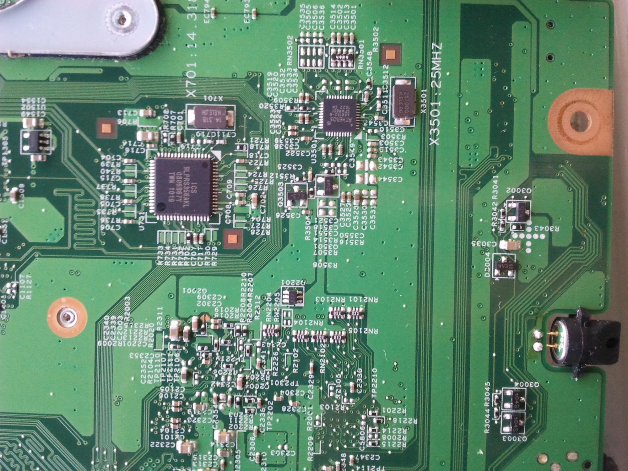

      Ok, here are the pictures. Mbo from upper side looking good, nothing unusual. Everything clear. Mbo from down side got burned in one place. That is fuse i guess? Whats its rating? Can i connect it directly with wire? Suggest me what to do. Got good solder iron, got little experience, got multimeter.

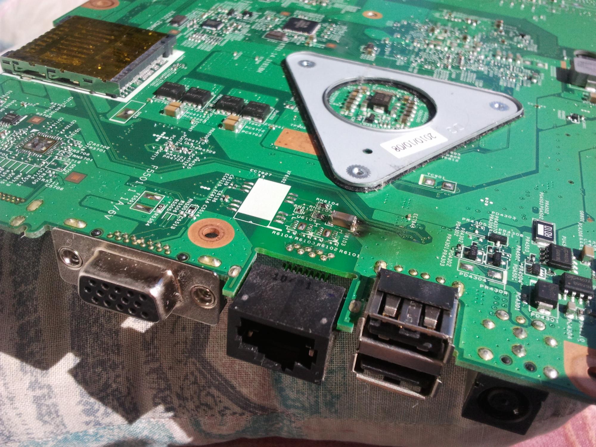

        I can't read the numbers on any of the chips.
        Please try again with the pictures, this time with the camera perpendicular to the board and the edges aligned with that of the board.

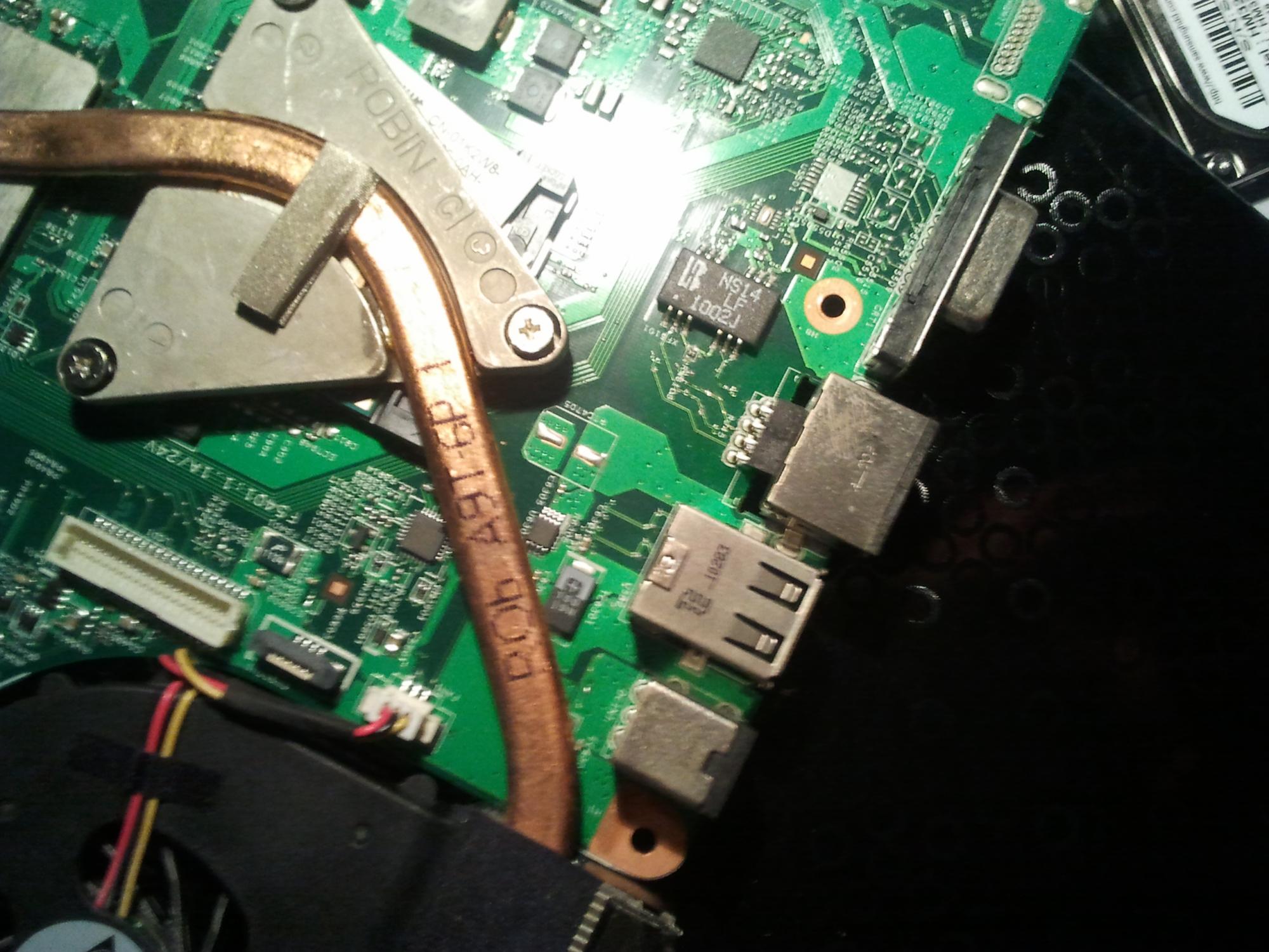

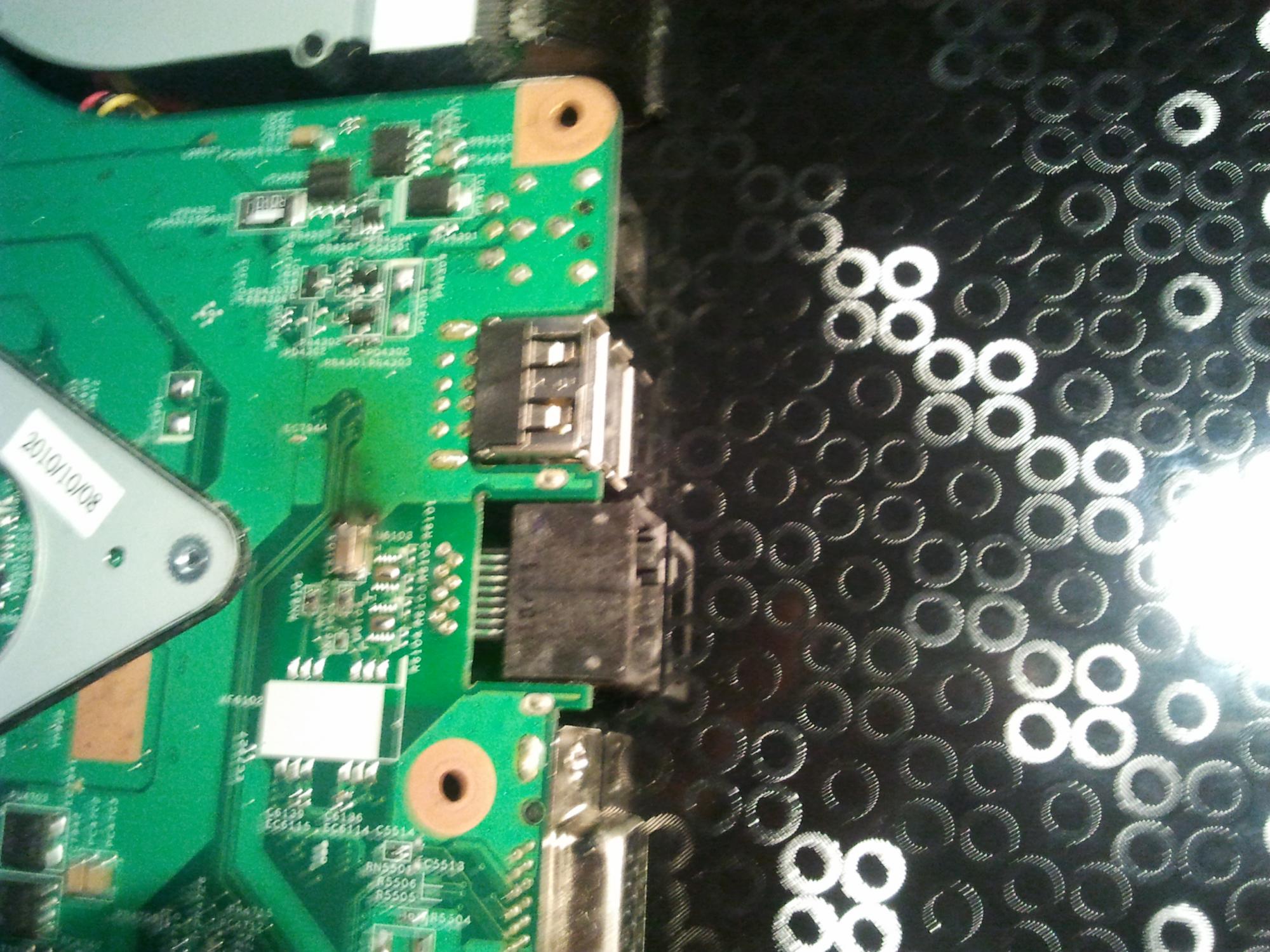

          I hope it's better now. Cant get better than this, pics are taken with mobile phone SGS i9000. Dont have better camera here atm but if needed will borrow.

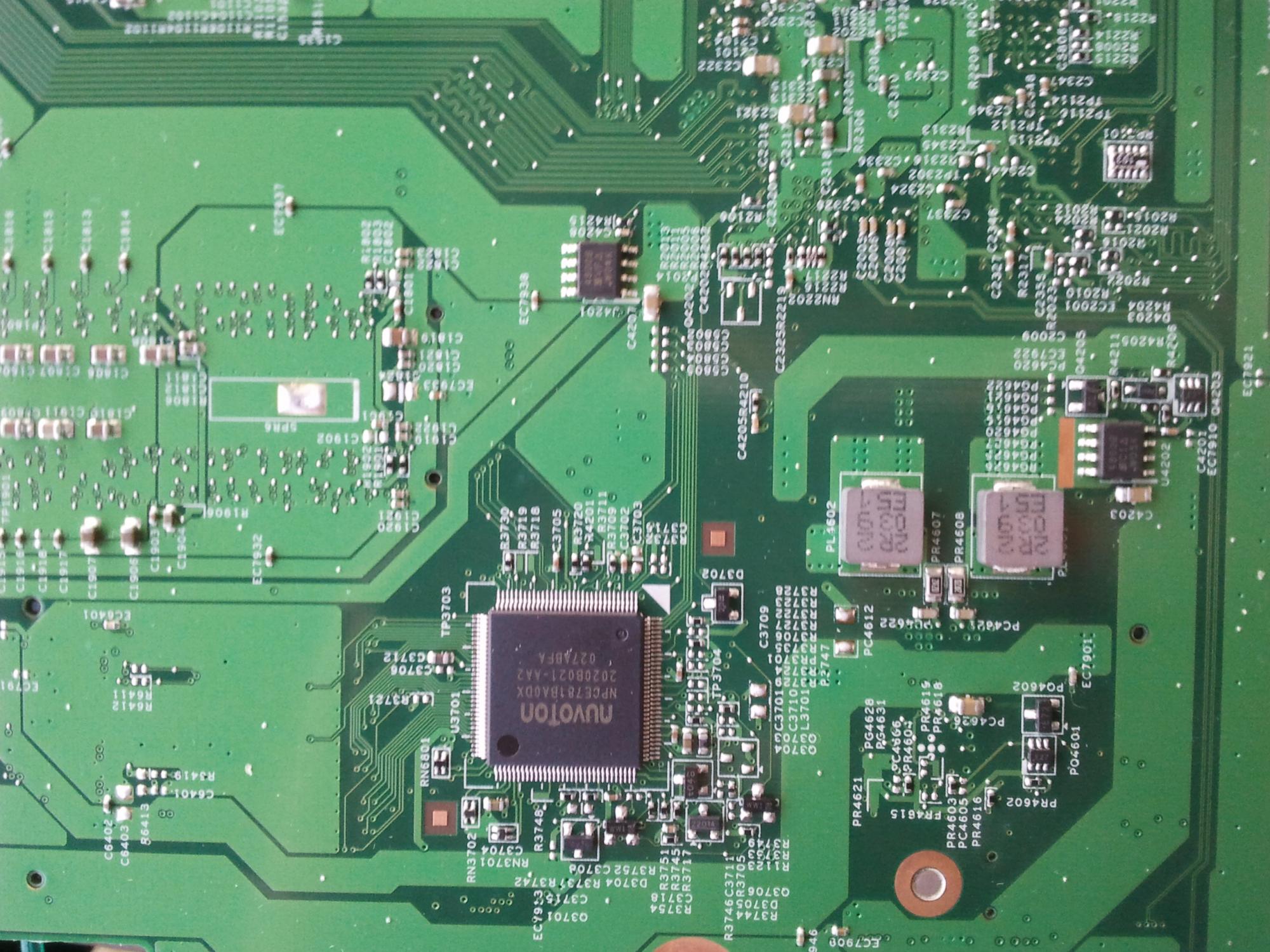

            The first one is great. I can see the numbers on the MOFSETs.
            The other two are useless.
            Take pics of the other areas of the board in the same way as the firstone.

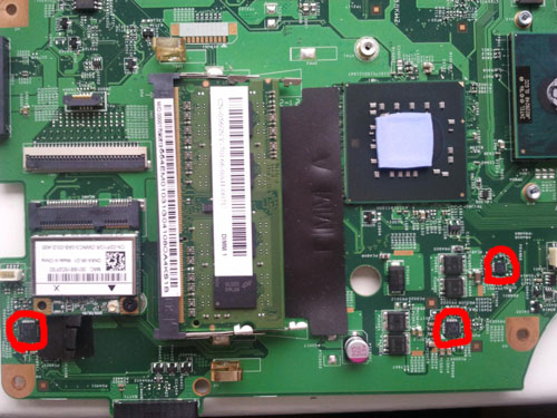

              Whole board from down side.
              • b700029
                Banned
                • Sep 2010
                • 640
                Did you remove U5701 and if so, what was it?
                I see all the power MOSFETs, the network chip (Atheros AR8152), clock generator (ICS 9LPRS356AKL), and embedded controller (the Nuvoton), but not the battery charger/system DC-DC converter chip. Can you give pictures in the same way for the other side?
                  No, I didnt remove anyting. All is as it was.

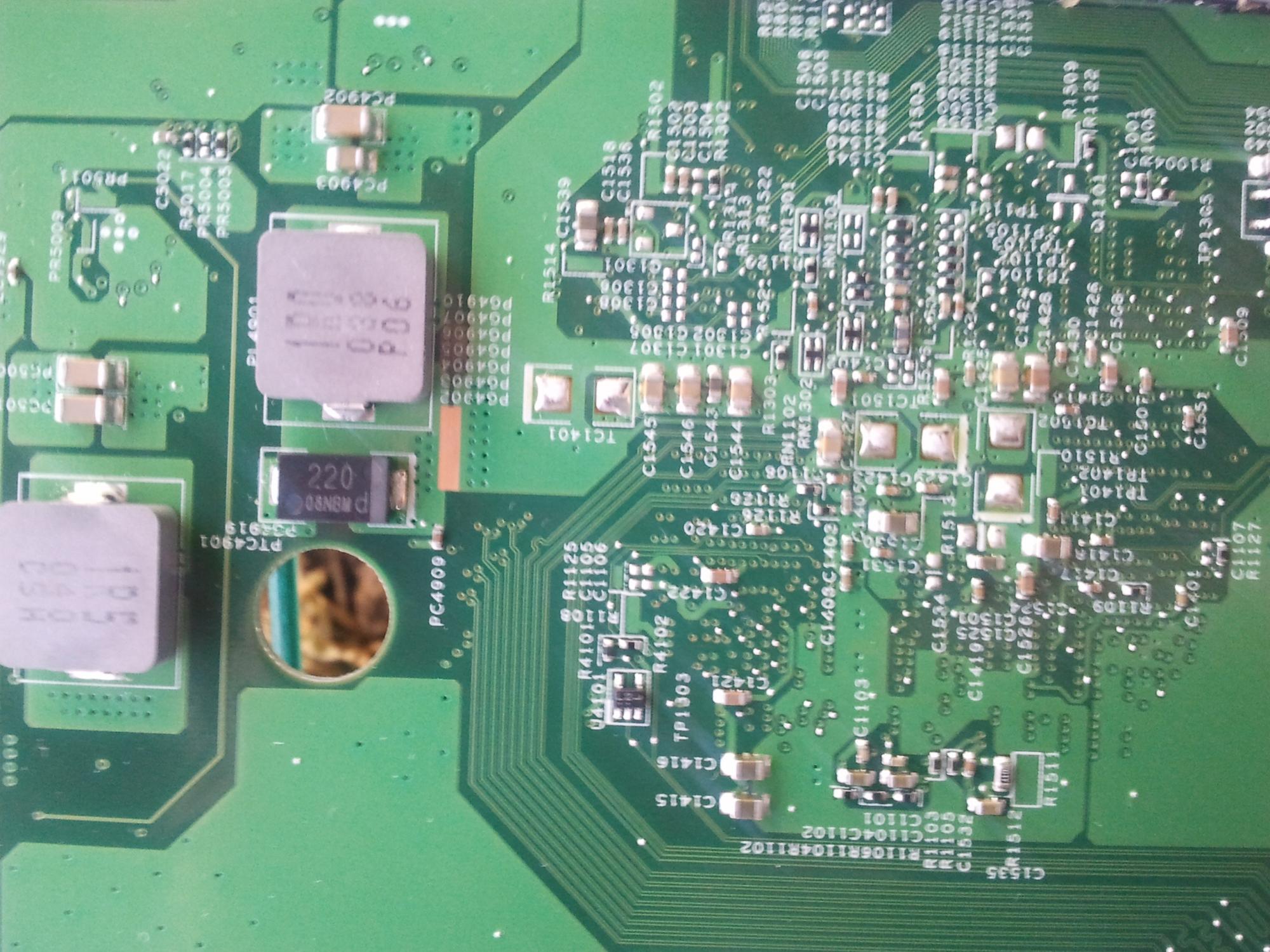

                  • Ant3G
                    • 24

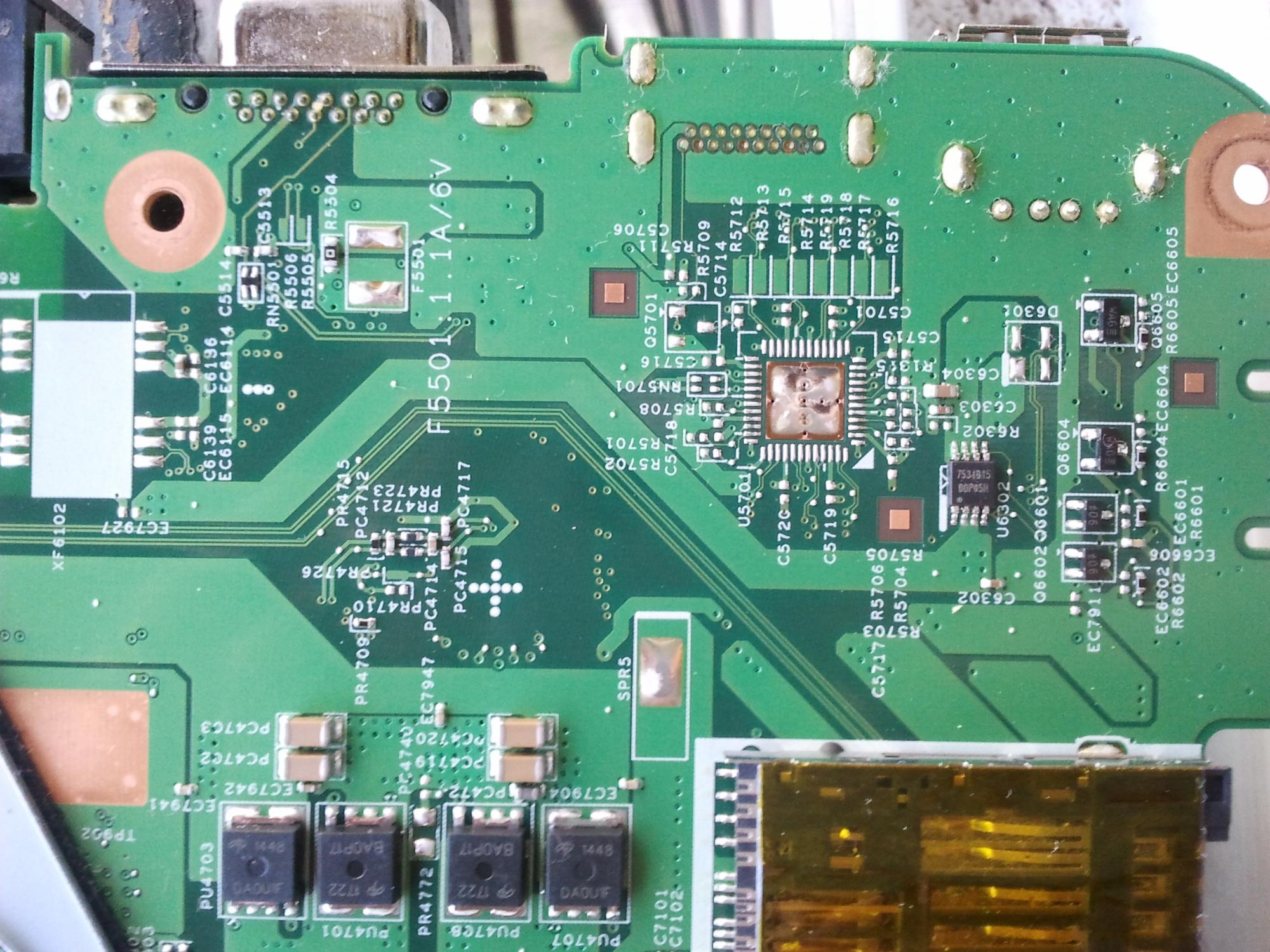

                    Couldn't edit post. Delete upper post if it's against rules (double posting).

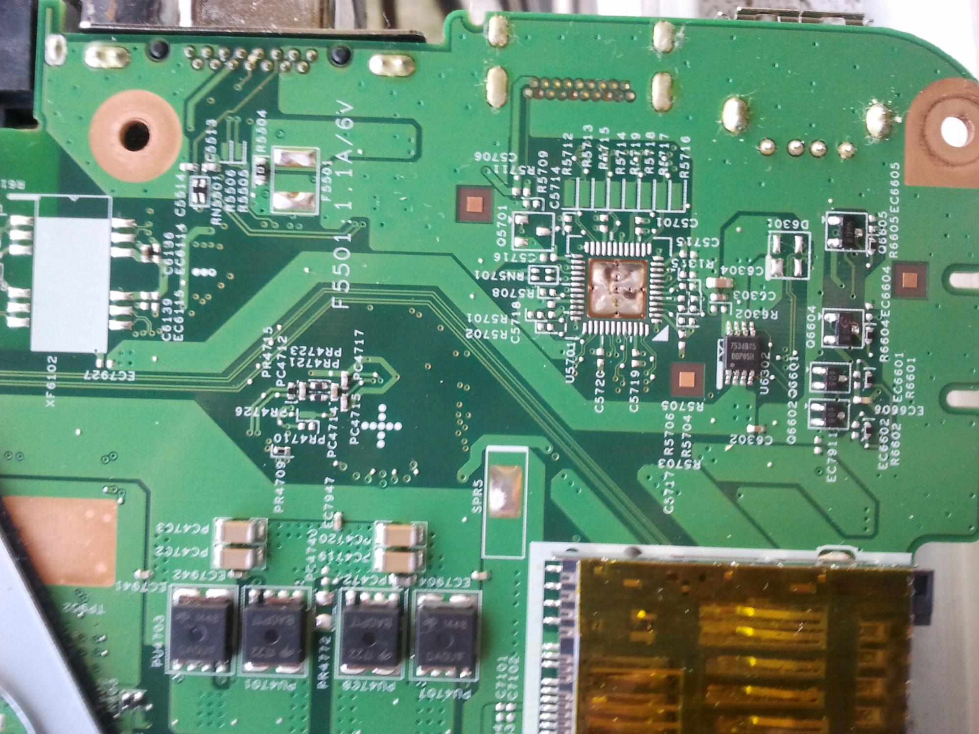

                    Pictures of up mbo side.
                      With the exception of the TPS51620 (vcore controller, 5V input, not too useful for what you want to do) I can't read the ICs. You will either need to provide clearer pictures or read what these say.

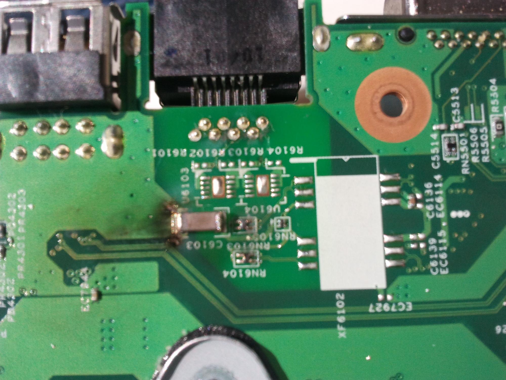

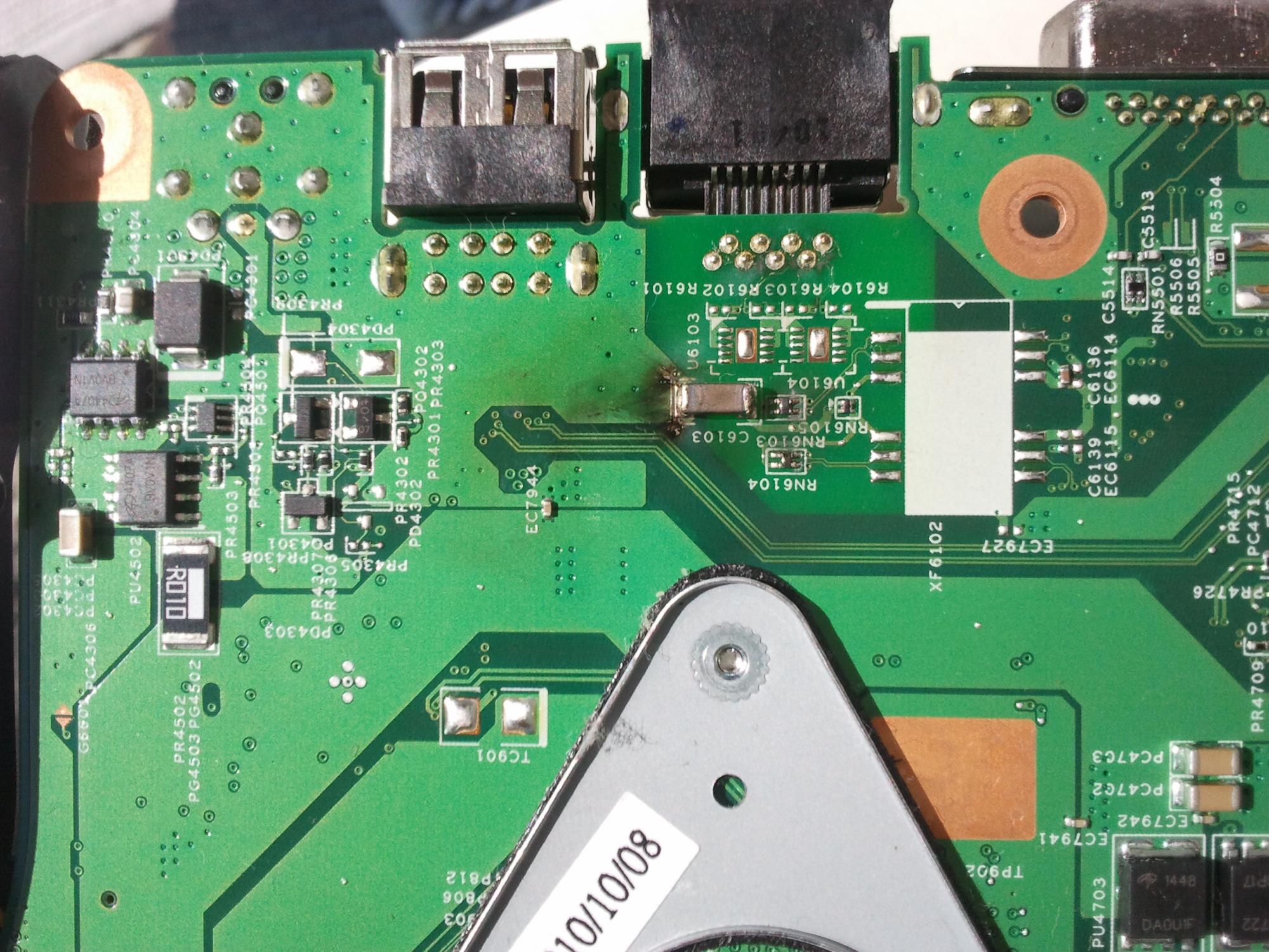

                        Nope, that's a ceramic cap. You can tell by the board markings (the "C" in C6103 stands for capacitor).
                        Ceramic capacitors like to short out when they die. Remove it from the board and test it with your multimeter using the lowest resistance setting (usually 200 Ohm on manual multimeters). You should get an open circuit across the cap terminals. If you don't, post what readings you get.

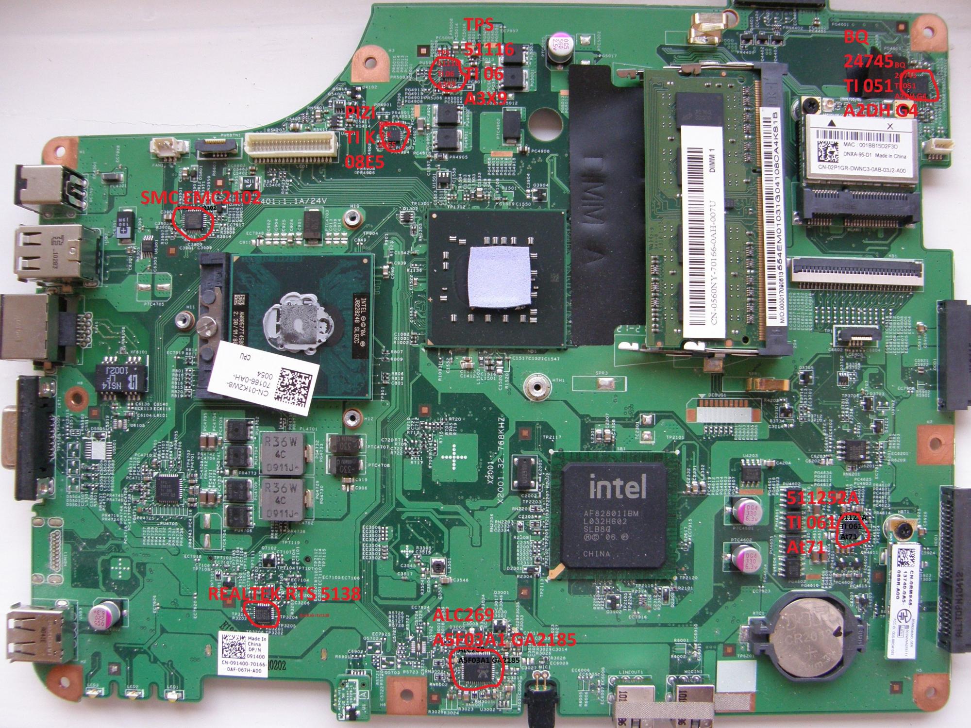

                          Ok here are names.
                          I dont get any ohm/esr readings from capacitor.
                            Thanks, now we know what you're working with.
                            Googling the part numbers lead me to the N5010 schematic which seems very very similar to yours. It's good enough to follow when checking the components, at least. Go to page 45 and start tracing power.
                            TPS51116 - DDR supply
                            TPS51218 (likely match for the PIZI part) - 1.05V VTT supply
                            TPS51125 - main system supply (in the N5010 it is replaced with the RT8205, apparently a Chinese clone with the exact same pinout.)
                            TPS51620 - Vcore supply (in the N5010 it is replaced with the ISL62883, possibly having the same or similar pinout.)
                            BQ24745 - battery charger
                            EMC2102 - fan controller
                              Is that out of circuit or in circuit?
                              Also, what exactly do you mean by no reading? Zero Ohms (as in 0.000) or open circuit (on auto-range multimeters, open circuit is displayed as "OL" and on manual multimeters it's "1" on the left side of the screen)?
                                I get reading like there is no contact. I get "1" at display while multimeter is not connected to anything, and when i connect, its still 1, no change, no contact. Same thing on board and also when measured board when cap was removed.
                                  Just changed cap on board and still same problem. But I found something. When power adapter is connected to MBO, USB and power connectors are getting hot. What that means? All voltages near ac connector are low, <0.5V
                                    That means there is a short somewhere. Look for hot component(s) on the board.
                                    A low-voltage high-current power supply will be useful for tracing shorts.

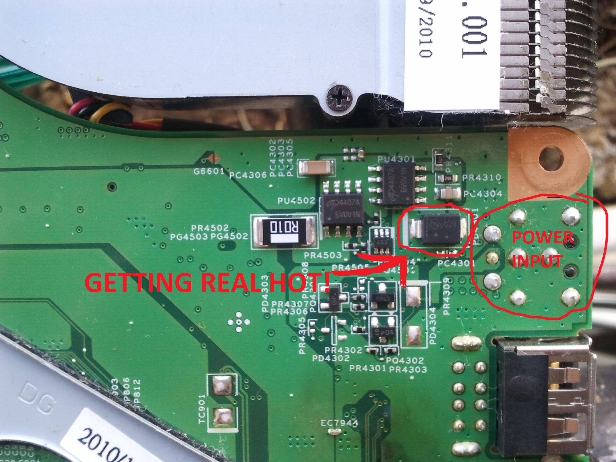

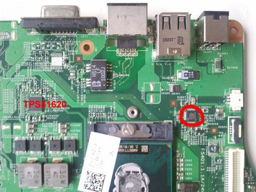

                                      I think I will abort fixing this board. Seems impossible to me to find where is it shorted.
                                      Could this component be the cause? Its so hot that i cant hold finger on it.
                                        That's just the input reverse-polarity-protection diode.
                                        It getting hot only shows there is a short somewhere.
                                        You need a low-voltage current-limited supply, a multimeter, and soldering iron to find it.
