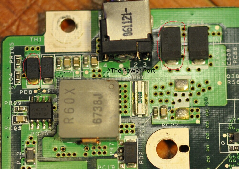

    What is this electronic component?
    Can you please help me identify this electronic part?

    Looks like a cap to me

      Re: What is this electronic component?
      Actually, as it says there on the board "PD", I would say both are some sort of power diodes.
      The one on the left could be this one:
      FAIRCHILD SEMICONDUCTOR - SS34 - DIODE, SCHOTTKY, 3A, SMD, DO-214
        It looks like every component designator (R = resistor, C = capacitor etc.) is preceded by a 'P' for some reason.
        Just noticed the one on the left, I imagine that will be a diode.
        Maybe the 'P' is for Power board...
          uhm interesting.
          Now, Am wondering if a bad capacitor could be causing the power to continuously recycle -causing a strange humming sound. It is a very low humming sound however.
                    Well, it is pretty convincing I mean. The "P" only show up near the battery area and the ac adapter socket area.
                      That, if I'm not mistaken (At least the one on the right), is a tantalum capacitor.
                        Ok very nice. Now does anyone know how to read the codes on the capacitor that tell you what the ratings are? I might think about replacing them
                          Can you take a caliper and measure them?
                            Caliper? sounds high tech. I don't really have a caliper but i think i can measure it in mm with an ordinary ruler. It is 8x5 mm.
                              So I'm looking at the two big ones on the right-hand side, the ones with the markings:
                              330 6DS7 D...
                              I looked at a few pictures from various manufacturers, I just can't find anything. I'll try to keep looking. Where did this come out of?
                                Obviously,
                                PQ= Capacitor &
                                PD= Diod.
                                  PD = Power Diode
                                  The others are PC.
                                  Which I think must mean > Power Capacitor.
                                      It looks like a Tantalum cap to me as well. Best solution is to check it with a multimeter out of the circuit - if it shows open circuit both ways when you measure it for continuity, then it's more than likely a capacitor. If it shows a [continuous] reading one way but not the other, then it's a diode. If it shows short circuit regardless of which way you test it, it's obviously a bad component.
                                      Also, Tantalum caps usually commit a pretty nasty suicide when they go bad (i.e. they burn out - literally), so if it's a Tantalum, it's unlikely to be bad if it reads normal.
                                      With that said, I would suggest you check the rest of the components in the charging circuit - particularly power rails being shorted to ground. The buzzing could be because there is an overload in the charging/power circuit somewhere.
                                      Originally posted by masud
                                      PQ= Capacitor
                                      No.
                                      PQ is for transistor. Just ignore the "P" prefix and you can see that this board has standard marking. C = capacitor, D = diode, R = resistor, Q = transistor, L = inductor.
