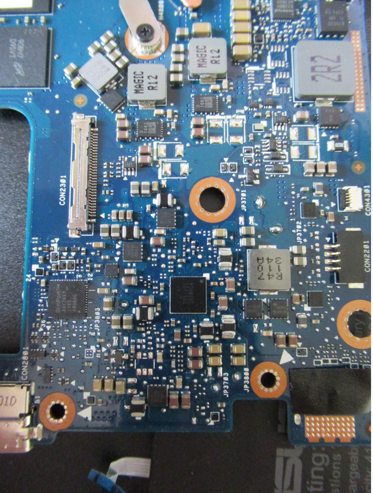

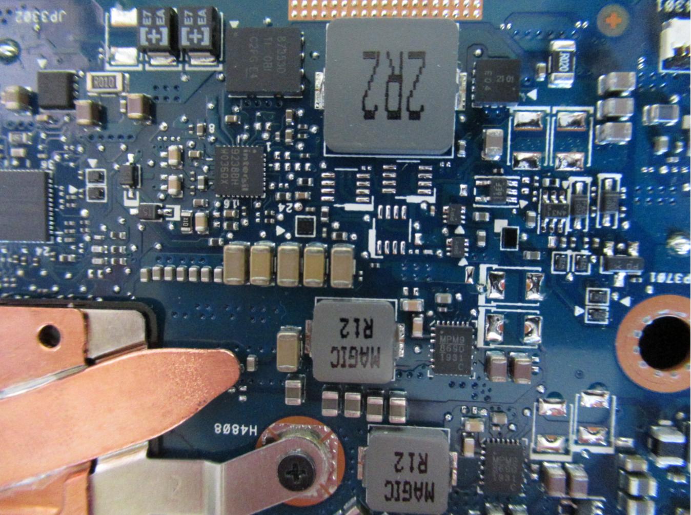

        I'm really struggling to identify the Mosfets - there are very few 3 terminal devices on the board. I can see an Intersil ISL9238 which is an NVDC interface but nothing anywhere near it that looks like a Mosfet to me.
        Two pictures uploaded and happy to provide more.
        Any advice very welcome please.

          Yepp, NVDC. And since you can even measure 3.3V and 5V supplies there is probably no issue in the charging circuit, but later in the sequence. I recommend to share a overview of the board instead. Resistances and voltages of all inductors of the board present. There might be (partial) shorted power rail further down the sequence

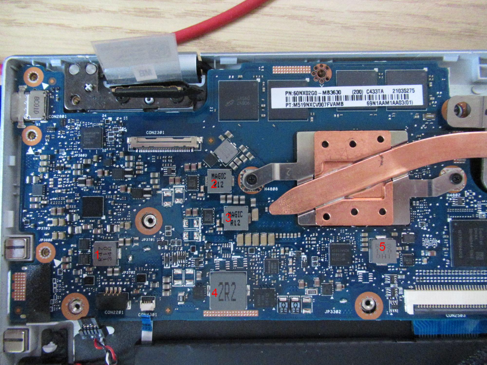

            I'm reasonably sure I can identify 6 SMT inductors here
            Inductor # / Volts / Ohms across / Ohms to GND
            1 / 0 (< 5mV) / 0R1 / 330k
            2 / 0 (< 5mV) / 0R1 / 8R2
            3 / 0 (< 5mV) / 0R1 / 12R
            4 / 5.14 V / 0R1 / 53k
            5 / 0 (< 5mV) / 0R1 / 24R
            6 / 0 (< 5mV) / 0R1 / 630R
            (#6 is the one not marked in the photo, close to #2)
            Volts measured wrt USB-C shell, with battery connected and USB-C high current charger connected.
            Ohms measured with charger and battery disconnected
            BTW the reverse side of the board has very few components mounted.
