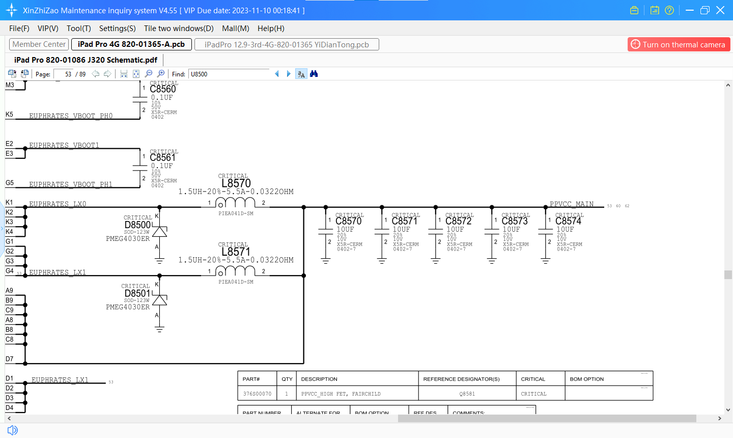

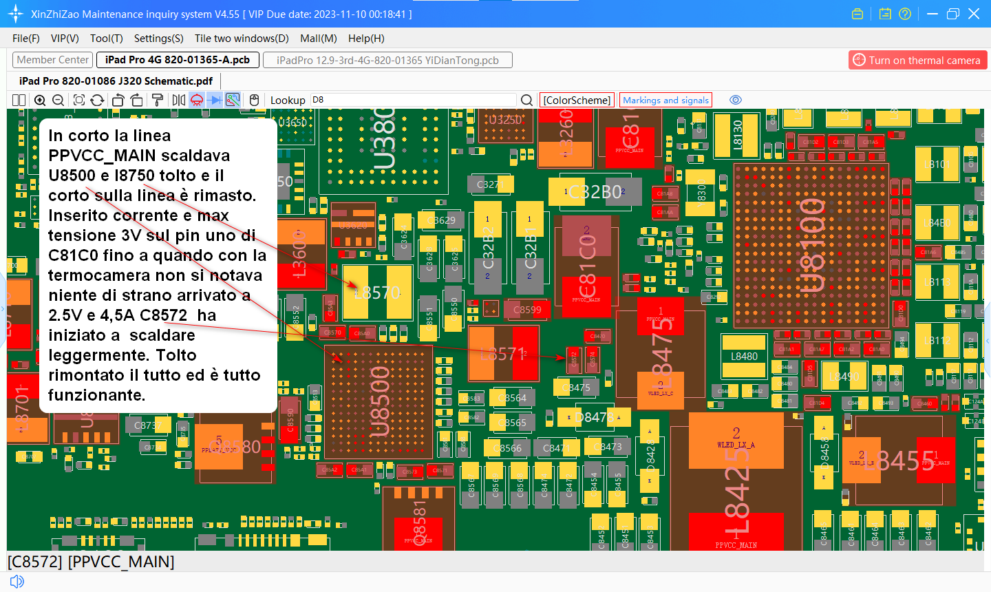

    Ipad A1876 No power
    The PPVCC_MAIN line was shorted, drawing from USBC 0.450 MA, the U8500 was heating and the 8750 was removed and the short on the line remained. I inserted current and max voltage 3V on pin one of C81C0 until, with the thermal imaging camera, nothing strange was noticed. Once it reached 2.5V and 4.5A, C8572 started to heat up slightly. Once removed, everything was reassembled and everything works.
