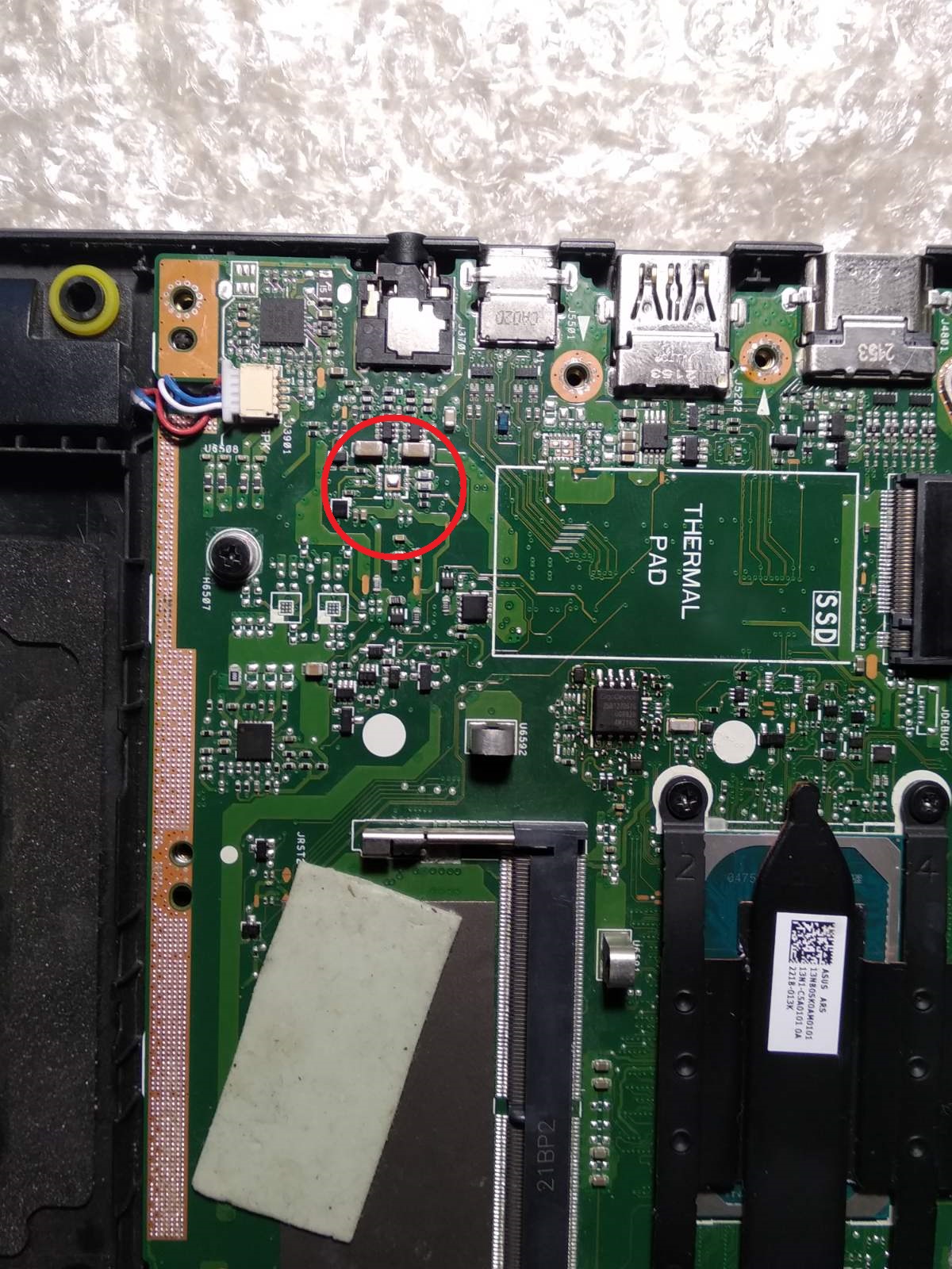

    Hello!
    I need help identifying part name of IC in QFN16 packadge under SSD, near audio jack and 1206 capacitors (marked on photo). Unfortunatelly there is no refdes of that part so that is only info I can provide. I took boardview here on forum for revosion 2.0, but it doesn`t have this part at all, not just moved. Maybe someone have relevant schematic or BV.
    Notebook was poured with coffee and someone already tried to fix it but as usual made jusy worse. I`ve restored all mobo defects and now it powers up, starts OS booting but hangs on OS logo. I believe missing part may be an issue, while it must be installed anyway. Part probably was missed in previous service, because it was removed gently witout a trace, but with all surrounding parts present.

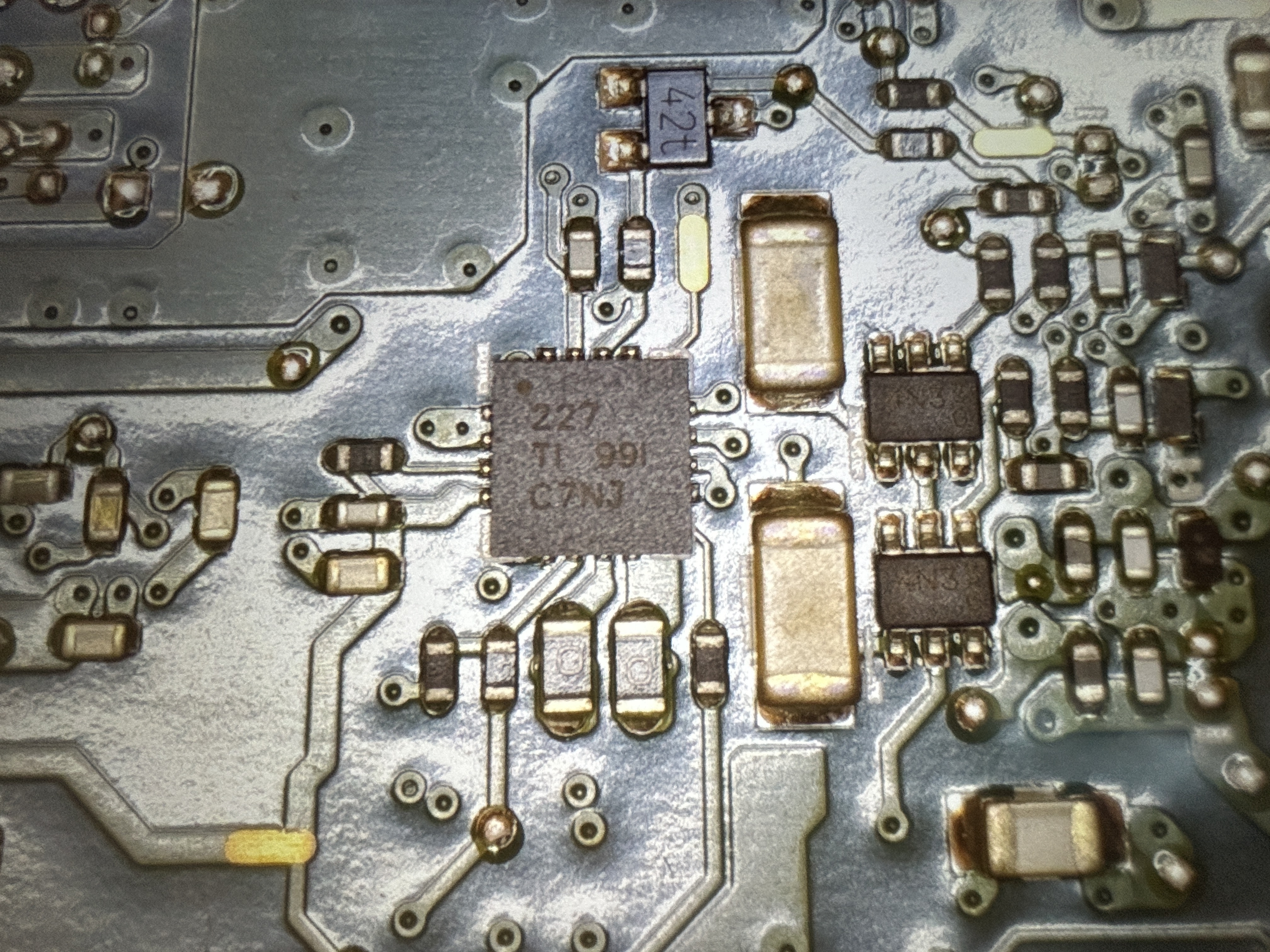

    Hi ,
    Did you managed to find the component missing on your laptop ?
    I have an Asus Vivobook K513E Intel I5 11th gen 16Gb ram , don't know if is the same MB but I will make a photo on that location
