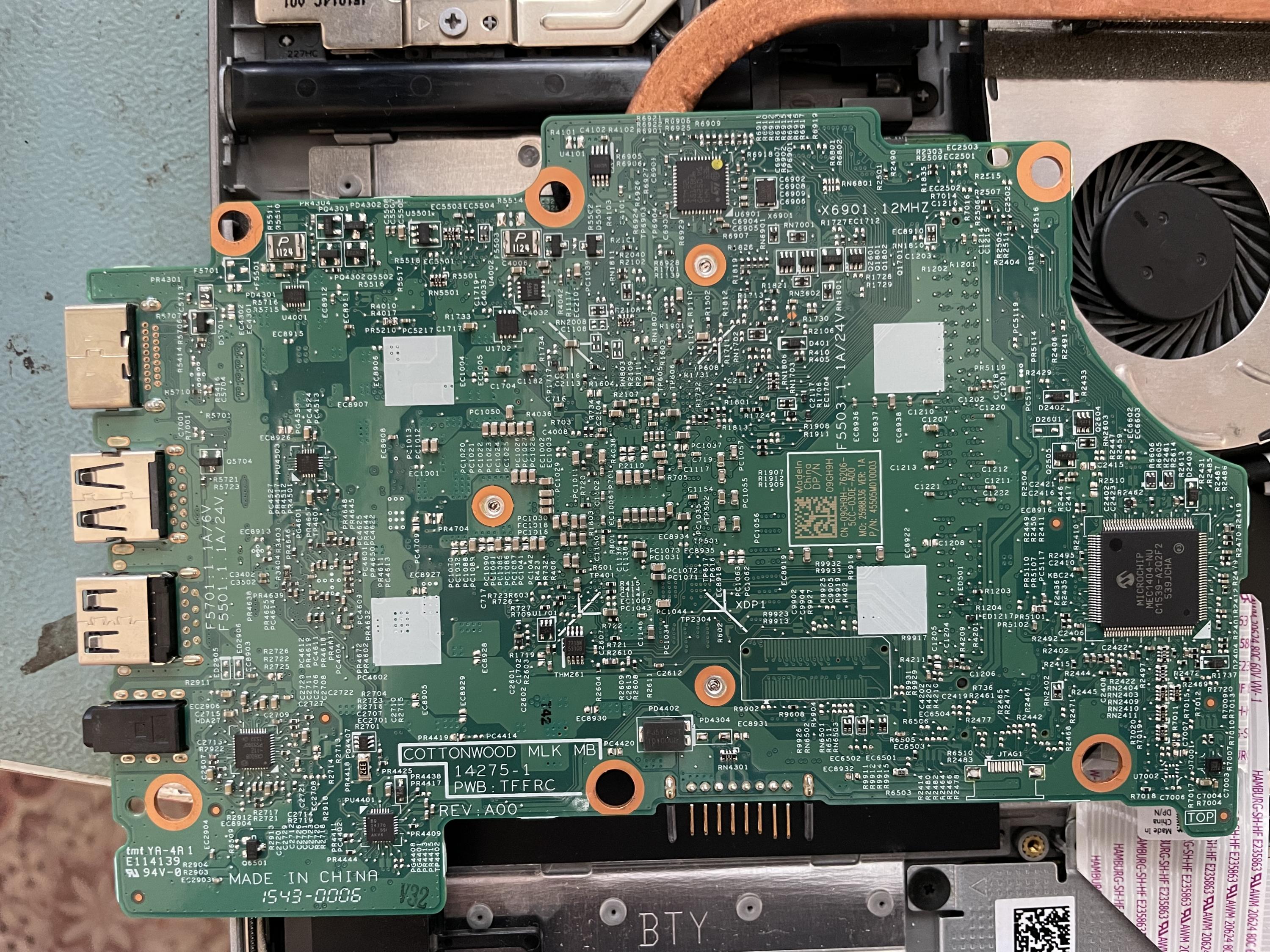

    I have here this laptop. When power button is pressed LED is blinking 2 amber and 5 white - problem with memory. And fan is running at full speed, CPU is hot little bit. I tried 3 different modules of DDR3L memory but problem persist. I tried 4gb and 8gb RAM. Slot looks fine.
    1.xxV voltage on ram is present. No water damage.
    Laptop model: p57g002
    Motherboard: cottonwood mlk mb 14275-1 pwb : TFFRC
    Any idea please?

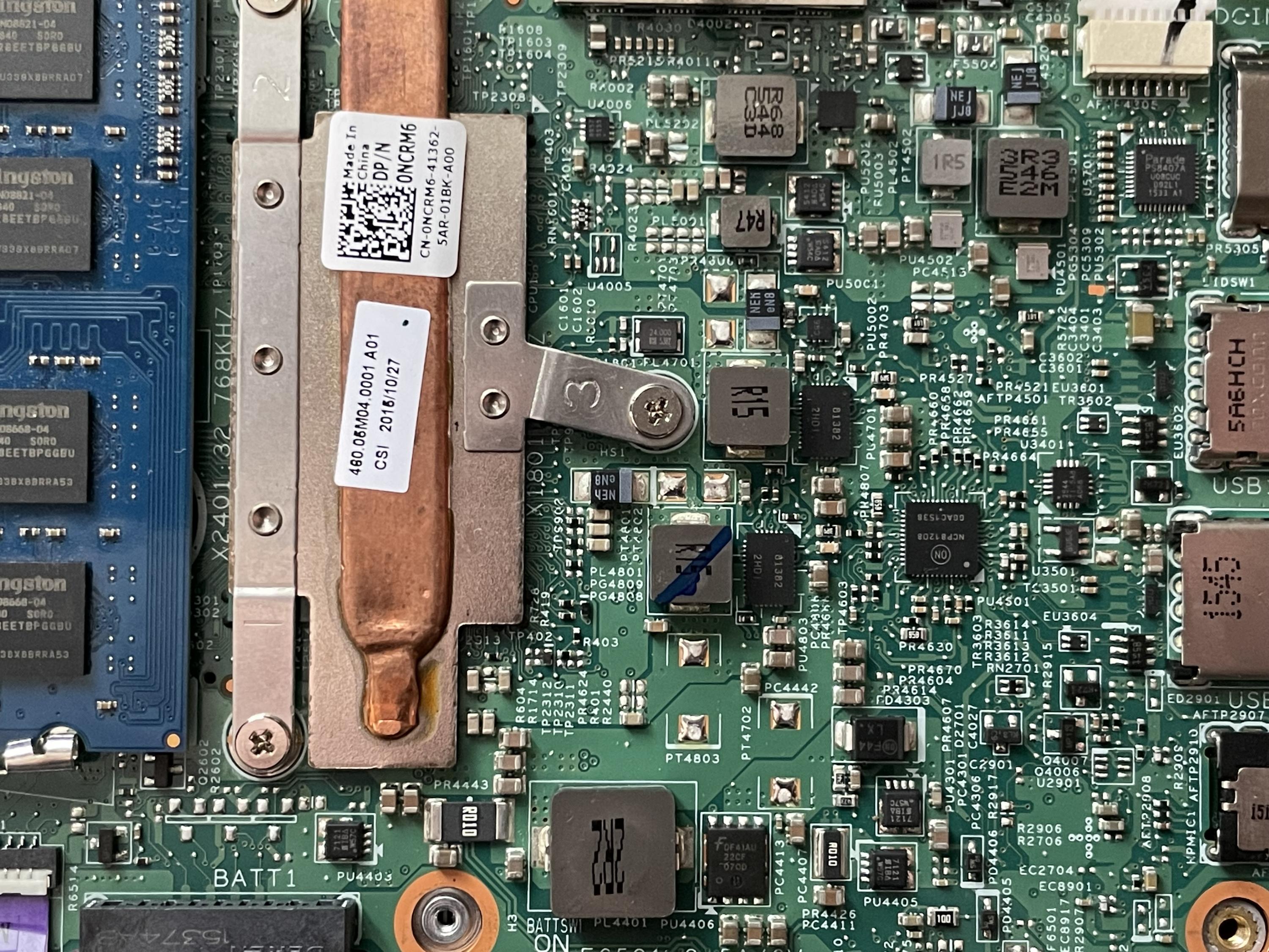

          Re: Dell 13 7359 not post, only led blink
          What voltages are missing on the big gray coils?

            Voltage is not present on PL4801 - blue mark on photo.
