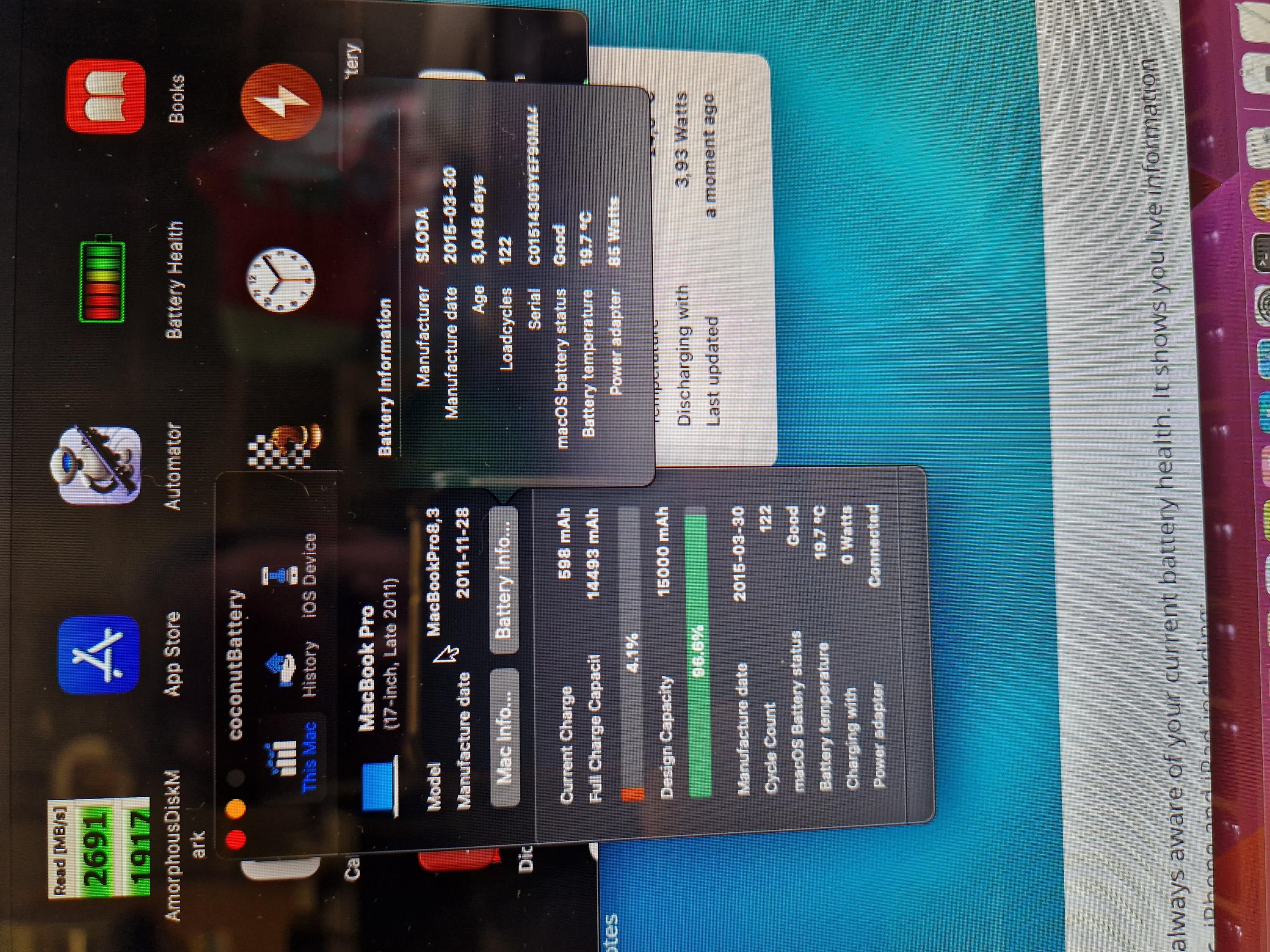

    Got a 17" macbook pro which I suspect has been damaged by a charger with an iffy magsafe connector (3rd party).
    The battery reports correctly in macos and windows, shows manufacture details etc, condition normal, health status good but always says not charging.
    Magsafe led is always green, never orange.
    Without battery connected I get a voltage at the battery power pins, with it I only see the battery's voltage. I assume this means the SMC is preventing charging?

          They all seem fine and without the battery connected I'm seeing the correct charging voltage.
          I've checked coconut battery and though the battery hasn't locked itself, the capacity is less than 4% so I'm just thinking it's a crap battery. Oh well.

            Yes, could be crap battery. As noted by @Piernov in numerous articles, 99% of the time, it is the battery to blame.
            Order one to test with Amazon from a reputable vendor and return it if it is not required.
            Since you can extract the vitals - fake or real, the SMbus lines are working.

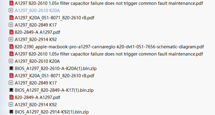

              Good morning
              I have an Apple A1297 with components that burned, 5V USB in this case, I am looking for the diagram and the boardview to repair it. thank you​
              • mon2
                • Dec 2019
                • 14515
                Pasglop - it is best for you to start a fresh thread with your details. We also require the 820-**** details from your logic board that identify the PCB model inside of your unit. Respectively, locate the USB connector and nearby this connector will be the USB load switch which act like solid state relays. Often they get killed. Very common parts to source and replace if you have lost the VBUS rail = +5 volts. You should also be able to confirm the damaged part through a visual inspection of the USB load switch.
                You may also have a burnt EMI filter that is in series with the USB load switch to the USB connector for the VBUS power rail. This filter can burn out if there is an excessive current draw or similar event on the USB port.
                Here are the many versions of this logic board so need the specifics of your board:
