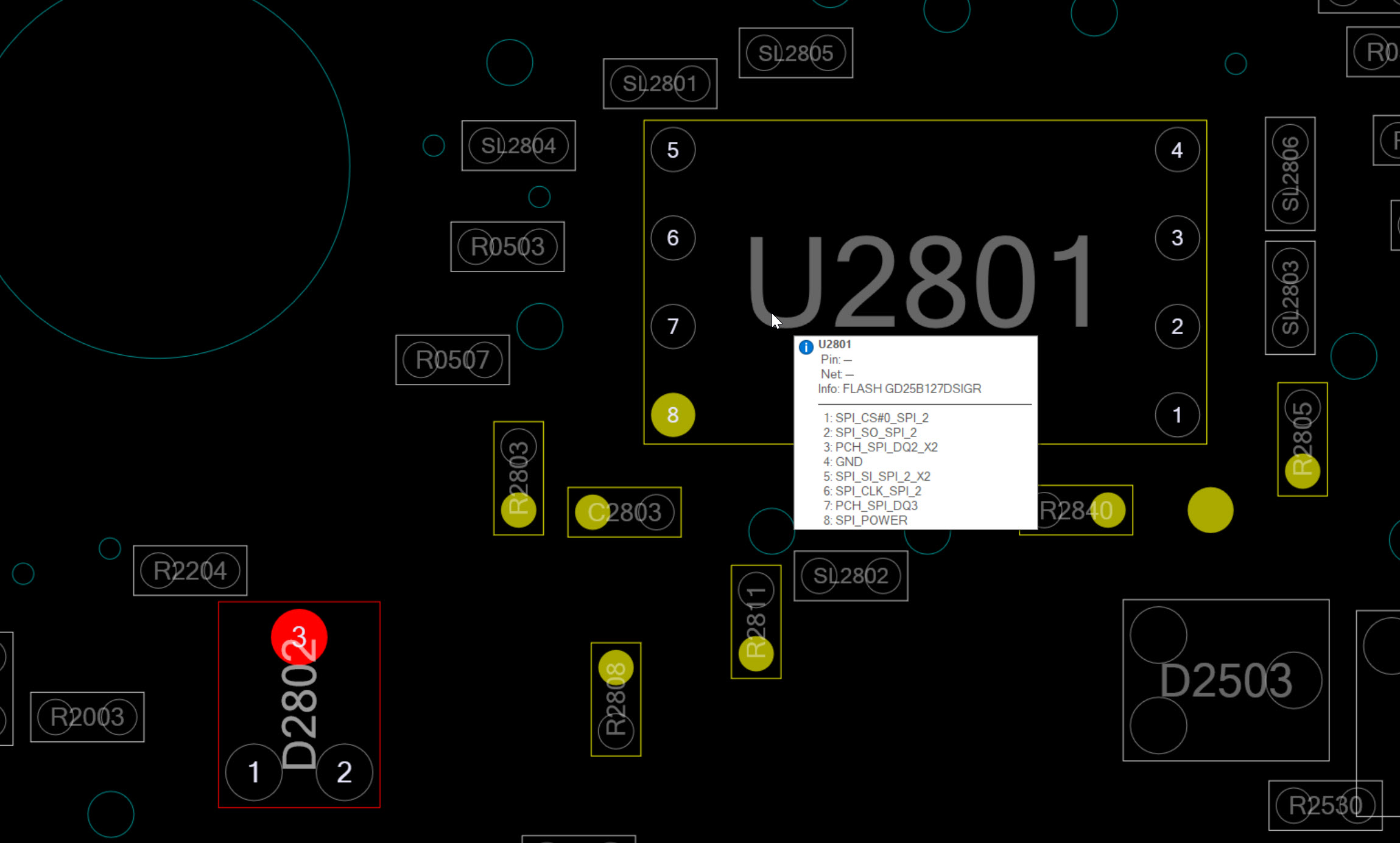

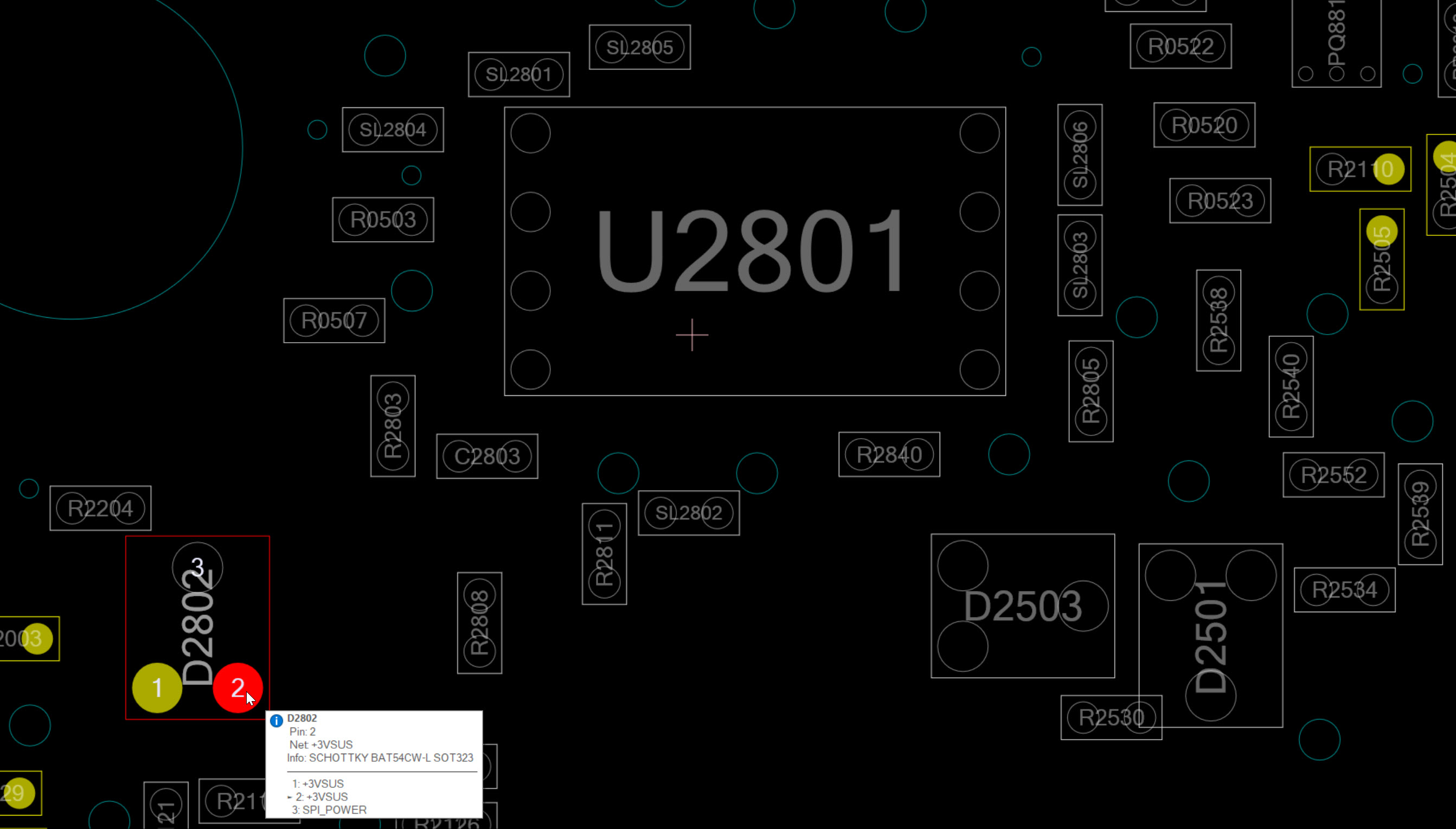

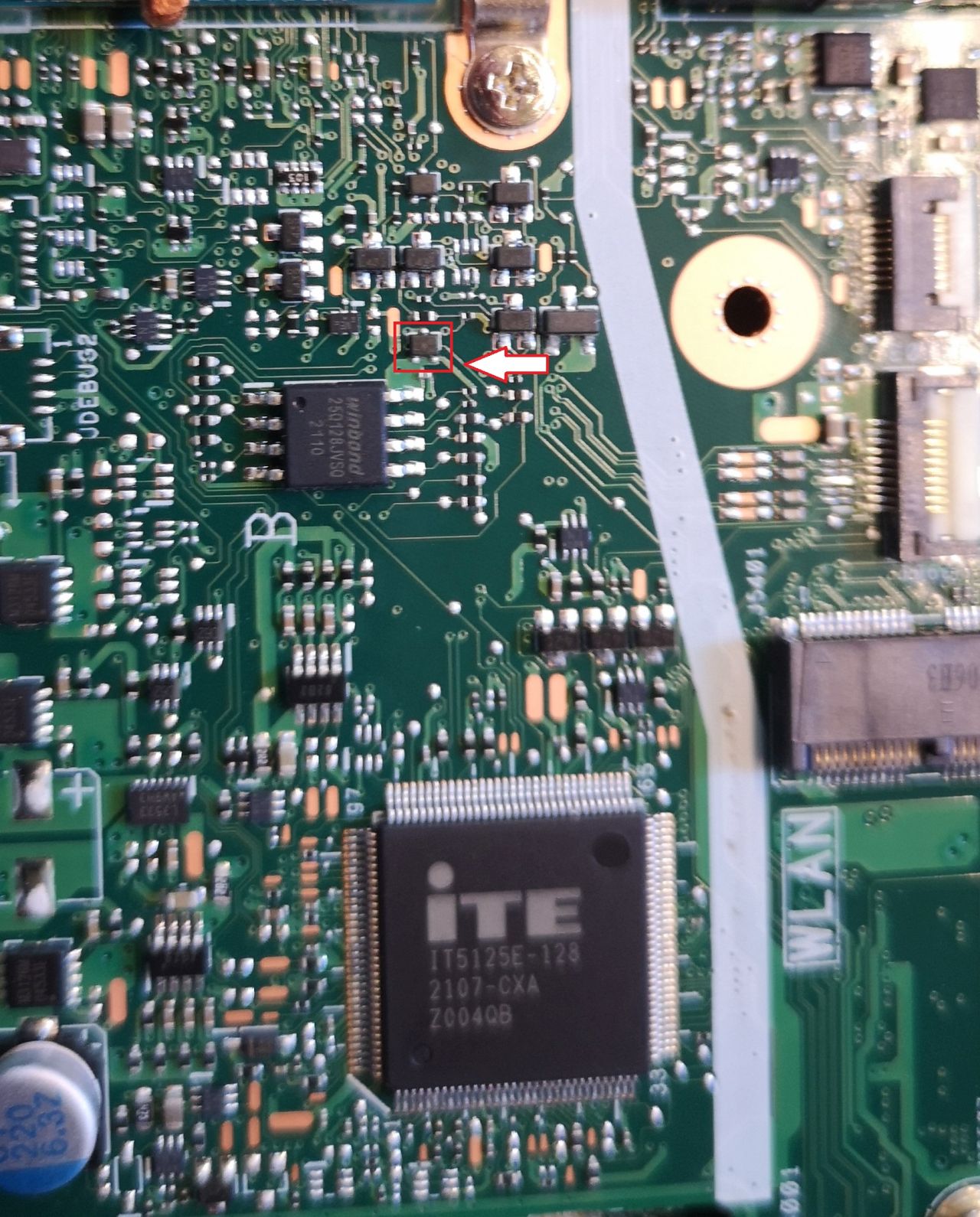

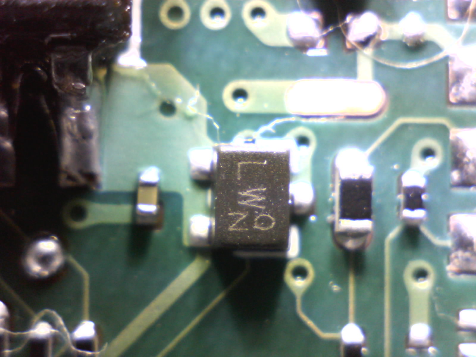

    Please help me identify the item in photo #2.
    It is located on the board at the location from photo #1.
    Thanks in advance for your help.

    Re: Mainboard ASUS X415JA rev 2.2 - Asking for help in identifying a component
    See attached - extrapolated from the very scarce Asus laptop schematics. This dual diode appears to be common to other Asus designs as well.
    From this review,
    BAT54CW-L
    SOT323 = SC70 SMD package
    <final answer; going to lock this in>
    This part is available from many vendors and each are a drop-in replacement.
