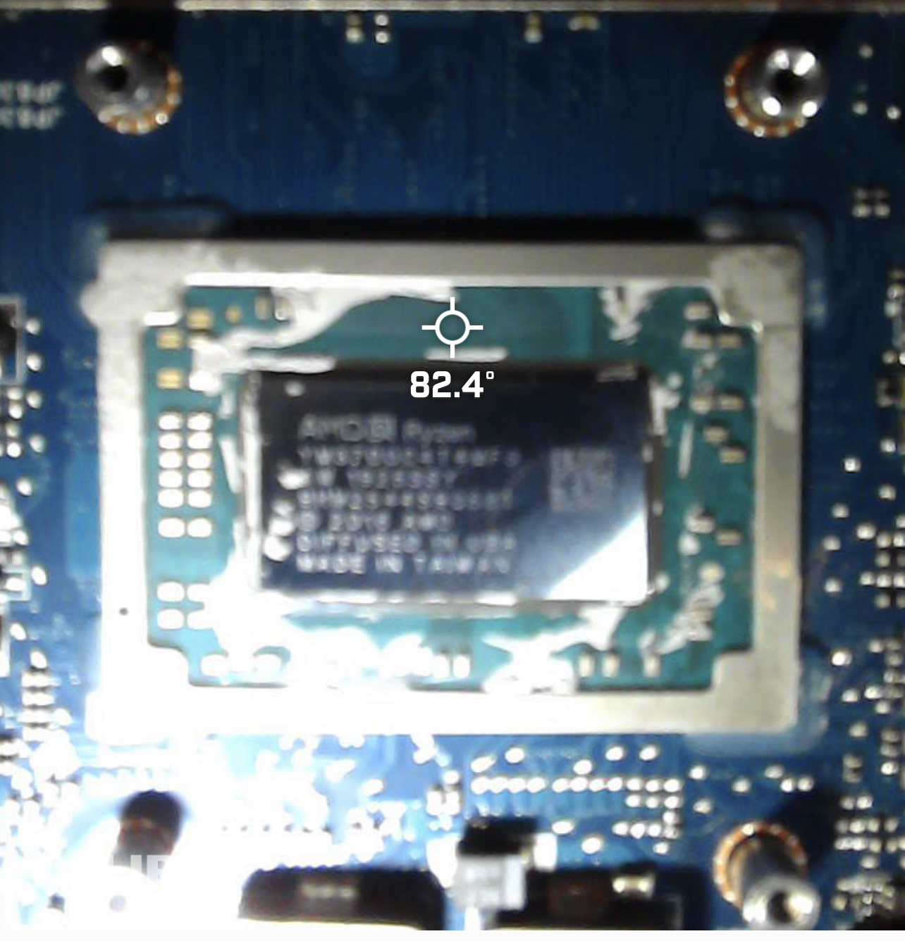

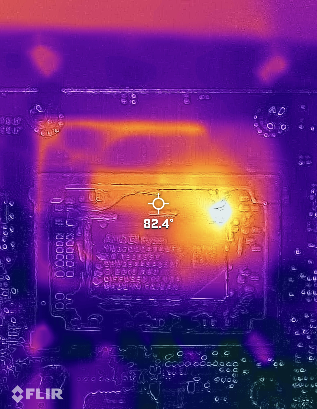

ASUS FX505DU Charge/Bat LED on No Power LED
  • mikeeuly
    • Jul 2020
    • 5
    ASUS FX505DU Charge/Bat LED on No Power LED
    Working system then no power. Checking obvious and using an IR Flir camera shows immediate hot spot when plugged in. Within a second or 2 IR picks up a hot spot. Is there a chance it's due to a failed component MOSFET or Cap that's showing this? Or it's a dead CPU. Ryzen 7 3700U Mobile.
  • todenkopf
    • Oct 2014
    • 49
    • UA
    Re: ASUS FX505DU Charge/Bat LED on No Power LED
    Dead CPU 99.9%
    • mikeeuly
      • Jul 2020
      • 5
      Re: ASUS FX505DU Charge/Bat LED on No Power LED
      Yup and thanks for the quick response. I checked and was trying to find a smoking gun thats causing this but no gun. thx
      • GLISIT
        by GLISIT
        01-16-2025, 02:29 PM
      • ipatch
        troubleshooting microsoft surface pro 4 no power no led charge light
        by ipatch
        hello, �� i have been sitting on some microsoft surface pro 4 tablets for a while now. i was originally tasked with replacing the battery in one of the tablets, and ended breaking the screen and logic board in the process. decided to buy another tablet with the same specs. got that screen off successfully of the second tablet. the logic board appeared good, but i guess i shorted something out in the installation process of the logic which i've read is a common issue if there is no barrier between the logic board and battery pins. all that said, i ate costs of the repair and have...
        10-05-2023, 11:59 AM
      • proxneo
        iPad A2197 no power, A10 and other IC become warm, only 0.5A charge
        by proxneo
        Dear reader
        TL;DR: iPad not turning on, A10 and power IC become (very) warm when attempted to turn on but this power-on cycle has a 'cooldown' period wherein powering on doesn't work, does not take more than 0.5A charge.
        I am working on an iPad 7th generation 2197 from >2019 with no / limited charging and no boot issues. It is a refurbished purchase made in 2021. It appears the 'refurbish' company has either done prior motherboard work (all protective component shield layers are gone) or is one of the many trash refurbish companies (little screen adhesive left, component...
        12-01-2023, 04:14 AM
      • PantherDave
        by PantherDave
        Hi all!
        05-29-2024, 02:01 PM
