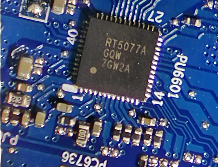

    Hello guys,
    I need some help here,
    I have Lenovo slim 3, turn on, but no display.
    For sometime it's can turn on for about 3 minutes, then its shutdowm itself, after than I cannot turn on the laptop again.

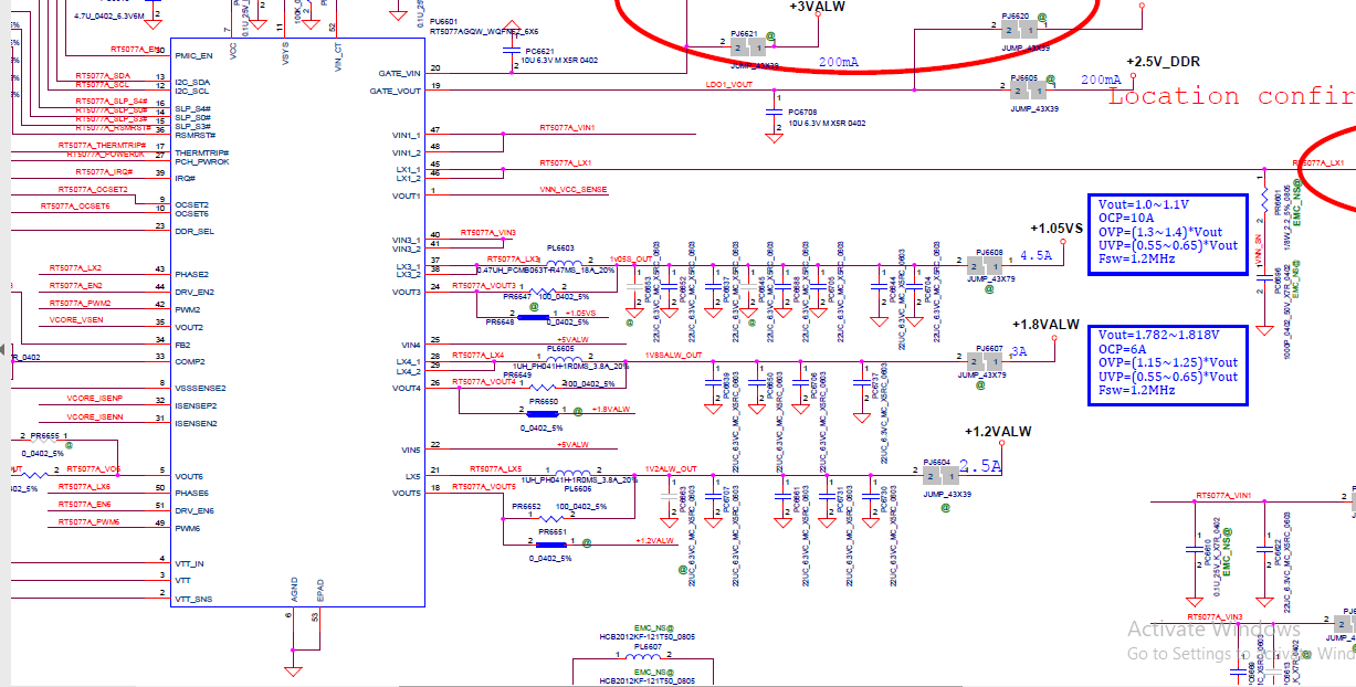

    When i checked, i found that my 1.8VALW is missing in Bios Chip pin no. 8.
    I found that 1.8VALW is from RT5077A. Already check VIN
    VIN1_1/VIN1_2 5.1V
    VOUT1 0V
    VIN3_1/VIN3_2 5.1V
    VOUT3 0V
    VIN4 5.1V
    VOUT4 0V (for 1.8VALW)
    VIN5 5.1V
    VOUT5 0V (for 1.2VALW)
    VCC 5.1V
    VSYS 14.19V
    VIN_CT 20.2V
    PIN30 PMIC_EN 3.35V
    What should i check? Is this mean RT5507A is bad and need to replace?

    Have you checked if VSYS and VIN_CT is present?
    • ch3nzu
      • Jul 2021
      • 43
      • indonesia
      Re: Lenovo Slim 3 14IGL05, RT5077A 1.8VALW missing
      yes, there was present.
      VSYS 14.19V and
      VIN_CT 20.21V
      Note :
      If I plug in adaptor power in 2 hours later, the laptop can turn on, 1.8ALWS and 1.2ALWS is present normally, but only for 3-5 minutes, and its shutdown again.
      • Sephir0th
        • Oct 2020
        • 1282
        Then the issue might be later in the sequence. VCC_CORE for example.
        FairRepair on YouTube
        • ch3nzu
          • Jul 2021
          • 43
          • indonesia
          update
          Change the RT5077A with a new one, and its back normal. Thanks.
