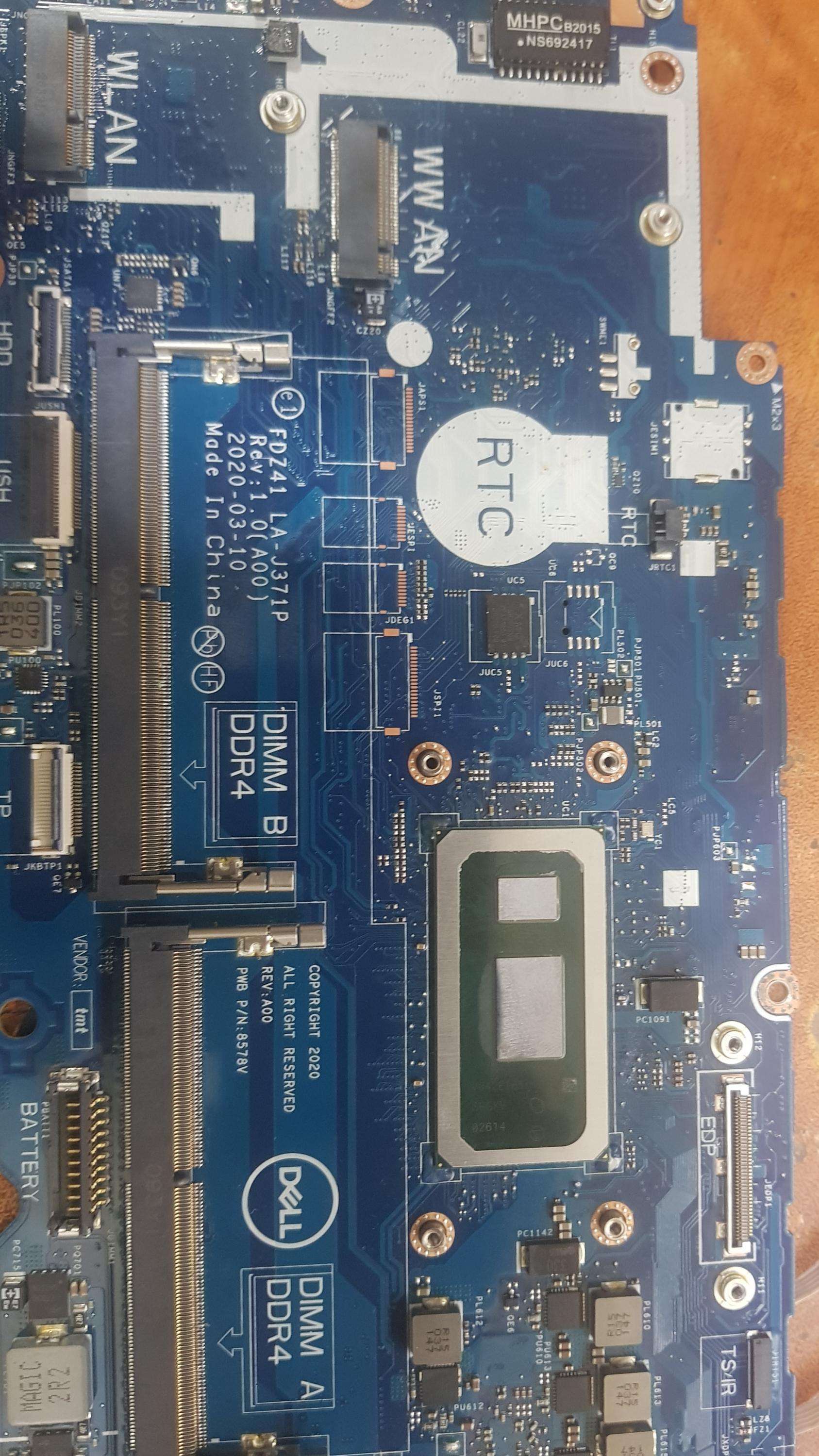

Dell 5410 not powering on
  • motanya
    • Nov 2021
    • 162
    • Kenya
    I thought this is a bios issue but it is not. Other than the main power rail and charging IC, places I ought to think it should have 19v it has 8.6. At the LVDS connector, there is no 19v. If I connect the charger, the power button led comes on for 1minute but the processor is cold and the fan doesn't spin. What might be the issue?

        Re: Dell 5410 not powering on
        What are the silkscreen markings on the logic board?
        • motanya
          • Nov 2021
          • 162
          • Kenya
          FDZ41 la-j371p
          Rev: 1.0(A00)
          2020-03-10

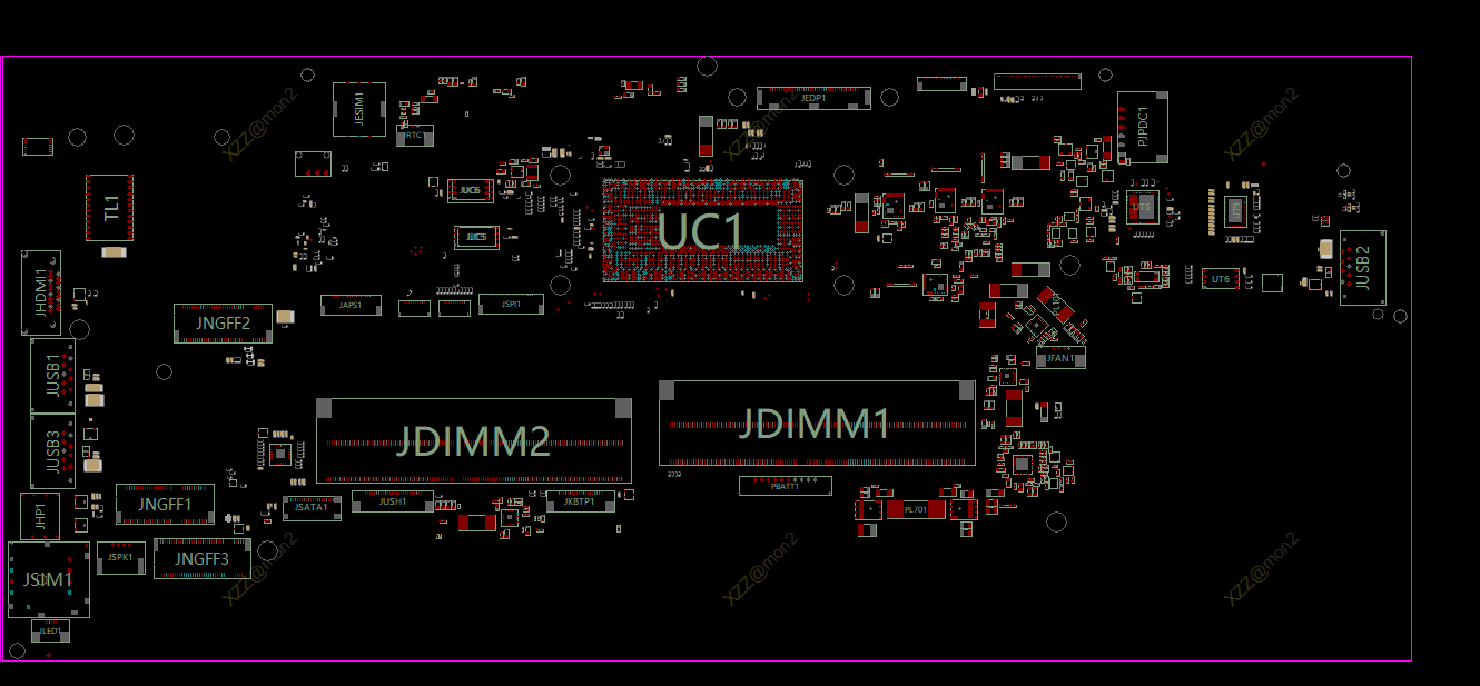

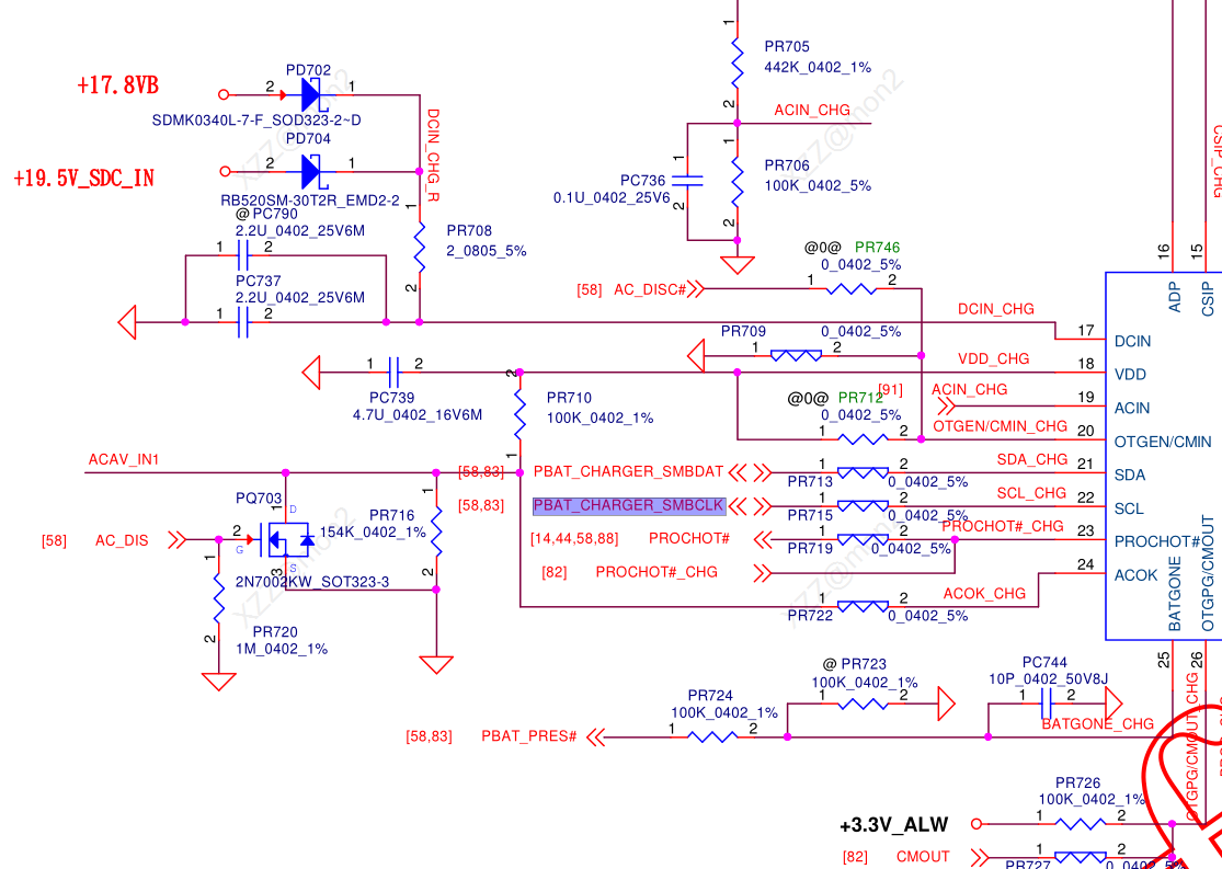

                    Is this your board? Board is LA-J341P?
                    Click image for larger version  Name:	J371P.png Views:	0 Size:	60.3 KB ID:	3478142
                    • Biggs220
                      • Sep 2024
                      • 2
                      Re: mon2
                      My board is LA-J371P. Its the same as the pic of the board motanya posted. The board schematic you posted looks like it but its hard to tell. Would you have a diagram for it?
