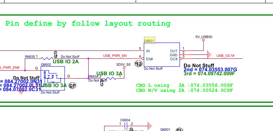

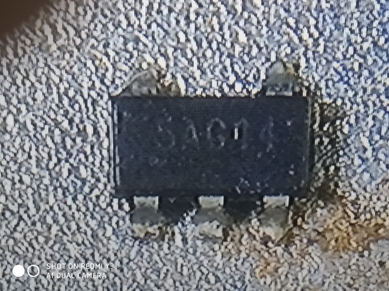

DELL latitude 3420 component identification
  • jm801
    replied
    Re: DELL latitude 3420 component identification
    Do you know any equivalent to it?
    G517G1TO1U thank you for your help
    Leave a comment:
  • mcplslg123
    replied
    Re: DELL latitude 3420 component identification
    Problem is solved. I tried replacing U6601 with SY6288DAAC but it doesnt work and dont output 5V when turned on but does output 5v when off. Since i didnt had any other spares just jumpered a wire between pin1-5 to get 5V on usb. However, Another IC marked 48BAA was defective as well and replaced it with TI 2544. Now all the 3 ports are working. thanks badcaps family.
    Leave a comment:
  • jiroy
    replied
    Re: DELL latitude 3420 component identification
    I tend to believe somone put the wrong replacement .. Or probably was trying an equivalent .. 5AG14 is Ricoh RP124N303E .
    Leave a comment:
  • mcplslg123
    replied
    Re: DELL latitude 3420 component identification
    Thanks alot for the info@smdflea.
    Leave a comment:
    replied
    Re: DELL latitude 3420 component identification
    In the schematic at U6601 there`s a Silergy SY6288DAAC . 5AG14 could be a GMT G517G1TO1U
    SY6288DAAC https://cdn.badcaps-static.com/pdfs/...691dbc2ca3.pdf ,marking BU***
    G517G1TO1U https://cdn.badcaps-static.com/pdfs/...6d6855822d.pdf
    2nd = 074.03553.007G SY6288DAAC
    3rd = 074.09742.009F ?
    CBG L using 3A :074.03556.009F ?
    CBG N/V using 2A :074.00524.0C9F G524B2T11U
    Last edited by SMDFlea; 05-05-2023, 01:52 PM.
    Leave a comment:
  • mcplslg123
    started a topic DELL latitude 3420 component identification
    DELL latitude 3420 component identification
    Modelell Latitude 3420
    MB:CYBORG L14 mb 203068-1
    Somebody has worked on it earlier. A 5leg component is shorted and its connected to usb port. None of the 3 usb ports are working. The component is marked 5AG14(Pin2 is GND). ON PCB,its marked U6601. I dont have schematic.
    Please identify the component.
    DELL Latitude 3420 Notebook 3000 Specification for Upgrade or Repair
    This specification for the DELL Latitude 3420 Notebook can be useful for upgrading or repairing a laptop that is not working. As a community we are working through our specifications to add valuable data like the 3420 boardview and 3420 schematic. Our users have donated over 1 million documents which are being added to the site. This page will be updated soon with additional information. Alternatively you can request additional help from our users directly on the relevant badcaps forum. Please note that we offer no warranties that any specification, datasheet, or download for DELL Latitude 3420...
    09-07-2024, 01:30 AM
    DELL Latitude 3420 Notebook 3000 Specification for Upgrade or Repair
    This specification for the DELL Latitude 3420 Notebook can be useful for upgrading or repairing a laptop that is not working. As a community we are working through our specifications to add valuable data like the 3420 boardview and 3420 schematic. Our users have donated over 1 million documents which are being added to the site. This page will be updated soon with additional information. Alternatively you can request additional help from our users directly on the relevant badcaps forum. Please note that we offer no warranties that any specification, datasheet, or download for DELL Latitude 3420...
    09-07-2024, 01:30 AM
    DELL Latitude 3420 Notebook 3000 Specification for Upgrade or Repair
    This specification for the DELL Latitude 3420 Notebook can be useful for upgrading or repairing a laptop that is not working. As a community we are working through our specifications to add valuable data like the 3420 boardview and 3420 schematic. Our users have donated over 1 million documents which are being added to the site. This page will be updated soon with additional information. Alternatively you can request additional help from our users directly on the relevant badcaps forum. Please note that we offer no warranties that any specification, datasheet, or download for DELL Latitude 3420...
    09-07-2024, 01:30 AM
    DELL Latitude 3420 Notebook 3000 Specification for Upgrade or Repair
    This specification for the DELL Latitude 3420 Notebook can be useful for upgrading or repairing a laptop that is not working. As a community we are working through our specifications to add valuable data like the 3420 boardview and 3420 schematic. Our users have donated over 1 million documents which are being added to the site. This page will be updated soon with additional information. Alternatively you can request additional help from our users directly on the relevant badcaps forum. Please note that we offer no warranties that any specification, datasheet, or download for DELL Latitude 3420...
    09-07-2024, 01:30 AM
    DELL Latitude 3420 Notebook 3000 Specification for Upgrade or Repair
    This specification for the DELL Latitude 3420 Notebook can be useful for upgrading or repairing a laptop that is not working. As a community we are working through our specifications to add valuable data like the 3420 boardview and 3420 schematic. Our users have donated over 1 million documents which are being added to the site. This page will be updated soon with additional information. Alternatively you can request additional help from our users directly on the relevant badcaps forum. Please note that we offer no warranties that any specification, datasheet, or download for DELL Latitude 3420...
    09-07-2024, 01:30 AM
