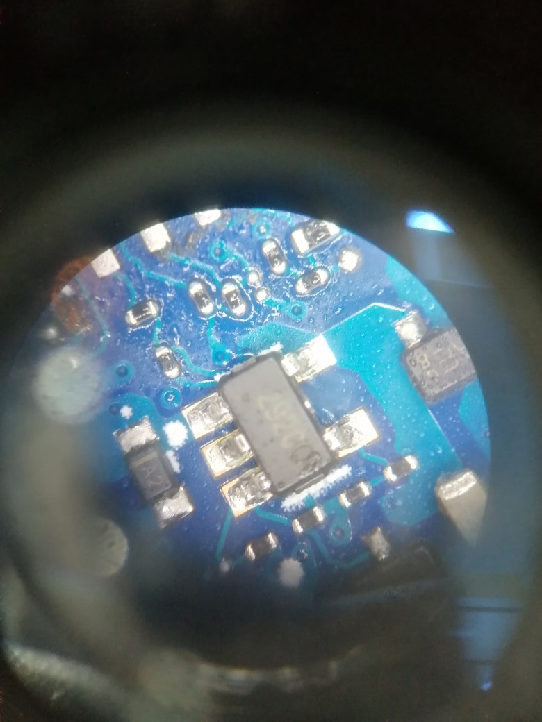

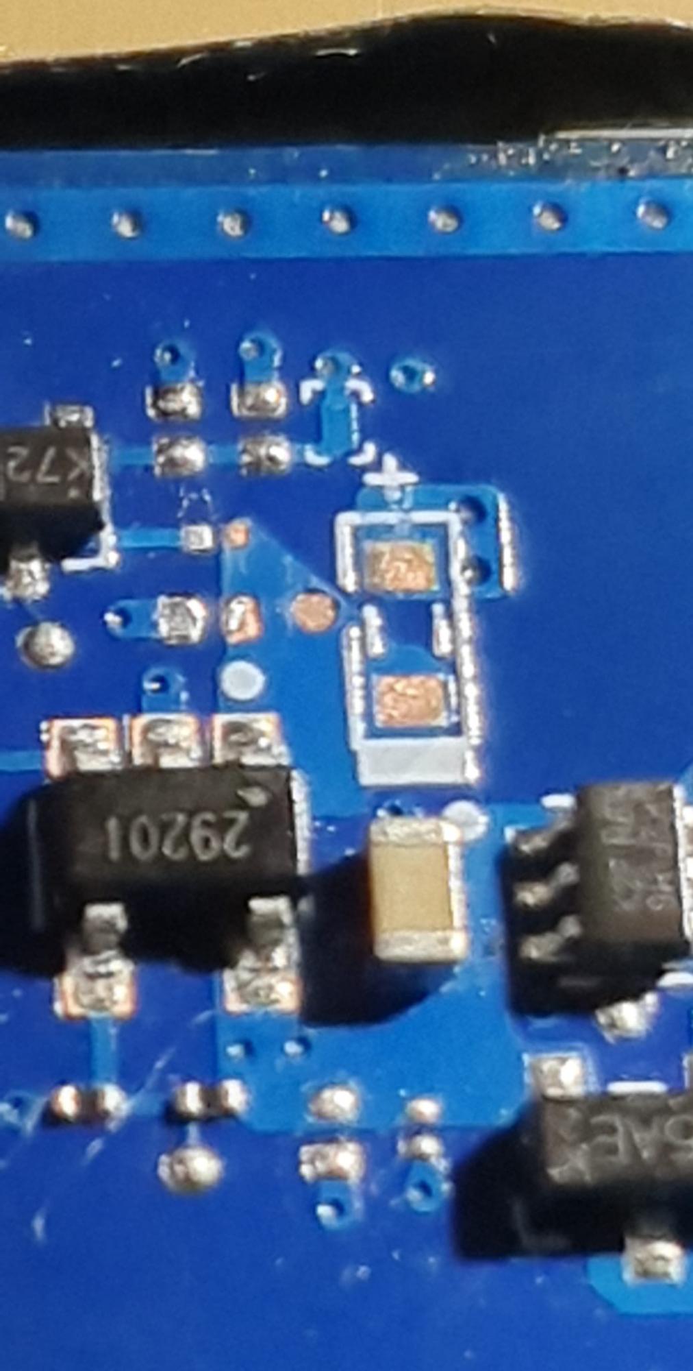

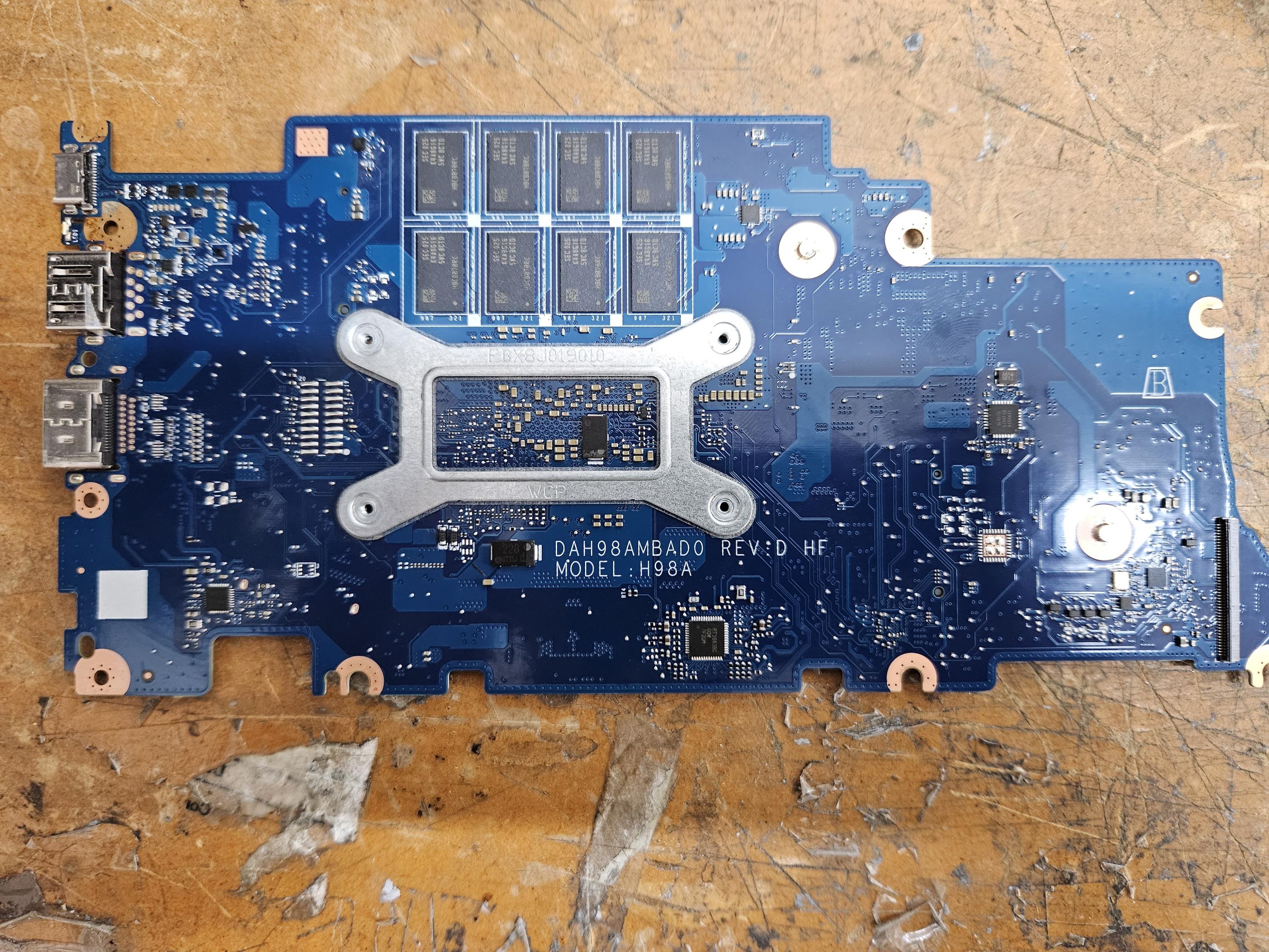

    Need to identify a component that is broken.
    One I already identified using the forum but the other on the left is missing.
    I cannot give any lettering advise because the component is broken.
    Any help would be very useful.
    Motherboard model is: DAH98AMBAD0
    Latpop: Huawei Matebook D 15 Boh-WAQ9R

    Re: Component Identification Huawei Matebook D 15
    There is enough lettering left on the part to help ID it, if you can post a better picture.
      I got it under the microscope today and i can read following:
      Top line: THA and the last letter is cut.
      Bottom line: ACD.

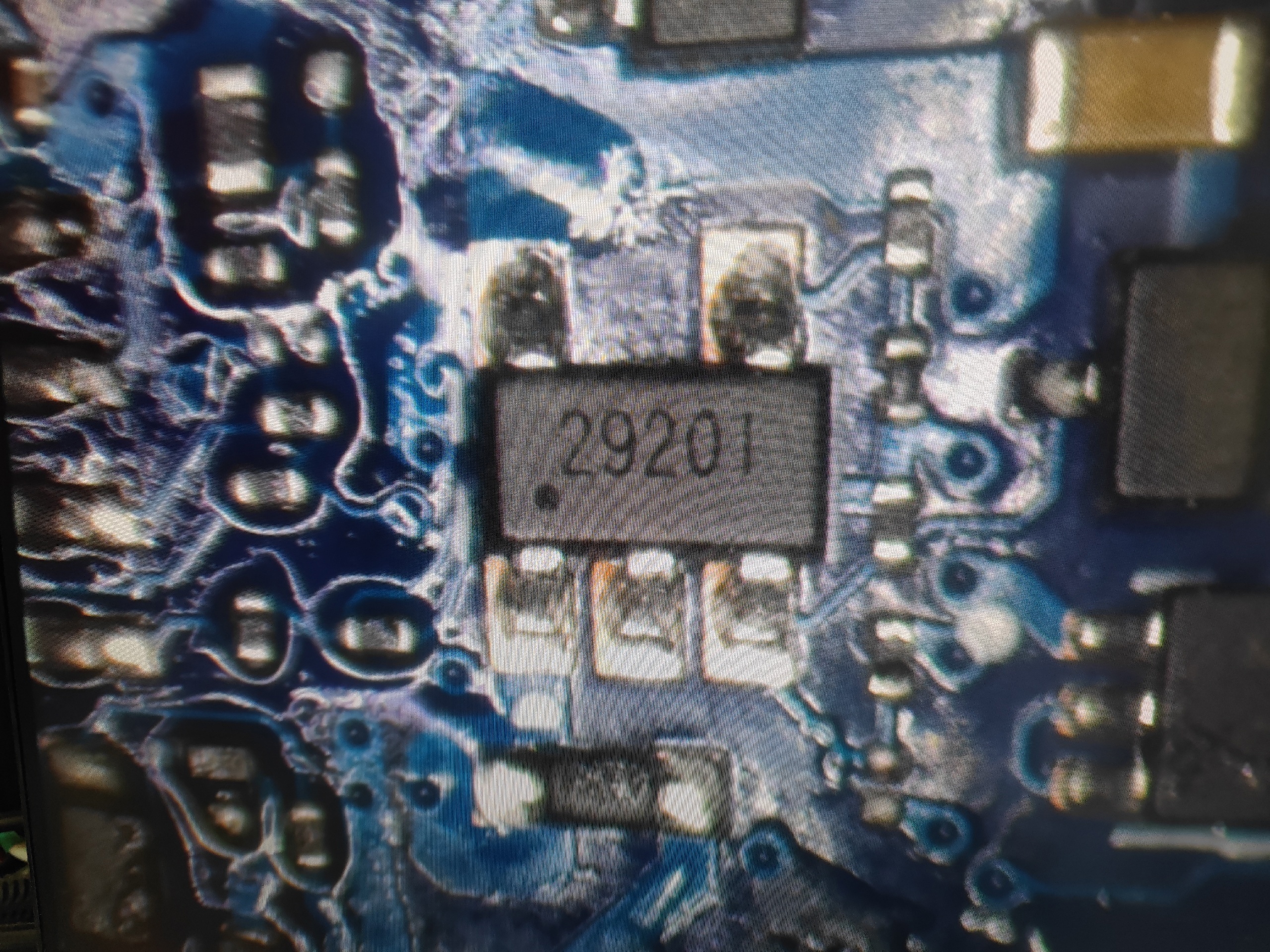

          Hello, please tell me what kind of element is marked 29201?
          Motherboard DAH98NMB8C0 REV C
            need help please
              Post a zoomed out picture of this area.

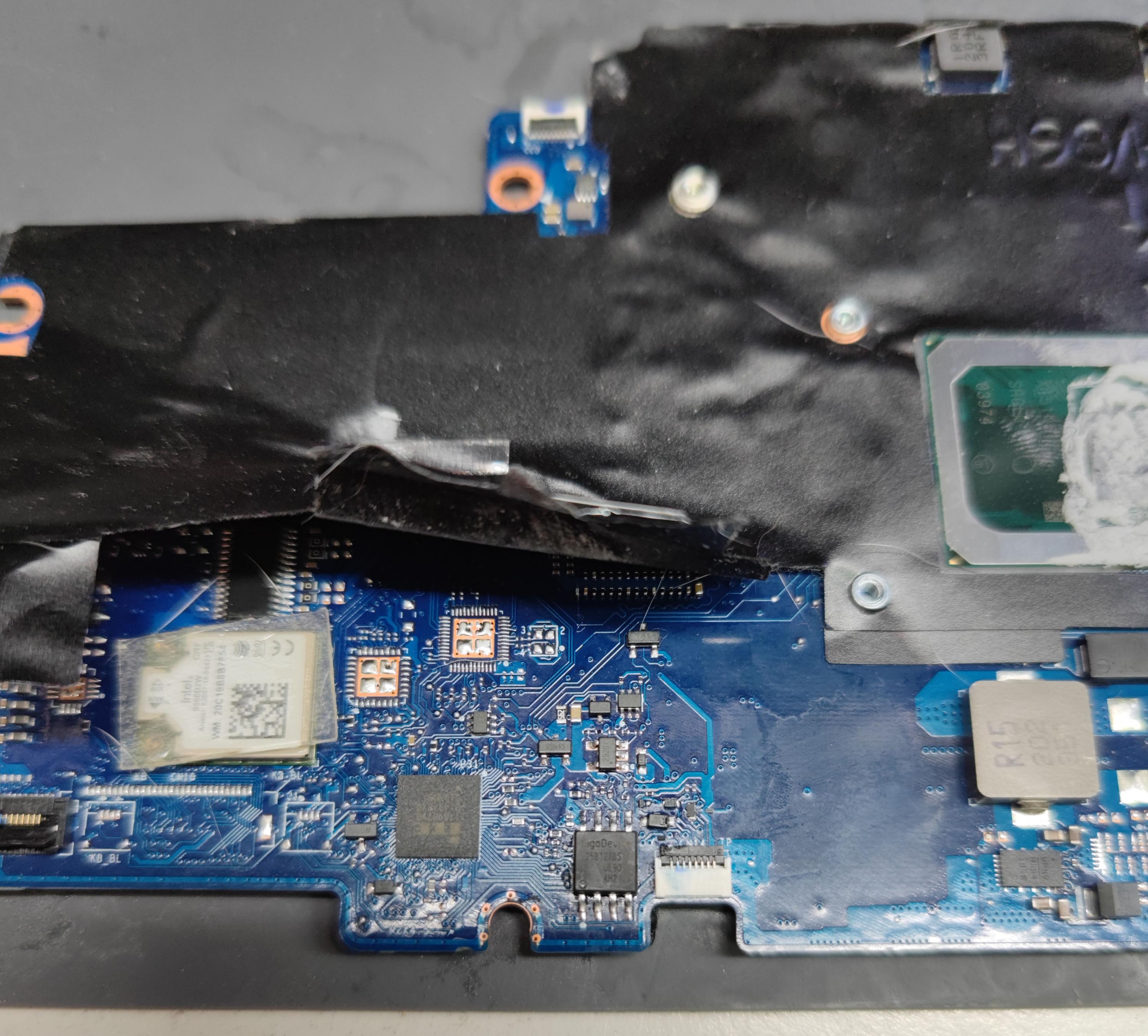

                Last edited by SMDFlea; 11-08-2023, 06:34 AM. Reason: posted images to badcaps from external link

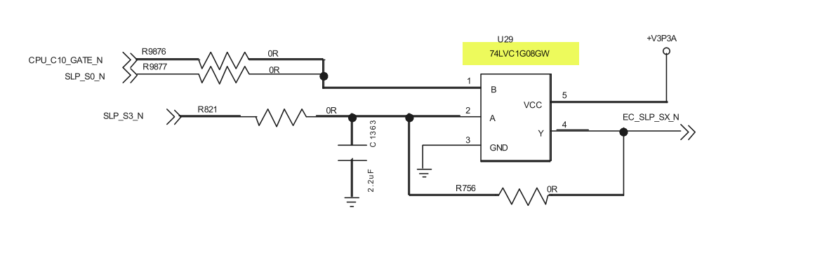

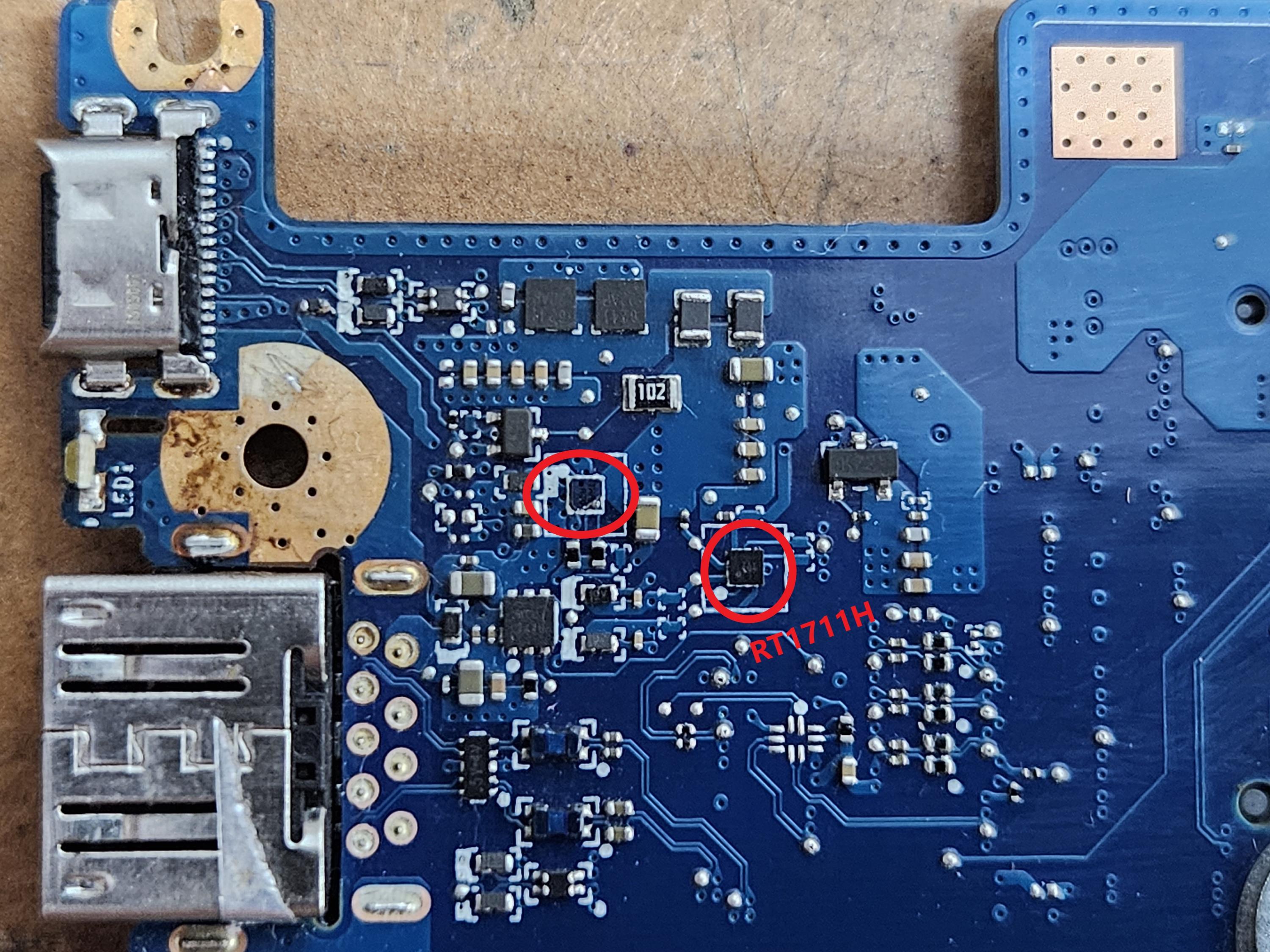

                  The same part is present on other Matebook models.
                  See here - post # 7
                  https://www.badcaps.net/forum/showthread.php?t=117316
                  Still unable to locate the part from the posted schematic.
                  Perhaps it is the attached single gate dual and device (74LVC1G08GW).
                  Suggest to remove all power -> meter in resistance mode. Measure the resistance across each of the black body SMD parts so we can better understand the resistance of each resistor. Create a small schematic of this component and surrounding parts.

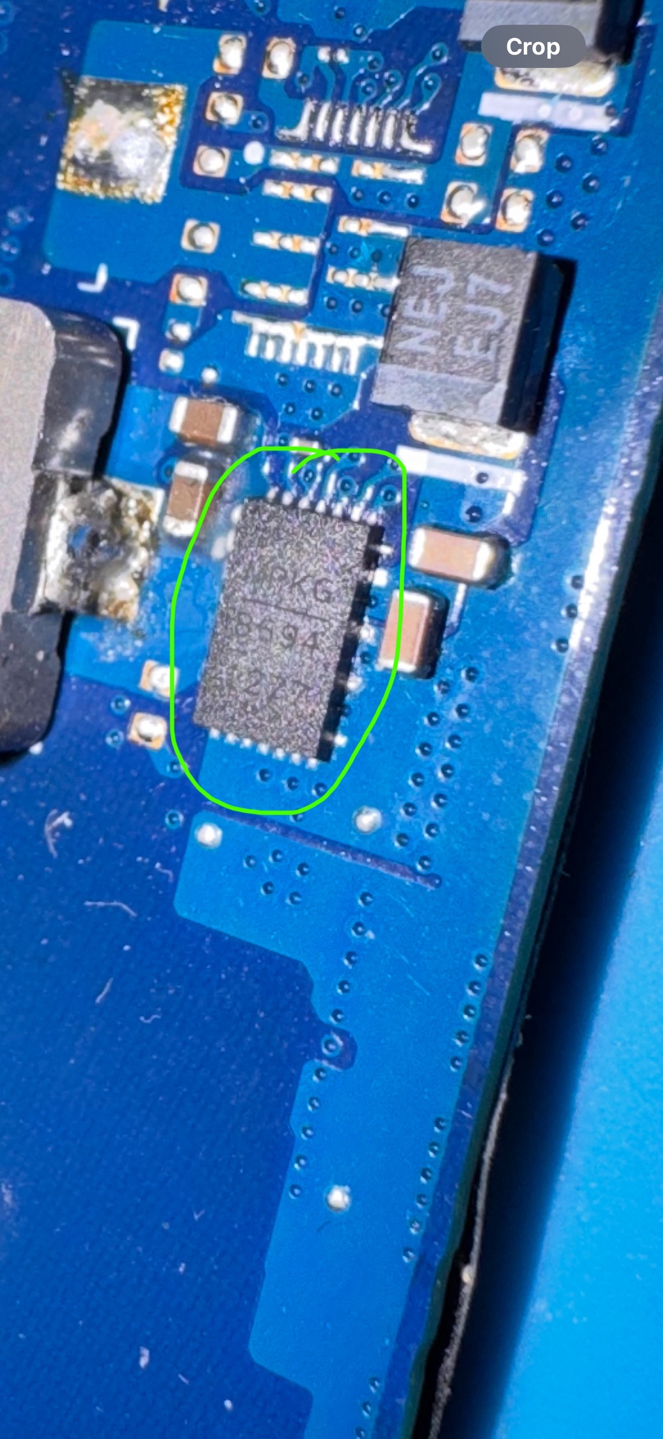

                    Hello guys 👋
                    I have schortet component on my huawei d15
                    DAH98NMB8C0
                    Can someone help me to identify component
                    It is written on the component MPKG 8694 1277 Click image for larger version
                    • mon2
                      • Dec 2019
                      • 14713
                      MPS #MP8694
                      I just found this on AliExpress: US $3.30 | New Original MP8694 Type MPKC 8694 QFN 1 In Stock Real Picture
                      https://a.aliexpress.com/_mqWwSzN
                      • Tosa
                        • Jun 2025
                        • 4
                        • Austria
                        Thank you so much!
