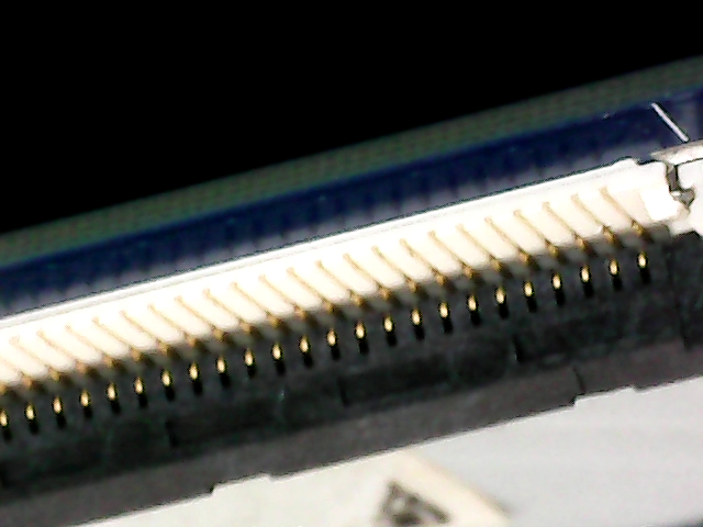

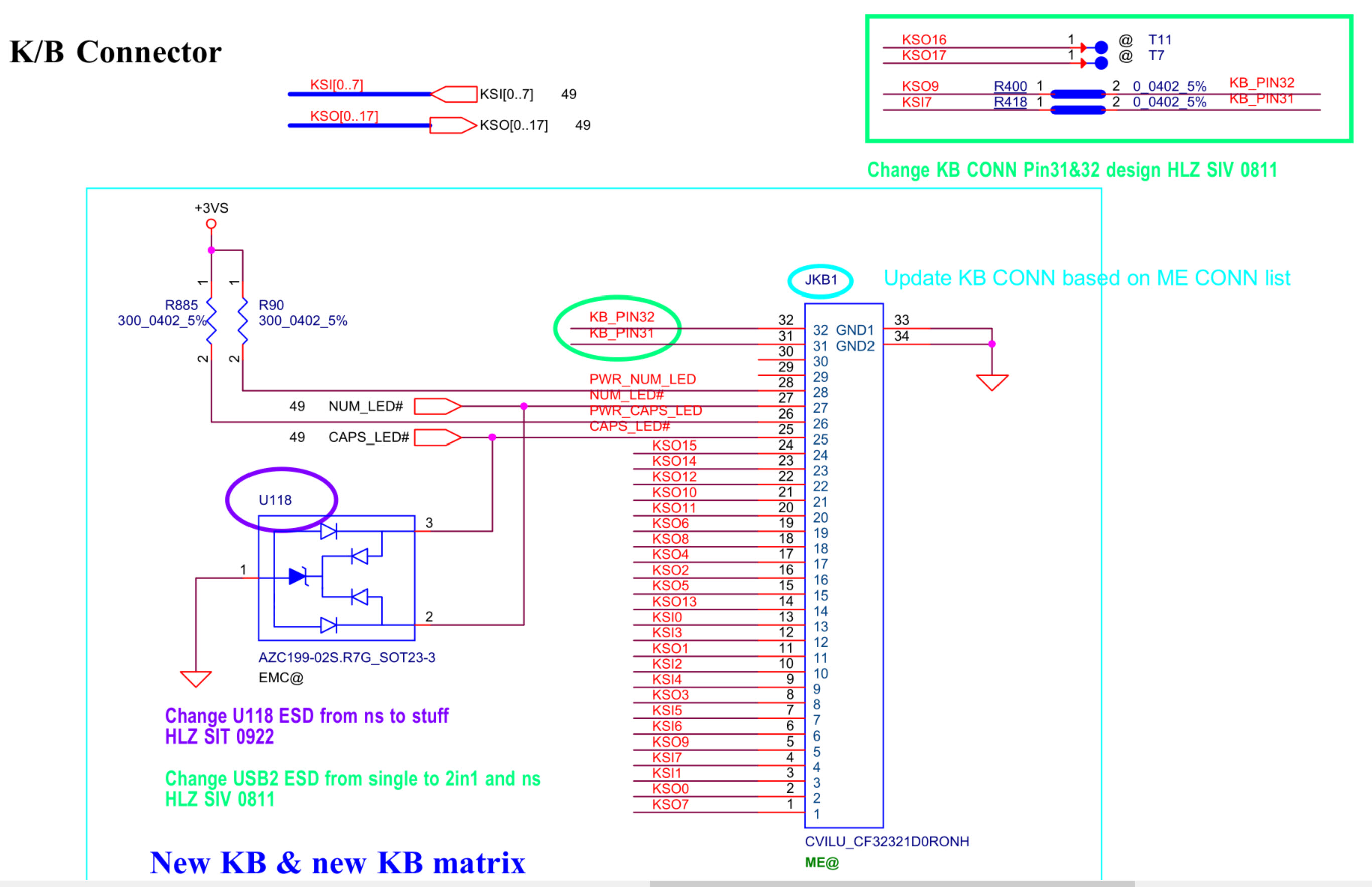

    Good night everyone,
    My problem seems to be strange and i didn't found anything on the internet so here it is if someone have faced it and could help.
    It is a Lenovo Legion Y520-15IKBN that have some keys on the keyboard not functioning ( E , G , H , 8 , 9 , FN , ....) so i thought that it is a keyboard problem, i ordered a new one and replaced it , at first night it worked perfectly the second night those keys were not functioning but when i press one of them 5 or 6 times they function again i restarted the laptop sometimes works sometimes not sometimes i press several times so they work again. after that they stopped completely. The exact same keys that were not functioning on the old keyboard became non functional on the new one so i guessed that it is not a keyboard problem.
    The trucks on the motherboard are connected from the keyboard connector to the super IO that i checked and are OK , the connector is ok too , i updated the bios , reinstalled the driver and didn't fix the problem.
    Does anyone have any idea about this issue ?
    Thanks.

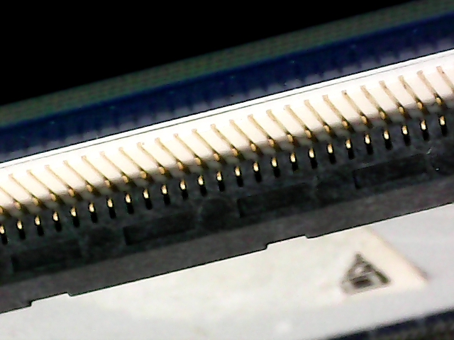

        check keyboard connector on motherboard with microscope...maybe one pin from inside is bent or dirty or similar.
        • ladharimohamed2
          • Jul 2021
          • 40
          • tunisia
          Re: Laptop Keyboard problem and it is not the keyboad!!!
          all good

            Second i would check in continuity mode connection from those pins to ite chip. And if all ok then i would check pins on ite chip if one of them is making bad/loose connection to the motherboard (solder crack).

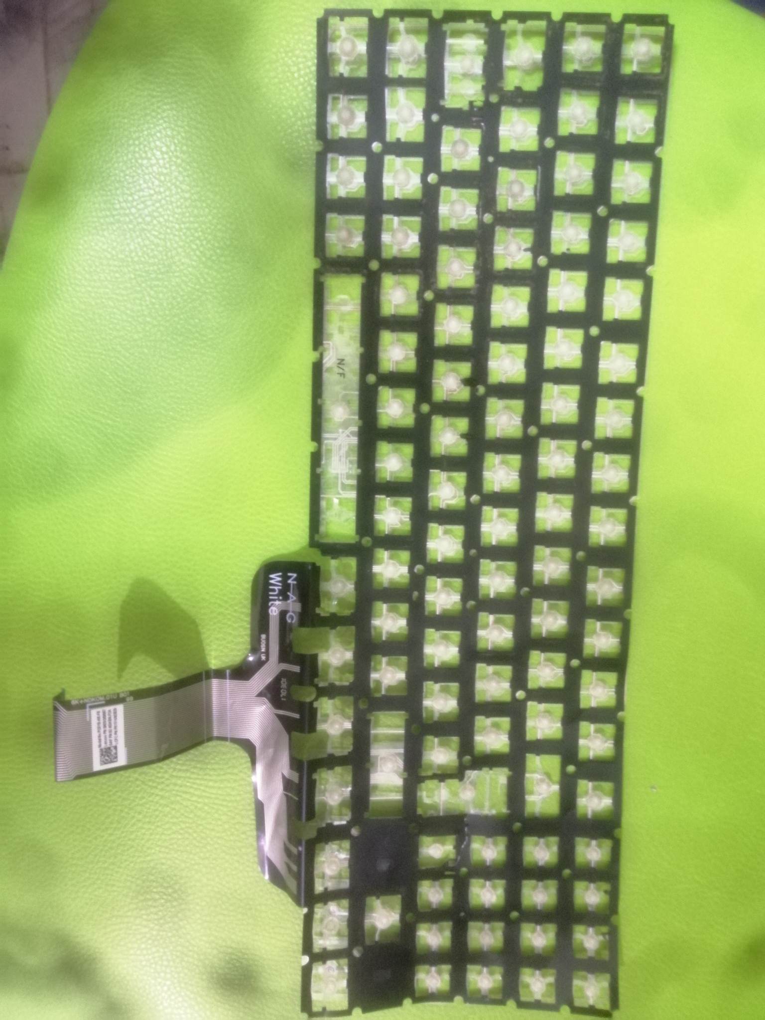

                  I disassembled the old keyboard and found that all keys that are not working have the same exact line on the keyboard. That line is connected to pin number 10 of the keyboard connector wich is connected to pin number 60 of the SIO. i even mesured connection directly from those buttons to their pin of the SIP (60) and they are connected. So i guess there is nothing left but a SIO problem.

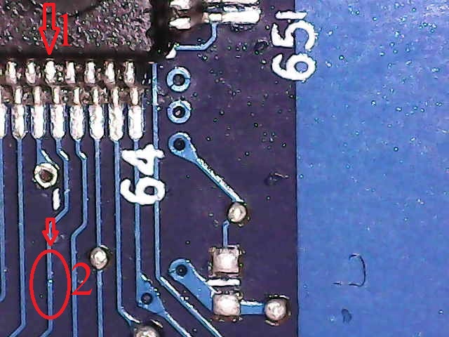

                            I also measured pin number 60 of the SIO that is common to the non-working group and found 700 value. Pin 64 of the SIO wich is a working group found 700 value too.
                            Hi mon2,
                            after more measurements i found different values of pin number 60 of the SIO (the pin wich the line of the non functioning buttons are connected)
                            the value on point 1 = 567 (point 1 where the pin 60 of SIO is soldered to the motherboard).
                            the value on point 2 = 700 (a track of that pin)
                            PS : continuity between those two points is 0 and no visual problems of connection between the two points there. What can it be ?
                            thanks a lot

                              The diode readings should be the same at the start of the pad and to the end of the trace that mates with the pin.
                              In posted pic, concerned about the lack of fiberglass view between the pins. Can clearly see a solder ball between 2 pins of this region.
                              Suggest to apply flux onto the pads and then use desolder braid to draw up the excess solder between the pads. Then use IPA alcohol to clean up the area.
                              In summary, solder sould be present on the pin and landing pcb pads. The area between the pins should be clean and without solder else there is a risk of a short.
