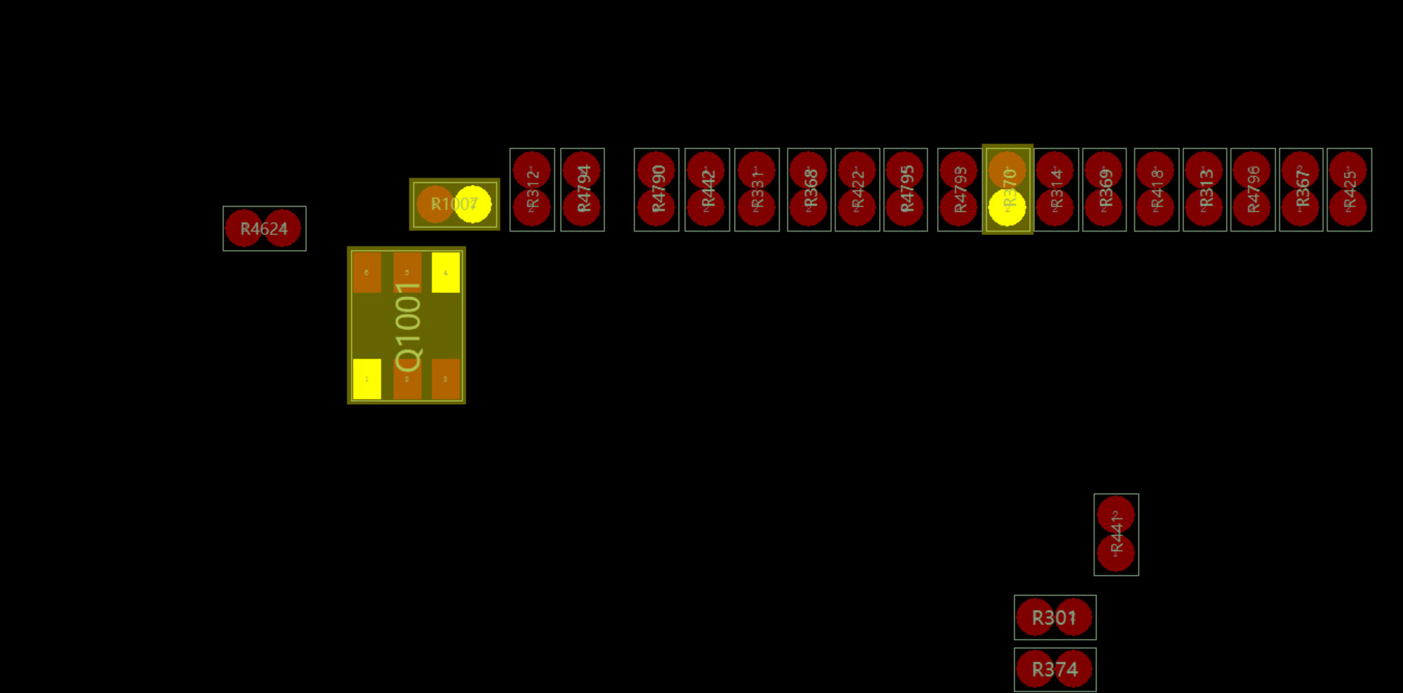

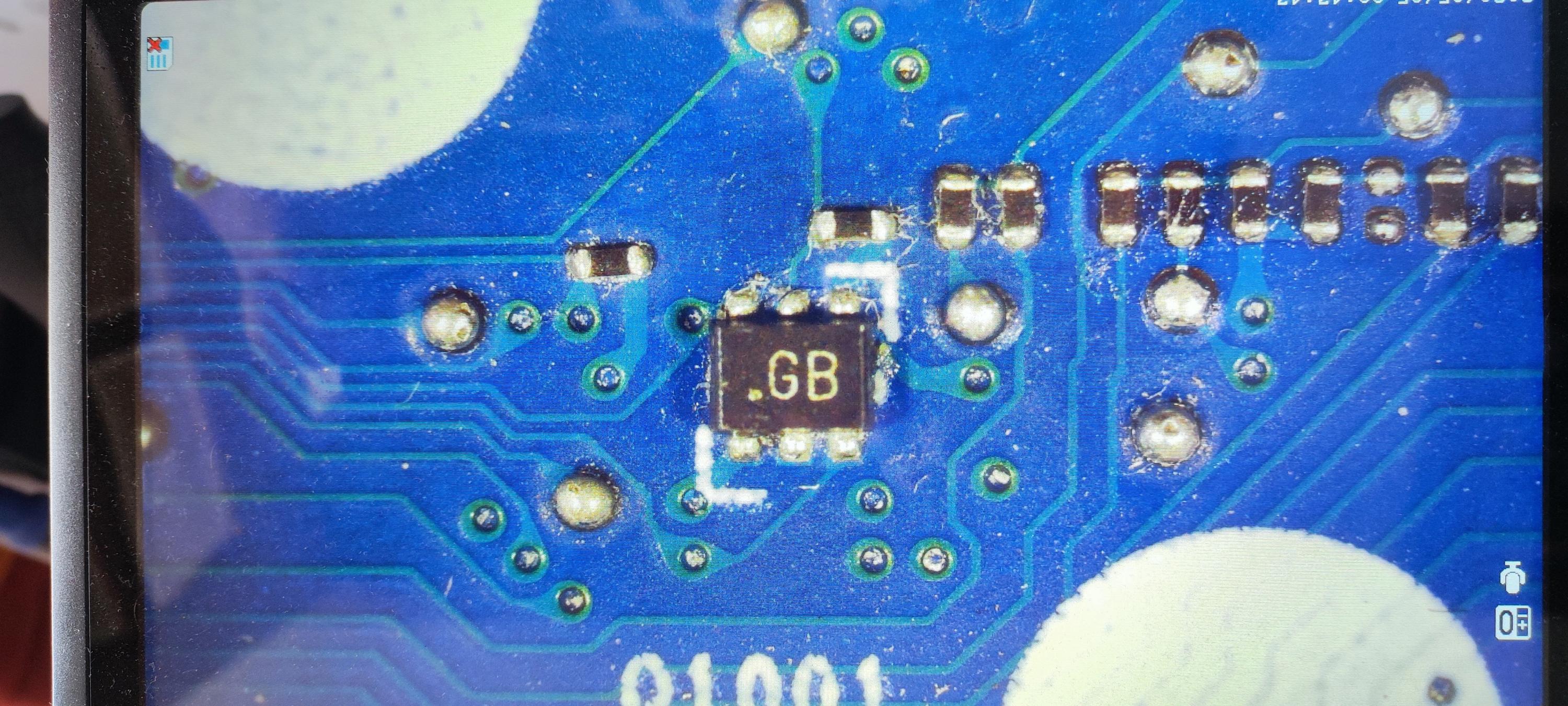

    Hello everyone, does anyone know a reference to this component, thanks in advance

    The plate is a Camelia 6050A3136201, I would appreciate any information, since it is impossible for me to find the schematic, thank you very much.

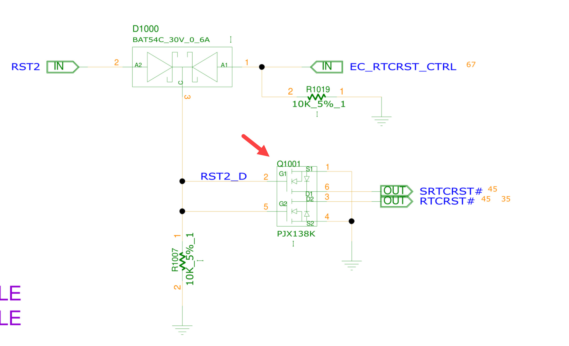

      Re: Hp 840 g7 board component identification
      Q1001 - see attached - also with BV, it is a match.
      https://www.mouser.com/ProductDetail...MeS5V7vw%3D%3D
        Thank you very much, you saved my plate, it had been a while since I got it, very grateful.
