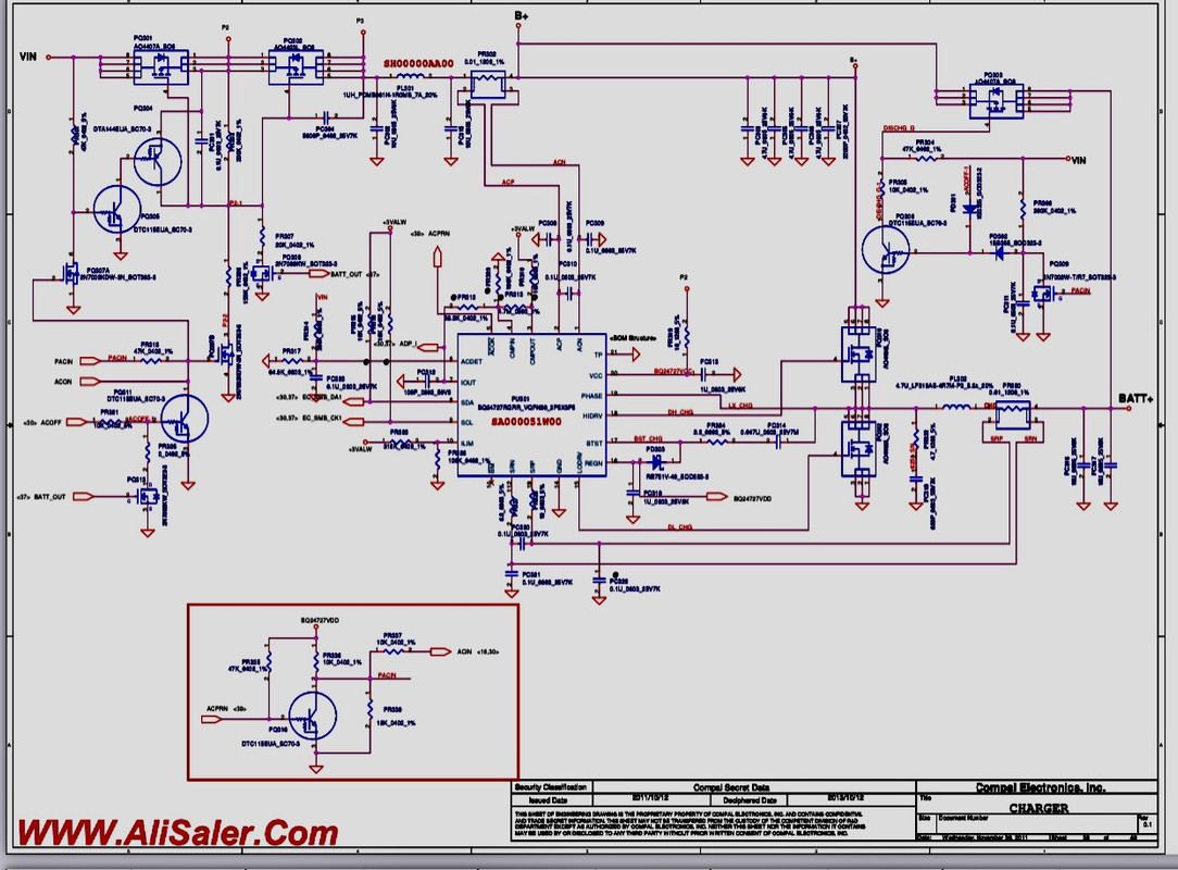

    Hi i've been troubleshooting laptop that only charge/recognized dc in when it in OFF position.
    When i plugged in charger in ON position it won't recognized/charging at all
    So when i need to charge the laptop i need to turn it off>plugged charger>and turn it on again. That way the laptop is charging/detect dc in
    I have an schematic of the board. But i'am not expert at diagnosing board level like this
    So what i need to check in this kind of problem? Is it resistors? Or mosfet charging?
    I provide the schematic link thanks
    Schematics: https://drive.google.com/file/d/1Akh...rKK-Y7Sl8/view

    The square box in the schematic is the battery charger IC by Texas Instruments under the name of 'BQ'.
    This chip decides when to charge and how to charge the battery.
    You will need a multimeter to carefully measure each pin on this charger IC with the adapter and battery connected. With a steady hand so the pins are not shorted.
    Meter in dc volts scale of 30v or higher. Red probe to the pin. Black probe to ground on the laptop. Shield is ok.
    Post the voltage readings and each pin number when ready.

        In the way measuring the charging ic, i notice that mosfet PQ302 was hot when i plugged in the charger. I try to replace that mosfet and now its charging normaly even when laptop ON position.
        Btw huge Thanks for advice
