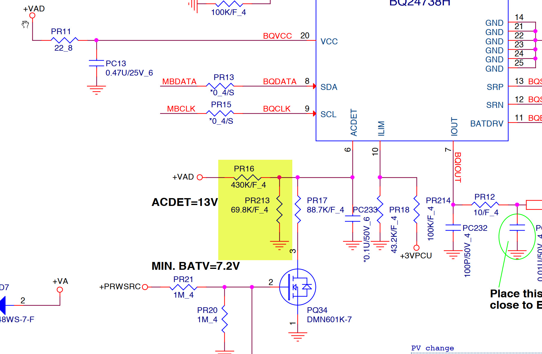

    pavilion 15 Y11A motherboard low ACDRV signal
    Greetings...
    Please, I need help in fixing the above board problem. The board number is DAY11AMB6E0 REV: E.
    0.8V is the voltage that was able to deliver into the system due to ACDRV being stuck at 0.8V. The system works when 19V is introduced to the PQ20 drain, but the battery does not charge.
    Below is the IC's reading when plugged in:
    1. 0.8
    2. 0.8
    3. 0.8
    4. 0.8
    5. 0
    6. 1.6
    7. 0.4
    8. 0.5
    9. 0.5
    10. 0
    11. 1.9
    12. 1
    13. 1
    14. GND
    15. 0
    16. 6
    17. 5.9
    18. 0
    19. 1
    20. 19.7
    There is no break between PR 211, 137 and the IC.
    Attached is the schematics diagram of the charging IC: BQ24738H

    Re: pavilion 15 Y11A motherboard low ACDRV signal
    Remove all power -> remove PR22 off the logic board. Do not lose this 4k resistor.
    Power up again and check the voltage to ground of ACDRV pin of the charger IC. Measure directly at the charger IC pin.
    Post the measurement.
        Measure the voltage on each side of PR16.
        • mon2
          • Dec 2019
          • 13848
          Fault in this area. This threshold voltage must be > 2v4 for the charger IC to detect the adapter. Then the ACDRV boosted voltage will follow.
          Remove all power. Meter in resistance mode.
          Measure the resistance of each resistor @ PR16 and PR213.
          Post each measurement.
              The final lower voltage @ 1v6 is not the correct voltage for ACDET. It should be higher and must be greater than 2v4 for the charger IC to detect a valid power adapter.
              Remove all power. Meter in resistance mode. Check the resistance of:
              PR16
              PR213
              Meter probes across each resistor to measure.
              One of these resistors is not the correct value and causing the lower ACDET voltage.

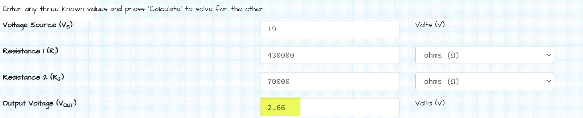

                          Ok. Carefully flux and remove resistor PR17 off the logic board. Do not lose this part.
                          We want to remove this part from the equation to see if the ACDET value changes.
                          Then power up with the adapter and check the voltage again @ ACDET pin.
                          Based on the resistor voltage divider calculator, if you have ~19v as input to PR16 and if the resistors are with a stable resistance, the voltage should be ~2v66 at ACDET.
                          It should not be 1v6. That is too low. If you still have this low voltage then recommend to replace at least PR16.
                          If you do not have these resistor values, we can try to work out with other values.
                            The ACDET changed.
                            it increases to 2.7V ACIN on pin no 5 now has a voltage, 2.9V at PR217
                              Very good -> check the ACDRV pin now.
                                  What is the voltage to ground @ ACDET pin # 6 of the charger IC ?
                                        Thank you so much @mon2, I just had it resolved now. thank you a million times.
                                        what happened was that PQ35 pin 1 which is GND was absent. Hence, there was voltage at the pin, and pin 3. so I created a ground for the pin. That solves the problem.
                                        thank you so very much.
