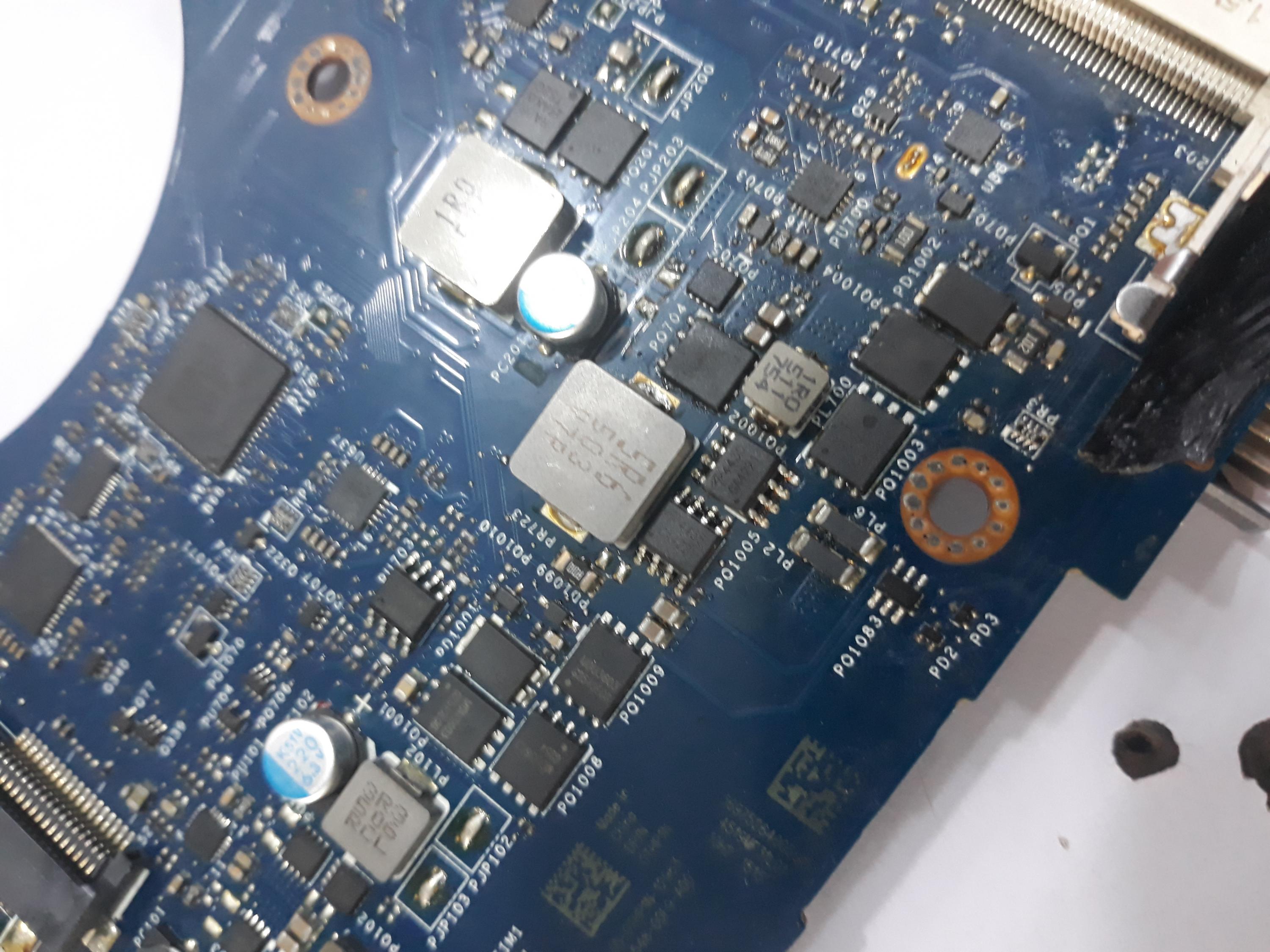

                  • maren1
                    • Feb 2022
                    • 20
                    • nigeria
                    Re: Dell precision m4800 not detecting battery
                    Originally posted by mon2
                    Not at my computer but need to review the charger IC. This charger IC will have local mosfets that act like switches to enable or disable the use of the battery if the adapter is missing.
                    The charger IC monitors the battery status and also will charge the battery if the adapter is suitable with enough power. The batteries must be known good batteries.
                    Do check the battery contacts.
                    Which charger IC is onboard? Is it the usual BQ series? Share the topside markings of this charger IC. Will check the same once at my desk.

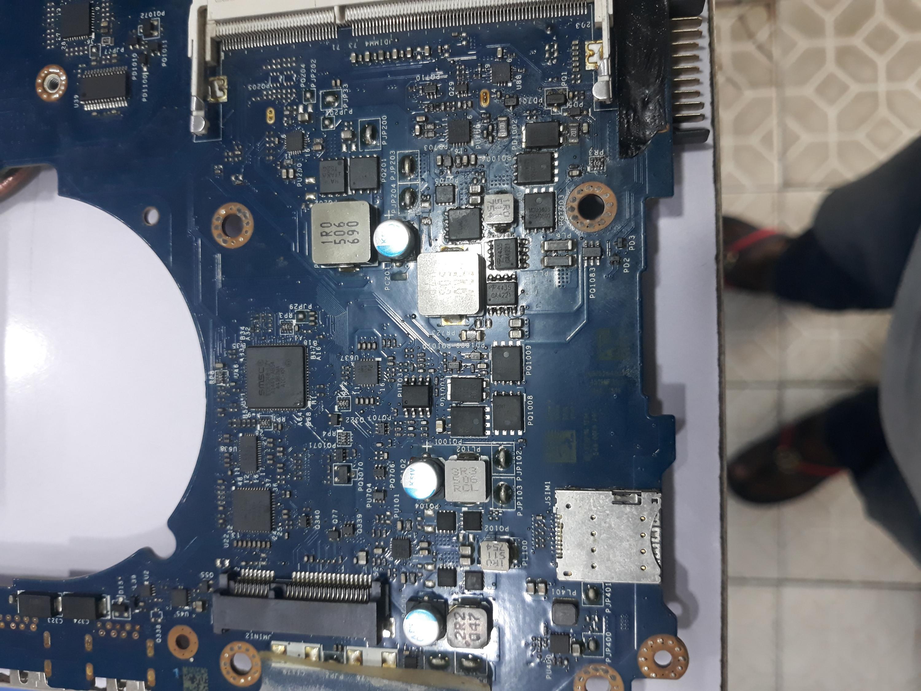

                    here is some pictures of the charging area of the board---

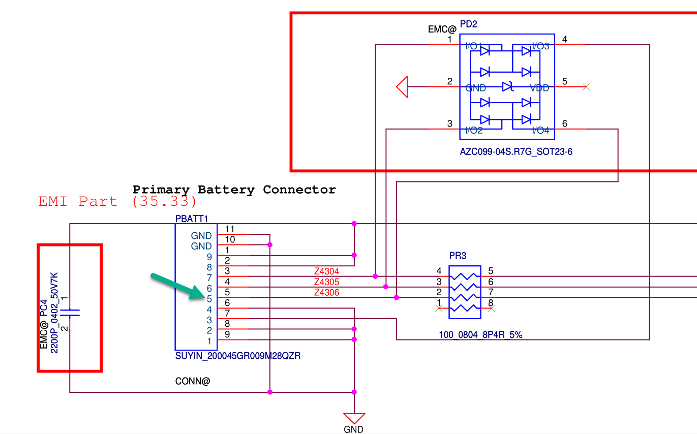

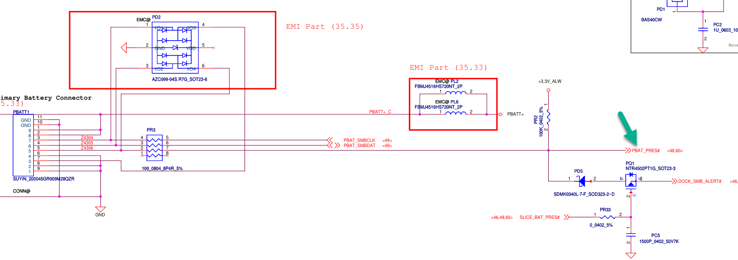

                      1) The schematic for this logic board is posted here:
                      https://www.badcaps.net/forum/showth...ighlight=M4800
                      2) See attached. Remove the battery and power up with only the power adapter.
                      Measure the voltage to ground of pin # 5 = PBAT_PRES# pin.
                      This pin has a local pull-up resistor @ PR2. Without the battery, this voltage to ground should be ~3 volts.
                      With battery connected, PBAT_PRES# = 0 volts.
                      Without battery connected, PBAT_PRES# = ~3 volts.
                      Confirm it.
                      3) Charger IC is @ PU700 = BQ24737RGRR

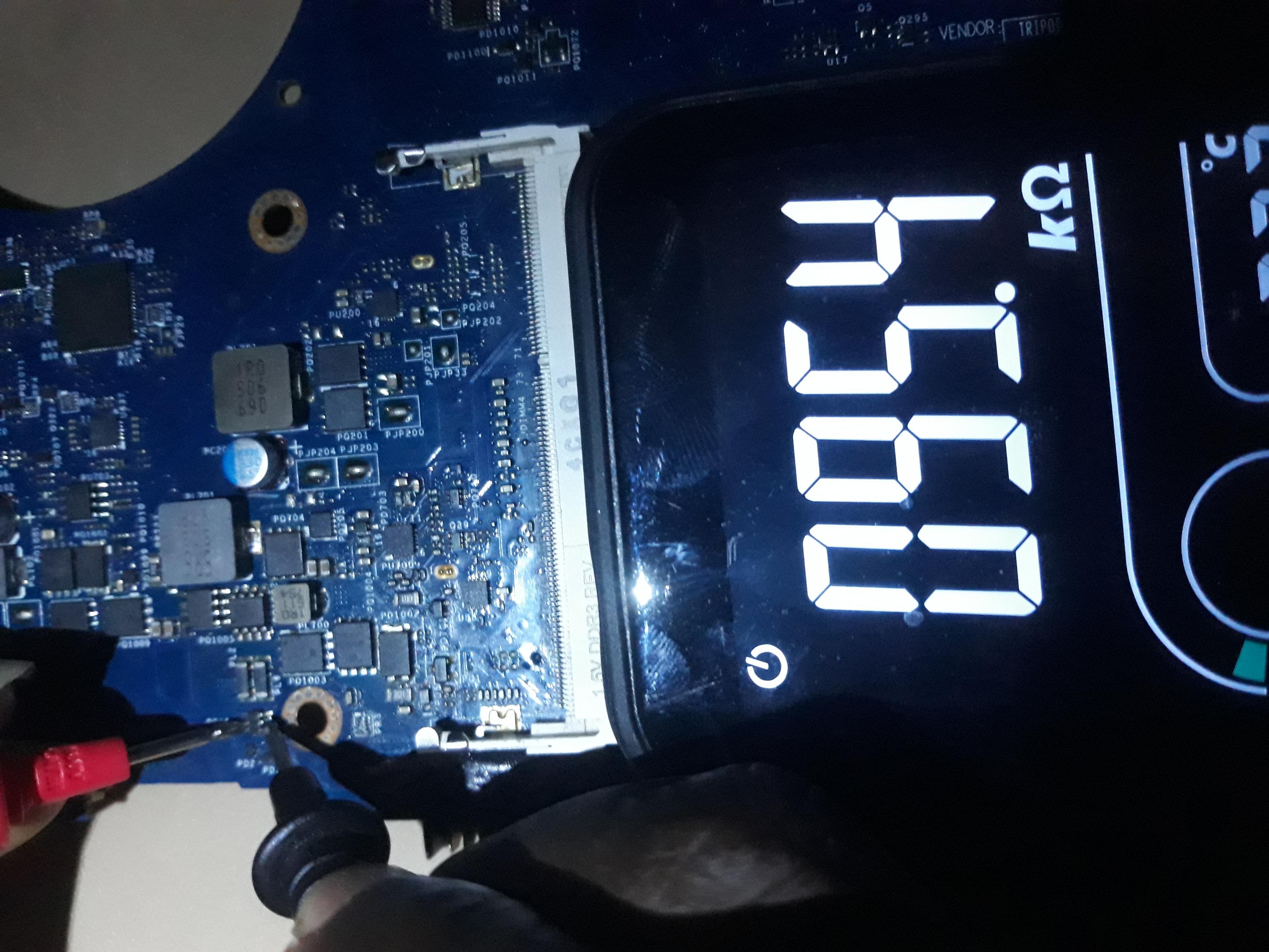

                              • maren1
                                • Feb 2022
                                • 20
                                • nigeria
                                Remove all power. Meter in resistance mode.
                                Check the resistance of the resistor network at PR3.
                                One meter probe on pin #3 of the battery connector. Other meter probe to pbat_smbclk. Reading should be ~100 ohms.
                                Repeat for pbat_smbdat line.
                                Post your measurements.

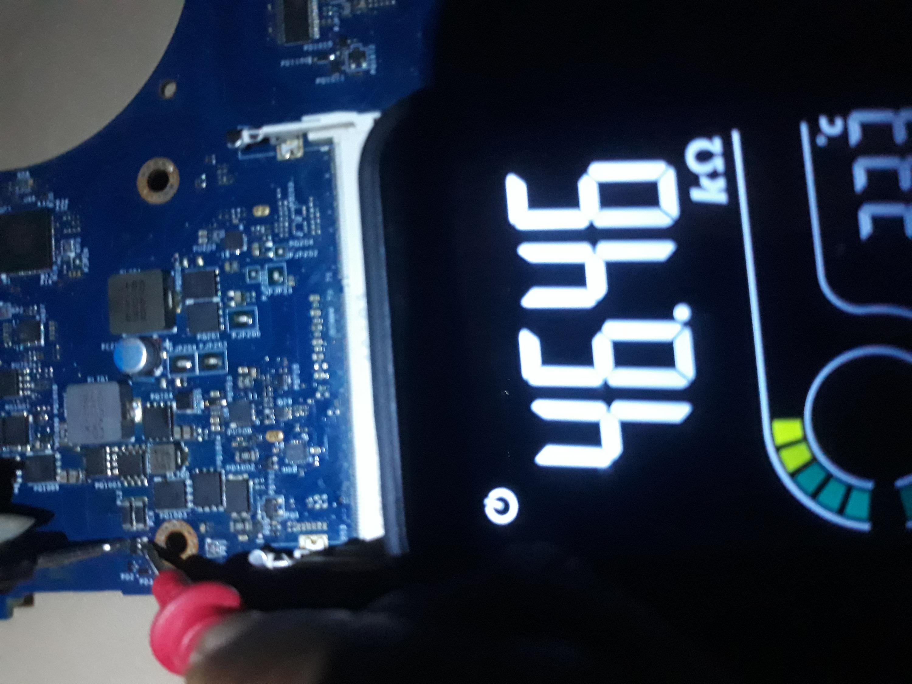

                                here is the reading

                                  but dont understand how to read this line----

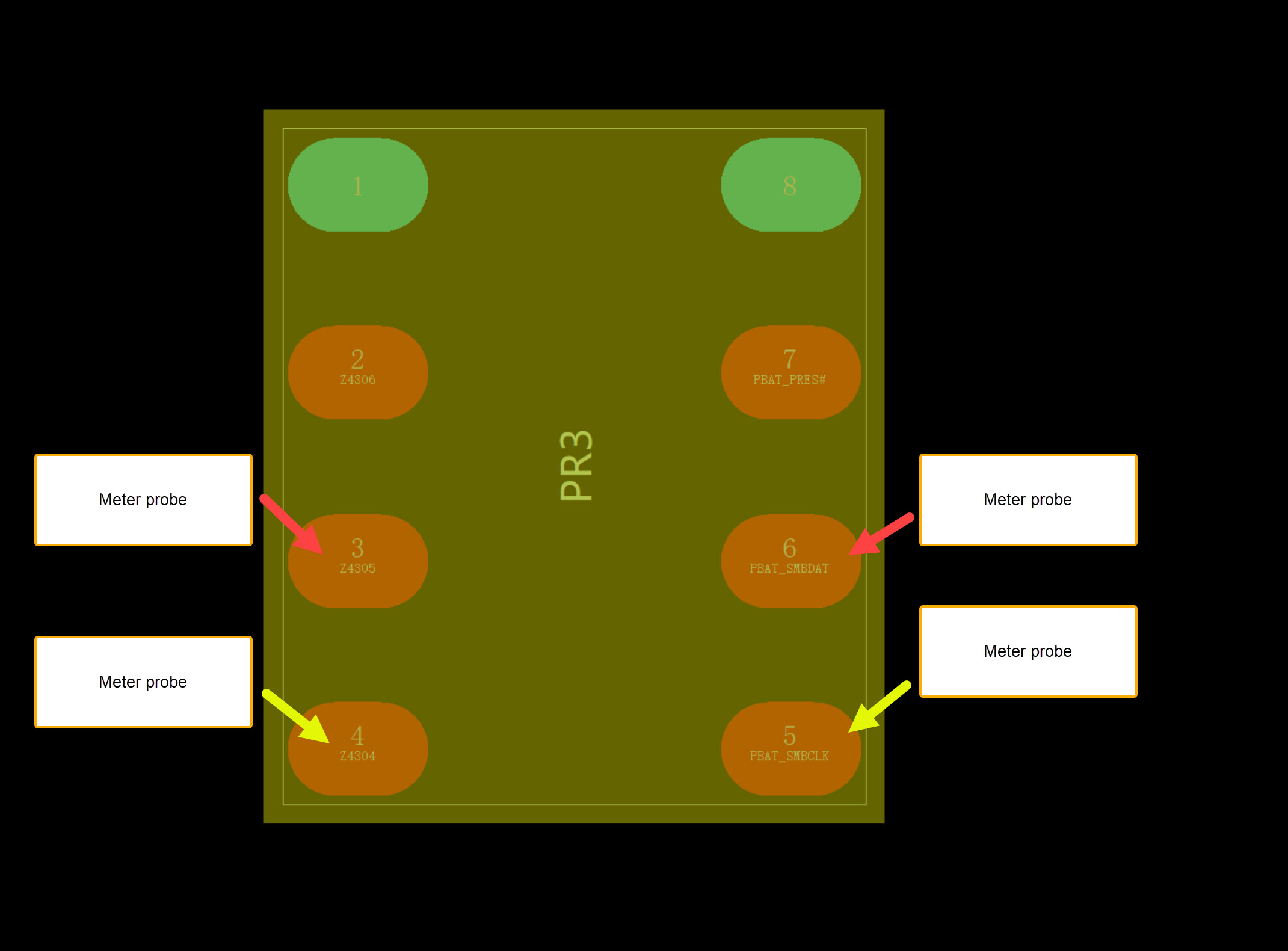

                                  • mon2
                                    • Dec 2019
                                    • 13954

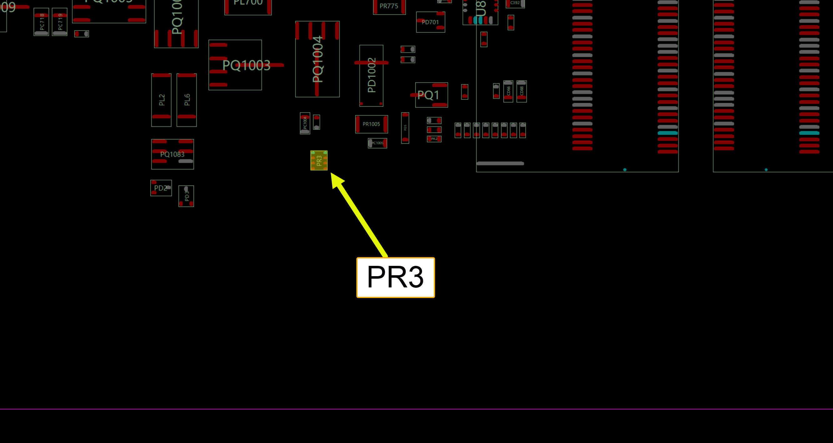

                                    See attached.
                                    Use the meter probes across the resistor network with the RED arrows.
                                    Then repeat the same test with the probes at the YELLOW arrows.
                                    Each should return a value of ~100 ohms. We are only checking to be sure that PR3 resistor network is ok.

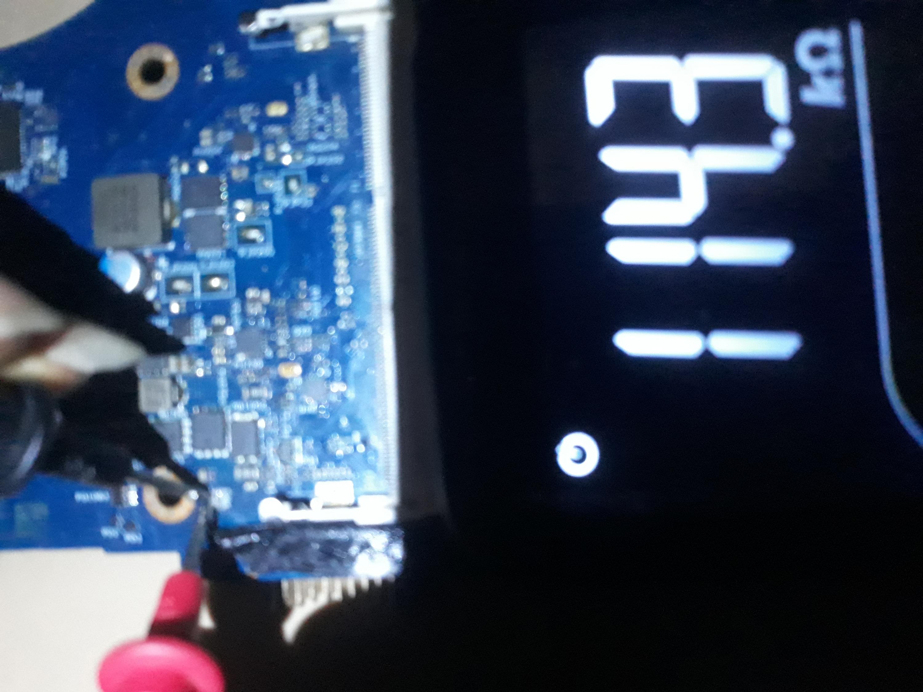

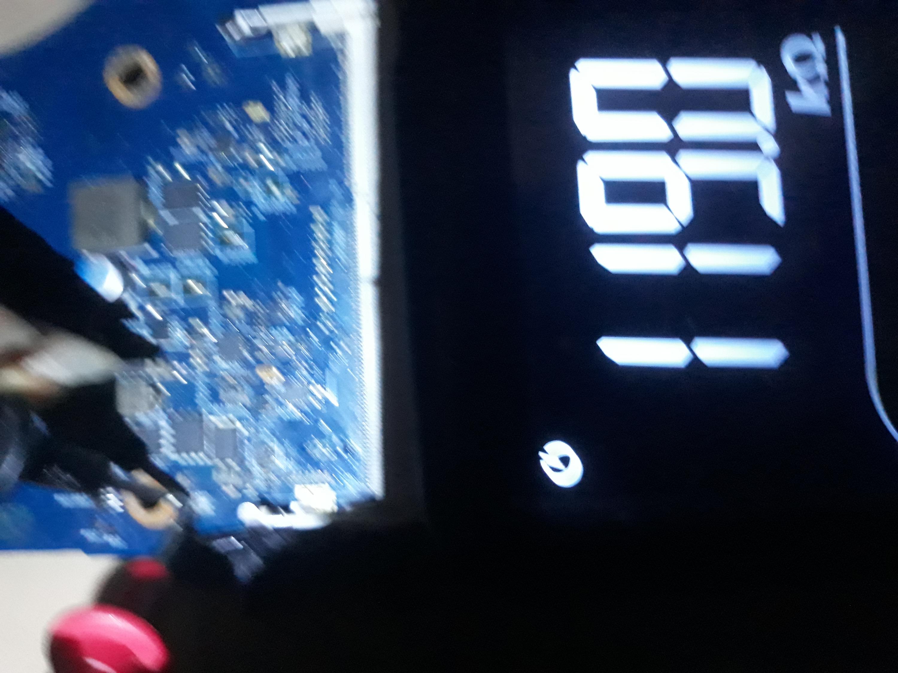

                                    • maren1
                                      • Feb 2022
                                      • 20
                                      • nigeria
                                      See attached.

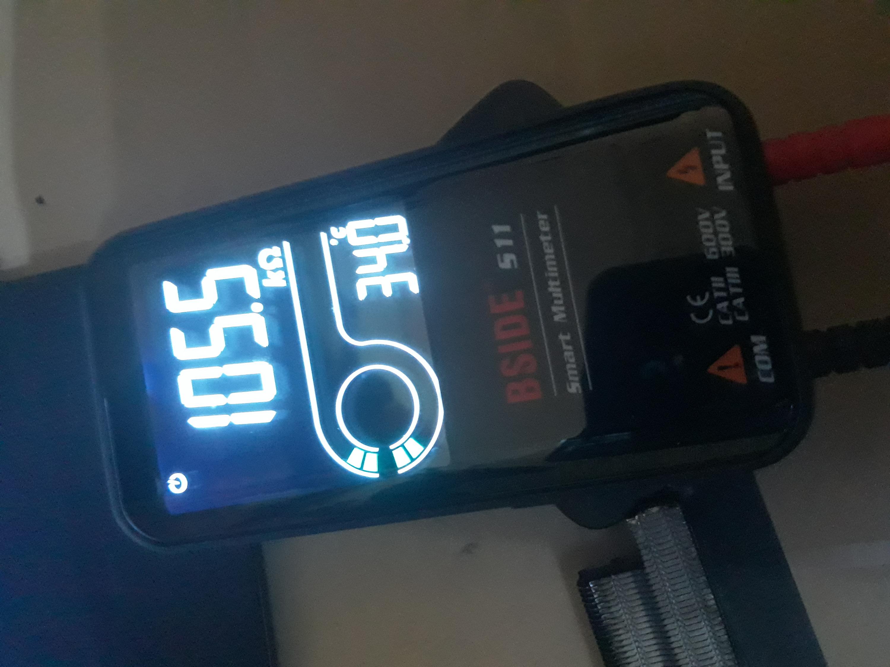

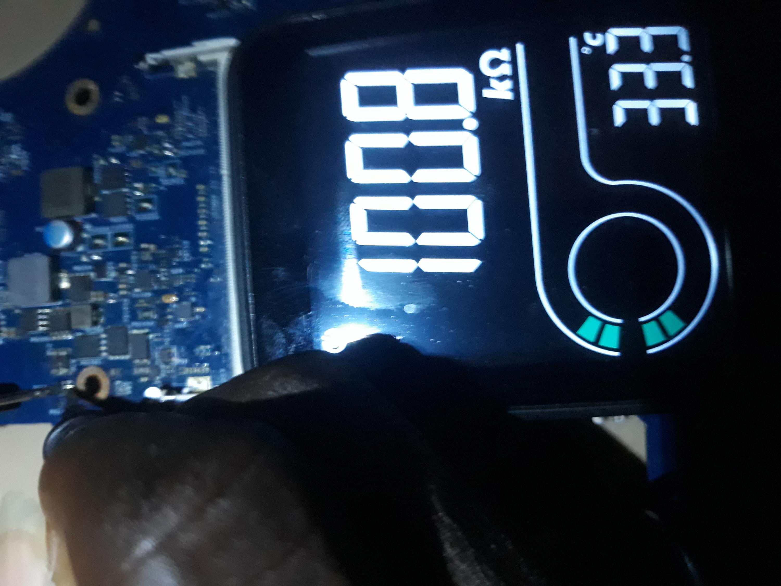

                                      here is what i have---
                                      • mon2
                                        • Dec 2019
                                        • 13954
                                        These are very high readings.
                                        The resistance should be ~100 ohms for each check, not in the Kohms.
                                        Can you short your meter probes and post the measurement?
