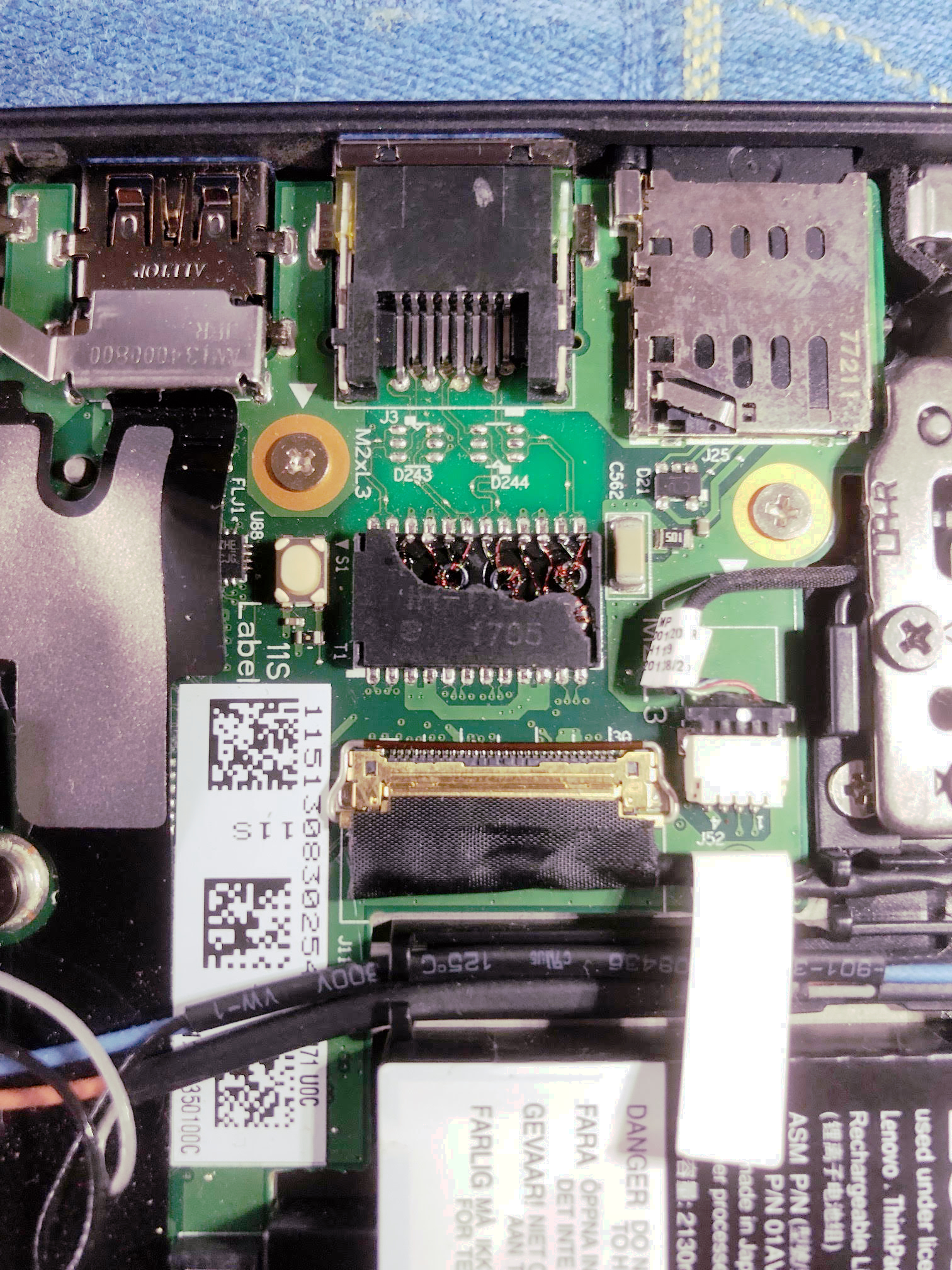

    Hello, I have a burnt chip Lenovo T470s and I am unable to read what
    it says on the chip.
    Can anyone help me out please with a photo of the chip
    and maybe where to get one from, Thanks.

    Hi, according to the schematic this part is T1, it is a TAIMAG IH-189-A component. You can buy it from
    https://www.aliexpress.com/item/1005002712708058.html

      This chip can work even with the cover broken. Make sure you test everything before ordering the new one

        Thank you both for your help much appreciated, I never realized until
        looking at the picture of a new chip that this one has a cover on it.
        This chip maybe ok after all, Thanks.

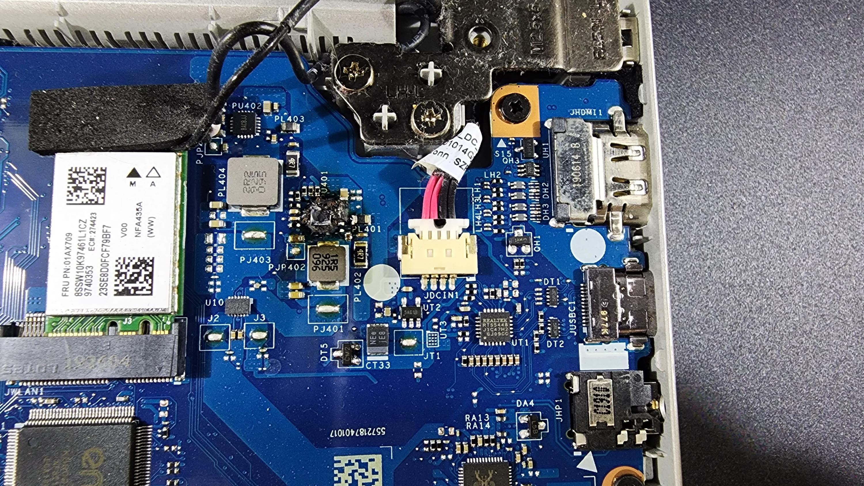

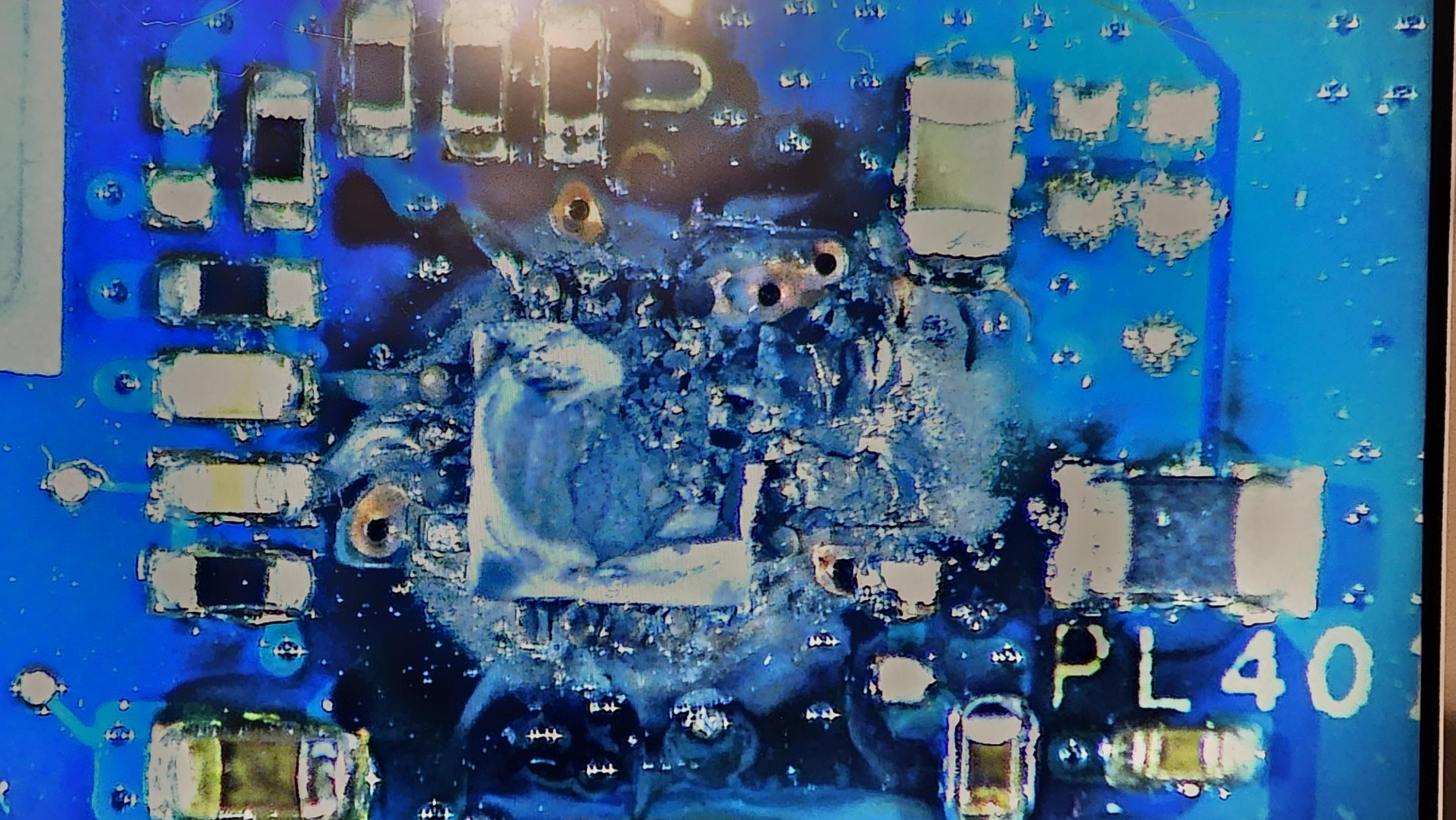

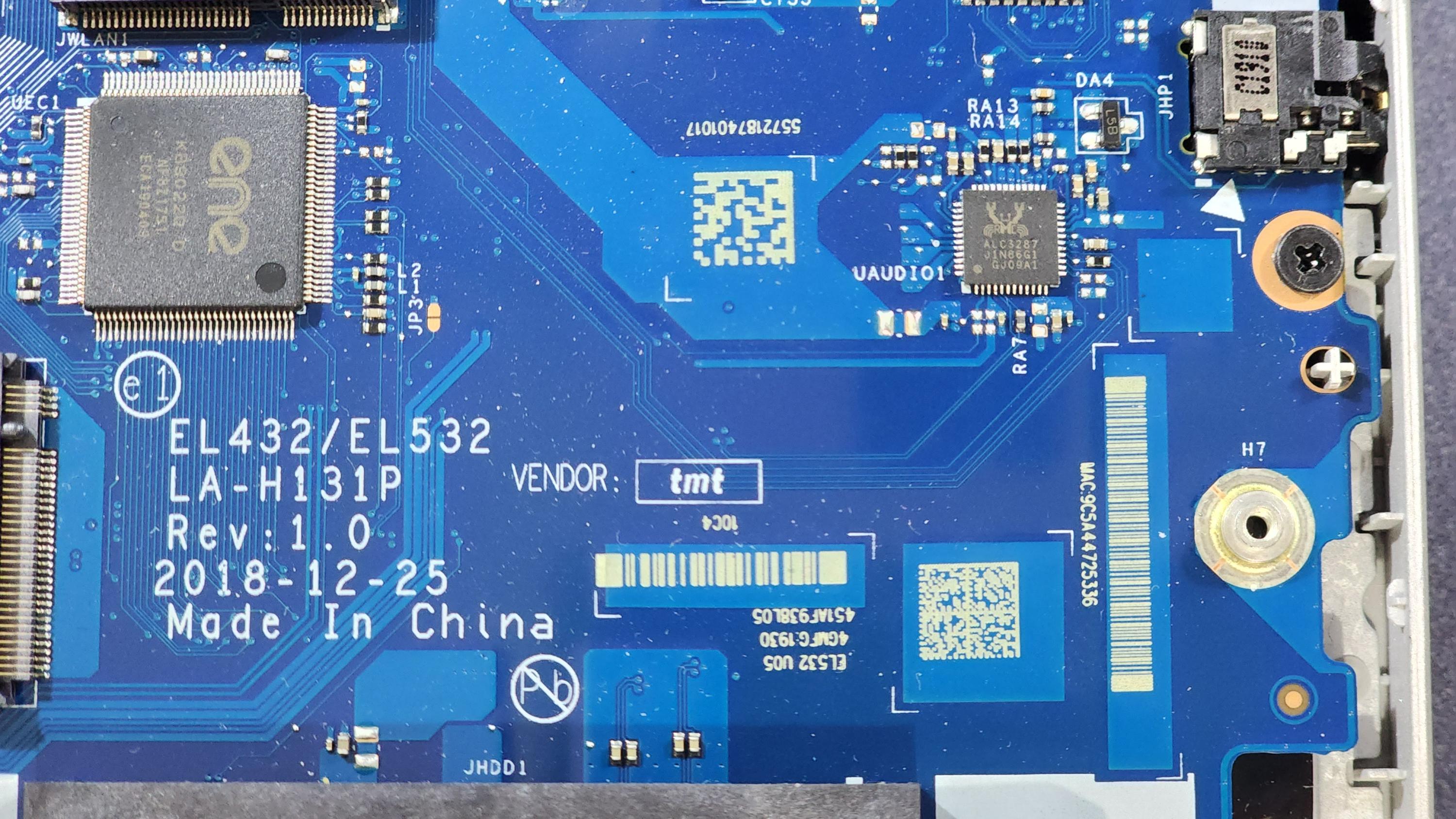

          I am new here and apparently, I am not able to start a new thread so I hope you don't mind If I ask a similar question here. I am also trying to ID a burnt chip on a Lenovo el432/el532 motherboard. Power Sup section.Thanks in advance for any help you can provide.

            Hi, @Michael Farrey PU401 is a SY8386BRHC. You can also check PL401 to make sure it is not open.

              @ JaroTech thank you so very much! will check pl401 for open. I guess the next thing I need to do is determine the orientation of the chip, which way it sits on the board. Every picture I could find of the board was low resolution. Thank you again!

                PL401 is connected to pins 2, 3 and 4.
