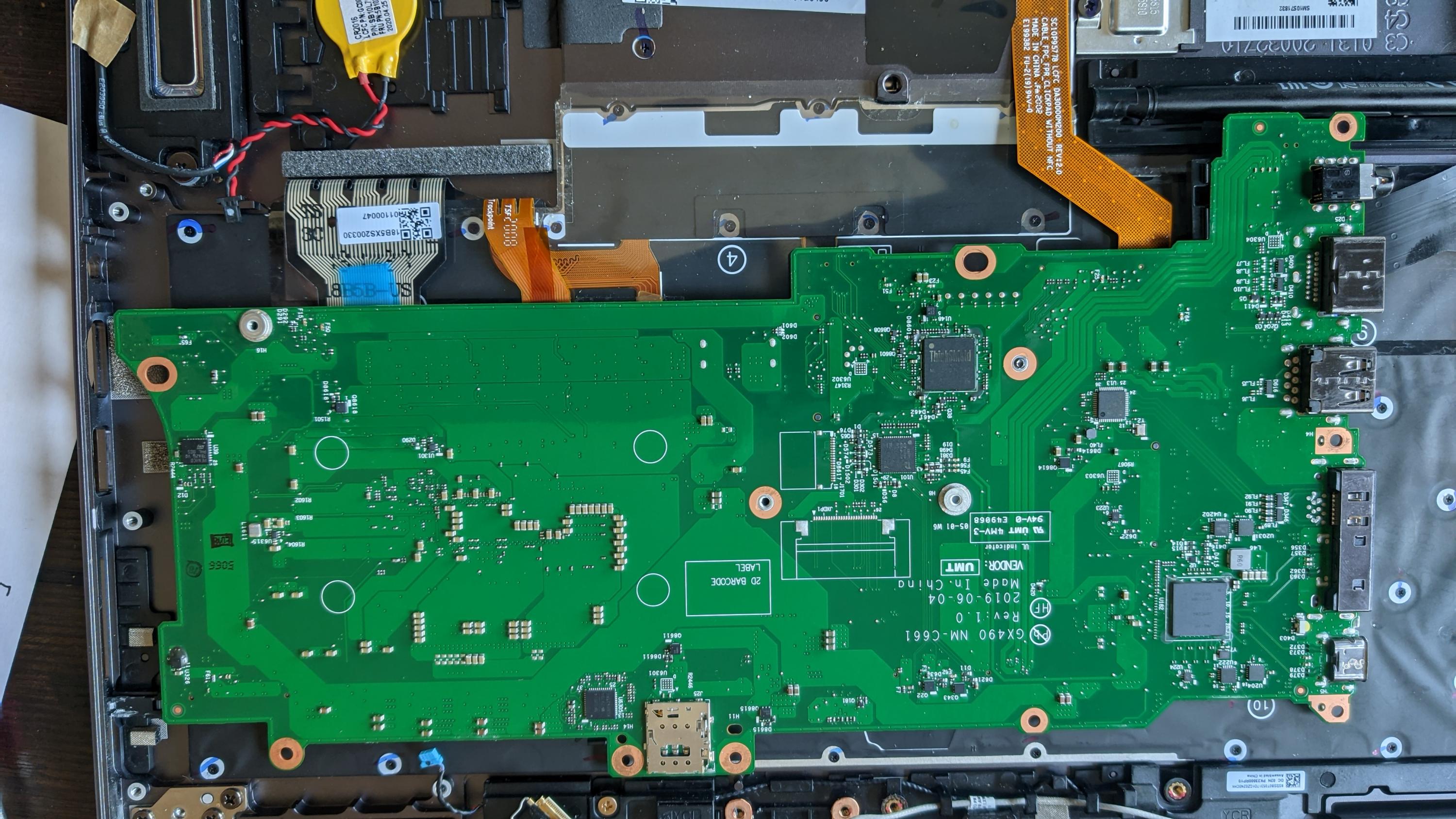

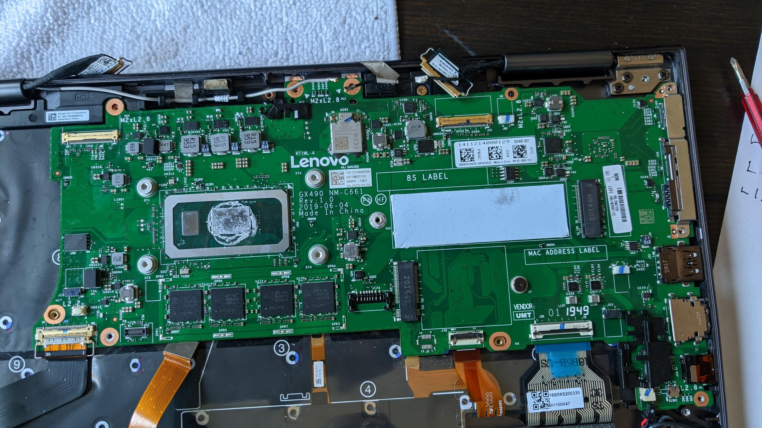

    Attached is the schematics and PDF boardview of FX490 NM-B861 thanks to Volinakis for uploading.
    My board is GX490 NM-661C but it appears to be the same after comparing a number of components.

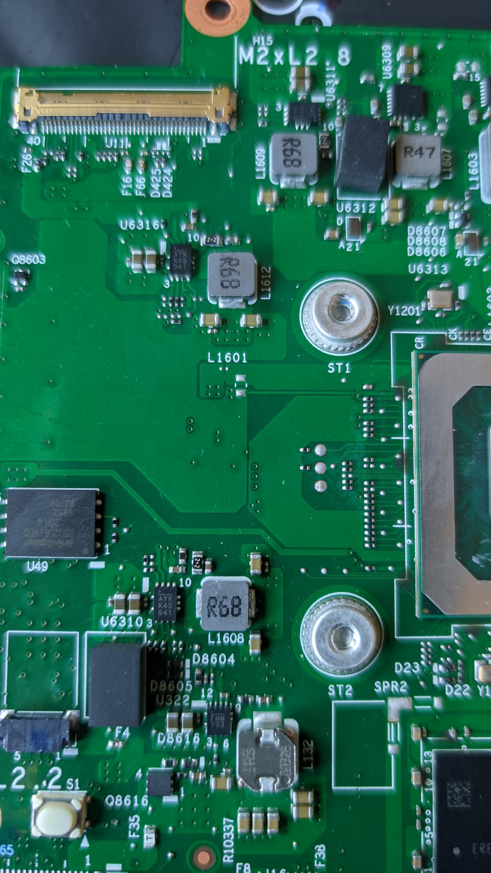

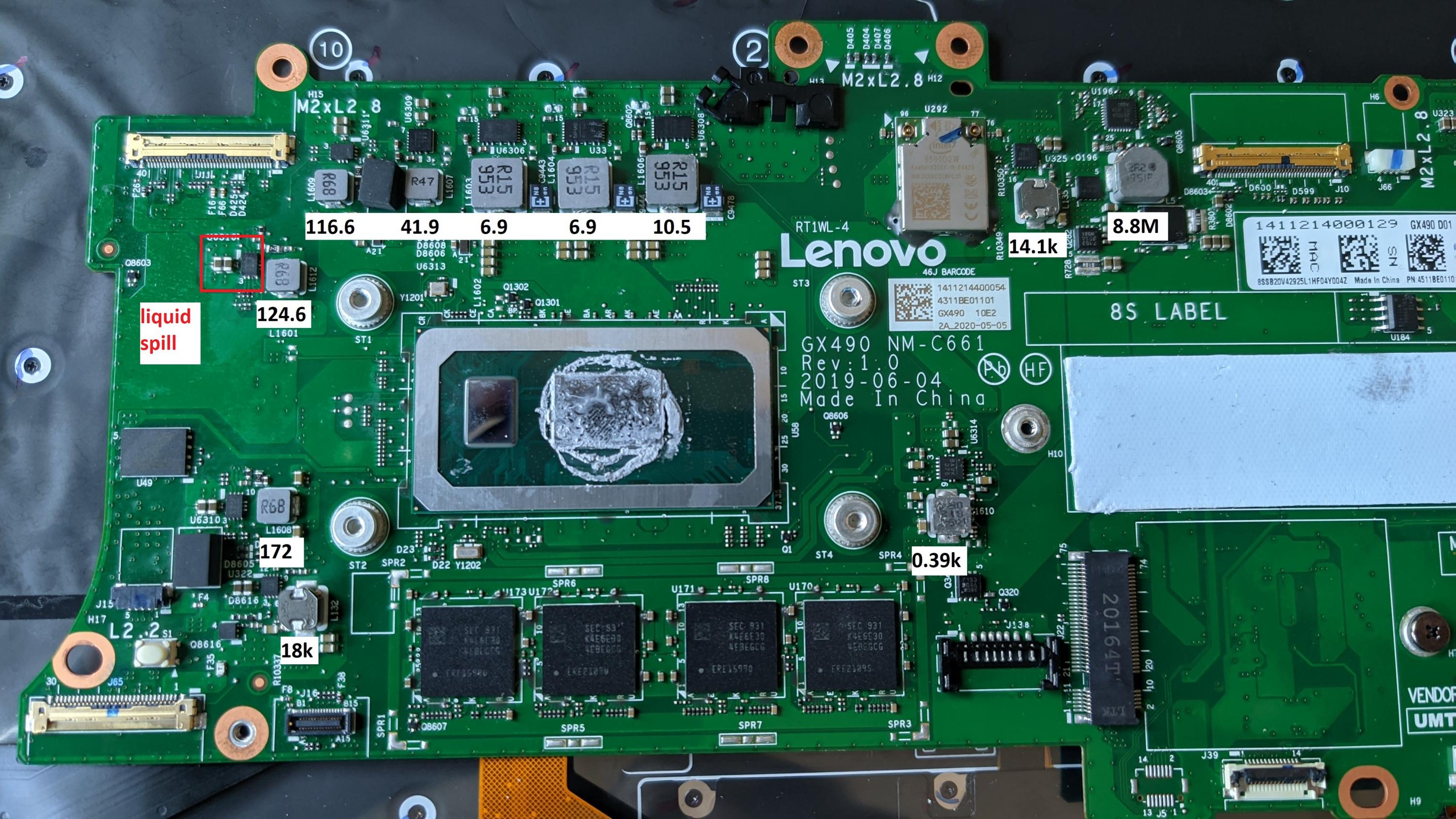

    The laptop had evidence of liquid spill (dried) around U6316 shown in red square in picture. I thoroughly cleaned it with Isopropanol and observed under microscope to ensure it was clean.
    I measured the resistance to ground of all the big inductors and have added the values in Ohms in one of the pictures attached. There is no evidence of short to ground from the measurements I have taken so far.

      All the inductor voltage measurements were taken with a fully charged battery connected. I thought to mention this in case it impacts the numbers.
      Resistance to ground of VCCCPUCORE without power adapter connected = 7.5 Ohms measured at L1603.
      I listed them here but if it is better to write them on a picture of the board, please let me know and I'll do that for the next measurements.

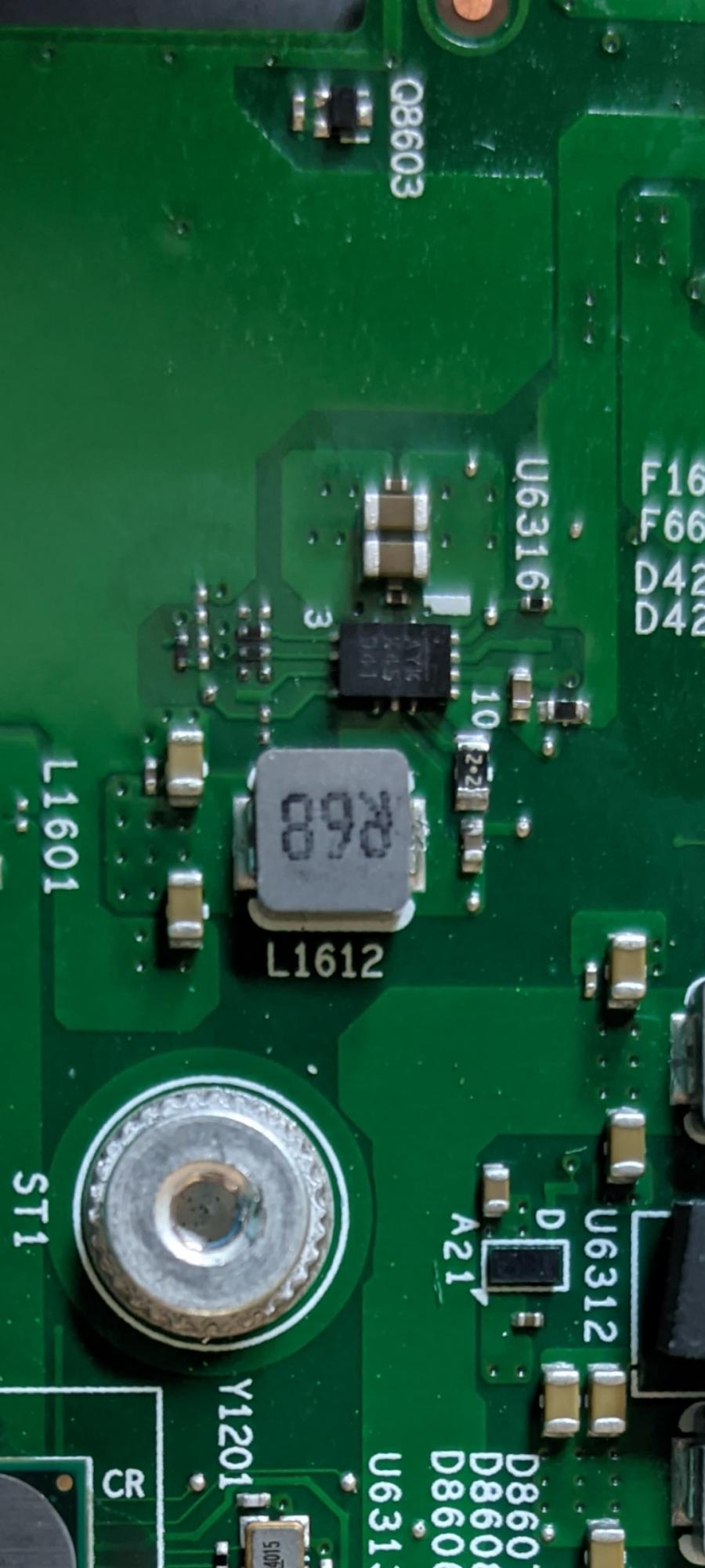

                            Unfortunately, I forgot to take pictures of the damage before cleaning.
                            Attached is a picture of the area after cleaning.
                            It was mostly on U6316 and the surrounding capacitors/resistors.
                            It was very minor but visible.

                              Pin5 doesnt seems well connected. Remove the IC after applying flux and clean the pads and resolder it again. Check value of resistors surrounding it.

                                Did as directed and measured the resistors in around U6316
                                Vales are below:
                                R10727 = 0
                                R10726 = 0
                                R10720 = 0
                                R10731 = 99.1k
                                R10763 = 0
                                Based on schematics, the values check out.
                                I also measured the Voltage to ground of all pins on U6316 with power adapter and battery connected. Then measured resistance to ground on all pins with power adapter and battery removed. Values are below
