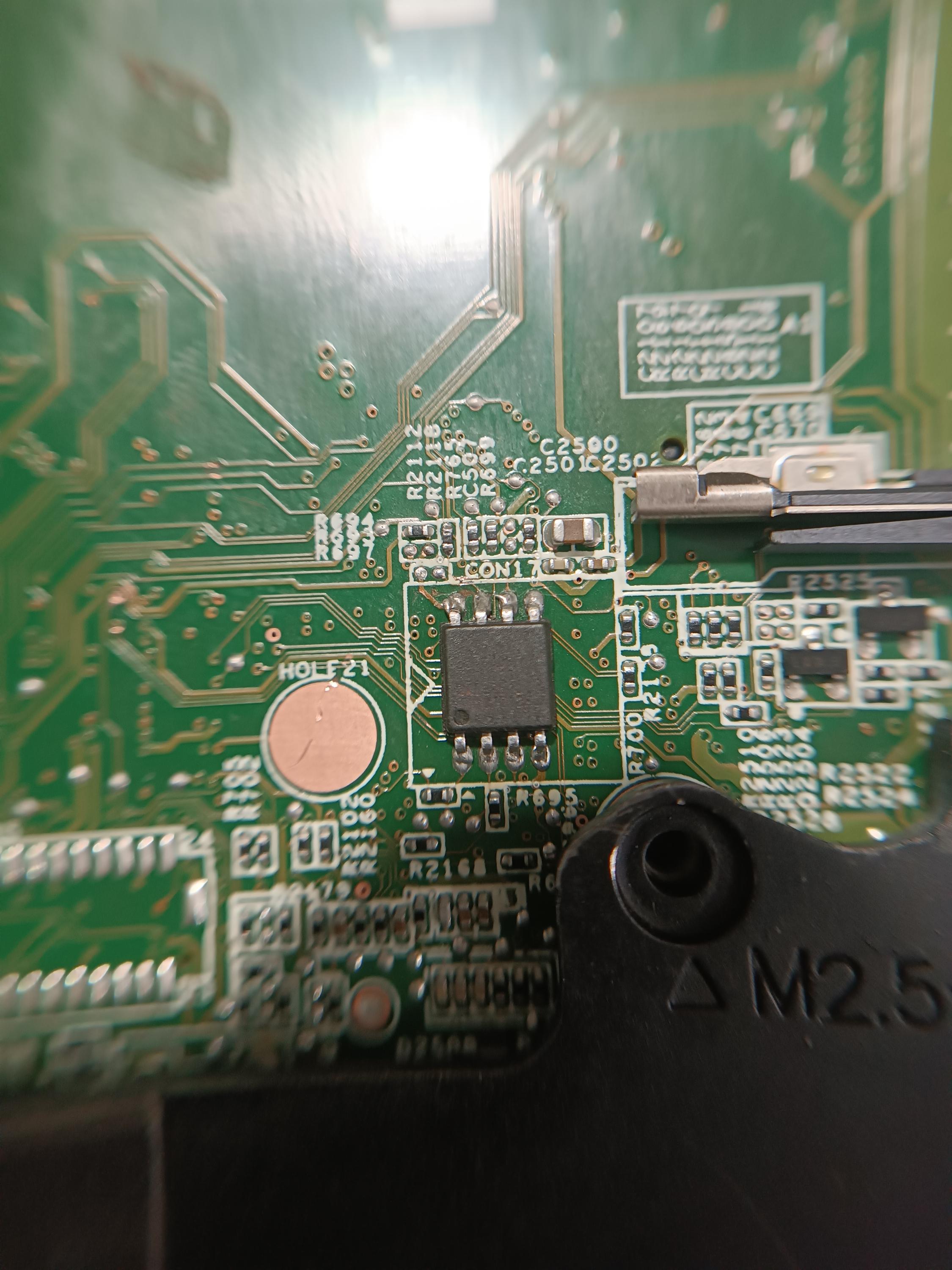

    Hello An HP ELITEBOOK 8560w device It used to have a picture, but the previous repairman programmed the BIOS wrongly and lost a resistor. I do not know the characteristics of the resistance The resistor is connected to the 7-pin base. Hold base Thank you for your guidance

    Post a picture of the area and the 7 pin connector to locate this resistor.

      Re: Find value resistor HP 8560w
      Uploaded

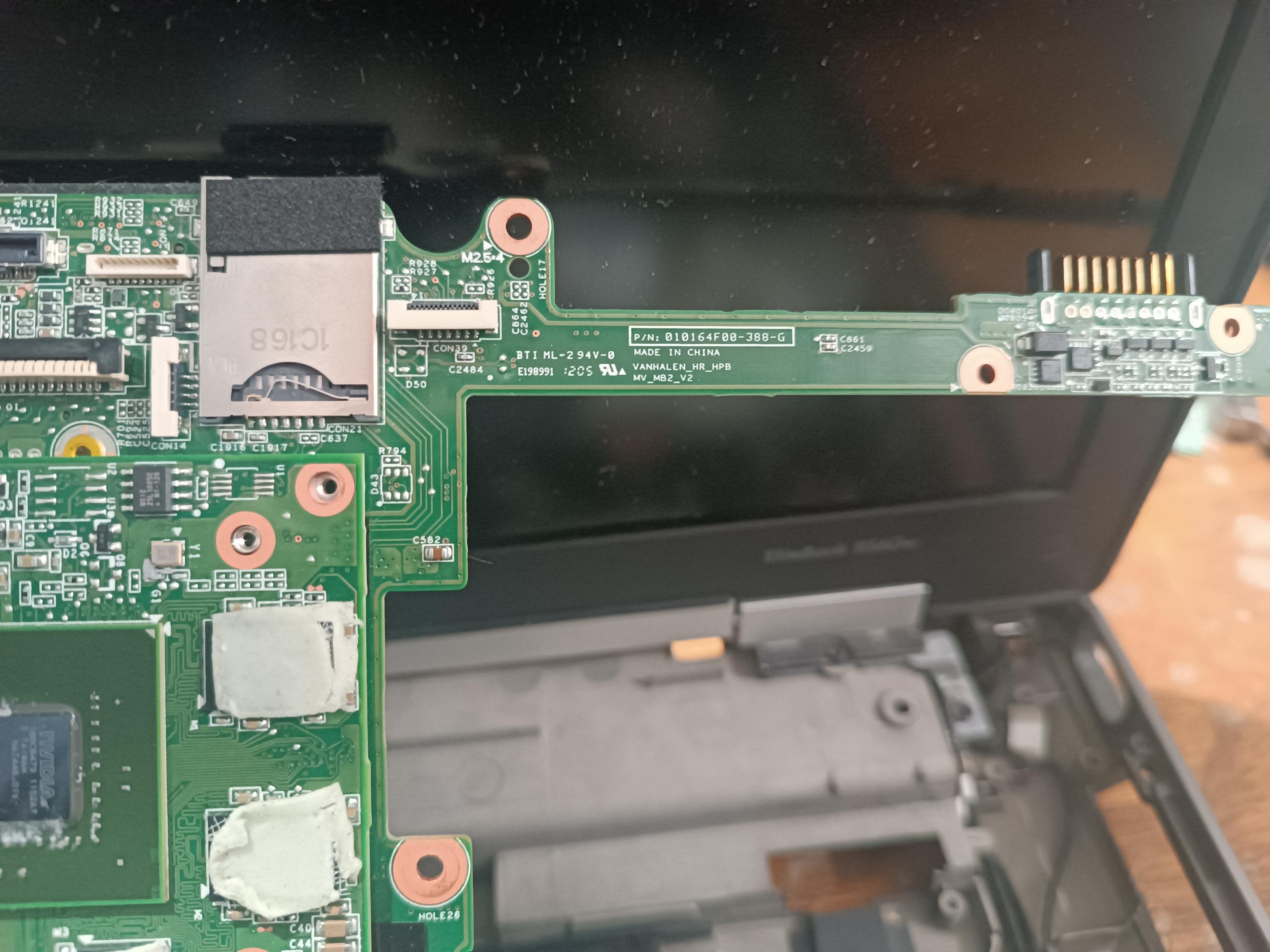

      Please, if you have a photo of this motherboard, post it here. Maybe another part was removed, but as far as I checked, this resistor was removed.
      Finally, the correct model of the motherboard
      VANHALEN_HR_HPB
      MV_MB2_V2

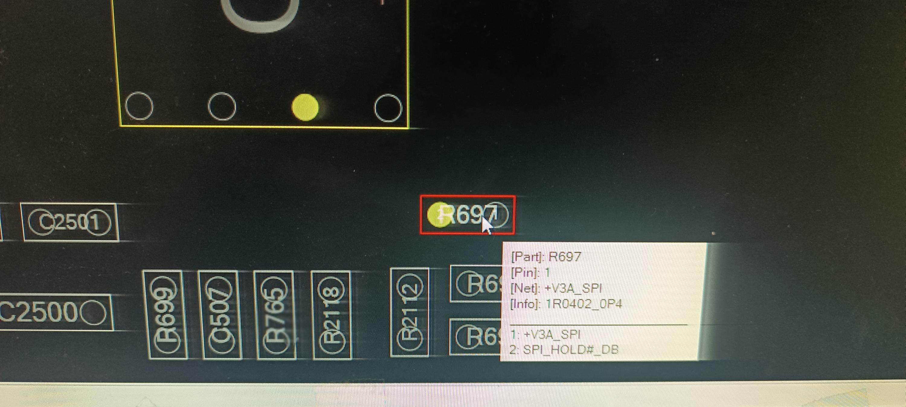

        No, have only the boardview file for this board.
        The pin # of the flash chip was of interest. Now we know it is pin #7 = hold#.
        If the pin #7 is held low, the spi transaction will be in hold mode. This missing resistor is going to pin #8 = VCC of the flash chip.
        The value is not critical.
        Apply any value you have from 1k to 47k ohms here.
        Also, apply some flux and clean up the solder blob on pin #6 of this chip. The solder blob is too close to pin #7.

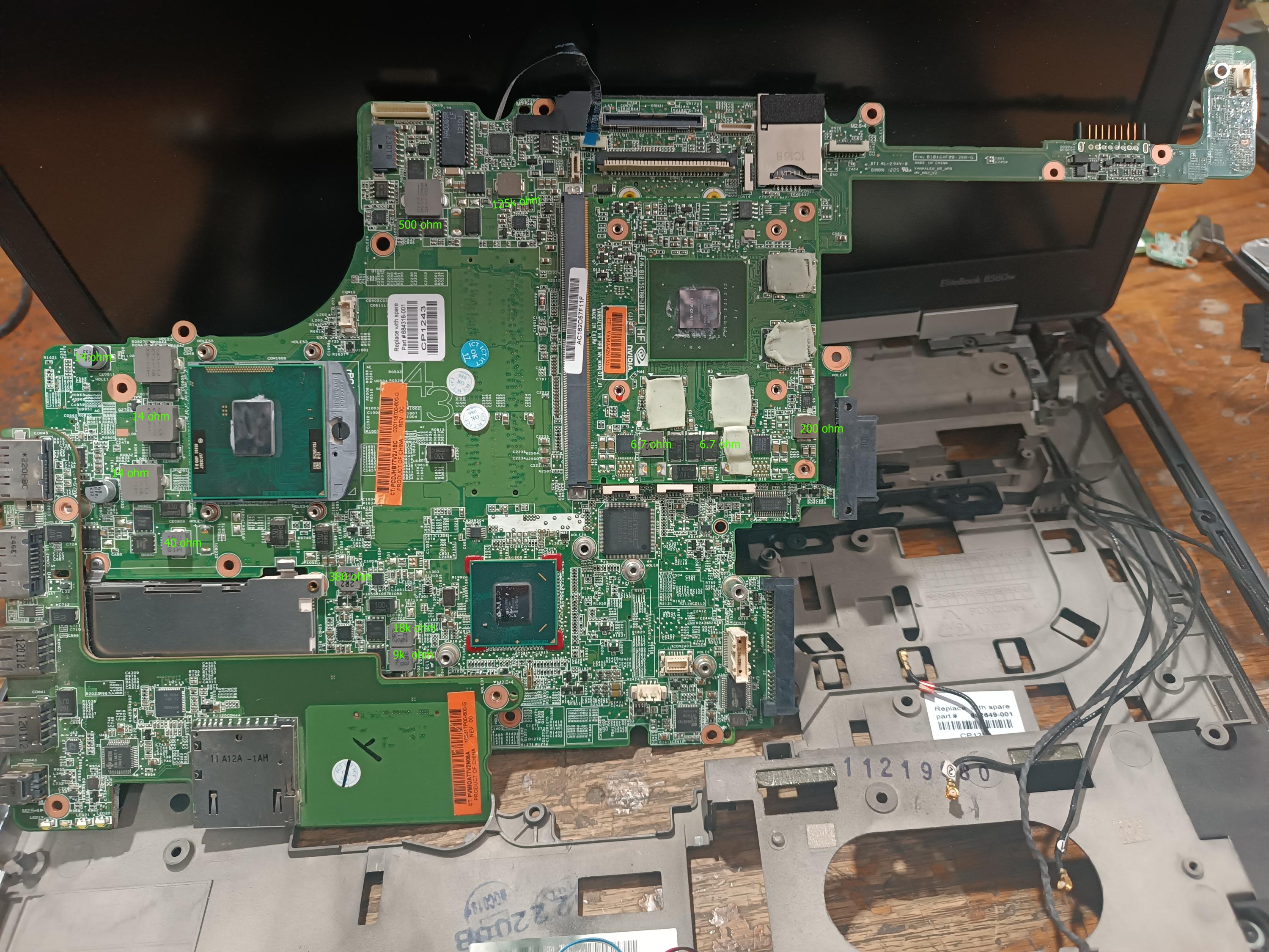

                            Remove all power. Meter in resistance mode. Check the resistance to ground of each of the coils / inductors.
                            Each inductor is linked to a power rail. Checking for low resistance readings.
                              Look at the attached photo of post 11
