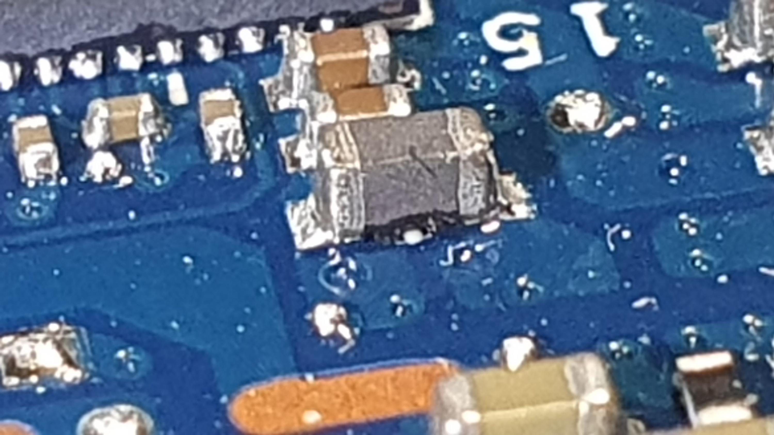

    Hello, on this laptop, there is a black fuse 0603 with letter « L », it is blow up (close LVDS connector). I can't find it nor equivalent on alixpress. Can you help pls ?

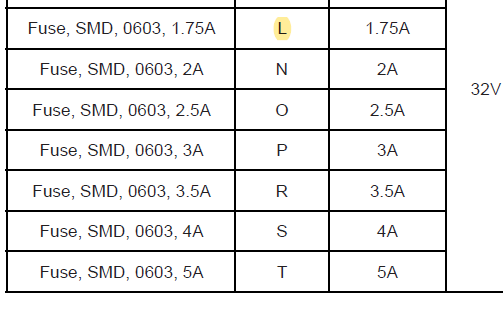

    Re: Laptop Zenbook UX480 Fuse L
    Maybe, it’s this one.
    https://fr.aliexpress.com/item/4000812956401.html
    The 1.75A ?
      Originally posted by corrize
      Hello, on this laptop, there is a black fuse 0603 with letter « L », it is blow up (close LVDS connector). I can’t find it nor equivalent on alixpress. Can you help pls ?
      I think it should be that one (0603, 1.75A, 32V).
      If you can't find it, you can use (0603, 2A, 32V) with letter (N), it's the closest one.
      Also you must measure and see if there's any short to ground before or after the fuse.

        Can you post a pic of the area where this fuse is on the logic board?
        In comparing a mix of other Asus logic board, there is a polyswitch fuse of 0.5A in 0603 package. Also found 0.75A in 0805 package on a few boards.
        P/N SMD0603P050TF
        So the concern is on the actual rating of the component.
        Also, if you really had a polyswitch fuse onboard then that fuse will reset after a period of time once the power and excessive load event is removed.

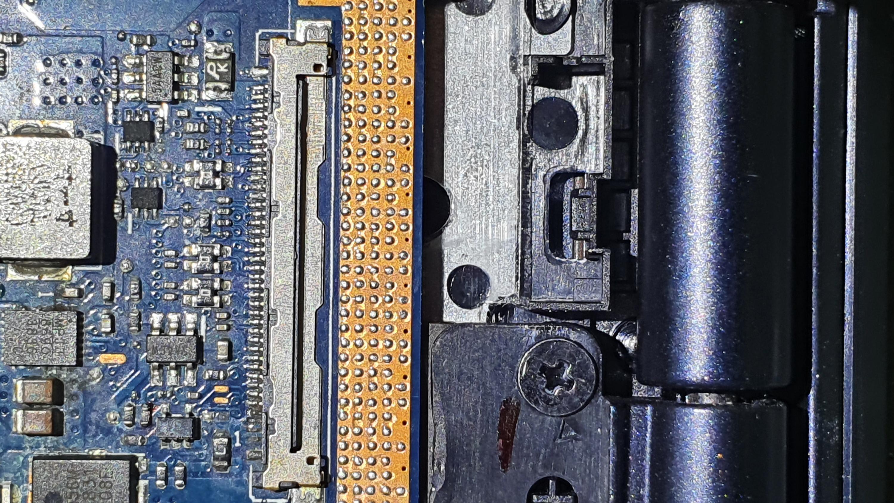

          Thx for reply, I will order it so.
          It’s not a reset fuse, the laptop is off long time ago.
          It’s a screen fuse, see picture, it is below, at left of LVDS connector
            Actually, a "P" means Polyswitch / polymer switch. They self-heal after a period of time. If the fuse has a lot of wear then yes, the fuse will no longer self-heal.
            Remove all power. Check the resistance across the fuse pads.
            To me, the part looks larger than an 0603 -> perhaps a 1206 size?
            https://www.aliexpress.com/item/32804658202.html
            https://p-nt-www-amazon-ca-kalias.am.../dp/B0B6DJBPBT
            1206 SMD fuse with code K:
            https://www.littelfuse.com/media?res...206l-datasheet
            To check the size:
            a) measure it with a micrometer
            OR
            b) review that the part beside is a SOT23-6 device. Hunt down any part in SOT23-6 package and review the length of the part.
            Then compare the fuse length to validate if the fuse is 0603 / 0805 or 1206.
            My bet is on 1206.
