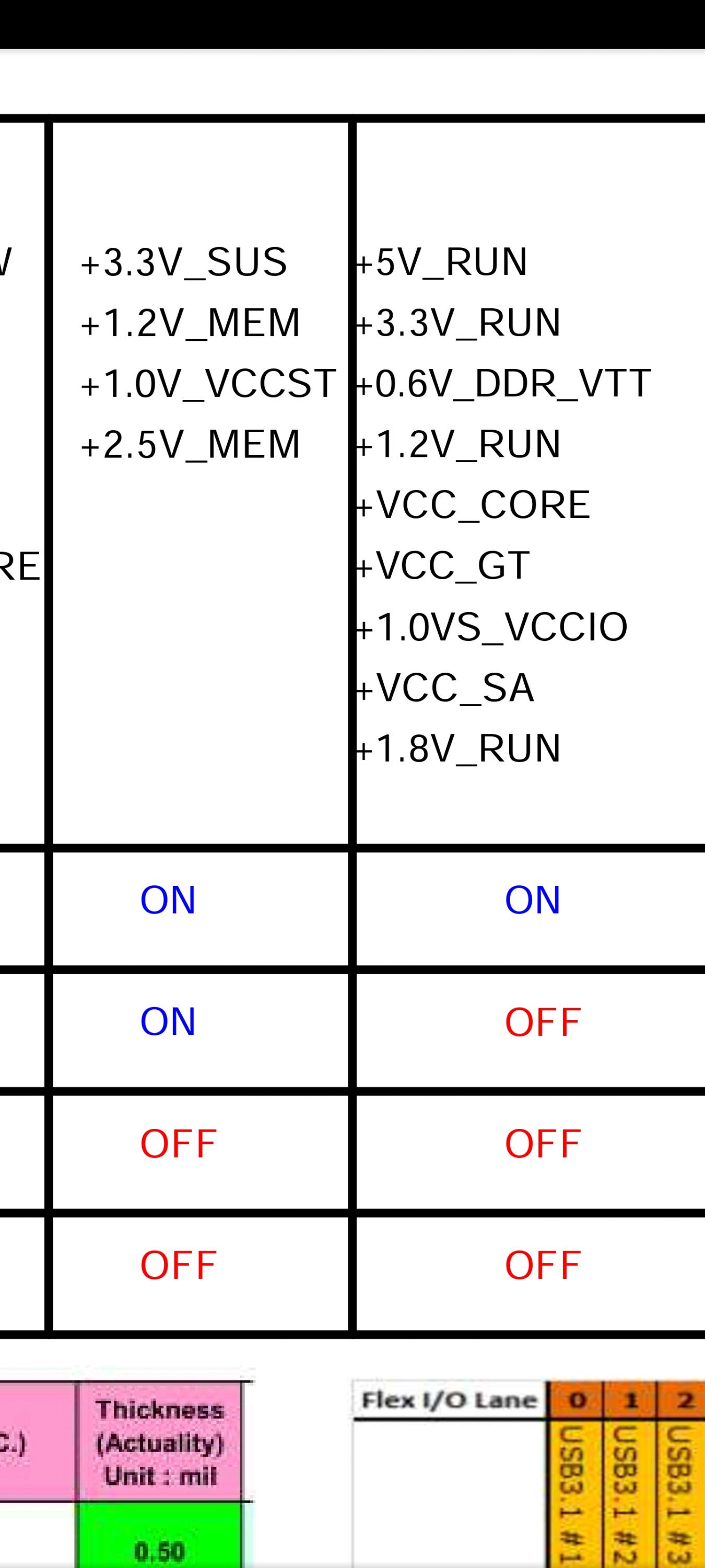

    Got this mtherboard not power on
    Dell latitude 5591 , LA-F711P.
    No short , no suspicion area , all is clean.
    All voltage at S5 are present .
    PM TABLE =
    +5V_ALW
    +3.3V_ALW
    +3.3V_ALW_DSW
    +3.3V_ALW_PCH
    +RTC_CELL
    +1.8V_PRIM
    +1.0V_PRIM
    +1.0V_PRIM_CORE
    +5V_ALW2
    +3.3V_ALW2
    +3.3V_RTC_LDO
    +1.0V_MPHYGT
    Timing Diagram for S5 to S0 mode =
    All is Ok until step 8
    8 = SIO_PWRBTN# = 3.3v
    PCH_RSMRST#_AND = 3.3v
    But the PCH don't send SIO_SLP_S5#
    All the power supply for PCH are present , when power button is triggered , POWER_SW#_MB 3v becomes 0 than 3 and that's the normal but SIO_PWRBTN# the signal send from io to pch to tell the PCH to get out of S5, and then go to S4-S3-S0 stay at 3V
    did i miss something to chek !

                                Back for this Laptop.
                                With charger consumption = 0.028amp..and not trigger on.
                                All the voltages that i mention before are present.
                                I started from the beginning ..PQ9 and PQ4.
                                PQ9 = S 19.5v / G 9.31v / D 19.5v So good
                                PQ4 = D 19..5v / G 18.5 v / S 13.21v..this is my issue .
                                So gate of this PQ4 must be low and there's a voltage divider = must be 1.75V
                                no high voltage on PQ7 = voltage divider not woking
                                As mon2 mention at his post , the voltage of VBUS2_ECOK must be a high enough voltage to enable the mosfet @ PQ4.
                                #48
                                https://www.badcaps.net/forum/troubl...e3#post1729109.
                                So.The GATE pin must be lower to enable.
                                I Attach a ground wire to the bottom pin of the bottom resistor PR16 Test and it replaced mosfet enables.
                                So why VBUS2_ECOK is not high !...there's no short , all resistrances values are correct !
                                I try to power on my motherboard via a type-c charger and i didn't find my oridinary voltages!
                                PQ1206 =votage not stable swing between 0.600v to 1.5v
                                Diode mode = Drain to S = 0.549v ok
                                resistance mode = D to S = 2.677 mohm ok
                                PQ 1213 = Same behaviour of voltage swing
                                PQ 1202 = same behaviour of voltage swing.
                                So what to check else
                                • lapfix
                                  • Mar 2020
                                  • 2742
                                  • my workshop
                                  Update
                                  I verify some measurements at P48 :
                                  PQ1B is High ( turned on ) so PQ1A is Low (turned off)
                                  Wich cause at the gate of PQ5 same as source so is turned off.
                                  But PQ7 is OFF due to the absence of VBUS2_ECOK at his gate.
                                  UT5 = PD controller
                                  +TBTA_Vbus_1 = must be 20v in normal condtion..or 5v/ nothing in case of issue..but i got a non stable voltage , swinging between 0.6--1.2 v..PQ1206 is not shorted .​
                                  • lapfix
                                    • Mar 2020
                                    • 2742
                                    • my workshop
                                    Update 2
                                    I try with another original charger ( lenovo ) PD controller is OK
                                    all voltage are present...But same as with charger ...no VBUS1_ECOK
                                    same too : no power light indicator , no caps light
