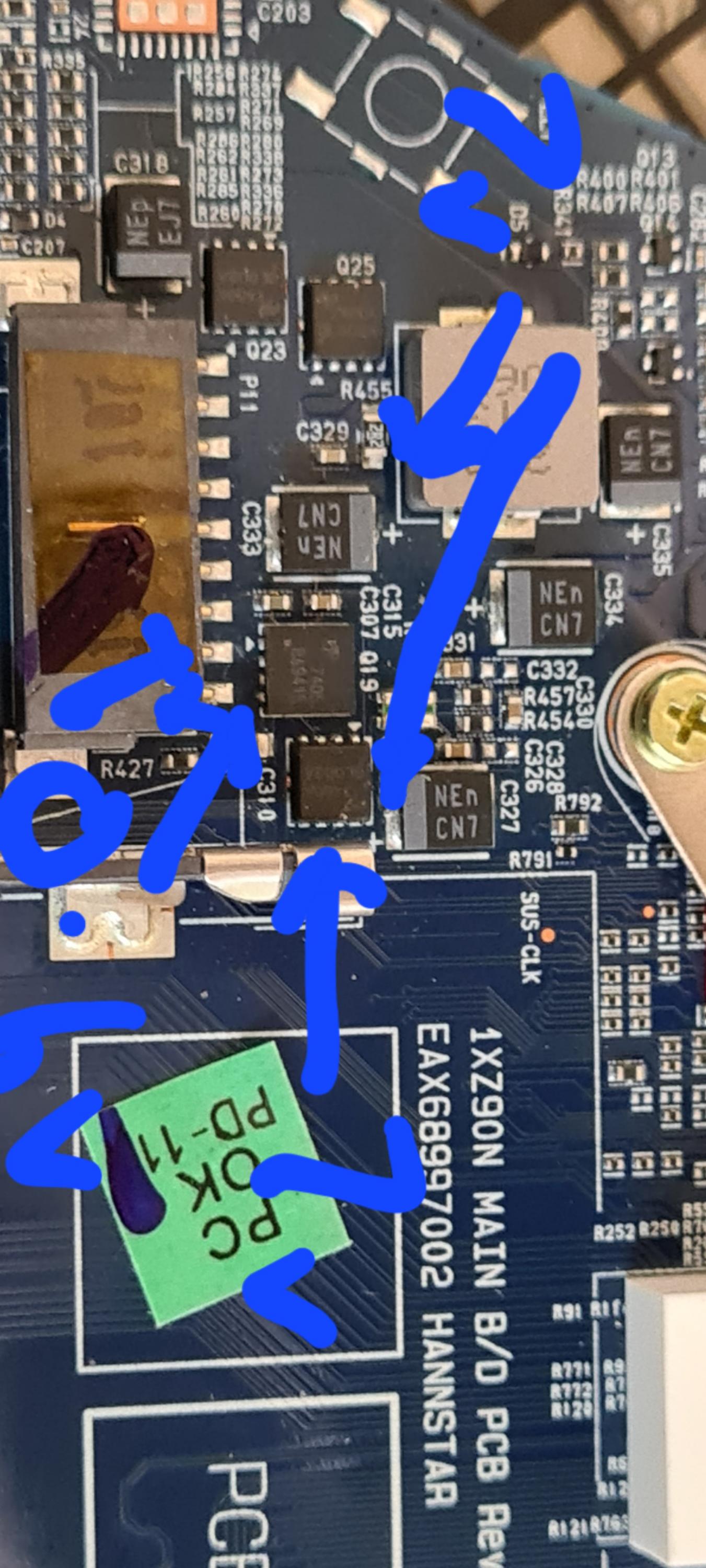

    I am working on an LG gram with a charging issue. The battery was replaced, but the problem didn't go away.
    Charging IC: ISL95520
    ACIN (Pin 1): 3.2v
    ACOK (Pin 2): 3.2v
    DCIN (Pin 18): 19v
    VDD (Pin 19): 5v
    CMRSC (Pin 29): 19v
    Charger plugged in: MOSFETs short to ground / and caps in region of r439
    I look forward to your help

              Battery: Is brand new and measures 7v
              Charger plugged in - shows charging graphics - stops and message says plugged in.
              Battery connector:
              3 + Pins: 0.6v
              Signal Pins: 3.3v
              7v goes to first MOSFET (see attached image) (one above C310 marking)
              2nd mosfet 0.6v on both ends, including gate.
              C333, C327 and C334 - 7v

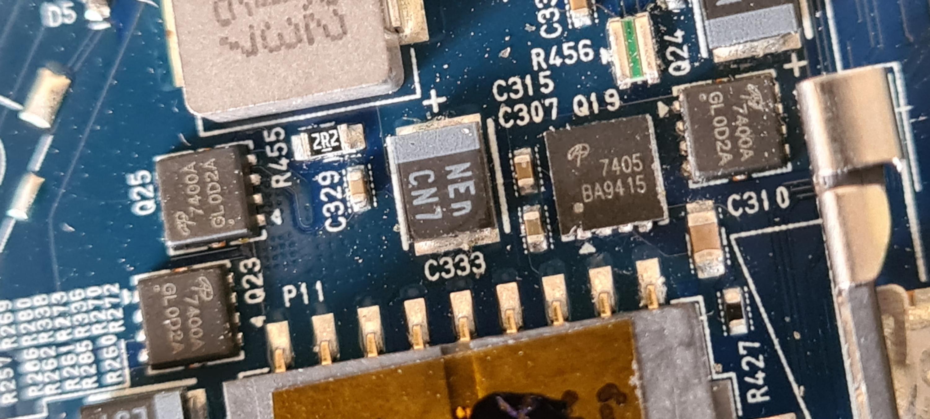

                Post the full topside markings of the mosfet so we can review the datasheet.
                • Ado02
                  • Jul 2021
                  • 100
                  • United Kingdom
                  Re: LG gram - Not Charging
                  As requested. Thank you.
                  • mon2
                    • Dec 2019
                    • 14662
                    See attached for the datasheets for each mosfet.
                    1) AON7400 is a N-channel mosfet. So pin # 4 (Gate) must be HIGHER than the voltage being passed between source & drain pins.
                    2) AON7405 is a P-channel mosfet. So pin # 4 (Gate) must be LOWER than the voltage being passed between source & drain pins.
                    3) Can you measure the voltage on each pin (group) again and post the readings?
                    source (1-2-3) ; pick any

                      7400A
                      Pins 1-2-3 / 0.2v
                      Pin 4 / 0v
                      Pin 5-6-7-8 / 7.18v
                      7405
                      Pins 1-2-3 / 0.66v
                      Pin 4 / 0.63v
                      Pins 5-6-7-8 / 0.2v
                      • mon2
                        • Dec 2019
                        • 14662
                        So with Pin 4 = 0v, 7400A mosfet cannot turn ON.
                        Can you post or link the schematic for this logic board?
                        If not available, you will have to trace where the GATE pin travels on the board and this will likely be a (black body) resistor. The resistor will then be driven by the charger IC.
                        The charger IC will offer the boosted voltage to enable this mosfet.

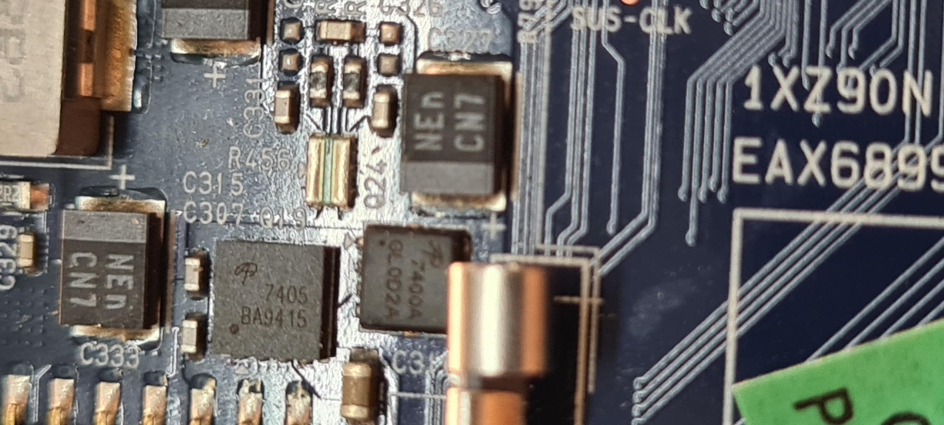

                          I traced the pin 4 (gate) to pin 25 BGATE (0v charger / no battery).
                          With the battery plugged in I get 11v on the pin 4 (gate) and 7v across the 2nd Mosfet.
                          Will the power pass to the battery connector if the battery is not connected?
                          Also, do you have any other suggestions?
                          • mon2
                            • Dec 2019
                            • 14662
                            Then BGATE has a valid voltage to enable to the battery mosfet. If the battery is not detected, the charger IC will not enable this mosfet.
                            This battery mosfet is like a solid state (no moving parts) on/off switch for the battery voltage - to power the logic board.
                            This mosfet should be enabled to power the logic board when the power adapter is not connected to the logic board.
                            Attach the charger and still keep the battery on the logic board.
                            Measure again the gate voltage to ground on this mosfet. Post the measurement.

                              7400A Pin 4 / 12.9v
                              7405 Pin 4 / 2.26v

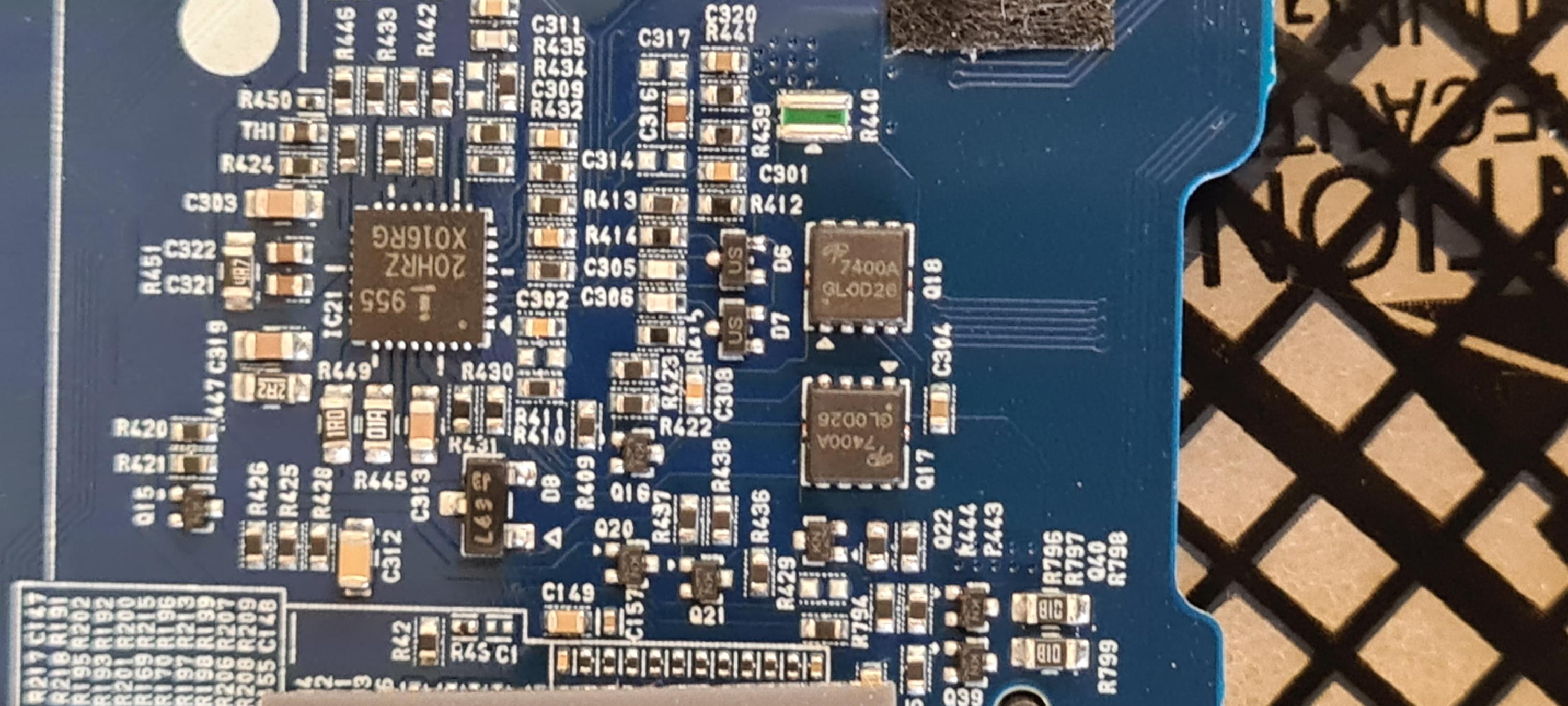

                              I also found 2 more Mosfets on the other side of the connector. Please see the image
                              Q23
                              Charger / no battery
                              Pins 1-2-3 7.16v
                              Pin 4 7.16v
                              Pin 5-6-7 19.11v
                              Battery No Charger
                              Pins 1-2-3 7.62v
                              Pin 4 7.62v
                              Pin 5-6-7 7.11v
                              Battery + Charger
                              Pins 1-2-3 7.22v
                              Pin 4 8.22v
                              Pin 5-6-7 18.98v
                              Q25
                              Pins 1-2-3 0v
                              Pin 4 0v
                              Pin 5-6-7 7.18v
                              Battery No Charger
                              Pins 1-2-3 0v
                              Pin 4 0v
                              Pin 5-6-7 7.62v
                              Battery + Charger
                              Pins 1-2-3 0v
                              Pin 4 0v
                              Pin 5-6-7 7.47v
                              • mon2
                                • Dec 2019
                                • 14662
                                Test to see if these new mosfets are leaking.
                                Remove all power.
                                Meter in resistance mode.
                                Measure the resistance across the mosfet pins.
                                Source (1-2-3) & Drain (5-6-7-8)
                                Source (1-2-3) & gate (4)
                                gate (4) & drain (5-6-7-8)
                                Post each measurement.
