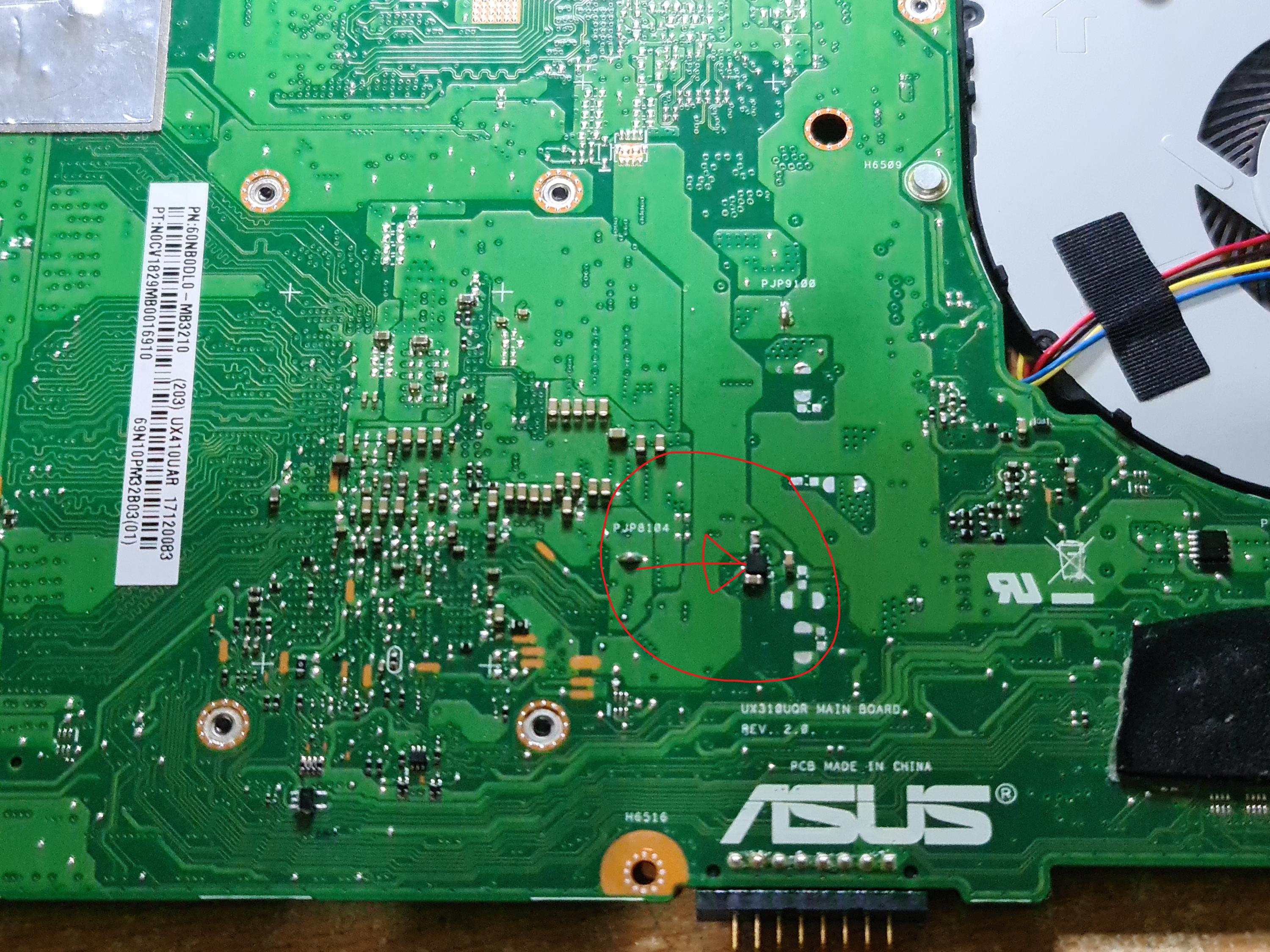

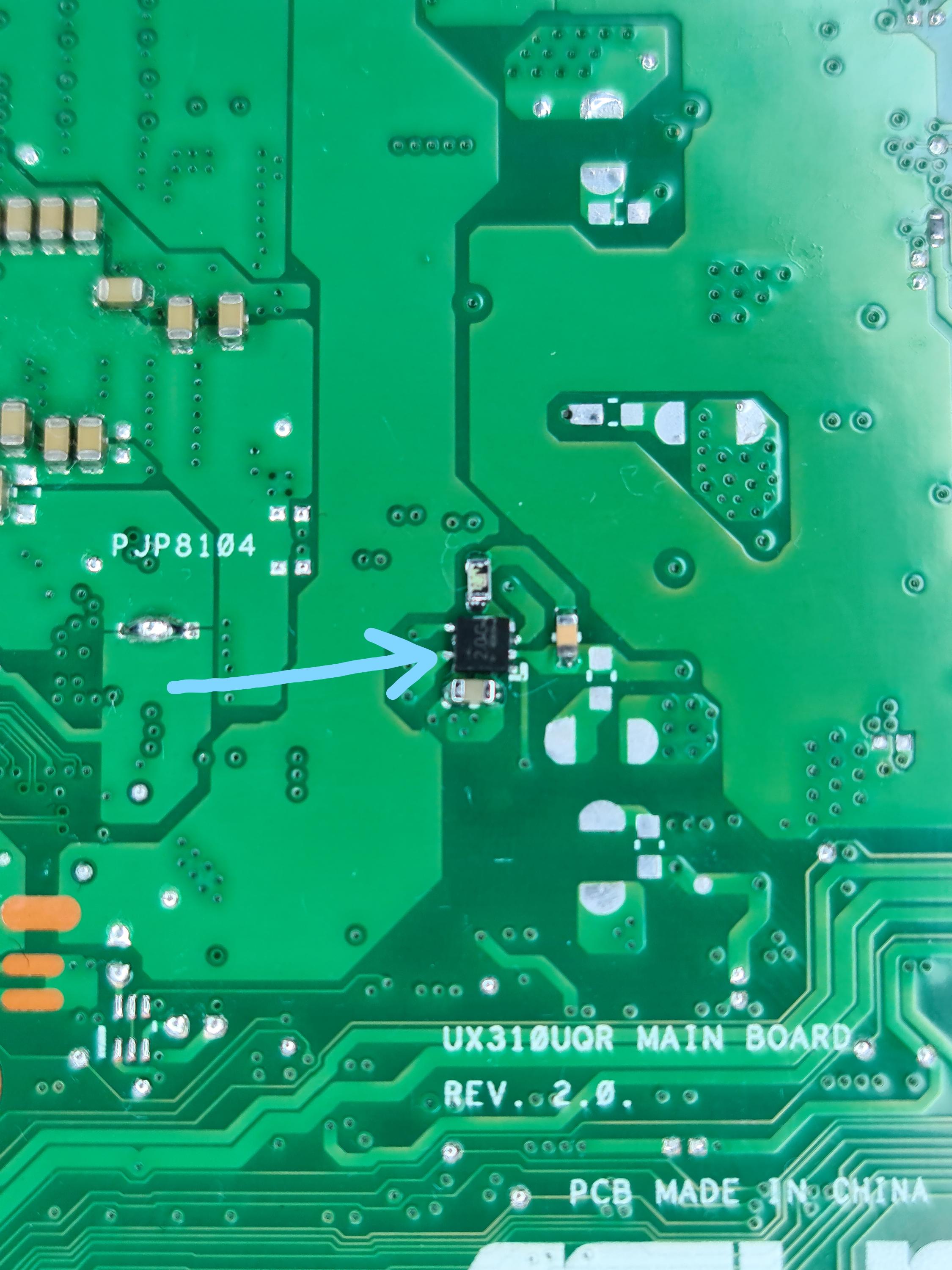

    I am trying to identify a part on an Asus UX310UQR Motherboard for a laptop. There was corrosion on that chip. It only has 2.0 G stamped on top of it. I have no board view and no schematic.
    Is anyone able to help, or point me in the right direction? I have taken one pic on the mainboard in full and circled the component and another with it magnified.
    Do let me know if I need to submit anything else.
    Your help is much appreciated.

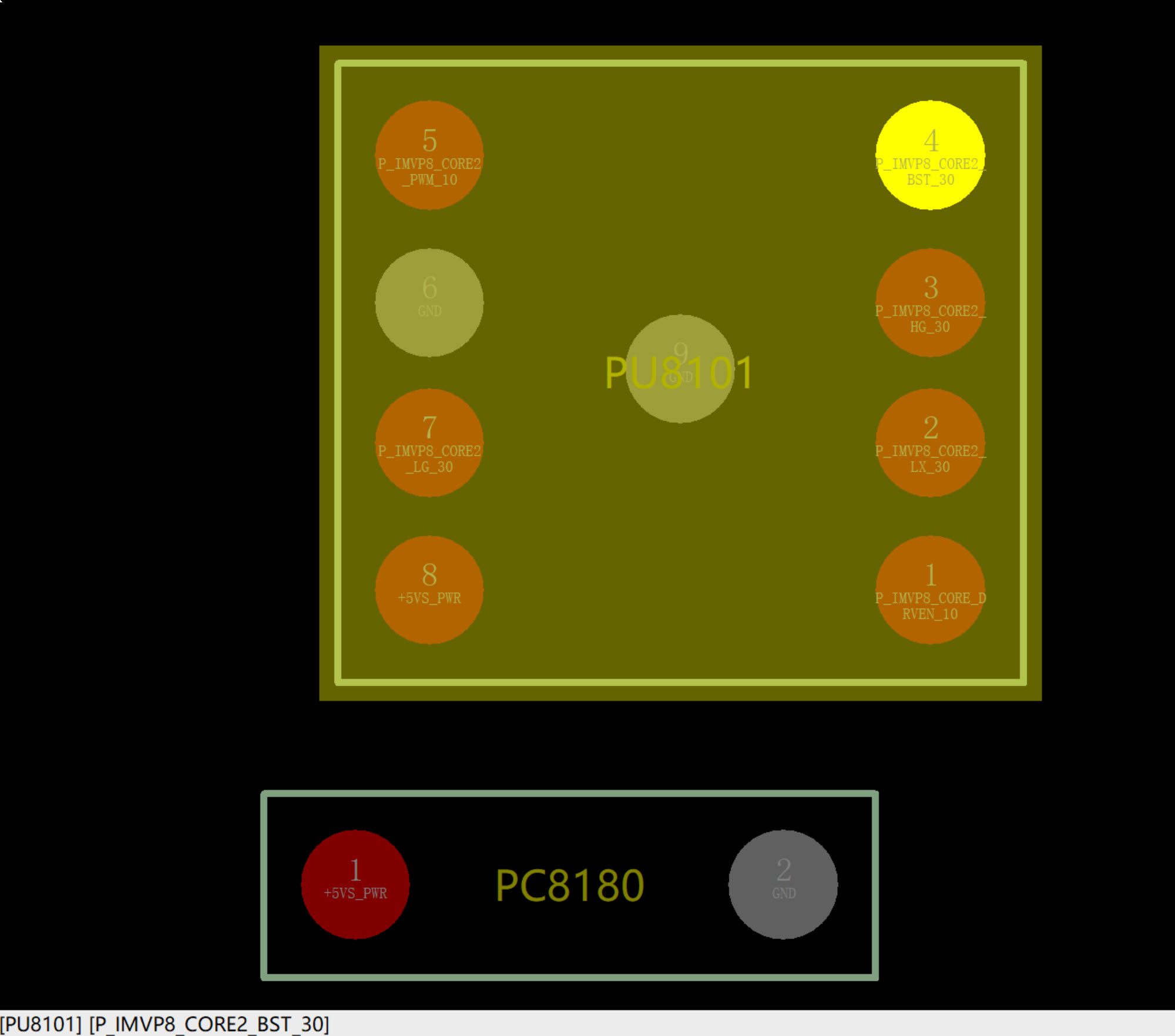

    Label is PU8101. Found this by reviewing the paper sticker on your board and searching under UX410.
    Still searching...

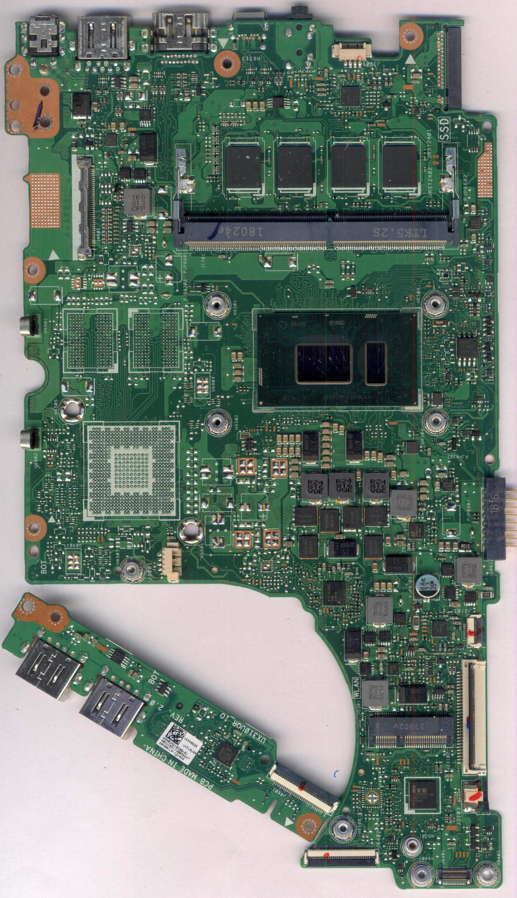

      Thank you very much. The only thing I need now is a picture of the motherboard CPU side. Specifically, the MOSFETS that are bunched together on the RHS of the CPU. I need to be able to see the part number. I need to make sure that my mosfets are located in their correct positions

        Re: Identify part on an Asus UX310UQR Motherboard
        That's a driver related to the VRM circuit. VRM Controller and driver usually come from the same manufacturer, so check the Controller
          Here you are:
