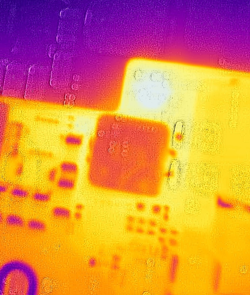

          the board is hot at the point like in the picture from the cam. Maybe that's why only 4V?

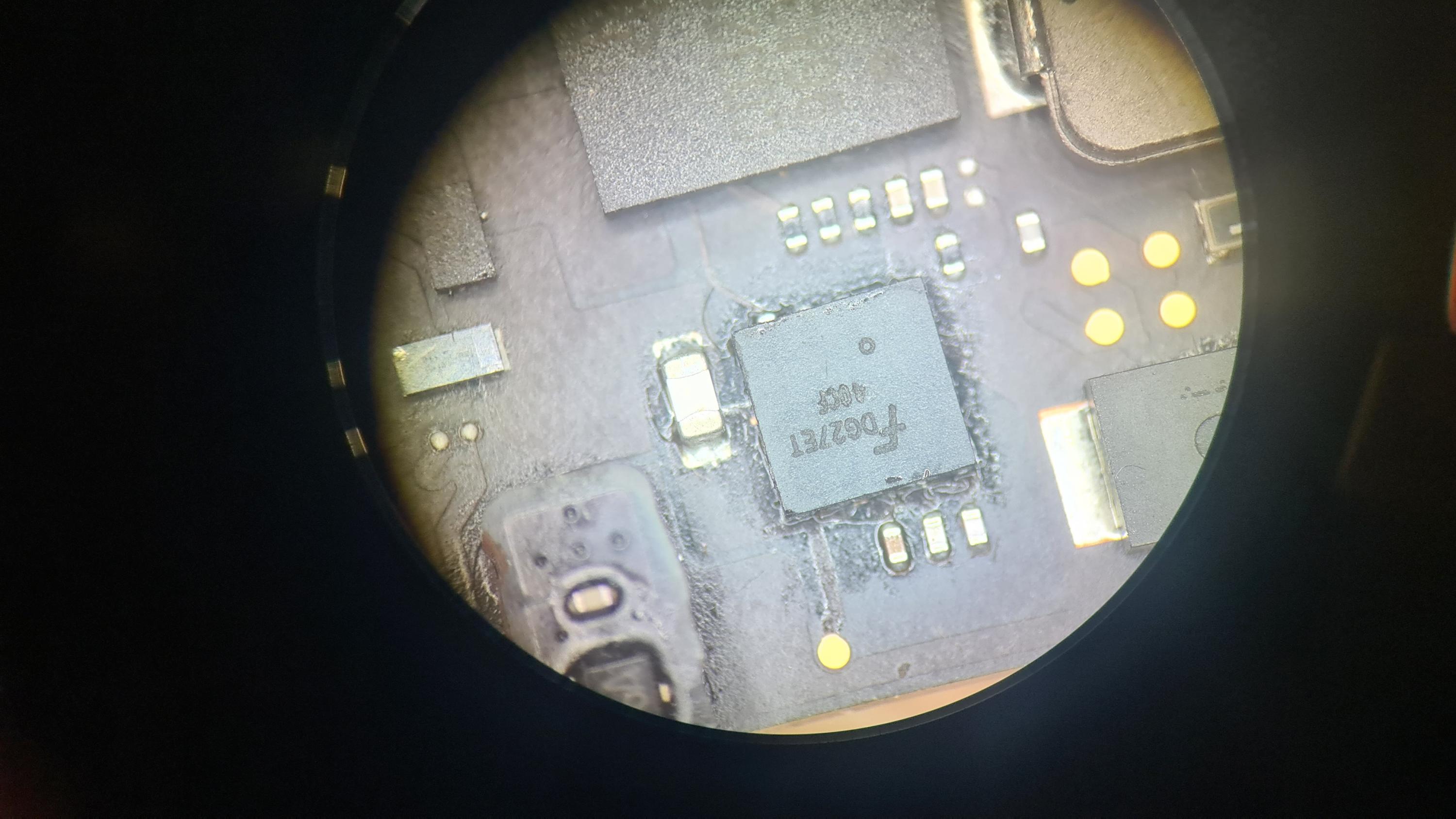

              F3001= 4,96V but F3000 is 0V But I see that the Q3100 is probably not ok. I think it was soldered! I took a picture. I think I have to swap it!

                  I swapped Q3100 and I saw the cc742 was missing. Now it goes up to 20V and down again and sometimes 6V so unstable.

                    Does L7030 still get hot?

                        L7030 is hot

                          Just saw the thermal.. wow.
                          Remove all power, check the resistance to ground of this coil.

                              Remove all power -> what is the resistance to ground of L7030 ? It is getting hot due to some event in this region / power rail.
