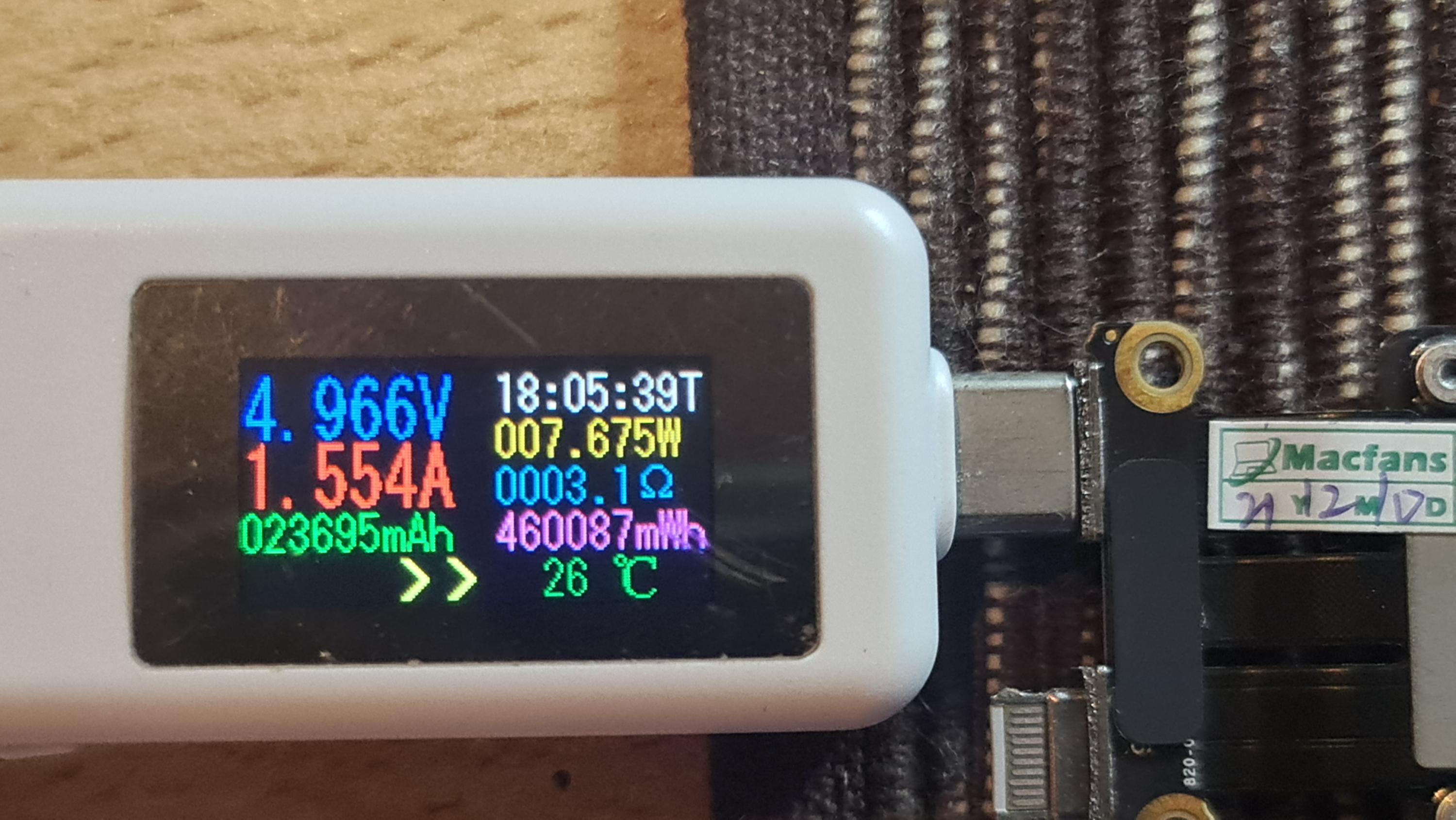

    I have an Apple MacBook A1990 15" 2018 board 820-01041. It just went out during operation and won't start anymore. When I connect the charging cable, there is only 5V but it shows 1.55A see picture. I exchanged the Q3200 but it didn't help .

      I already have, even if it is removed 5V. It also doesn't start up in the other Mac with a full battery

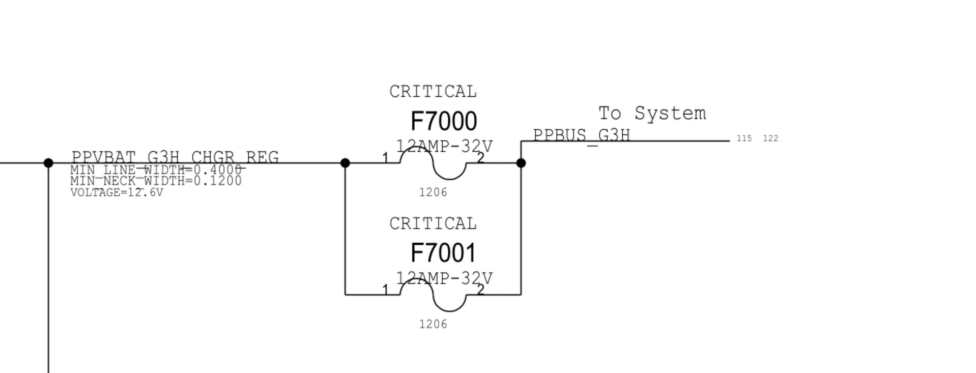

        Re: Macbook A1990 820-01041-A No Power on
        What is the voltage to ground of PPBUS_G3H @ F7000 ?
            Remove all power. Measure the resistance across fuse F7000 and also F7001.
            Are any of these fuses blown? Resistance should be ~0 ohms if ok.
            Next, remove both fuses, F7000 & F7001 off the logic board.
            Power up again with your adapter and measure the voltage to ground of F7000 PCB pad, pin # 1.
            Pin #1 is the producer side of this voltage rail which is created by U7000 (ISL9240).
            What is the voltage of PPBUS_G3H now ?

                The fuse F7000 and F7001 are ok 0 ohms

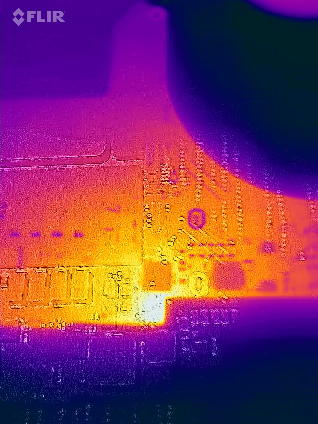

                    I had left the power supply on the board and now wanted to unsolder the fuses. I just noticed that L7030 is very hot!
                    • Strolch
                      • Nov 2017
                      • 237
                      • Deutschland
                      Here you can see the short circuit.

                        Ok - remove all power.
                        Meter in resistance mode.
                        Measure the resistance to ground @ F7000 pin # 1. Best if the fuse is removed.
                                Ok if the fuse is removed, the 9M ohms is on which pin of F7000 PCB pads?
                                Pin #1 is towards the U7000 (ISL chip). Pin # 2 is the consumer side.
                                Suspecting that pin #1 is with the high resistance? If yes, power up without these fuses.
                                Measure the VOLTAGE to ground @ Pin #1 of F7000 PCB pad.
                                What voltage is now present?

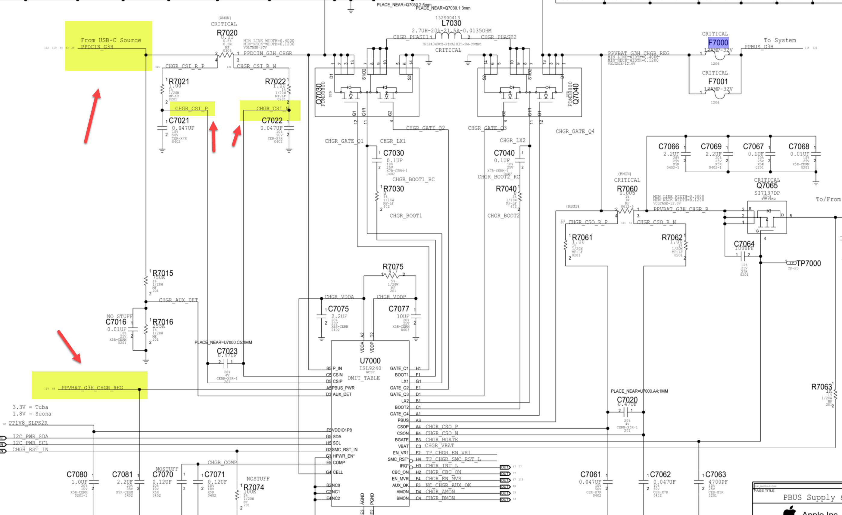

                                      Resistance is great but voltage is not.
                                      Confirm the voltages on the input of U7000.
                                      With a 5 volt adapter voltage, this regulator should kick into BOOST voltage mode to supply a higher voltage @ pin #1 of the F7000 pad.
                                      Be sure that you are truly on pin #1 of the fuse pad.
                                        I hope it's right
                                        R7015 Pin1=4V
                                        R7021 Pin2=4V
                                        R7022 Pin2=4V
                                        C7081 Pin1=0V
