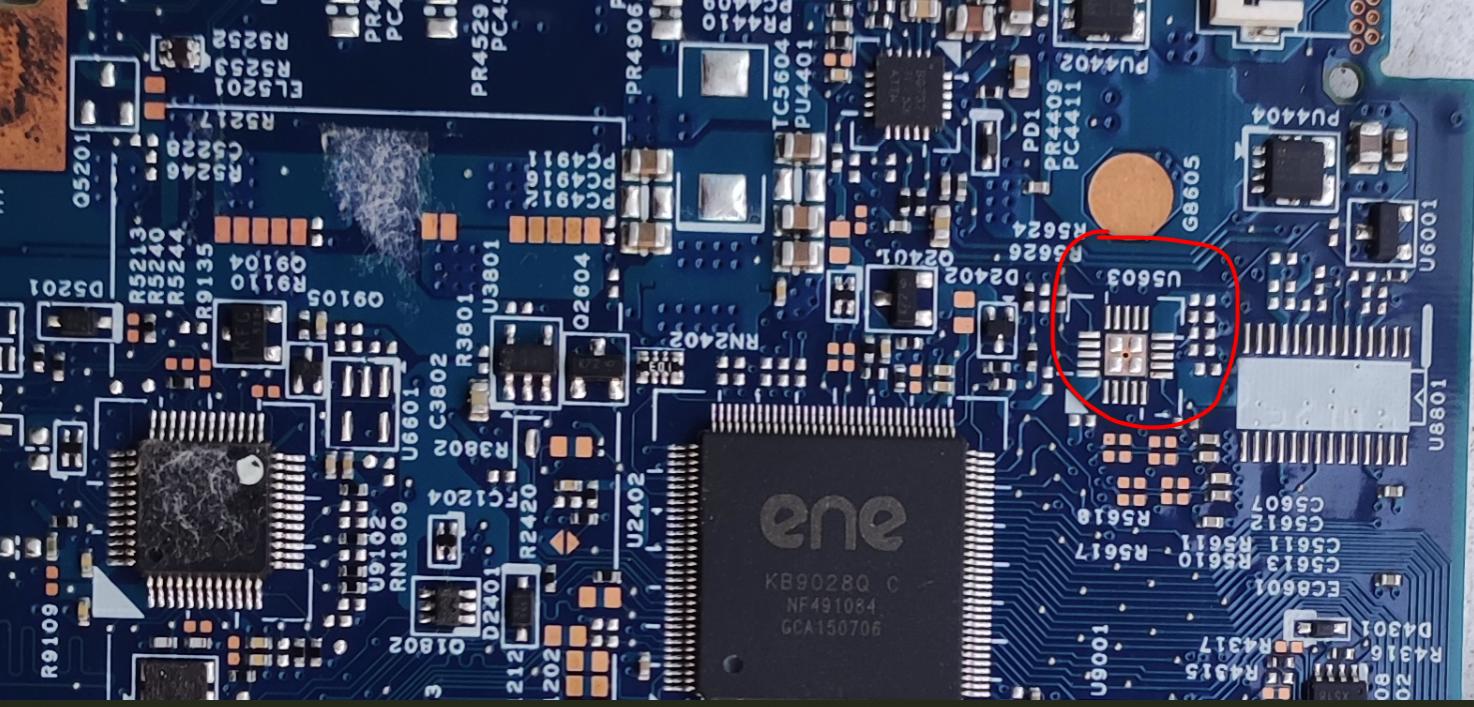

        HDD_Redriver U5603 SN75LVCP601RTJR-G
        Datasheet https://www.ti.com/lit/gpn/sn75lvcp601
          Re: HP Pavilion x360 - 13-s060sa HDD no detection
          Sir, i tried my best to find U5603 on this motherboard
          i didnt find it
          where it is located on board
            i didnt find it

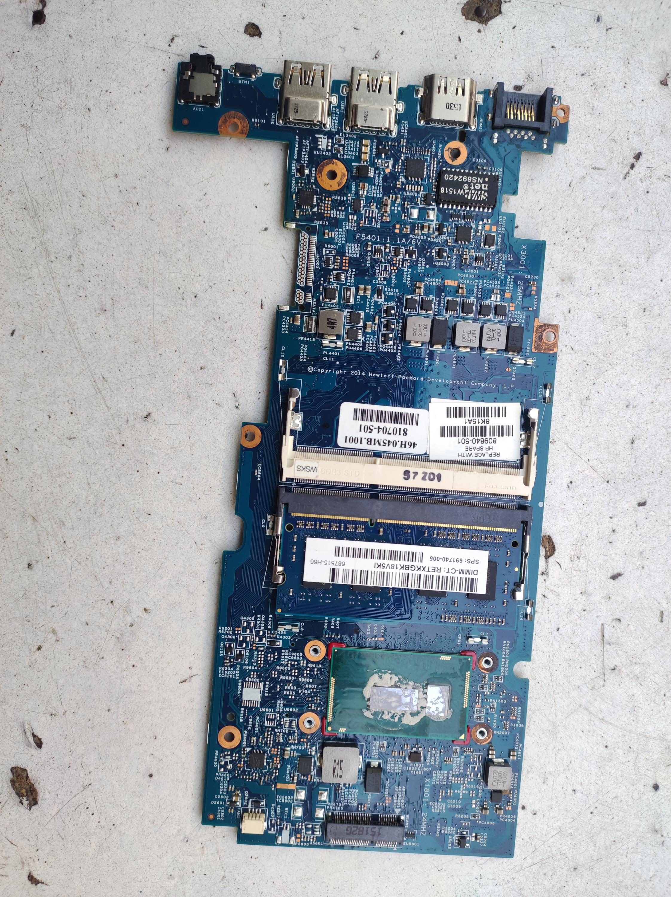

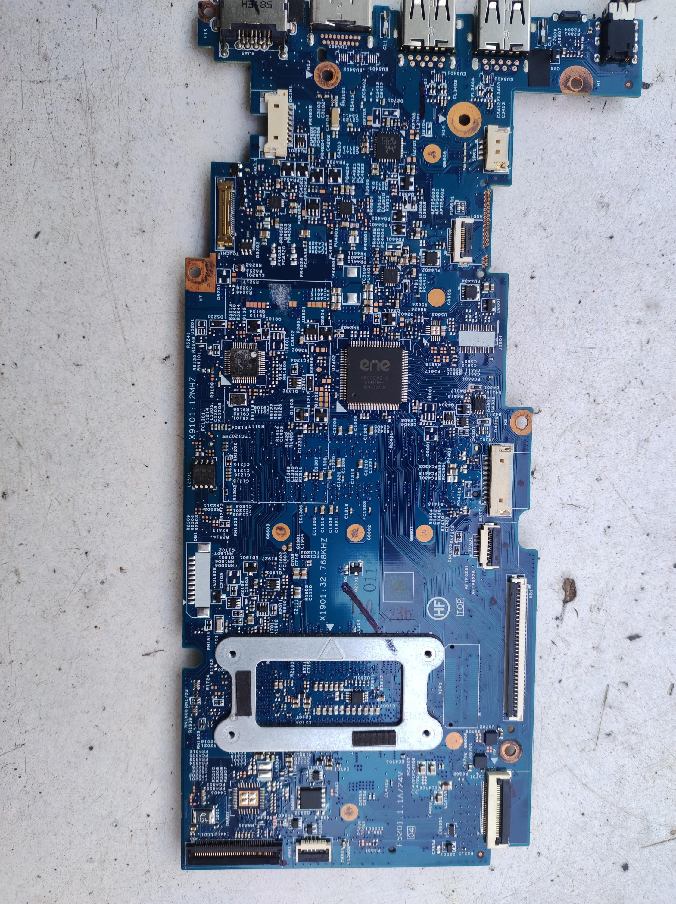

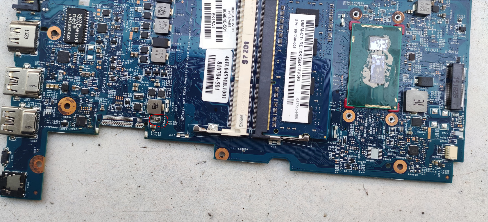

              this is my board
                this is my board
                This is location for u5603 but there is no ic

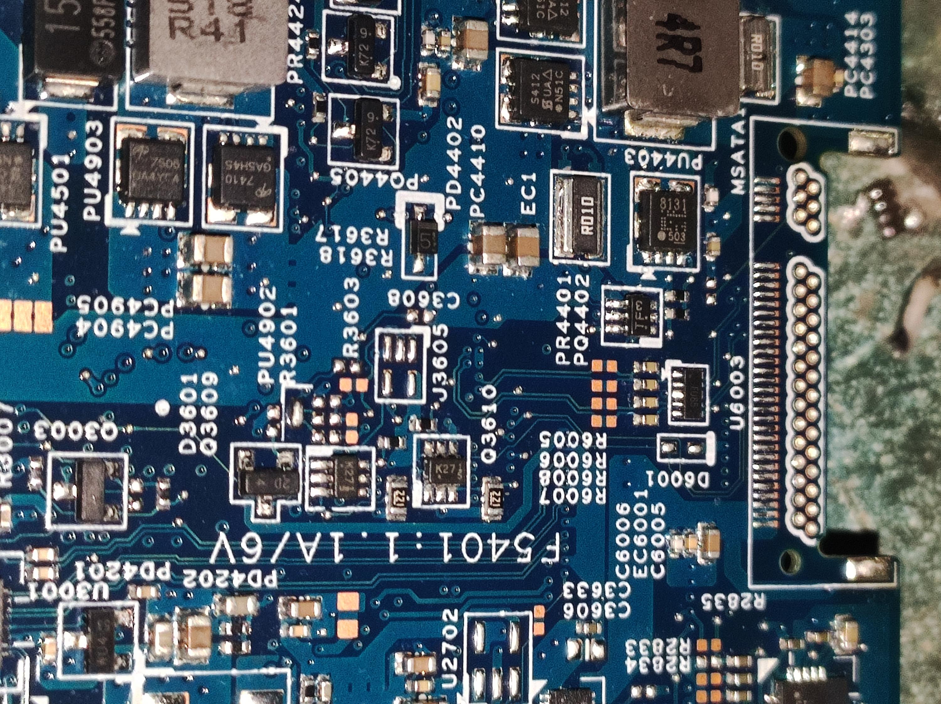

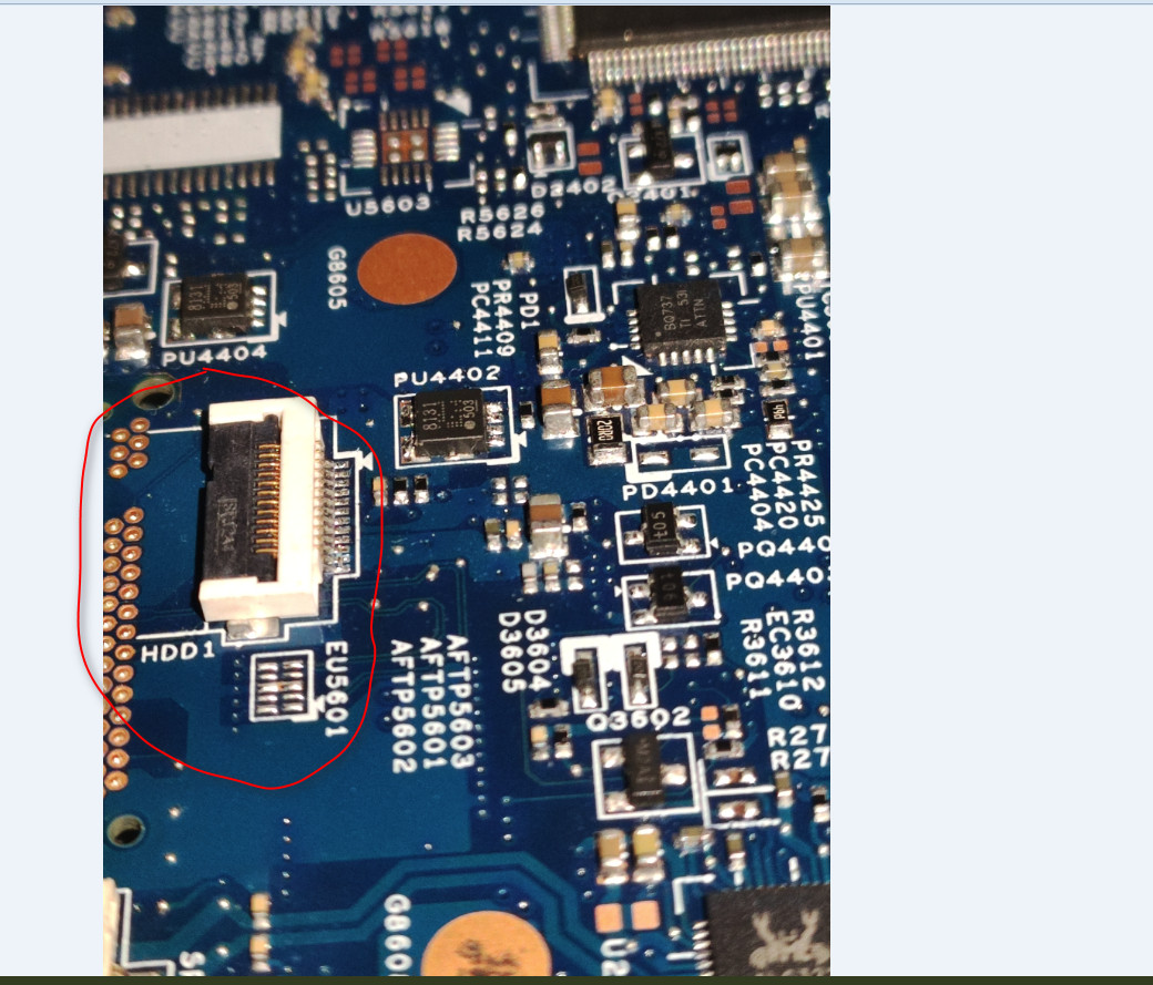

                            Post a clear pic of where the HDD Sata connects to the logic board. Perhaps some component is missing from the other rework.
                              Originally posted by mon2 View Post
                              post a clear pic of where the hdd sata connects to the logic board. Perhaps some component is missing from the other rework.
                              2nd pic is backside of hdd jack
