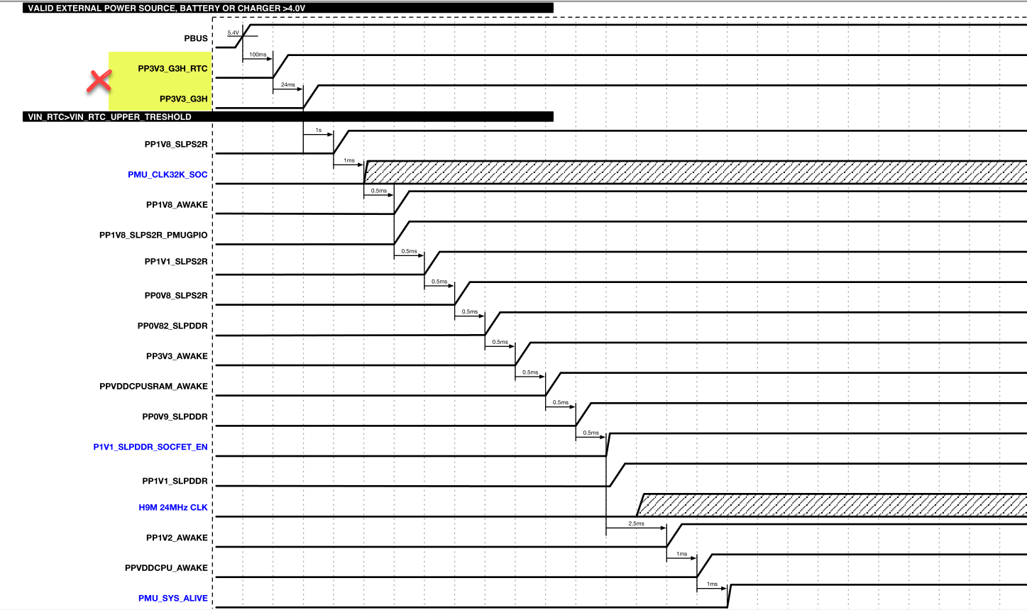

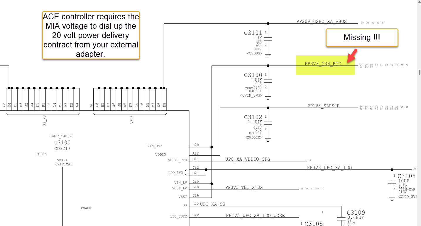

    1) Review the power sequence of the power rails for this logic board. Each must follow in order (sequence) to power up the logic board.
    A partial is attached. You have PPBUS_G3H which starts up in a BOOST mode.
    That is, your external power adapter is only supply 5 volts (not the desired 20v) and yet PPBUS_G3H is @ 12v3. This is because the ISL (Intersil / Renesas) IC @ U7000 is capable of operating in BUCK / BOOST modes.
    Buck mode will accept a higher input voltage and output a lower voltage.
    Boost mode is lower input and higher output voltage. Boost mode is always wimpy on the amount of current that can be supported.
    You will have 20V negotiated by the ACE controllers (CD3215 / CD3217, etc.) only if all the power rails to power each power delivery controller are present.
    Specifically, you are missing PP3V3_G3H_RTC and is halting the 20V power delivery negotiation. That is, your logic board is able to work with intelligent power adapters. These are the USB Type C style. The external power adapter is able to spit out a mix of power delivery contracts (voltage & current as a paired value). Only if the ACE controller on the logic board is working (each one must be ok) -> then the ACE controller will extract the database of supported PD contracts and dial up the best one to power the board.
    You are presently in the default 5 volt mode due to the missing power rail. Fault may be elsewhere but this power rail is still necessary to move forward.

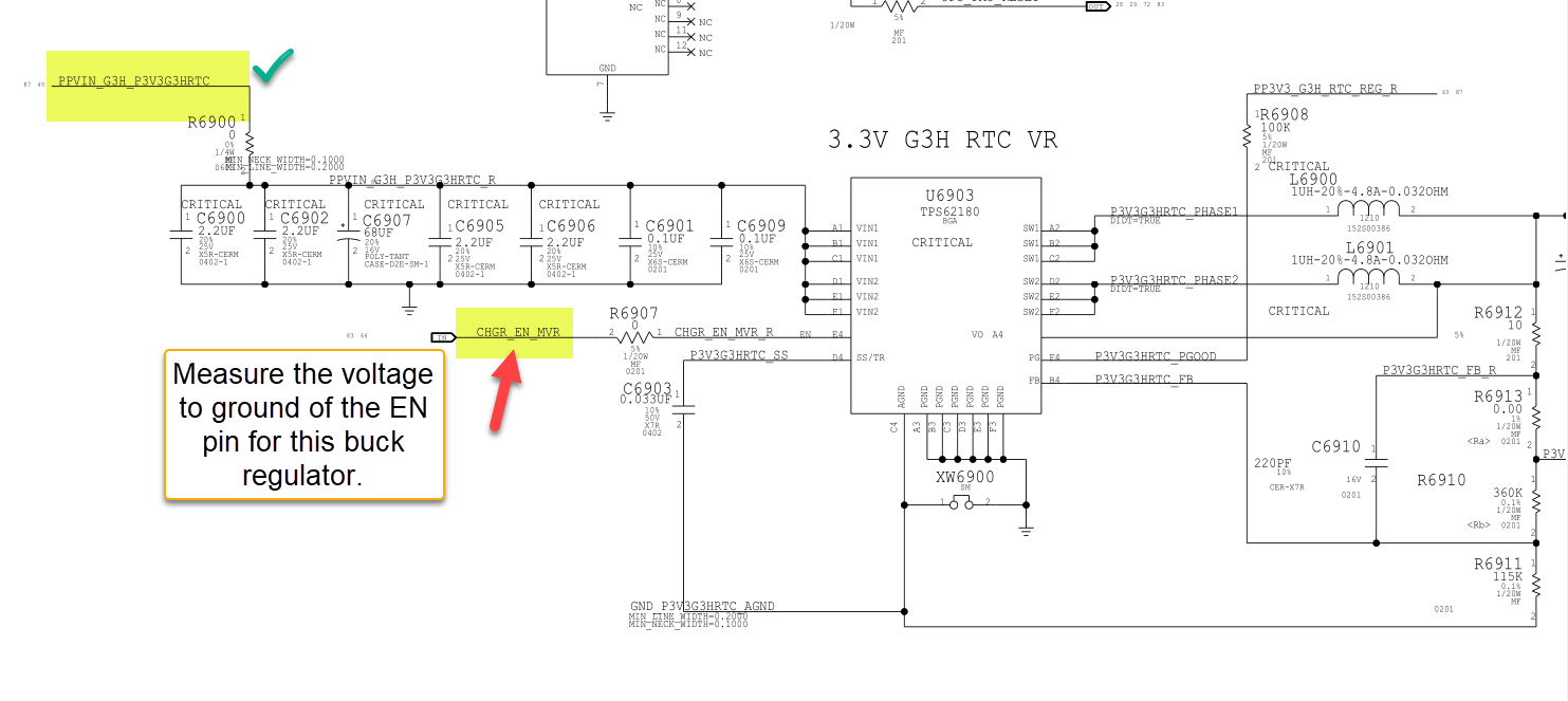

    You will need to review U6903 IC which is the creator of this missing power rail.
    Inspect for possible damage in the region. You DO have voltage going into this IC. Confirm that the EN pin is a logic HIGH to enable this power rail.
    What is the voltage to ground of the EN pin of U6903 ?
    Meter in DC volts mode -> 20 v or higher is ok.
    Red probe @ R6907; Black probe to ground. Check the voltage on each side of R6907.

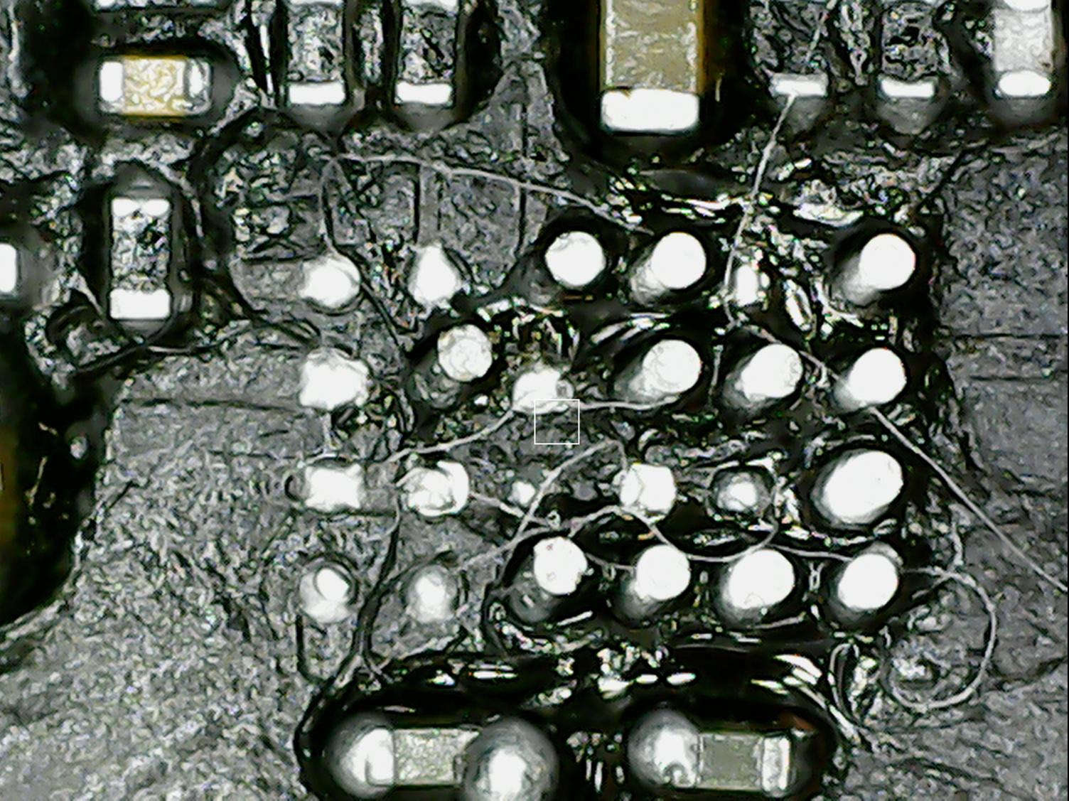

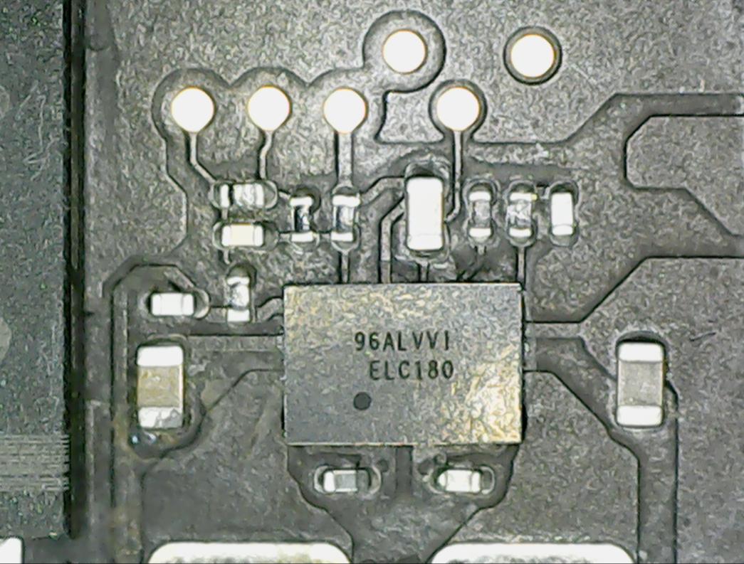

      @mon2 - Thanks for reaching out. I have obviously read a bunch of your responses on this forum and I really appreciate having the support from a vet like you. Thanks for awesome and clear response, it was really helpful in pointing me in the right direction.
      Attached is a picture of the chip with no glaring issues.
      As per requested, I measured 5.097 V @ Pin 1 & 2 on R6907.
      To be a little proactive, I also measured:
      - 12.3 V @ Pin 1 & 2 on R6900
      - 12.3 V @ Pin 1 on C6909
      - 0V @ Pin 1 on L6900
      Based on this, I assume it means that U6903 is defective?

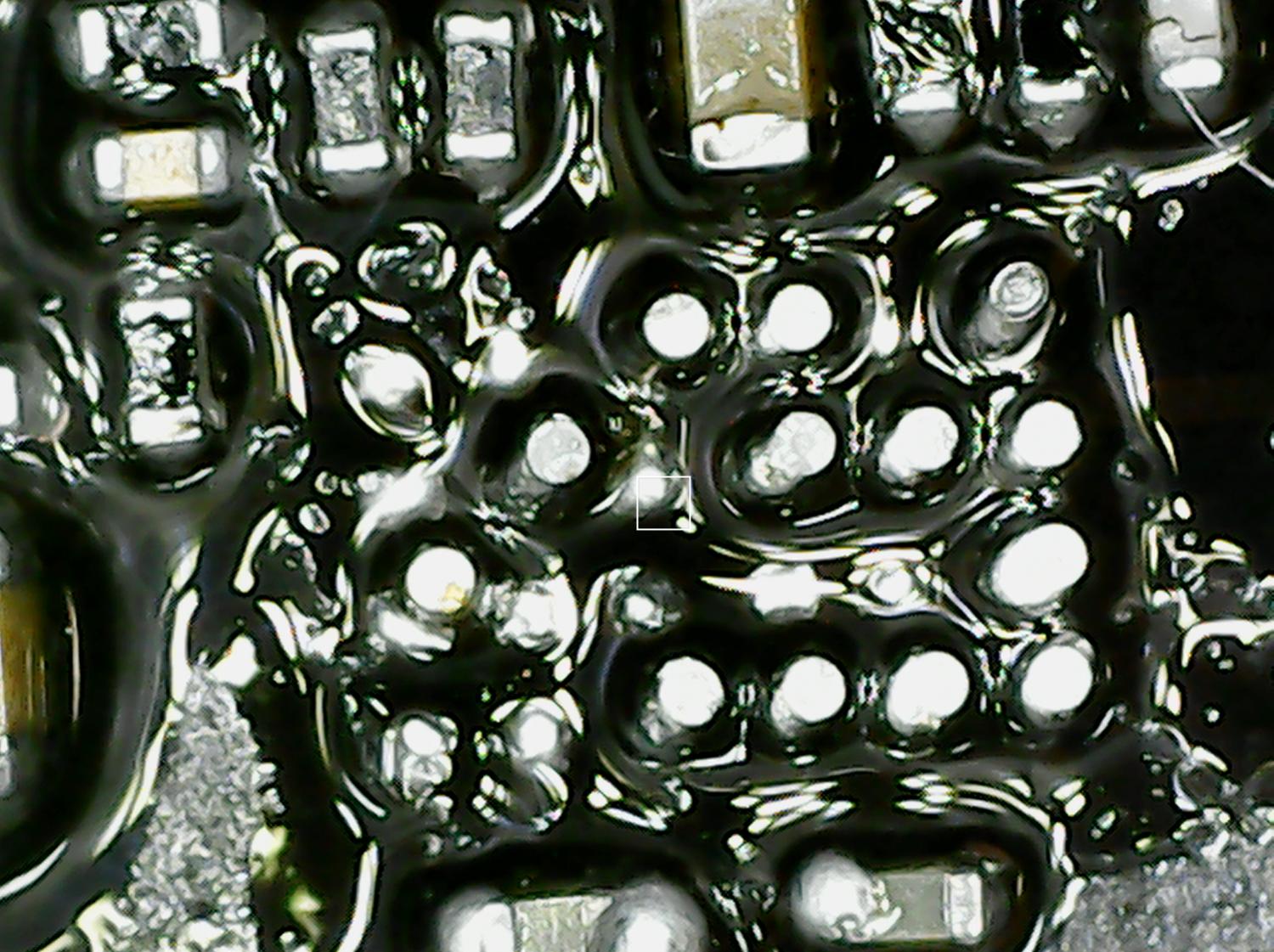

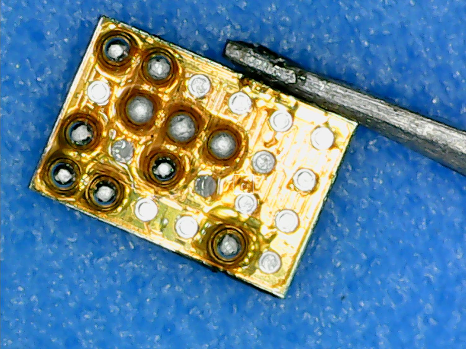

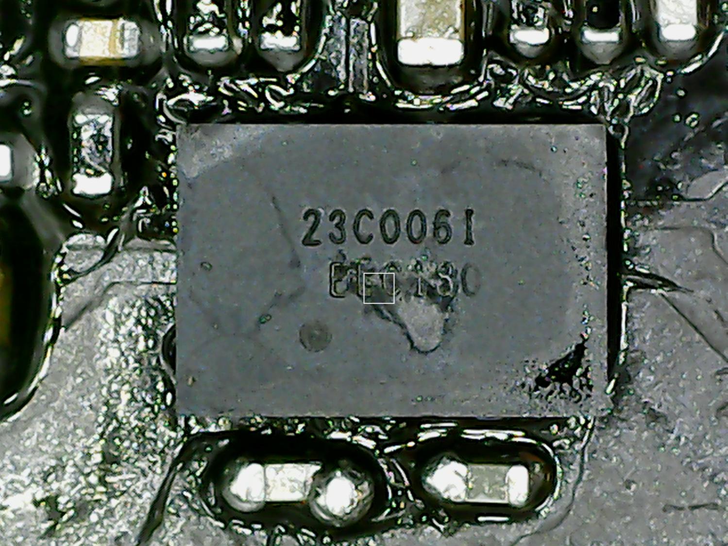

                Alright, so I bought two chips and they came in today. I practiced on an old laptop I hard around, but not going to lie, the chip placement and size of U6903 really made me punch above my weight on this one. I could use some spot checking on how I did (I am writing this reply while the board is in the ultrasonic cleaner, so I haven't tested the results yet, fyi).
                In a recap, I followed this video by Louis as a primer (https://www.youtube.com/watch?v=btEk...-UpFULLQUALITY). I have probably watched 25 times since we last spoke (in addition to a bunch of northridge's videos - what a great channel recco).
                I was able to get the original chip off with no broken pads. Thinned the pads and then tried wicking. Wicking was hard and did not go to plan. So I ended up just removing the excess solder with my iron and getting the grid as clean/flat as possible. I got the first replacement chip #1 on the board but there was no change on the amp meter. Re-probed L6900 and no change on output. Re-probed R6900 and C6909, again no chnage and a bit of a sigh of relief as I was terrified I destroyed surrounding components. Based on these reading, I made the conclusion that I did not get a good seat of the chip - but no worries, I bought another, and was now more 'skilled' (/sarcasm). Additionally, I was going to document things more appropriately in prep for this post!
                So we begin on replacement chip #2. Chip #1 came off without a hitch (see 2nd_lift.png). I re-thinned and then cleaned with iso (see 2nd_lift_iso.png). To me it looked decent, but please correct me if I am wrong. I also took a pic of the bottom of chip #1 (2nd_chip.png), and I am seeing many balls that did not make contact - again correct me if I am wrong. I also don't see an signs of bridging, so that made me feel better. I then did another ultra sonic cleaning prior to chip #2 placement. Once clean and bathed in iso, I re-fluxed and seated replacement chip #2 with the intention that I was going to hit it with heat longer and do a little more nudging try and ensure connectivity - see (2nd_Chip_place_v1.png).
                The results look alright to me, but again, I am a noob and could use some experienced eyes.

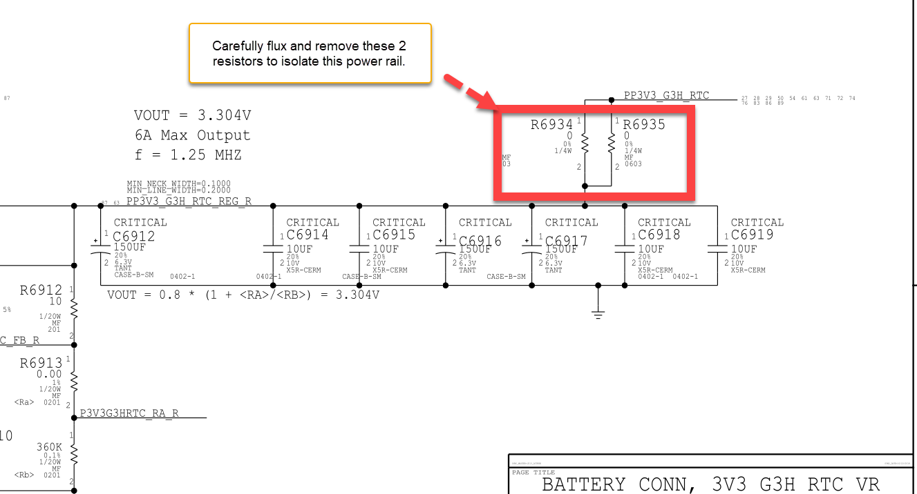

                                      Re: A2159 - 820-01598 - Stuck at 5V and am a beginner looking to learn
                                      C6912, pin # 1 (PP3V3_G3H_RTC_REG_R): 1.4 ohms
                                      You have a shorted part on this line.
                                      The voltages are fine on the INPUT to this regulator @ U6903 and the ENABLE voltage is also requesting for this part to turn ON. The ultra low resistance is causing this regulator to turn OFF due to an excessive current draw = too much of a load for the design of this power rail.
                                      See attached.
                                      Remove the 2 x highlighted resistors on the output side of this rail.
                                      After doing so with NO power -> measure the resistance to ground of:
                                      R6934 or R6935 - pin # 1. Either is ok.
                                      Is the low resistance still present ? Post the measurement.
                                      Then check R6934 or R5935, pin # 2. Either is ok.
                                      What is the resistance to ground ?
                                      By removing these 2 resistors, you are isolating the power rail to home in on the shorted part(s).
                                      BTW - Would you have an adjustable power supply ? Thermal camera or alcohol? Costco stuff works well.
                                        Ok, removed R6934 and R6935
                                        R6934/6935 @ pin 1: 1.85 Ohms
                                        R6934/6935 @ pin 2: 390 kOhms
                                        Ahhhh, makes sense. I guess from these readings, it suggests that the short is further downstream?
                                        I have 99.9% isa. I will amazon a power supply now.
