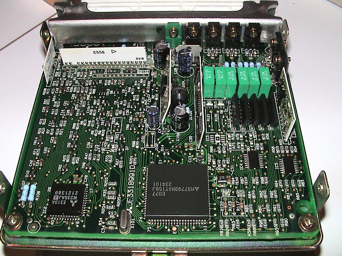

    been seeing a bunch of these lately.

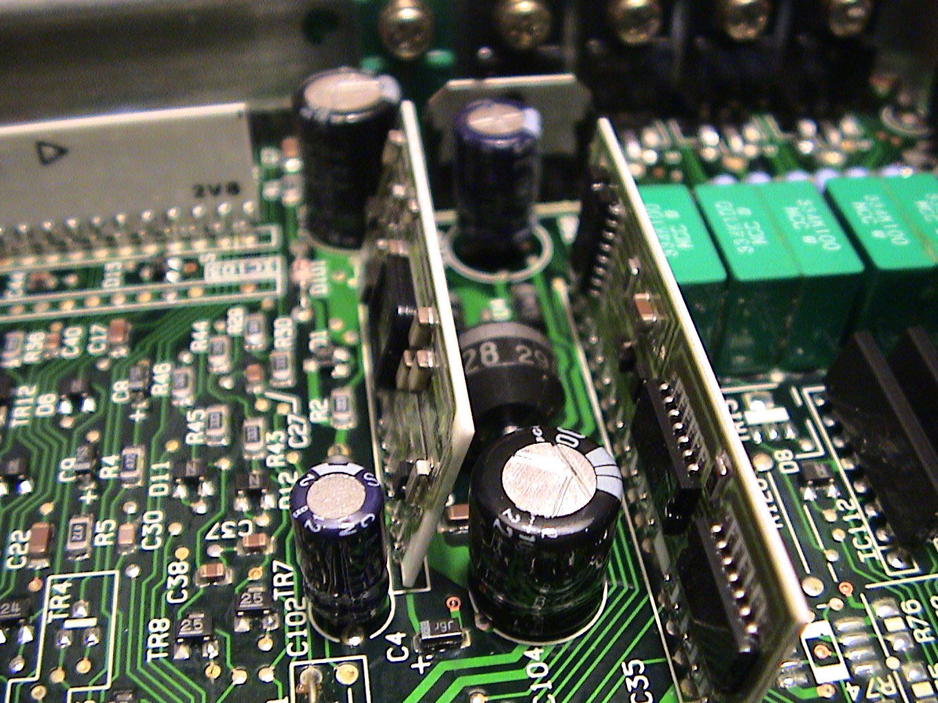

    caps leak on board and cause all sorts of annoying intermittants.
    had 3 in this week.
    usually get 1 a month.
    same ecm in other mitsubishi cars too.

          I have a 1993 Mitsubishi 3000GT that I replaced the caps on it's computer. Two were starting to leak and would have caused problems. Did not have any symptoms, I just did it in advance when I heard about this problem.

            HEY rumblefish73 could you please take a picture of the back of your ECU ...
            My 100 microfarad Capacitor has leaked and burnt the copper trace of the negative side of that Capacitor.
            So I dont know what copper trace to resolder the negative lead to
            A picture would let me know where to start
            Thank you

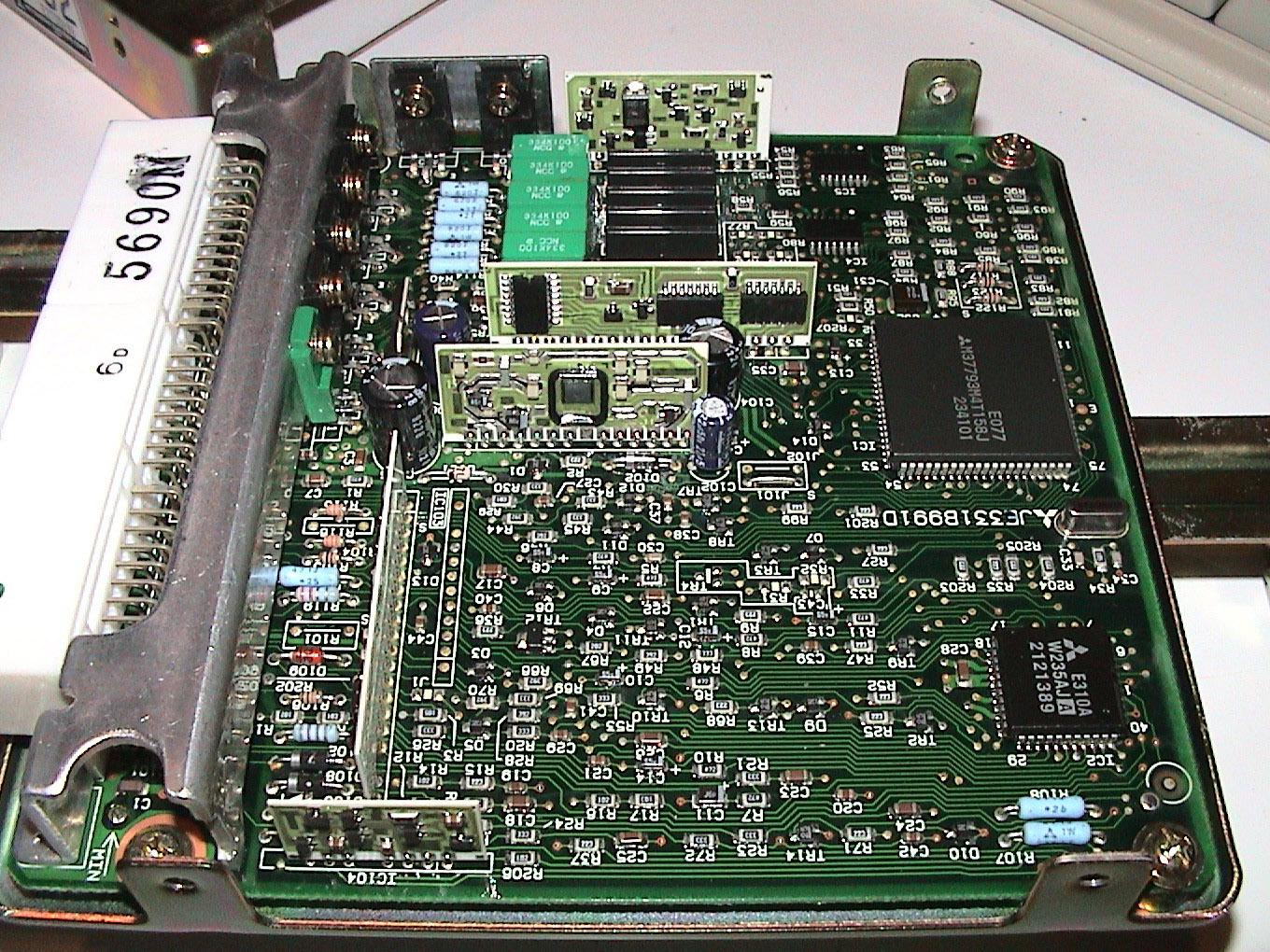

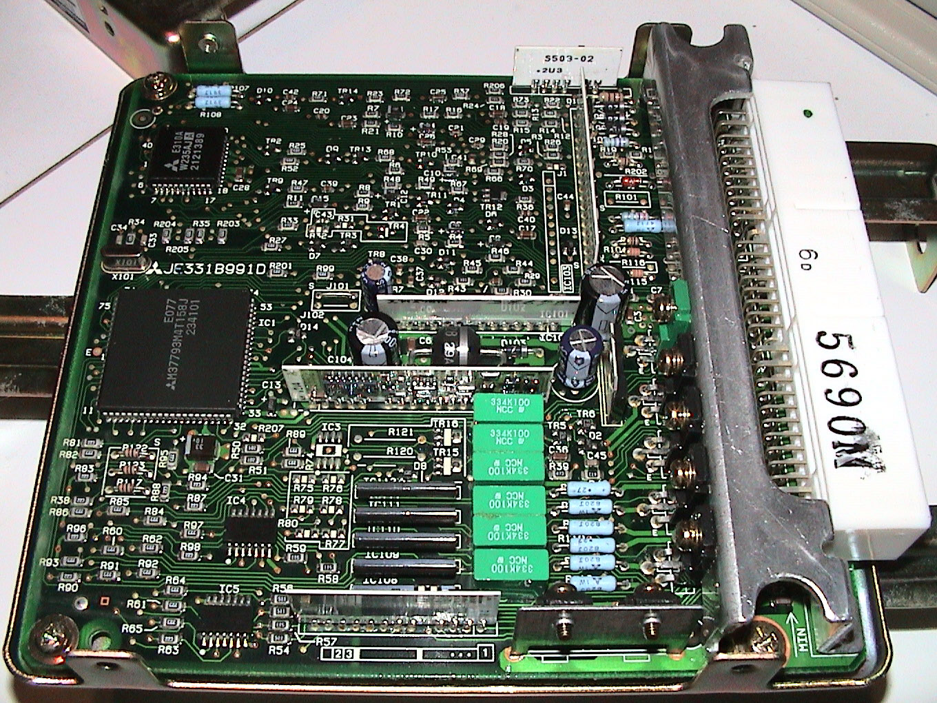

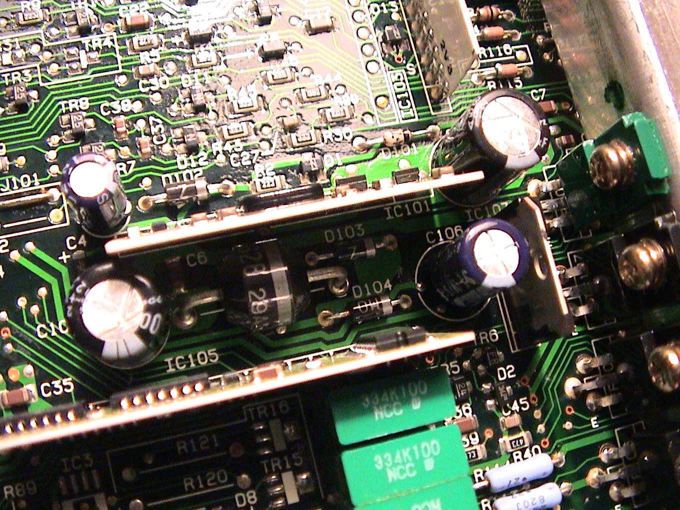

              Here's some more pictures of the ECM when I had it apart.
              I don't have any pics of the underside. Have you tried looking for a schematic?

                Thank You so much for those pics rumblefish73
                There is a trace in the 4th picture you sent that I didnt even know was there
                The Leaky Capacitor must have destroyed the entire trace
                I will resolder the trace today and send You a pic of What I am dealing with
