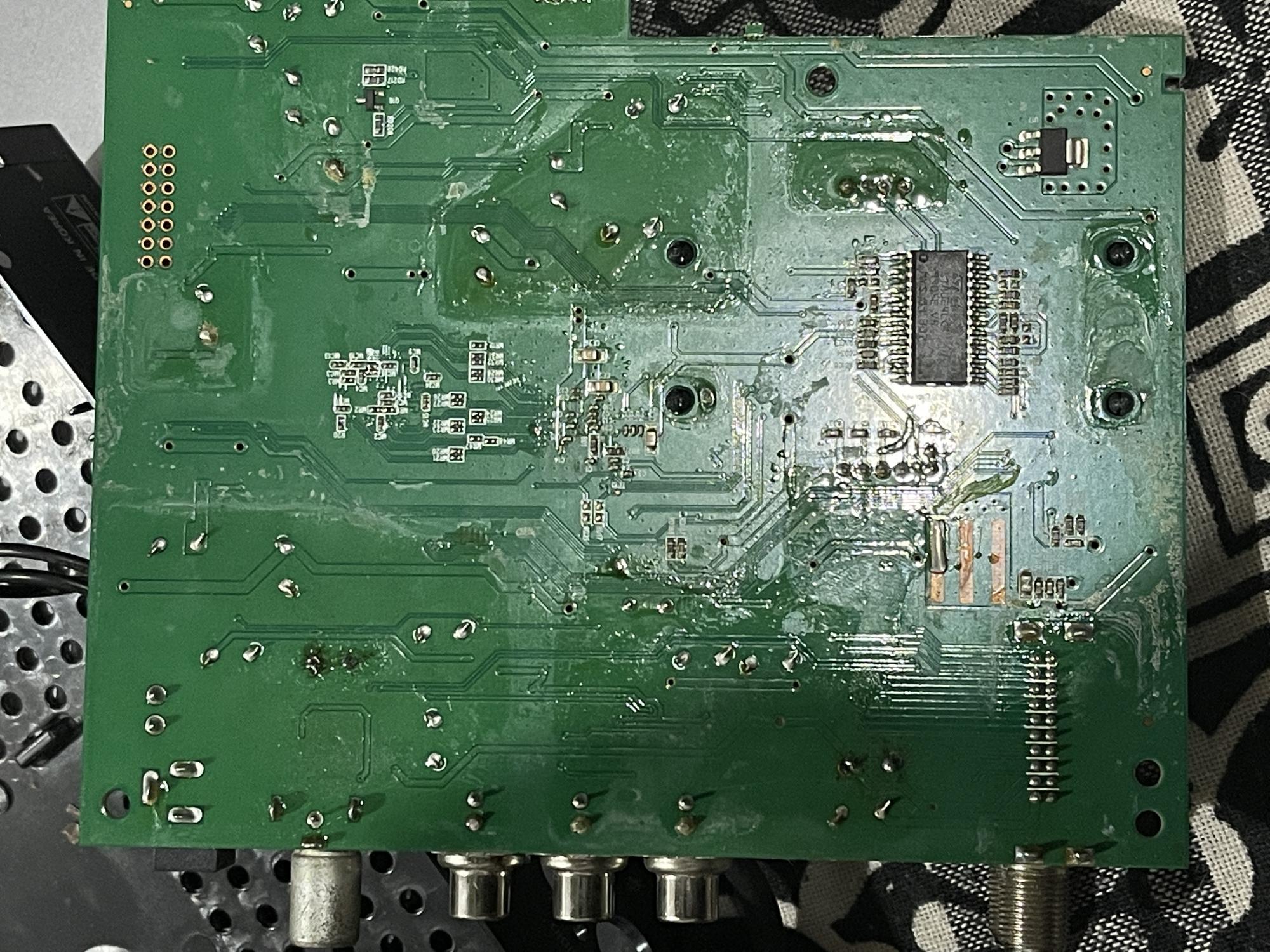

          If I can fix my old Decoder using new one Im okay with that also. Here is the current situation on my old decoder.
          It work perfectly But audio and video out faulty.
          If we talk about Audio, in AV out, Red wire doesn't out any sound. may be it will out very little sound. White one is okay.
          and on video out Its dancing randomly. sometimes Video is bit smudge to right side. If I keep decoder on for a long time, like 2-3 hours graphics became to normal. no more dancing or very less dance. but At the beginning it highly dancing. I tried to replace some parts but I failed. is there any possibility to fix this?
            Re: Satalite TV decoder - Smart card issue
            bad solder or worn capacitors if letting it heat up improves things.
              I can't find out the bad cap. I tested all the caps near video jack. I haven't noticed a short. is there any clue to find exact one?

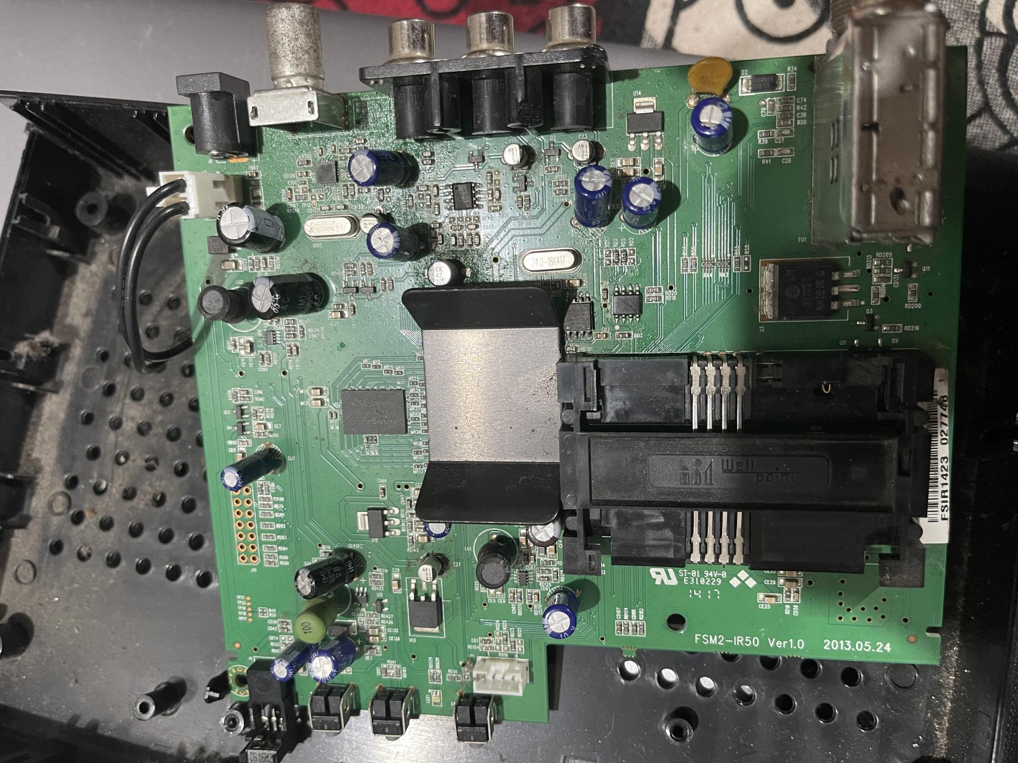

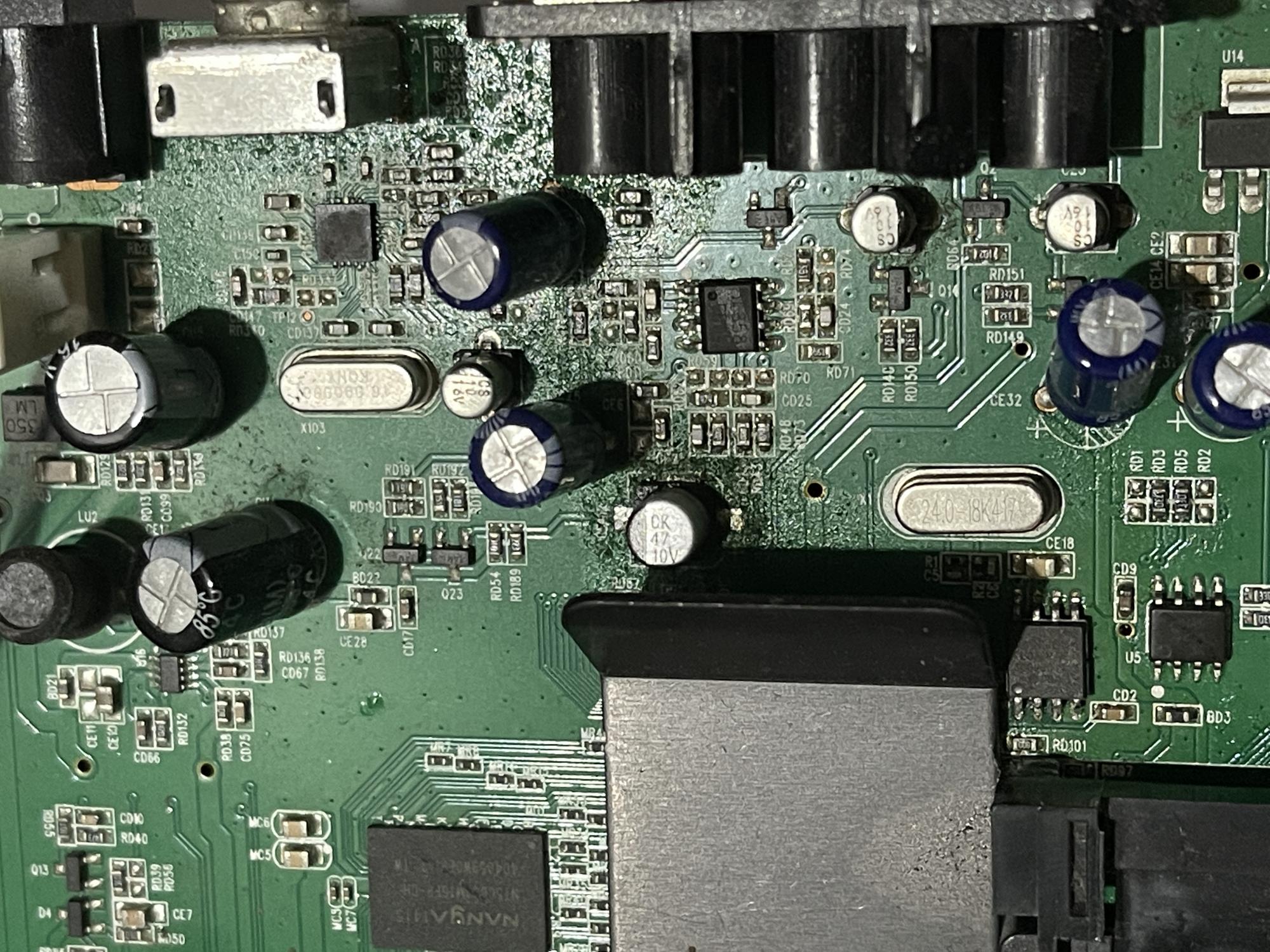

                  Here I uploaded the same board which I use to take parts out. I will send the faulty device images soon. hope this images help you to identify about the pcb.
                    is that dust around the surface mount capacitors or did they leak??
                    check on both units incase it's a common problem
                      yes thats dust mix with flux. I resoldered some psrts. but wasn’t clean the board with alcohol after soldering process
