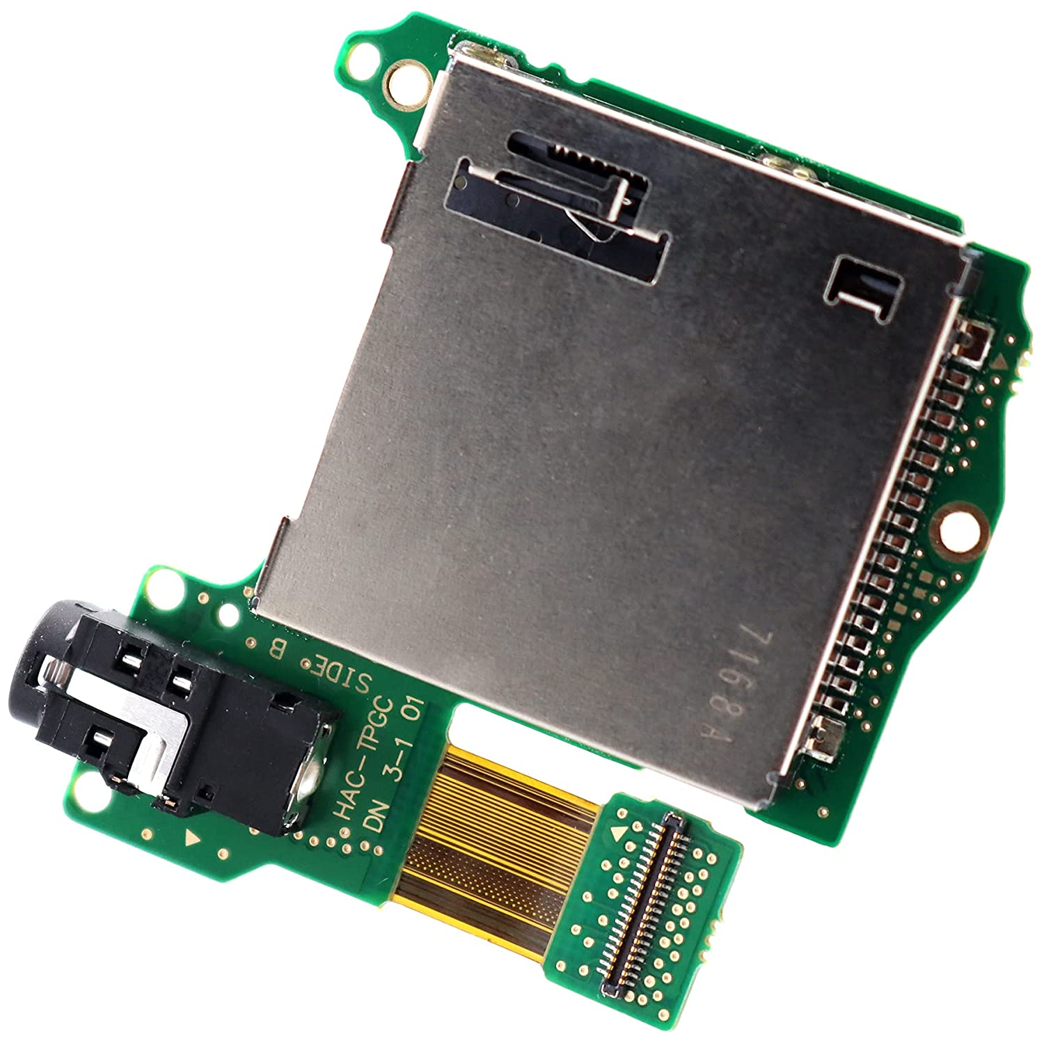

    anyone know if u can buy the male FPC connector for the game card reader i can only find the female one on the motherboard, is it unique to the switch or is it a standard part?

    you lost me,
    FPC connectors are for flat cables - you dont have male/female
    unless you mean contacts down vs contacts up

      Re: Nintendo Switch FPC connector Questions
      Like these stj, https://store.rossmanngroup.com/inde...tor-j2401.html , but smaller, 8 pins a side.
        those arent FPC, they are pcb interconnects.
        and a pain in the ass to 100% identify.
        but to get you started, most are made by MOLEX and are from the "SlimStack" series
        i have been chasing those for a while to fix motorola DMR radio's
          yeah i wasn't sure what the correct name for the connector was, its this one
            can you work out the pitch between the pins?
              thanks for that, dont know it i can measure things that small will give a try
