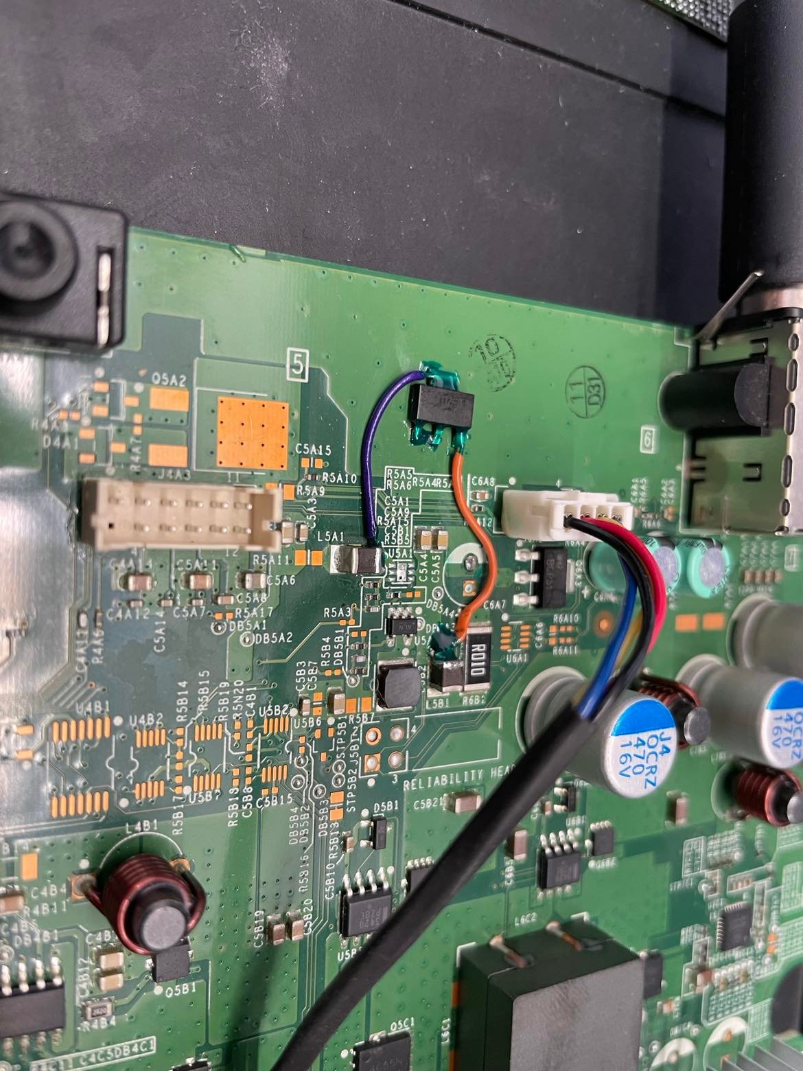

    Hello everyone!
    I have two same console with same error. Not turning on.
    Model:Xbox 360E model:1538
    The power birck led is lights on amber.- Tested with this methood. Link
    I measured the power button circuit to power panel connector, everithing looks good. local console guru said, southbridge error--> I replaced it with new.. same error.
    Can't find schematic or any document for this error.
    Can somebody help me?

        Re: Xbox 360E model:1538 not turning on
        A common cause in slims (does not turn on) is a problem in the 3.3v DC converter (in 5v - out 3.3v).

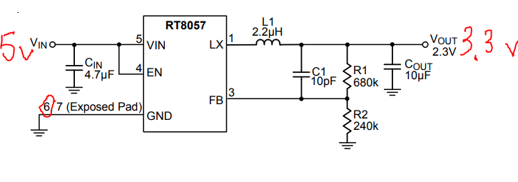

          Thank you.
          I measured 5V is present the 3.3V just 0.28V
          I not found this tiny voltage regulator name, type or any datasheet.
          Is there any solution to bypass or change to other components?
          I found article in which he mentions, to replace with AMS1117.. it is working?
            Yes, you can put AMS1117 3.3 with a fixed voltage of 3.3v
            "J7(X)" is "RT8057"
            Sometimes they put: "CEY" - That is "TPS62560"
              Thank you, so much!
                working!

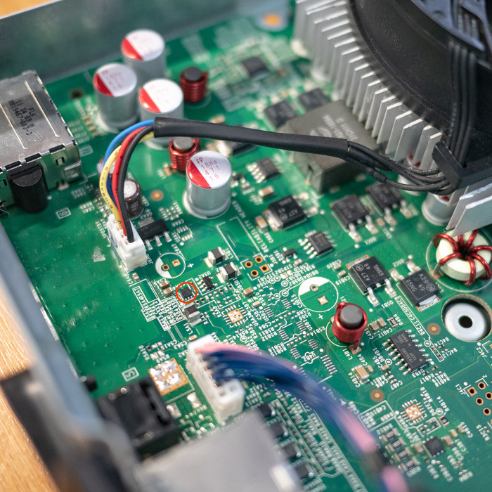

                    I have the same problem (xbox360 does not power on) with the same 1538 board. I checked voltage on the RT8057 and I have 5V on leg 6 and 3.4V on number 1. Any suggestions on what to look for next?
                    I can mention that when I happened to touch the 5 legs component next to the rt8057 with my finger, the fan started spinning for like a second or so.
                    Help on continued trouble shooting is greatly appreciated.
                      At 6 pin you can't have 5v because this pin is ground.
                        Yes, you are correct, I have 5V on pin 5, not on 6.
                        I hope someone will have a clue to what the problem is. I think it must mean something that the fan jumps into life when touching the adjacent component....

                          Update: I tested with another rf board from a working unit, no change. Green light on the on/off button for 2s after pressing it, then nothing, fan does not spin.

                            Found the problem: broken hdmi port, pins shorted to ground
                              And this needs to be checked first, as well as the USB ports.
