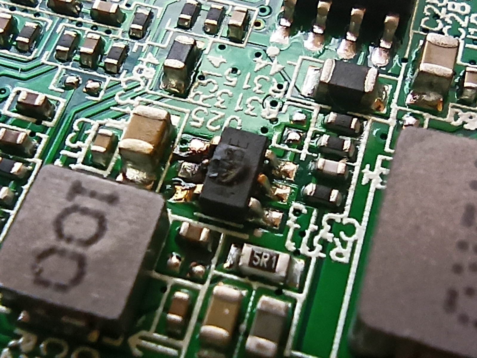

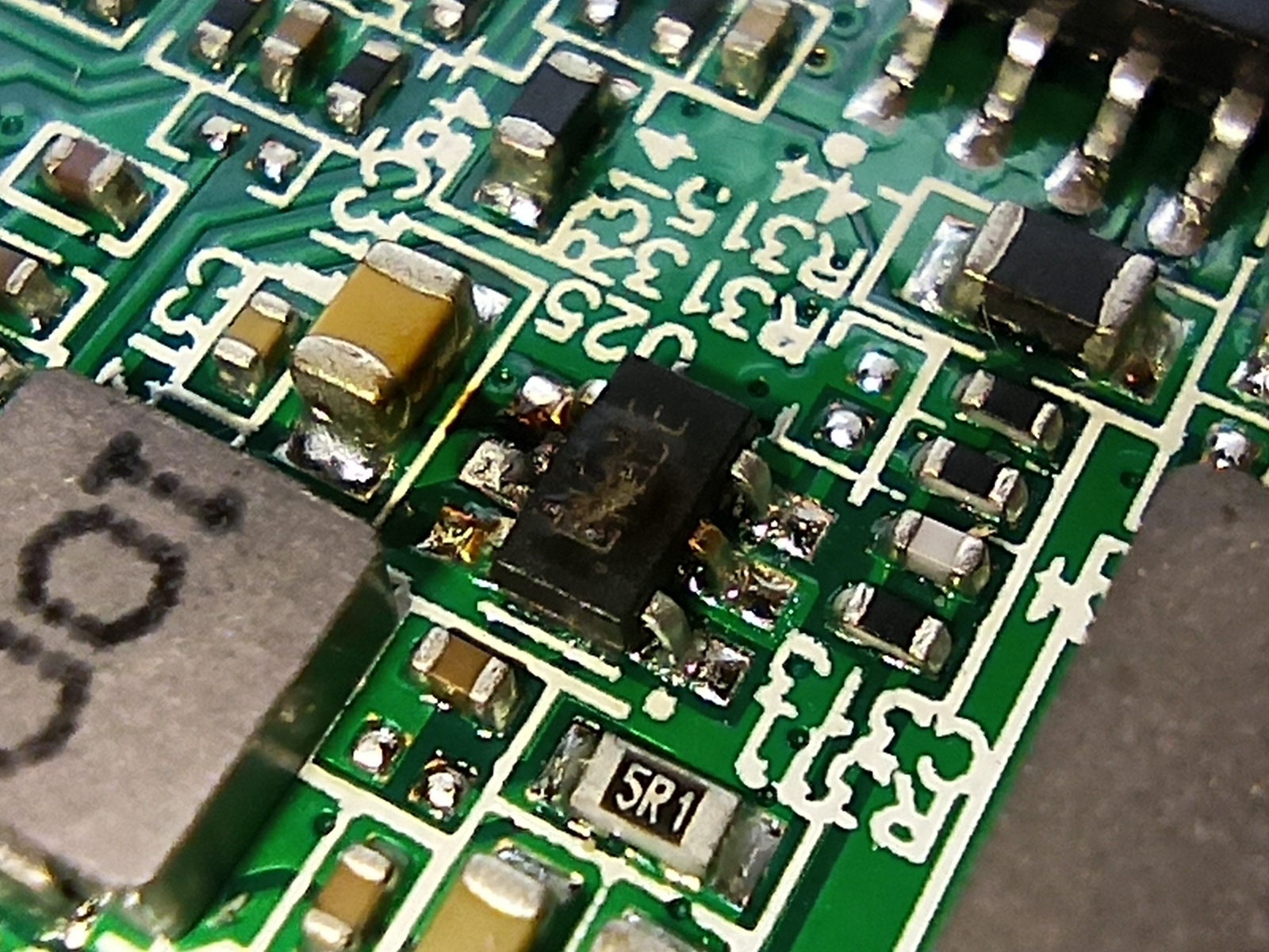

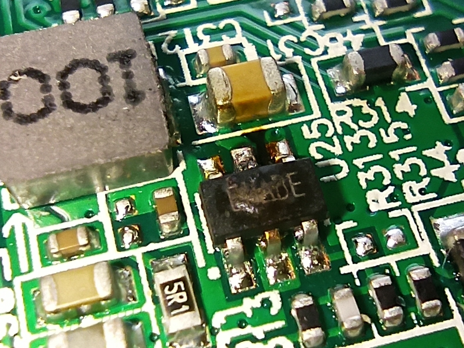

    Hi guys. Sorry if I'm posting this in the wrong place.

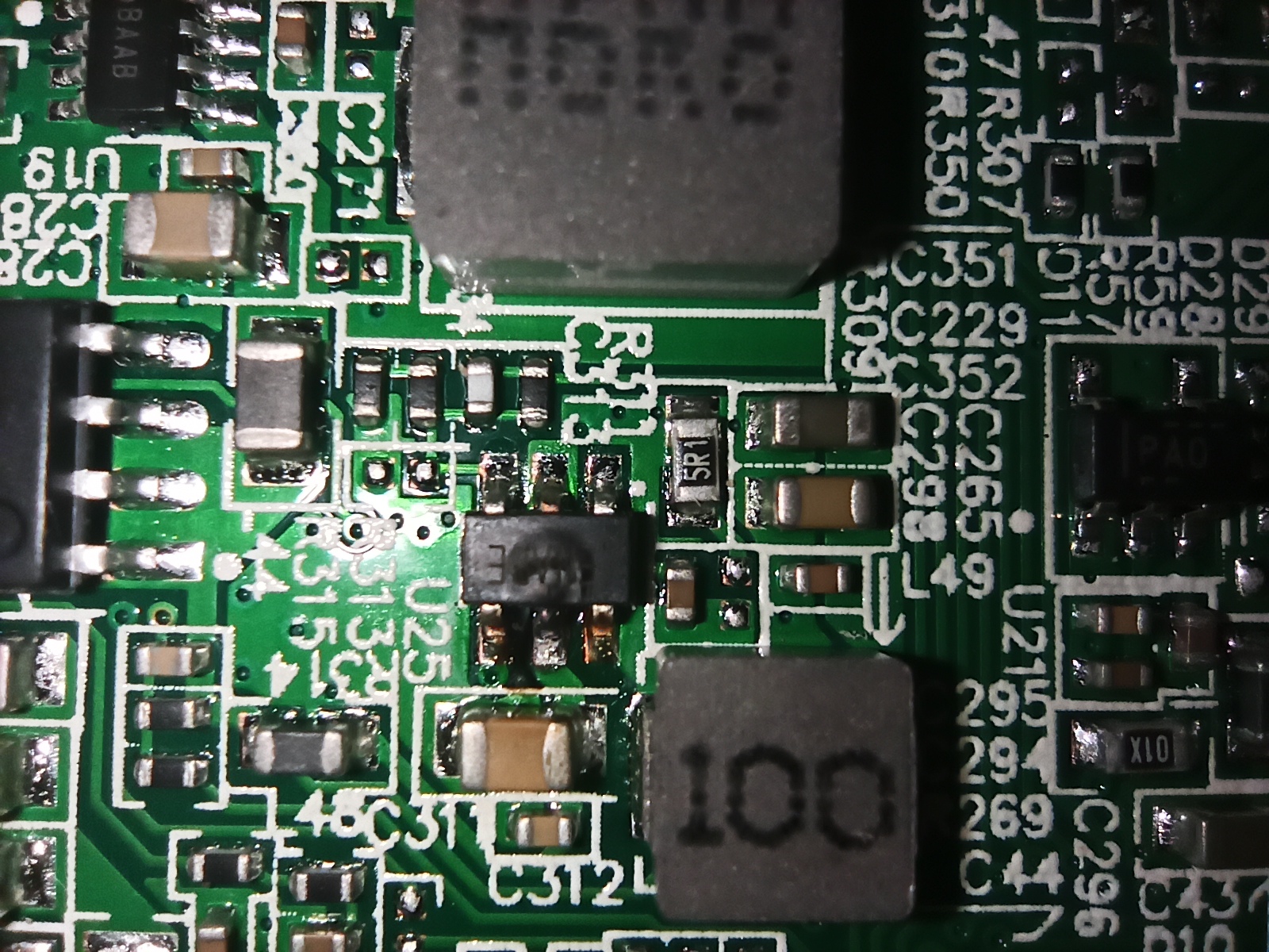

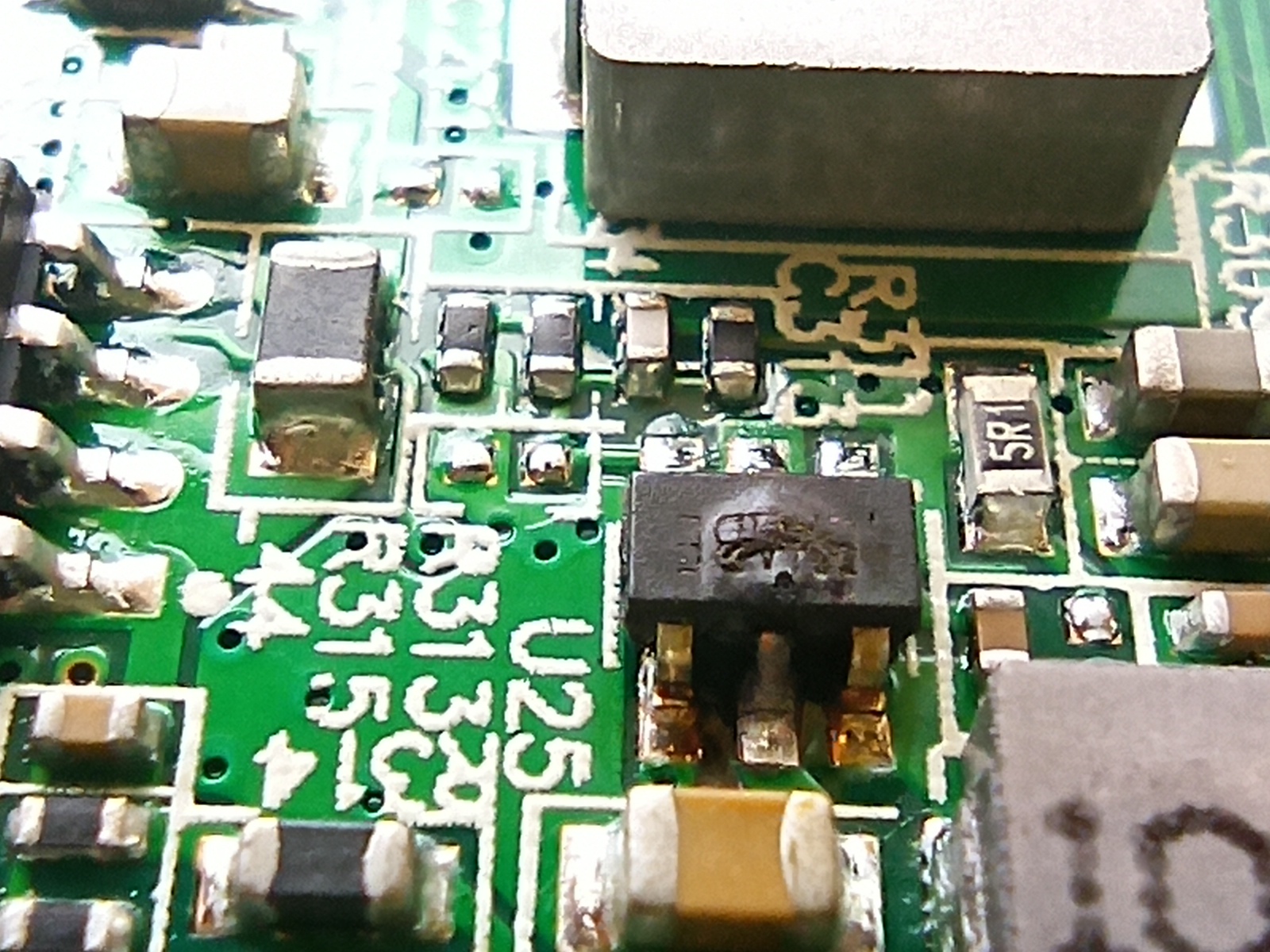

    So here's the thing. A friend gave this device saying it had no sign of life. After opening it, I found a burned soc23-6 which I cannot identify. I've searched for schematics for this model with no avail. Perhaps someone with more knowledge can assume what it is.

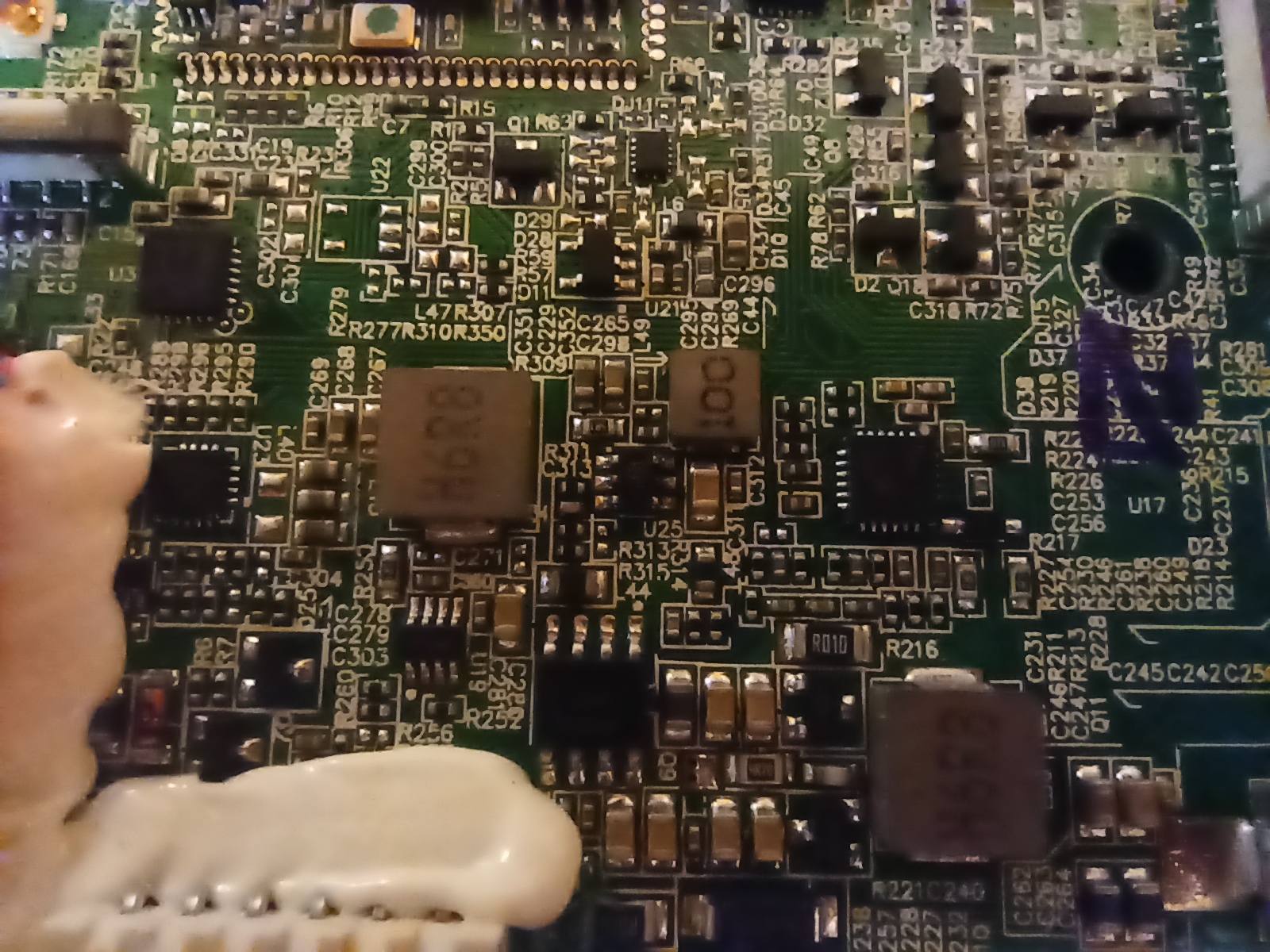

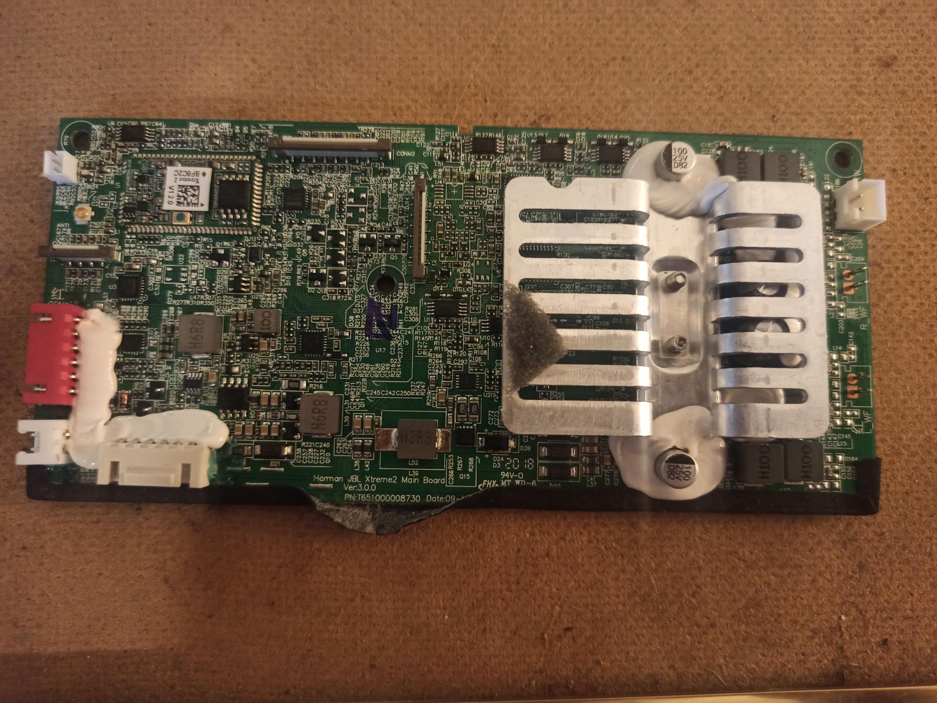

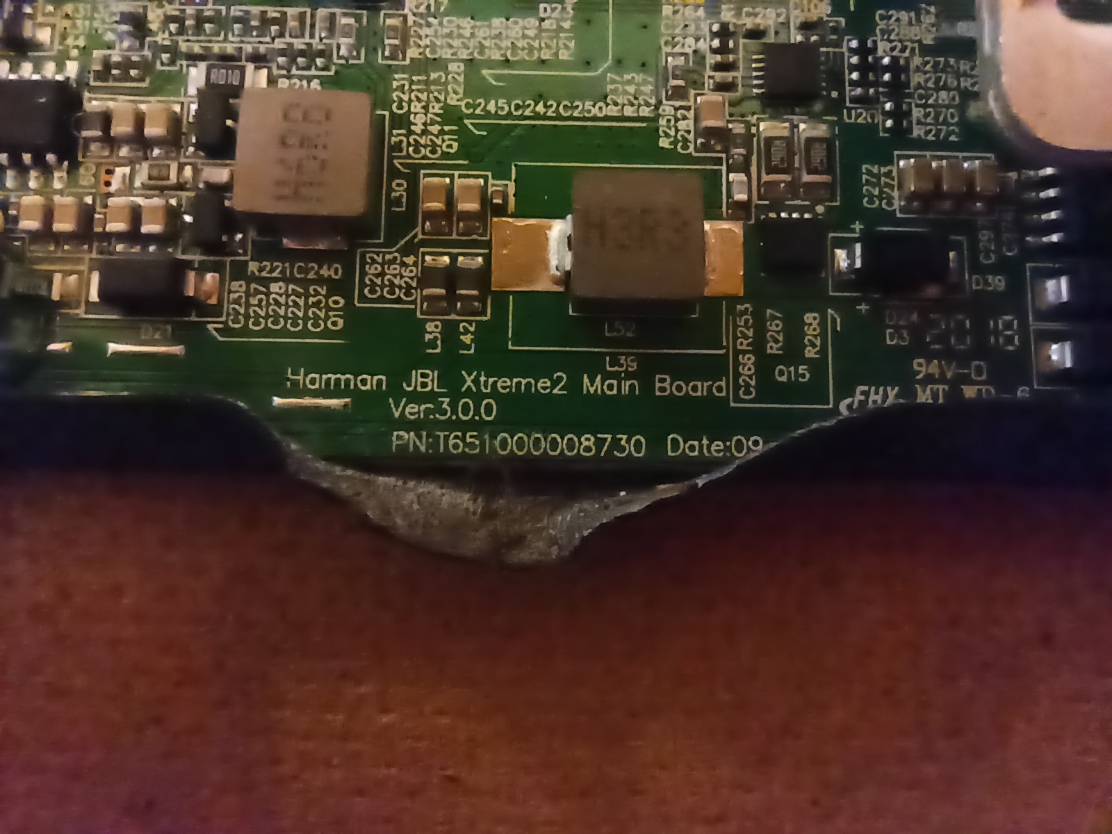

    Main board pn is T651000008730. I'll attach every picture o took out just to help in any way possible.
    Power input for this device is 19v.
    Thanks a lot.

    u25 - sy8201

      Thanks a lot my dear friend!!!! Once I get back home I'll search for a compatible in my donor pile and get back with the results! Can't thank you enough.
      See you in a bit.
      Toni
