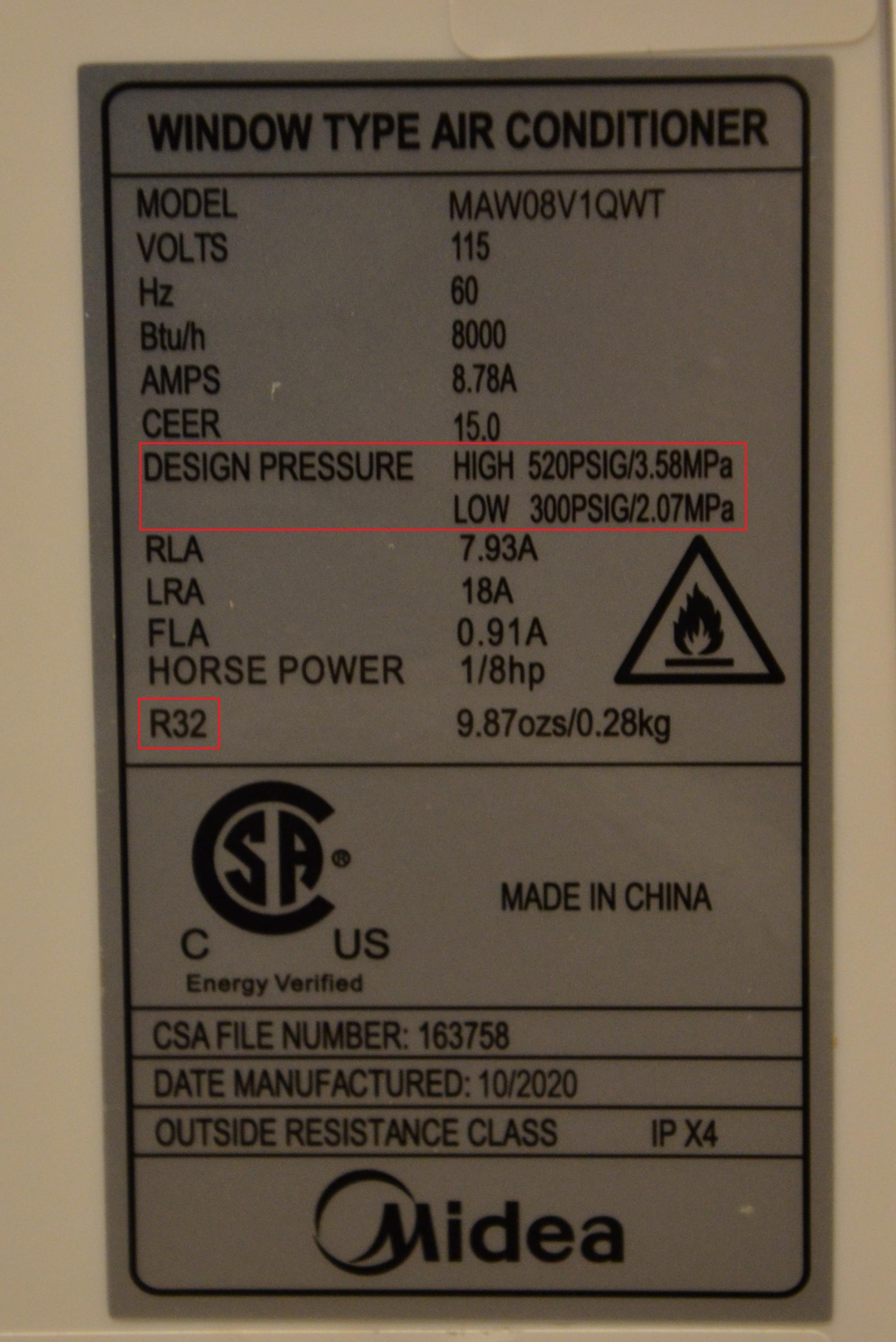

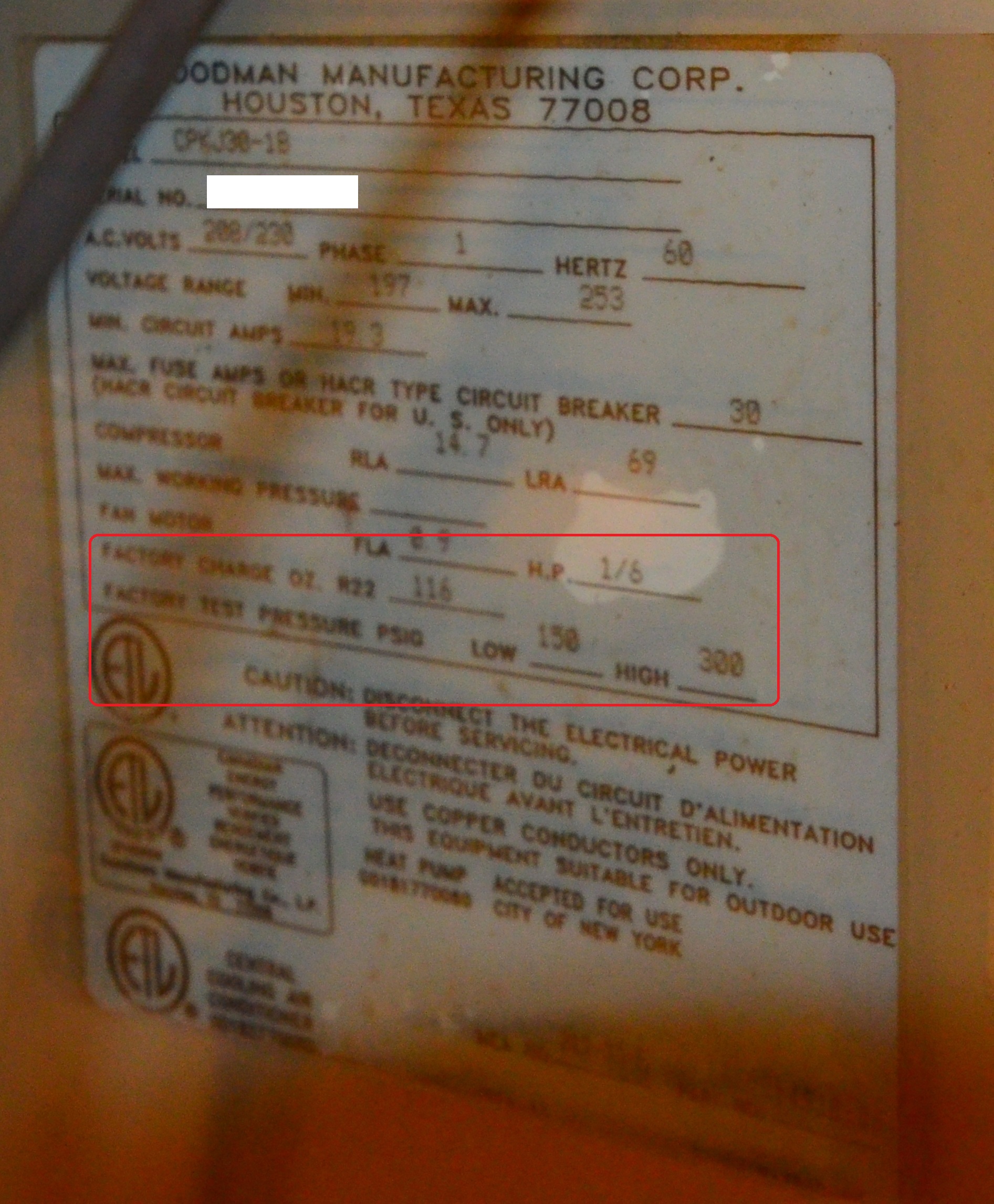

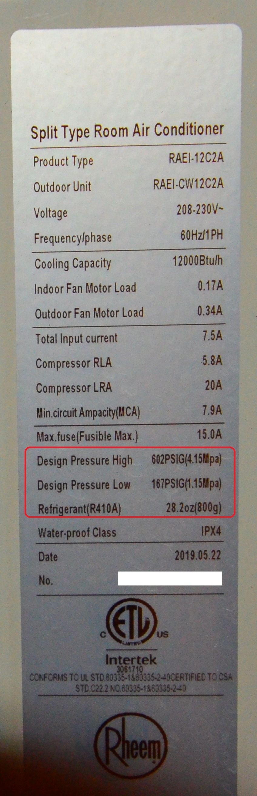

                  I don't have any experience or expertise in HVAC stuff, but from what I've heard, a lot of modern stuff (made in the last 10 years or so) fails much more often due running at much higher pressures in order to get better efficiency (which ends up chewing through the compressor faster)... and possibly something to do with the newer refrigerants too.
                  Not as much of an issue with refrigerators as R134a operates at similar pressures to R12 which it replaced (R600a is also about the same and R290 slightly higher).
                  When it comes to AC/Heat-Pumps (both central and window) and dehumidifiers though, R410A operates at around double the PSI than R22 which it replaced does (and R32 which is now becoming more common in window ACs and dehumidifiers operates at similar pressures to R410A).
                  Examples (granted these are max design pressures, actual operating pressures are generally lower, but a higher design pressure translates to a higher operating pressure):
                  R22 (low 150 PSI, High 300 PSI):
                  R410A (low 167 PSI, High 602 PSI):
                  R32 (low 300 PSI, High 520 PSI):
                  Of course these are just examples, not all units will be exactly the same, but in general an R410A or R32 system will operate at much higher pressures than an R22 system.

                      I thought you cannot put R32 in a R410 system? At least that is what I read a while back. R410A is being replaced with R454B?
                      • dmill89
                        • Dec 2011
                        • 2534
                        Re: refrigeration device repair...
                        At least legally you can't since R32 is classified "mildly flammable" (same with R454B), electrical components in R32 or R454B systems require additional shielding to reduce the potential for sparks (slight "tweaks" to the system may also be needed for maximum operating efficiency). R32 is actually one of the components of R410A, which is a blend of R32 and R125 (the reason for the blend was to make R410A non-flammable).
                        Both R32 and R454B are both proposed alternatives for R410A (as is R466A which is non-flammable), with R32 being championed by Lennox and Daikin, and R454B championed by United Technologies (Carrier, Bryant, Payne, etc.) and Johnson Controls (York, Coleman, Luxair, etc.).
                        Currently US building codes do not allow for flammable refrigerants in permanently installed residential HVAC units so of the 3 only R466A would be allowed by current codes (relegating R32 and R454B to stuff like window units and portable dehumidifiers, and some industrial applications), but since R466A is the most expensive of the 3 there is a massive lobbying effort by the HVAC industry to amend the codes to allow for mildly-flammable refrigerants in permeant installations.
