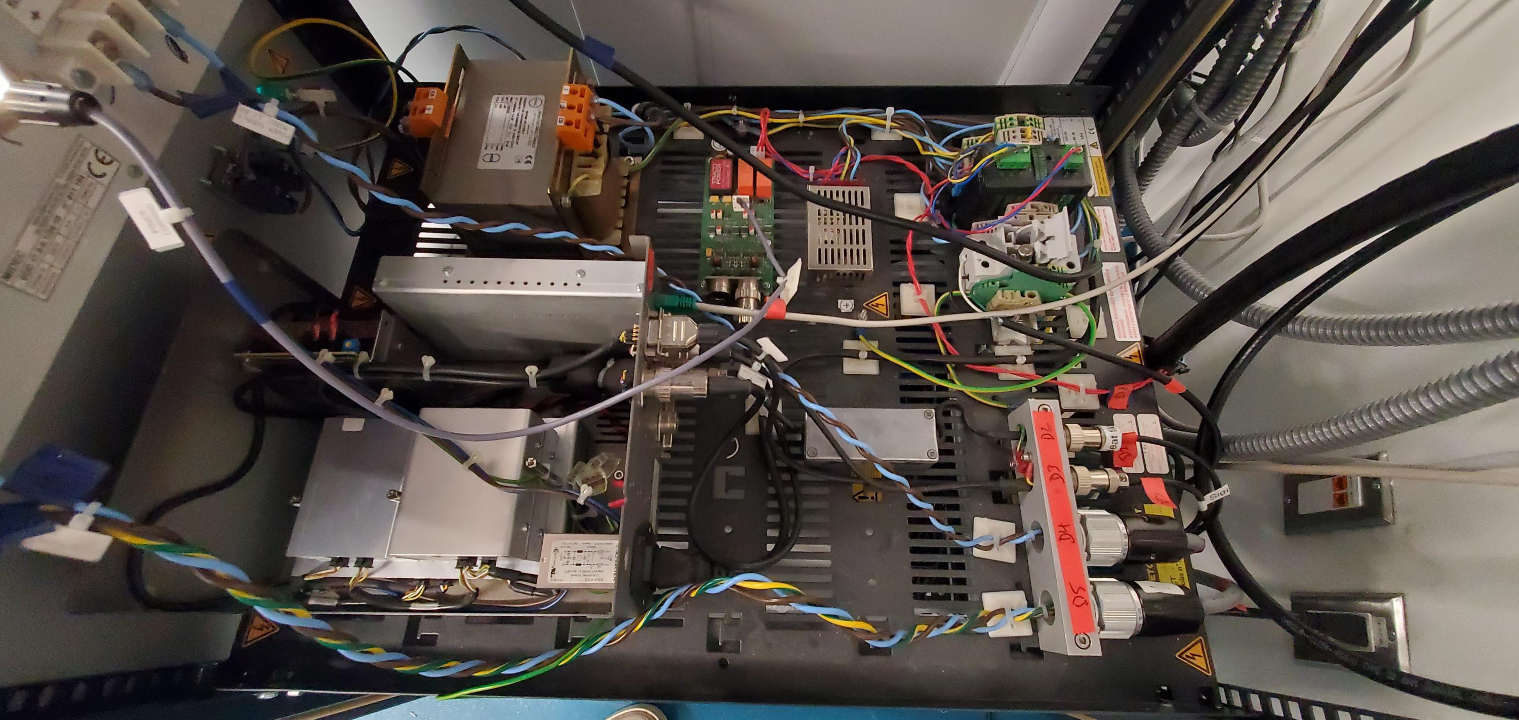

    Hi guys,
    The lab I work in has an equipment called a Differential Scannning Calorimetry. It essentially measures the enthalpy change as a function of temperature.
    Anyways, the equipment is made up of several devices and PCBs that have different cuntions. The main fuse connected to the transformer blew and I m trying to figure out why. These fuses go for $50 dollars each and we bought a few. I m going to unplug everything and connect each device until I find what device causes the fuse to blow and go from there.

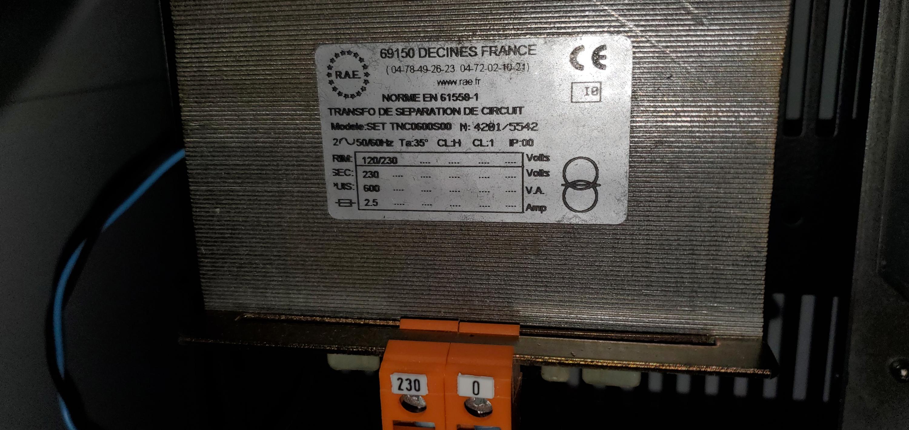

    Here is what I don't understand. The main transformer has an inputs 120v and outputs 230v. It is rated at 2.5 amps and 600VA. Here is a picture of the label.
    Two devices (and some small PCBs) are connected to the transformer. One is labelled "input: 230v 6 amps", the other "input: 230v 2 amps". Thats a total of 1840W just for these 2 devices. How could the transformer supply that if it's rated at 600VA?
    Thank you!

      Transformers(themselves) won't draw that much power continuously unless its output is drawing that power (or if the transformer is misdesigned for the frequency of operation). So depending on what's drawing power on it will determine how much power is needed for that apparent first stage step up transformer, probably as a cheese around to allow this device to be used in 120V-land like North America.
      You say it's a calorimeter of sorts, so I suspect the main use for it is to detect temperature increases and decreases over time to estimate thermal energy change in a chemical reaction. Whether additional heating or cooling is necessary I don't know - perhaps to bring the reaction chamber ambient temperature to a fixed value - would consume the most power. This would be the most stress on that initial step up transformer.

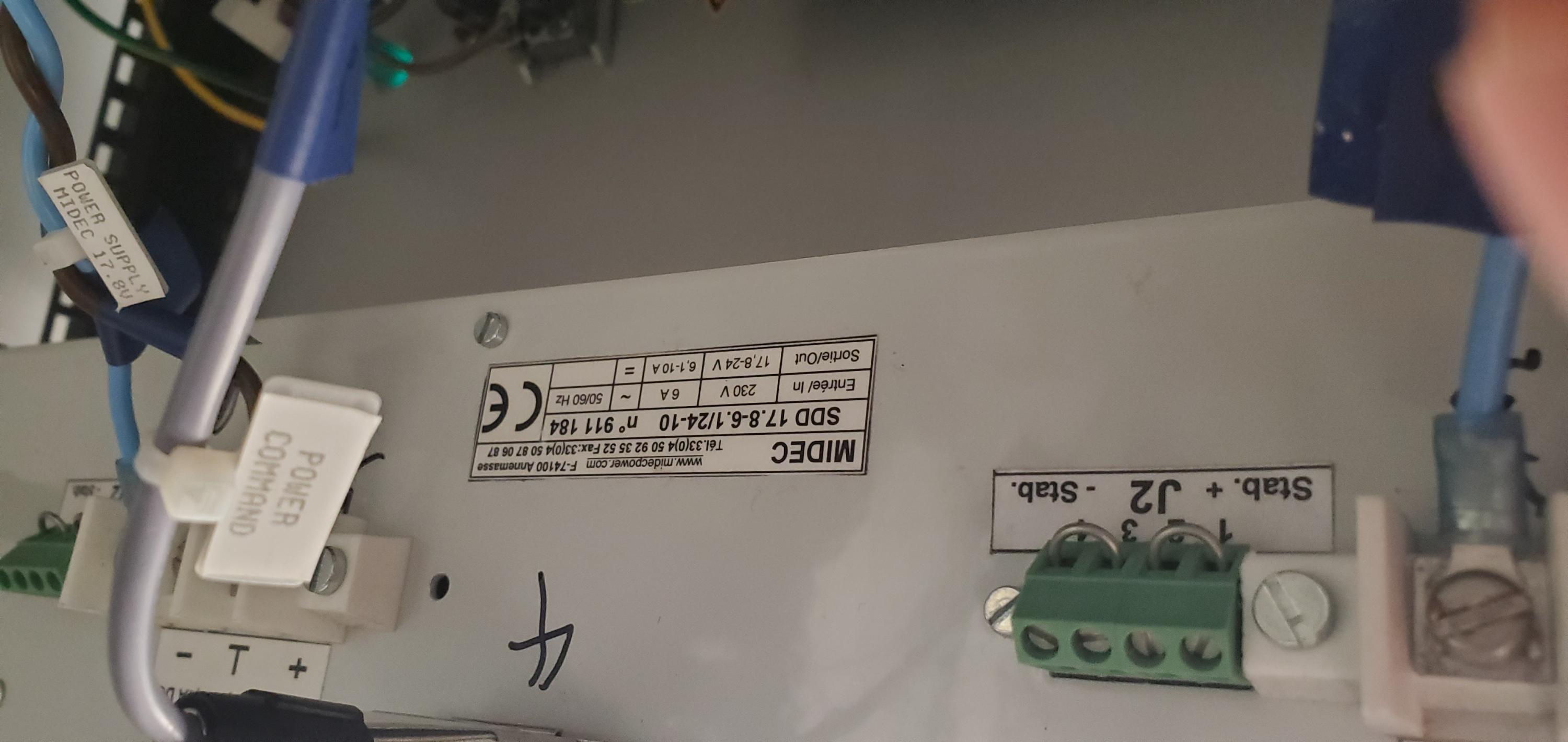

            Re: Fixing a laboratory DSC
            On the photo below is the back label of the device. I assume that's how much current is drawn.
            Yes, like you said, it either heats or cools but not at the same time. I thought that regardless of the the ouput of that device (whether it s heating or cooling), it would always draw 6 amps. But if that's not the case it all makes sense.
            I don't know about the fuse blowing. I found the blown fuse and haven't been able to test anything as I m waiting for new fuses to be shipped. As soon as I get them I can get on it and try to gather some info.
              That's probably a switching power supply in there but again I'm just guessing based on the large disparity of input and output power - and lack of heat sinking. And the reason why the 600VA step up transformer works fine.
              As most BCN people know, switching PSUs have a lot of ways to short out the input causing fuse blows. And the fact that MIDEC appears to have been fly by night, it's highly suspicious of being at fault here...

                Interesting. I ll take a closer look at that Midec. It does have a fan on the side which I suppose is next to a heatsink inside.

                    How do you know Midec is unreliable? Or are you saying this because of the switching power supply?

                      just a hunch because they went out of business it seems (website is gone?!) and switchmode PSUs tend to have their own set of failure mechanisms that aren't shared with linear PSUs.
                      But need to look at that PSU and confirm, it's only a speculation at this point.
