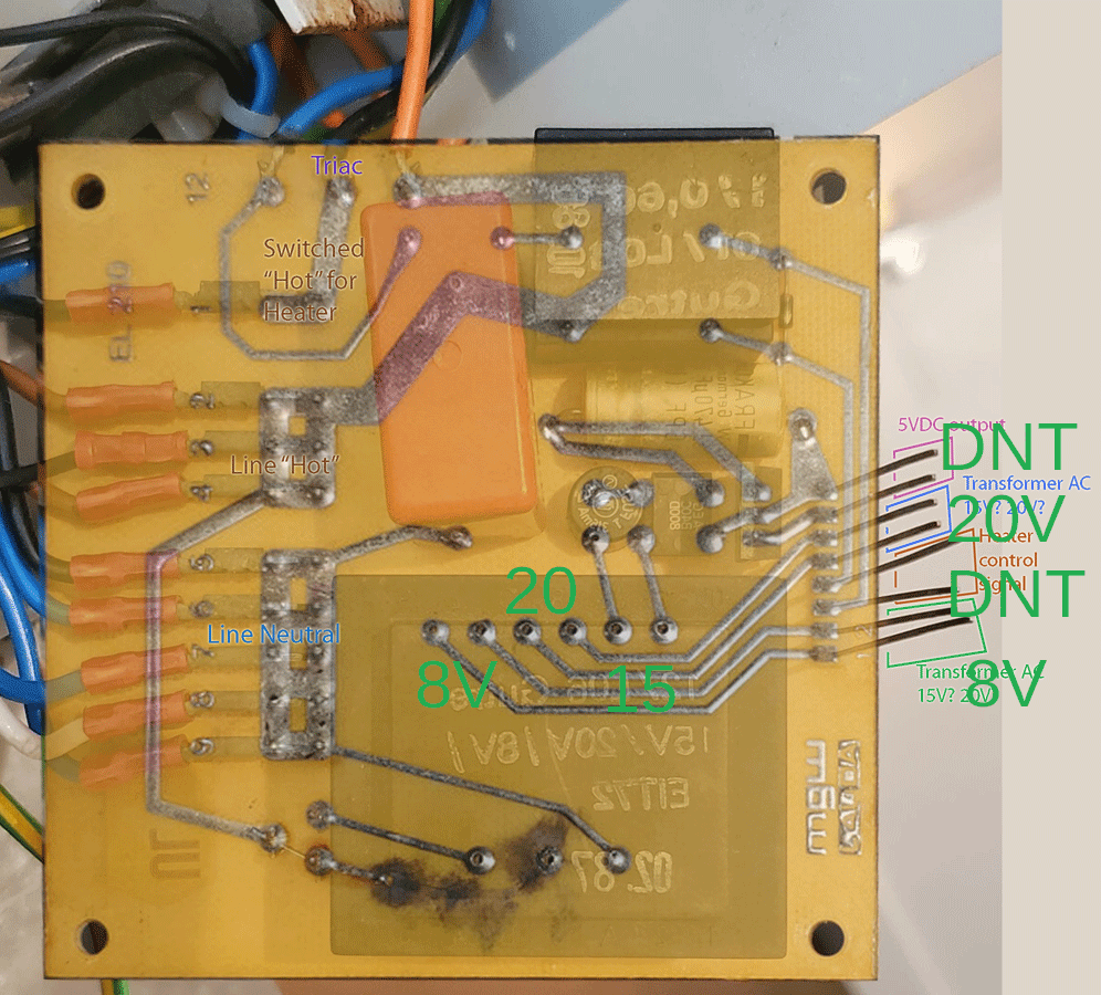

                        Could you tell me which is which again. I coloured them to make it easier.
                        Is it:
                        Blue: 15v
                        Red: 5v (rectified 8v from the transformer)
                        Green:
                        Yellow:
                        That would be really helpful.
                          #52
                          Re: Fixing a laboratory waterbath
                          The board with the transformer on it is probably better to do wiring hookups perhaps?
                          DNT = Do Not Touch
                          8V = 8 volt output, I would say 6.3VAC-8VAC is good
                          15 = 15 volt output, I'd suggest anywhere from 9VAC to 15VAC
                          20,20V = 20 volt output, I'd suggest anywhere from 14VAC to 20VAC
                          Do not go higher than the suggestions in my opinion.
                          BTW
                          only the 8V output needs to go to 1A, the other two outputs probably 200-500mA is sufficient.
                          and still... how did that trace on the transformer board burn out? Fed it 220V without changing from 120V or something?
                            DNT = Do Not Touch
                            BTW
                            Yes, I was going to do the hook ups on the transformer board.
                            When you say "DNT" you mean do not touch with bare hands? Or the pins shouldnt touch eachother?
                            Thanks for the diagram! Again, super helpful.
                              #54
                              Do Not Touch = Do not solder the transformer or anything else to them.
                              And technically you probably could get two (*maybe* just one) 5V and a 12V SMPS/regulated wall warts to replace the transformer, bridges, and 7805/7812; but there's a lot of surgery involved.
