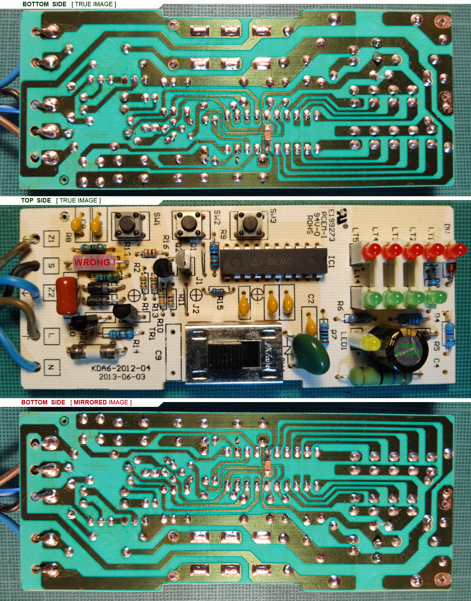

    I hope this fits well into "weird devices" category.

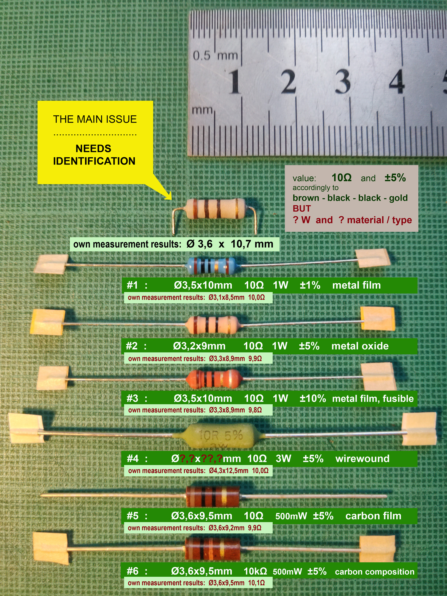

    Please... anyone that knows better the science of resistors. Everything is on pictures.
    Stuff written in green boxes are official values accordingly the packages and datasheets. The rest is the rest.
    All I can add is that the subject`s background colour behind stripes is blueish light gray. As resistor #2 in the row is rather beige and physically smaller, I think it`s not right replacement for the main issue.
    As I didn`t had resistors #1 to #4 on hand reach at first place, I quickly learned hard way that 500mW or either carbon film type resistor is not a way to go there.

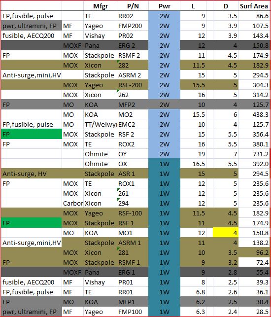

    I have a slight hunch that the subject might be 2W and metal oxide film due to similarities of this:
    https://projectpoint.in/index.php?ro...d=501648635957
    ... yet again some 3W variants look the same as well:
    https://www.amazon.com/uxcell-50pcs-.../dp/B07GMZDBNJ
    So I`m puzzled.
    IF 3W would be right way to go - could I use my #4 for replacement even though its wirewound type of resistor.
    Is there`s any significant difference between resistor materials type in this context?

    What would you do with the burn mark on PC board? Luckly the tracks are on the other side and not damaged. I applied some kapton tape on the spot before new resistor replacement.

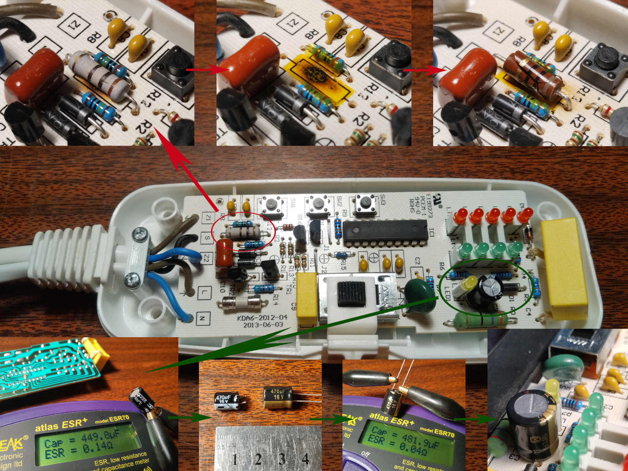

    Yes, the electrolytic capacitor is replaced as well. And atm I`m troubleshooting those yellow MPX X2 polypropylene capacitors as well, although it`s not shown on that second picture collage. Just to be sure of everything.

    The resistor is likely a 1 watt, Some manufacturers resistors are smaller in size for the same wattage. Mount the resistor above the board so it is no longer touching and it will have better heat dissipation. Did you find the cause of the open resistor or was the original not open? The one you are asking about is likely a 1 watt metal film flame proof, I would use #1,2 or 3, You can use #4 if you have room,

      it's a 1w FLAME-PROOF resistor.
      it's big because the oxide track is not continuous - it's a spiral so it can go open-circuit with minimal heat.
      that's also why it is dipped in gray cement instead of paint.

        I think there is another bad part that cooks this resistor? Is it for a snubber or capacitive-power? Where is the triac I would check it.
        There is a wide variance in the size of power resistors, a big game to make the smallest power resistor with the highest power rating. I compared dozens of different ones and realized it will drive you crazy.
        A resistor manufacturer will offer a "mini size" for the same power rating, but they operate much hotter.
        The larger the resistor is, the greater the heat dissipation. The better the materials (cement verses epoxy, wirewound verses film, copper leads verses FeCu) the hotter it can go.
        I don't think you can judge power resistors on size nowadays.

          R_J - Yes, this original main issue resistor is open. And the burn mark is seemingly a long-term result. Not a sudden cause of resistor failure.
          And there`s plenty of space to solder any of them there.
          stj - #2, #3 and #4 also have this kind of hard matt coating while #1 is glossy paint (or epoxy for that matter). I never knew the considerations for materials used for finishing. Likewise I don`t know much of a difference of resistor type technologies.
          redwire - Oh my, thanks for the input! There`s so much to discover. Snubber vs capacitive-power - How can I find out?
          So... putting this all together my #2 seems almost like a replacement but probably it will heat up faster and will eventually fail later.
          I am assuming that:
          1.) Wattage value can be exact OR bigger (if it physically fits) but never smaller than original.
          2.) Whereas `flame proof` type is a must accordingly the context.
          3.) Plus physical size should be at least the same up to its values for better cooling.
          [Correct me if I am wrong in any aspects.]

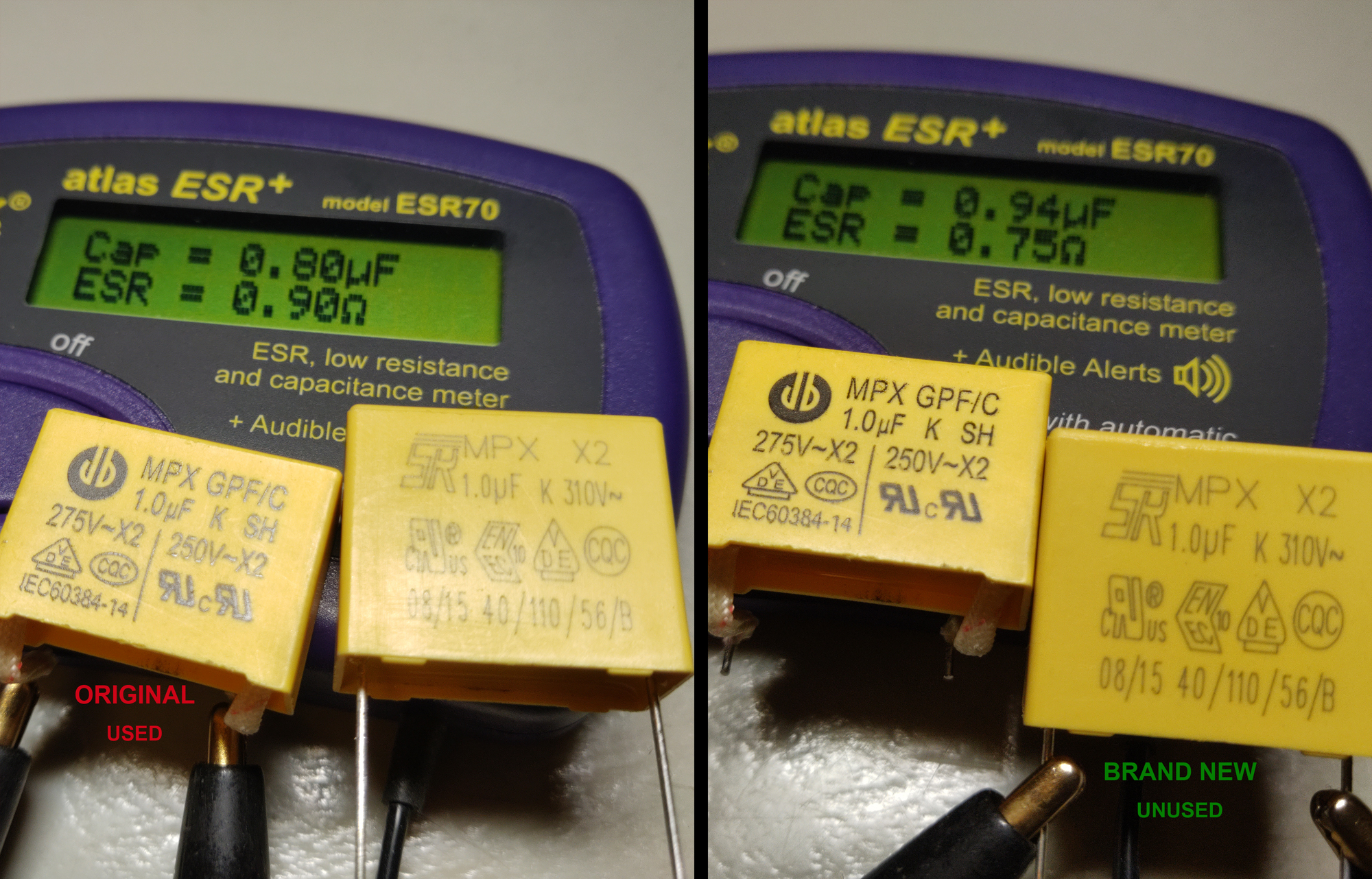

          -This polypropylene capacitor needs to be replaced, right? As it`s capacitance (exactly -20% of 1.0uF) is lower than stated capacitance tolerance (±10%). Also resistance slightly out of range.

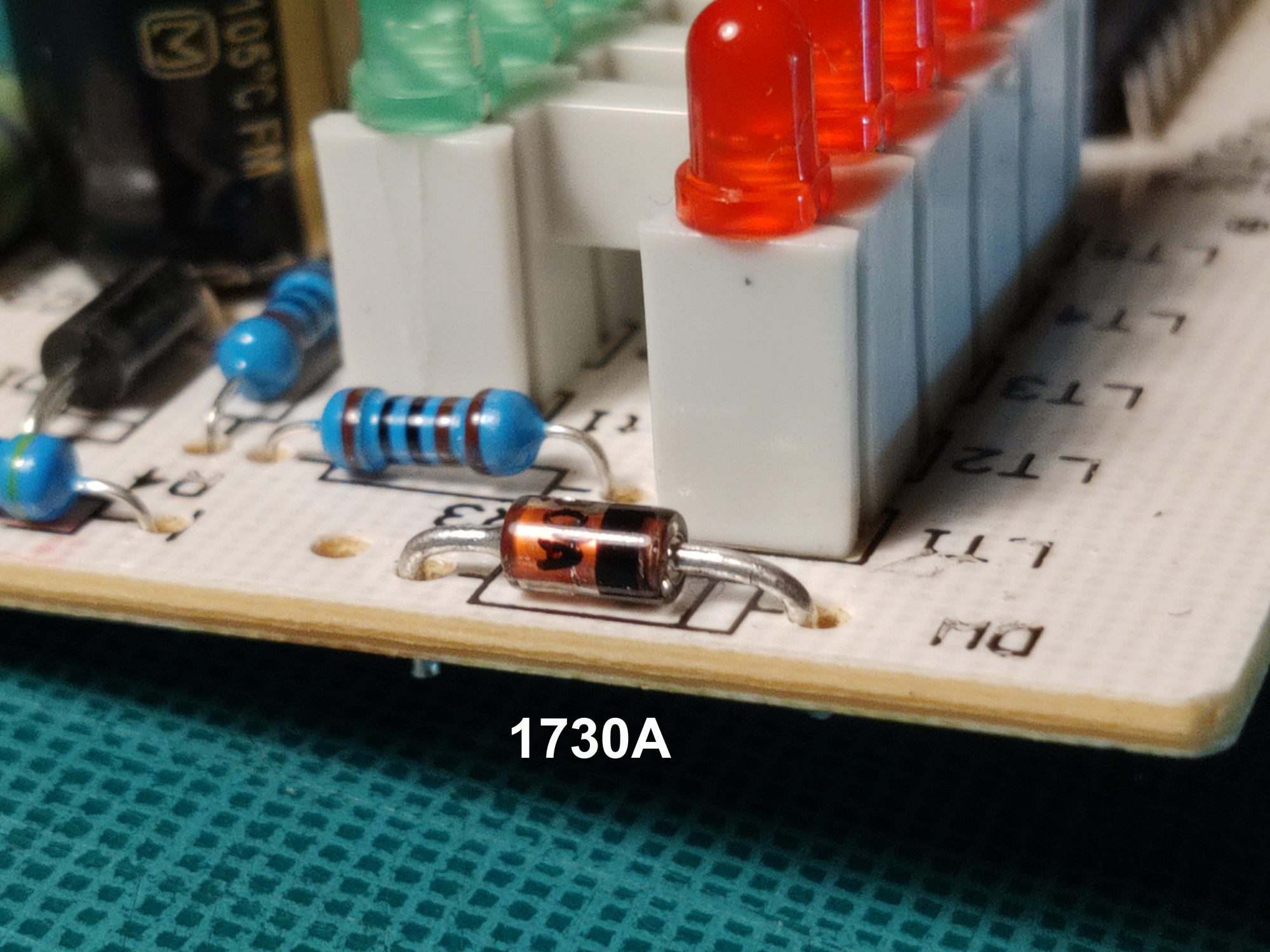

                  where does that microcontroller get 5v??
                  a zener diode??

                    ***-This polypropylene capacitor needs to be replaced, right? As it`s capacitance (exactly -20% of 1.0uF) is lower than stated capacitance tolerance (±10%). Also resistance slightly out of range.
                    I would recommend replacing capacitor scenes you have one on hand
                    I would also recommend when you put the new resistor on the board do not mount it flush to the board leave a space between the board and the resistor so does not keep burning the board
                          a zener diode??
                          This little fellow?

                            I suspect there is a problem with the blanket or wiring to the blanket that caused the controller to fail. If the led's are flashing the same way as the video, it indicates there is no blanket connected, no load and no feedback/temp control. The ic is likely a PIC microcontroller

                                  Some notes:
                                  The printings on PCB in video read
                                  E199273
                                  PCEM-1
                                  94V-O
                                  ROHS
                                  which are the same as mine,
                                  then on the other edge
                                  KDA6-2015
                                  wheras mine reads
                                  KDA6-2012-04
                                  2013-06-03
                                  Then pause video at 5:20 and the colour code for the "S" big resistor seems like red-red-gold-silver = 2.2Ω ±10% ?
                                  (The rest set of big components look the same as far as eye can tell.)
                                  Could it funnily be like few years later they found out that 2.2Ω ±10% is suitable there instead of 10Ω ±5% ??
