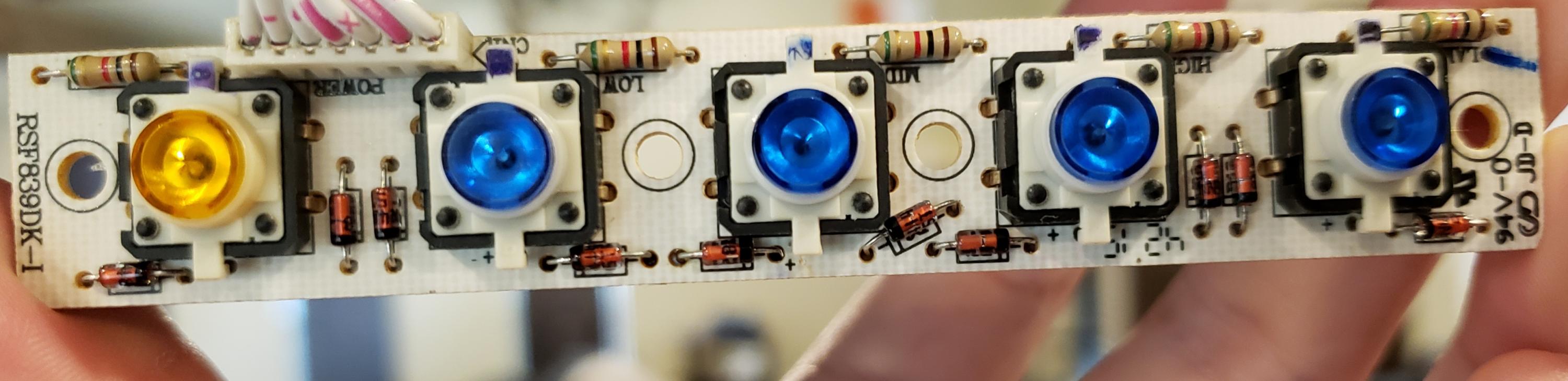

    I have a kitchen range hood that recently stopped working. Initially pressing any of the buttons would power on the unit and then immediately power off. I took out the control board and replaced all of the capacitors and everything worked like normal for a few days. Now the buttons on the range hood don't work. The range hood is definitely getting power. When I jump the pins on the back of the board I can get the fan to turn on. It will turn off when I jump the pins again. The LEDs that are on the switches will randomly faintly glow when the fan is on. Any ideas or recommendations on what may be wrong? I included a picture of the board in question.

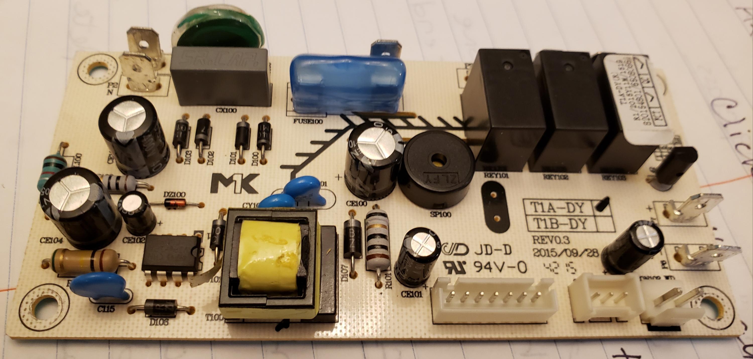

      Could you post a picture of the power supply board

        Here's the picture of the power supply board. I replaced 6 capacitors. I think that was all of them but I definitely could be wrong.

            If you do take it back down again look at the ic chip and see if it is some type switching power supply regulator if it is and you replaced all the capacitors I would recommend replacing this ic chip also
            I could not make out the hole part number but it looks like VIPER something this is switching power supply regulator I would recommend replacing it

              Is that a picture of the power supply board after you replaced the capacitors?
              If yes, it looks like the capacitors you used aren't low ESR/impedance type, which is usually necessary for switch-mode power supplies to get clean power. The caps you used look more like cheap no-name brands you get on Amazon, eBay, or the local store. Since you are in the US, Digikey and Mouser are usually the preferred places to get caps online. Badcaps.net/store may also have what you need in stock (and if you'd like to support the site.)
              List of suitable PSU caps (and series):
              https://www.badcaps.net/forum/showpo...22&postcount=9
              That aside, going by the symptoms you're experiencing, the issue may or may not be capacitor-related. I suggest uploading a picture of the PSU board and any logic boards (i.e. not just the button board), so we can check them for bad solder joints too, which is another likely issue when it comes to intermittent problems.
